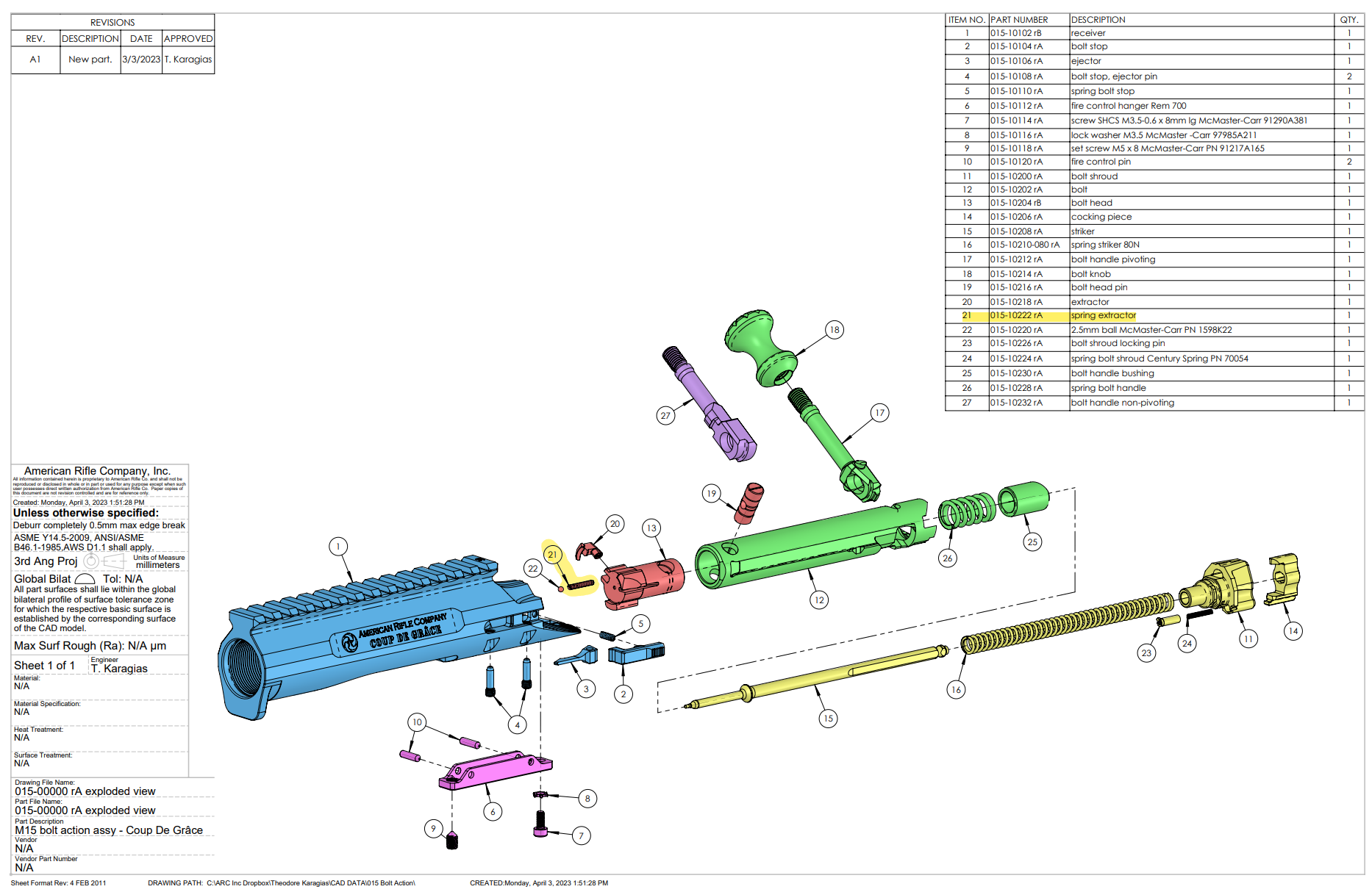

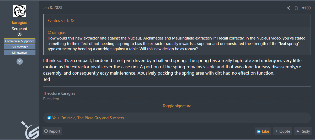

It has a (high rate) coil spring powered extractor unlike Ted's previous actions. You should be able to see the spring in the bolt head as it's partially exposed. The choice of the high rate spring is what leads me to believe it's extractor spring related.
#21, part 015-10222 rA
https://www.snipershide.com/shooting/threads/coup-de-grâce-new-action-from-american-rifle-company-899-wow.7155247/page-3#post-10663973

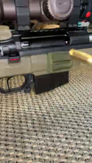

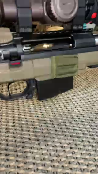

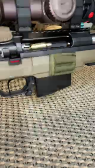

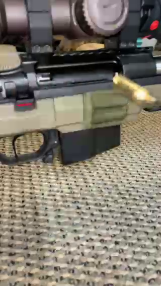

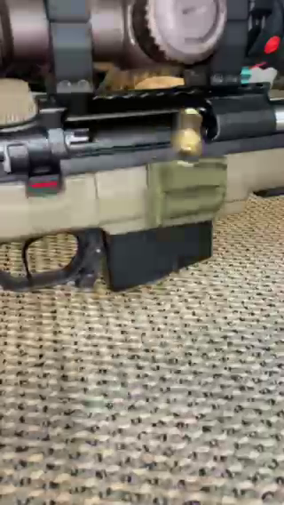

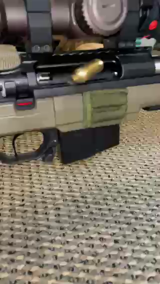

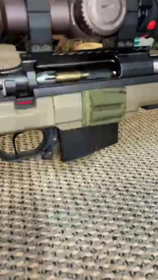

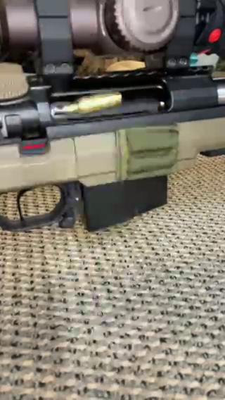

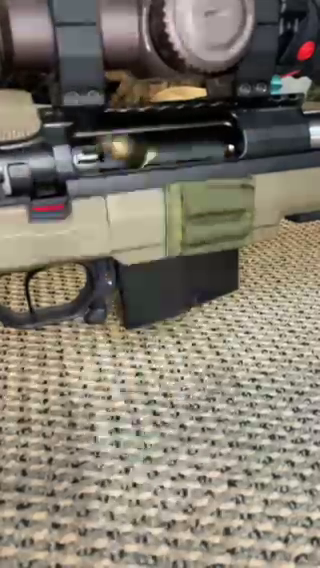

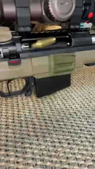

Recently built a CDG 6 BRA rifle and am working through the somewhat anemic ejection of the CDG (at least with the short cased 6 BRA). After taking a slow motion video of the ejection, it appears that the case makes a 180 degree spin whereupon the neck of the case (now rearward facing) bounces off the bolt head reversing its direction and causing it to move away from the action at the 2:30 direction. It looks similar to an AR15 ejection where the ejected case hits the brass deflector.
I couldn't upload the movie file so attaching screen shots. It's a little fuzzy but you can see the case pivot, then change direction as the case neck hits the bolt head.

The frame-by-frame (much thanks @Praeger) makes it look to me like the extractor is letting go early; the case head starts moving away from the ejection port (clearly coming out from under the extractor), so the case spins inside the action. I'd rather see it more like a door hinge: the case pivots around the extractor, then lets go only after the case center of mass is out of the action and traveling rearward.
I'd have to compare against another action with a fixed ejector and see what that slo-mo looks like, but that's the picture in my head.
I got new extractors for all of my bolt heads 223 and up. I think you’re correct on the reason though.
I wish I could upload the video, but you are correct in that as soon as the ejector blade pushes the left side of the case the entire case spins (mostly in the open ejection port) until the neck strikes the bolt head. When the case begins to spin, the right side that is captured by the extractor during the extraction, spins out of the extractor's control - it does not pivot on the extractor. My first experience with a mechanical ejector so no frame of reference if this is common to mechanical ejectors.
