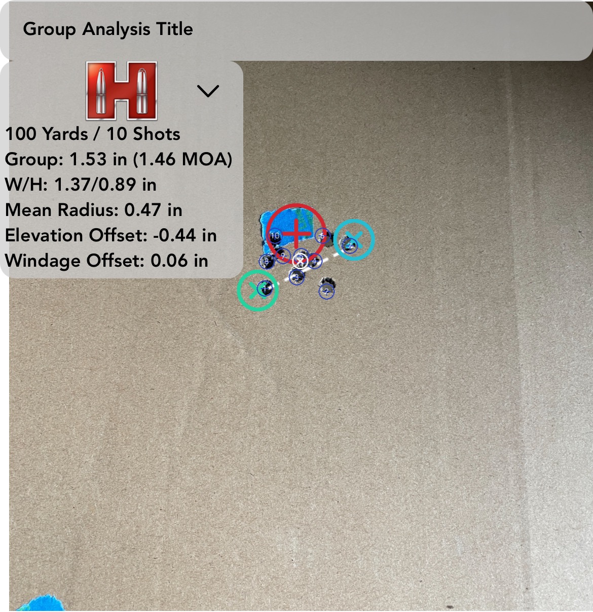

Got the 16” out this morning. Once I got the gas block adjusted it shot decently. Was getting 1.25 MOA on a 10 shot group with 140gr ELDM. I’m sure with a tad more patience on my end I could get 1 MOA or slightly better with this ammo.
I’ve got to verify that nothing moved when my scope shifted (didn’t have the rings fully torqued) on my next trip. After I do that, I’ll hone in on shooting some tighter groups to hone in on a perfect zero. The plan is to take this gun out to 1000 in a match in July.

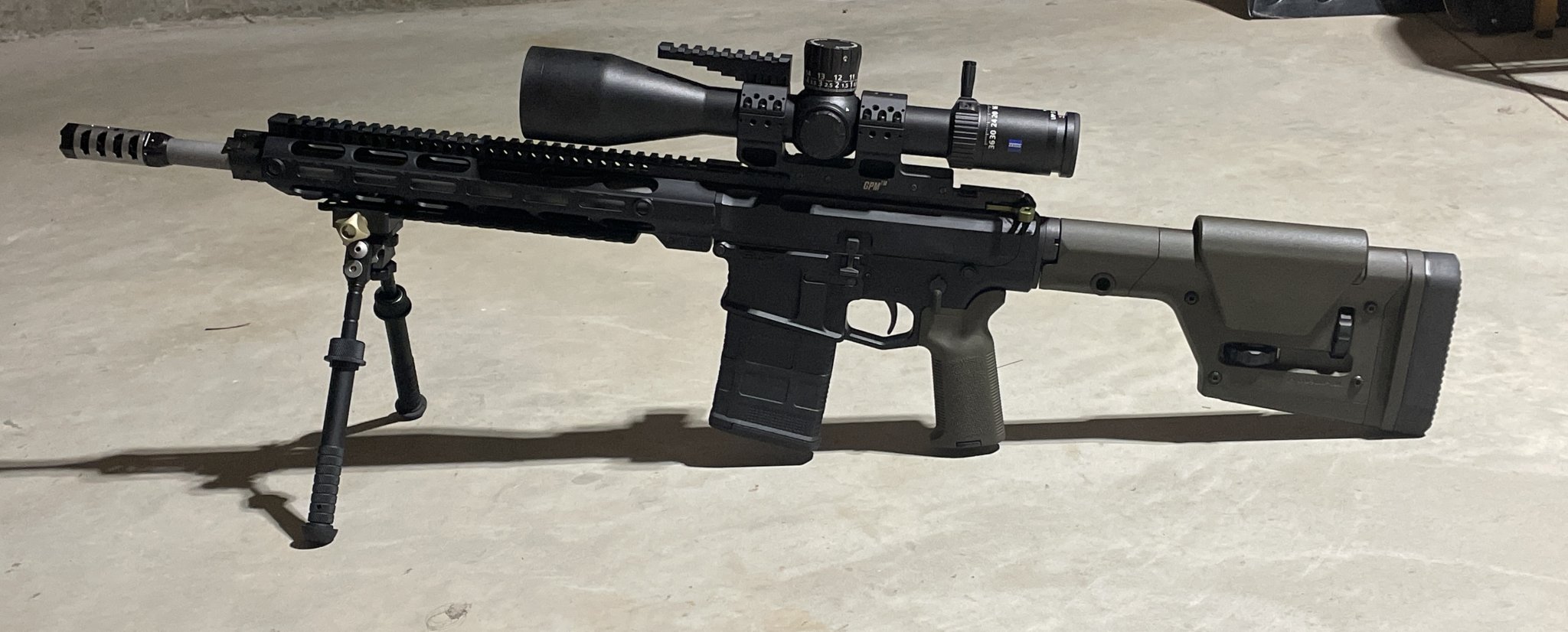

Got one in 6.5 creed, waiting to finish the build but the fit and finish is excellent. I want to build my version of the Ridgline Defense RD15 with one of their 16.25" 223 wylde barrels too

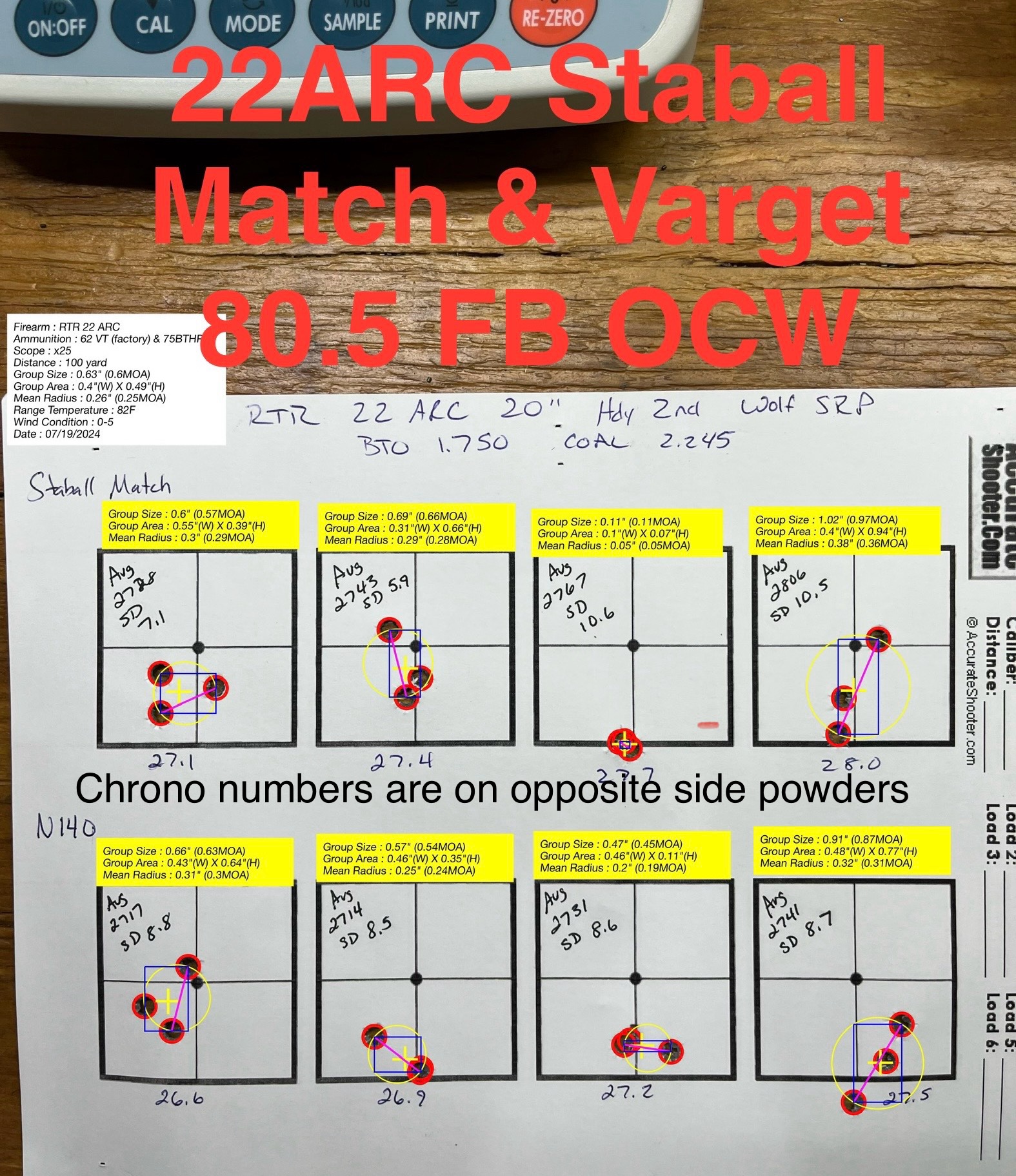

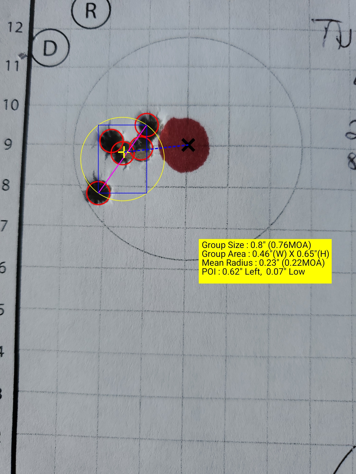

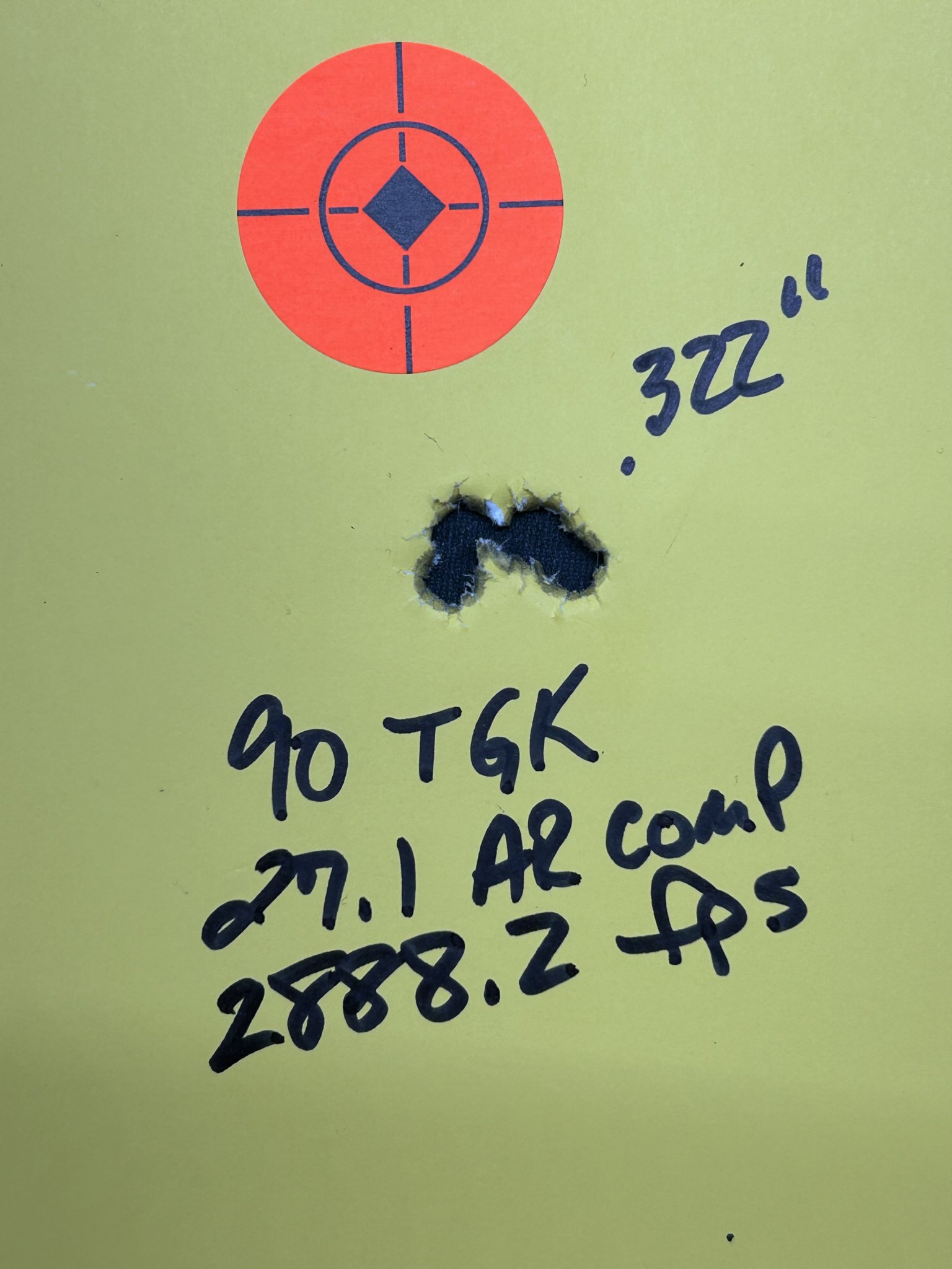

I picked up a 22" 6 arc RTR barrel earlier this spring. Other than needing to open up the gas port a few thousandths (+1 gas) to get it to cycle reliably, it has performed well. Customer support has been great as well.
Factory ammo shoots just under 1" at 100 yards. Handloads have performed better with a couple loads shooting under 1/2 ".
The group in the picture was from a recent load development session using Sierra 90 TGK and AR Comp powder. All 5 groups were unde 0.8" and this was the best at 0.32".
I'm definitely happy with the way it's performing.

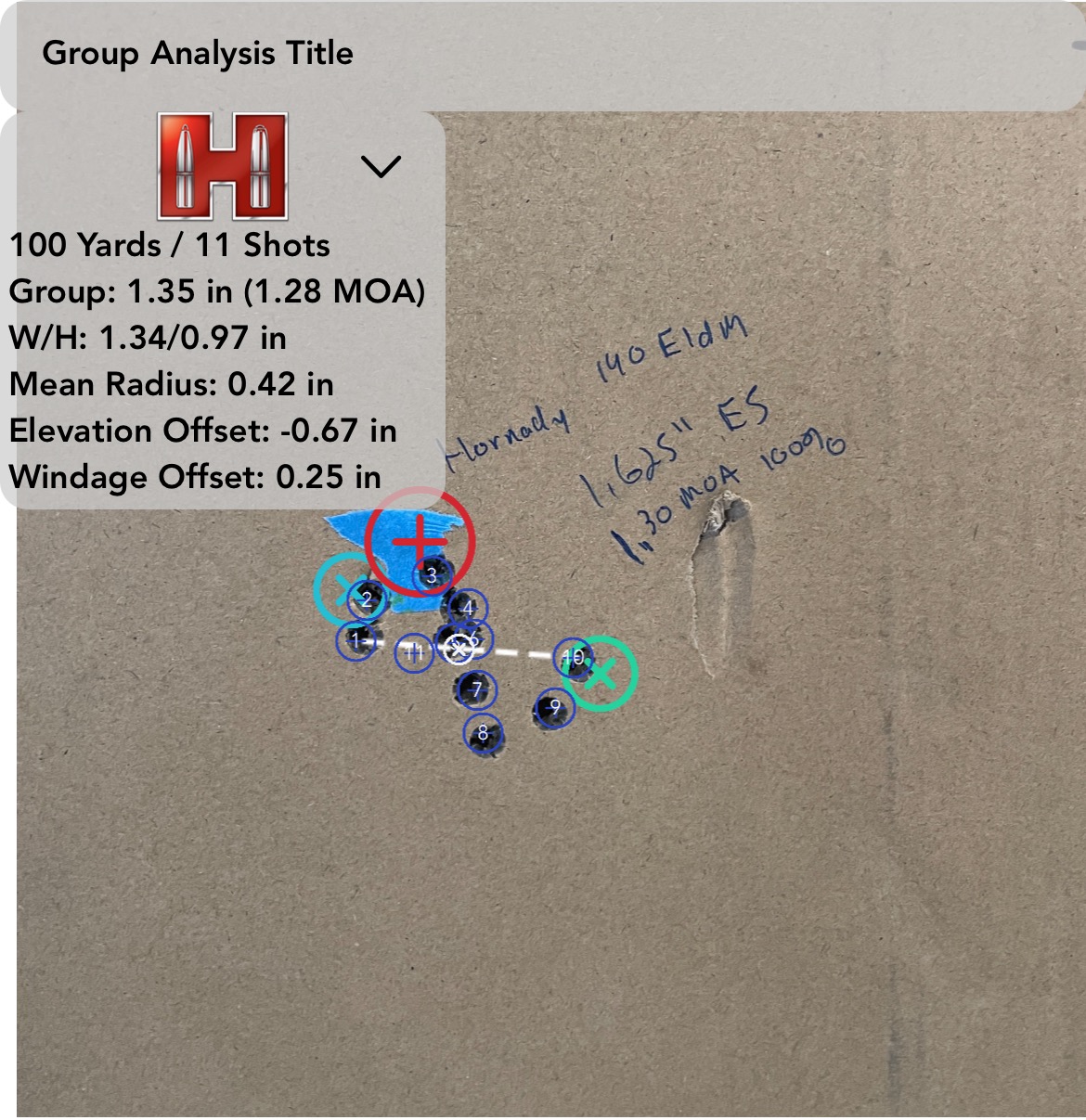

Two groups from today with my 16” 6.5 Creedmoor. Gun was hot and not given much cool down between these groups
