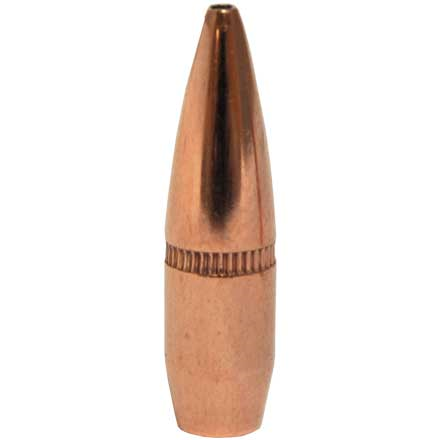

If you do, use a taper crimp. Make sure cases are trimmed to a UNIFORM length to avoid problems. A light crimp is sufficient. Only use bullets with a cannelure.
