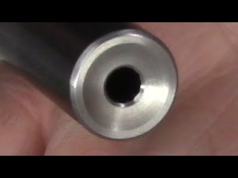

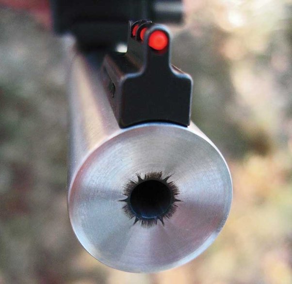

There are usually 3 things that can cause problems,
gas port through a land slices off more copper on one side of the bullet.
Burr on the crown or crown off center if it has a 45* chamfer
The muzzle has swelled where the 1/2" threads were cut but Steve knows about this issue and in the past has always stress relieved the barrels twice.
I would borescope the barrel very closely and look for the first 2.
This type of crown has a 45* chamfer into the bore, it is easier to get an imperfect crown with type.
This is a 11* crown without a 45* chamfer, much easier to cut a perfect crown if they single point cut this starting in the center and moving outward on the X axis.
BTW Keep torquing your barrel nuts to 40lbs, that barrel to receiver connection needs to be as rigid as possible.
