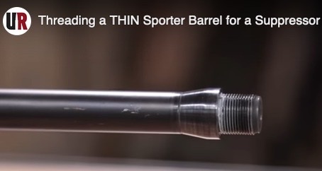

This is one solution for threading a thin barrel. When I'm ready to thread that thin barrel of mine I'll be trying to find someone who can do this.
Nice info! I see now about the shoulder issue.

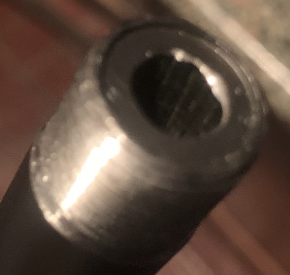

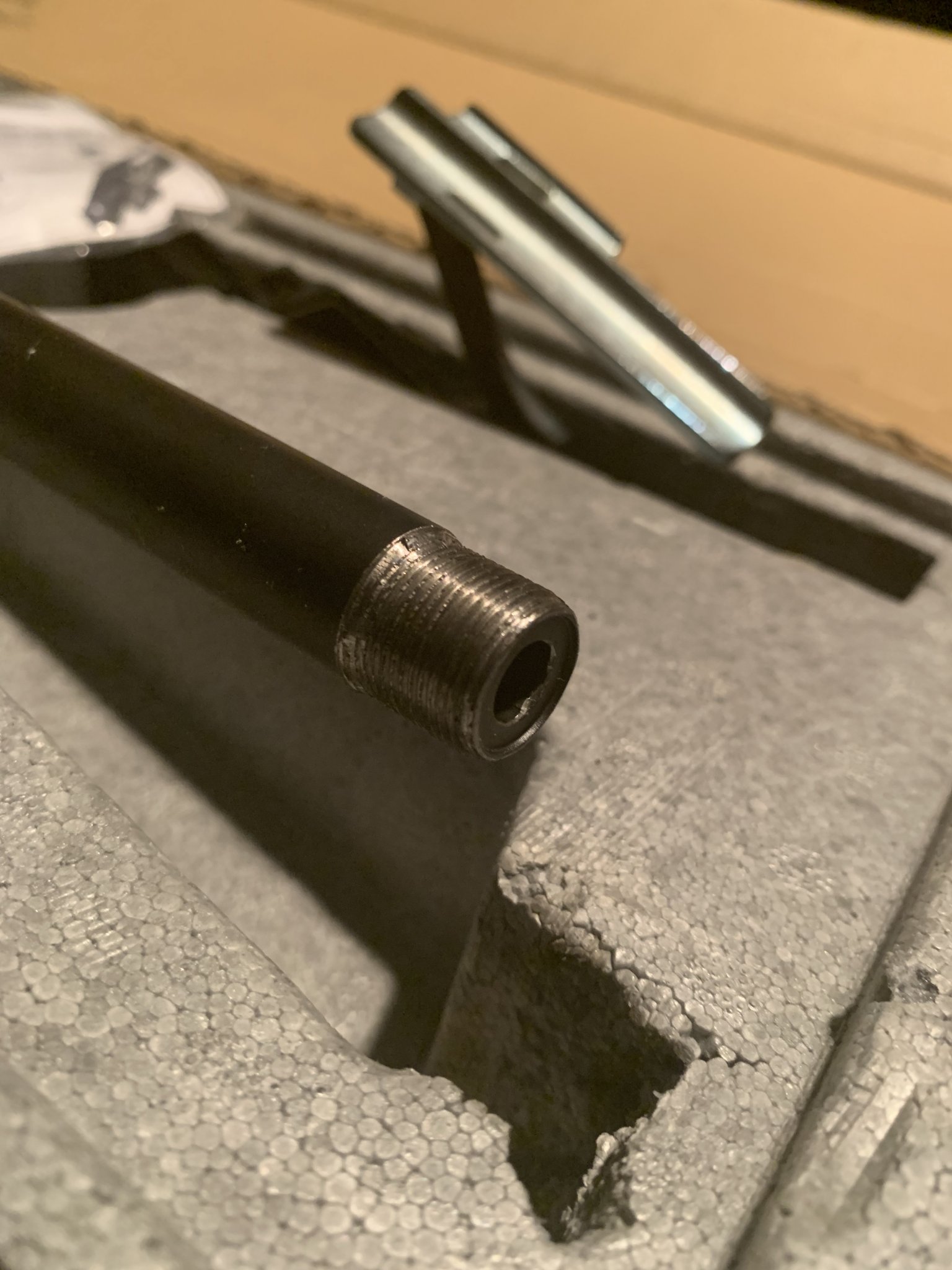

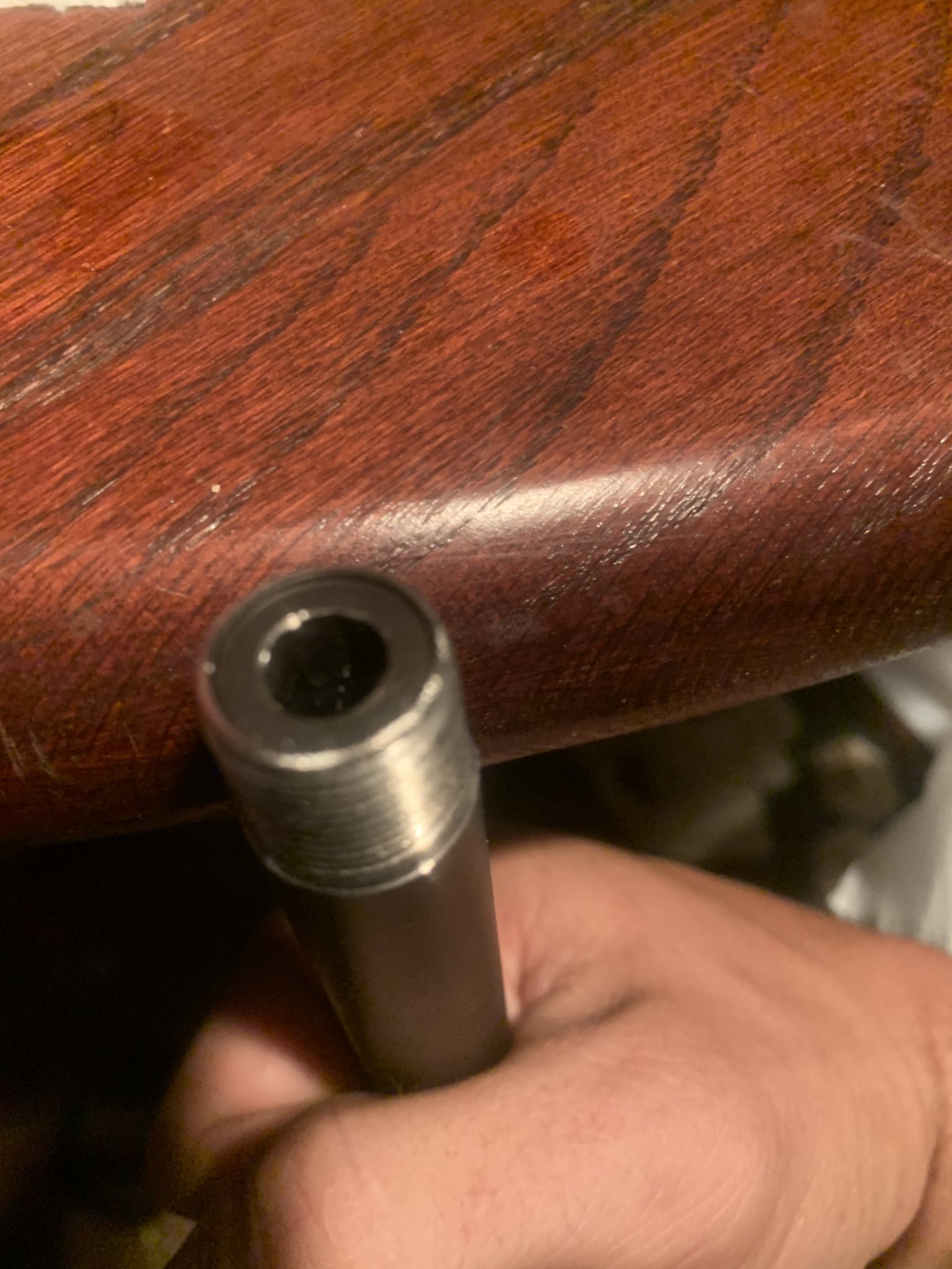

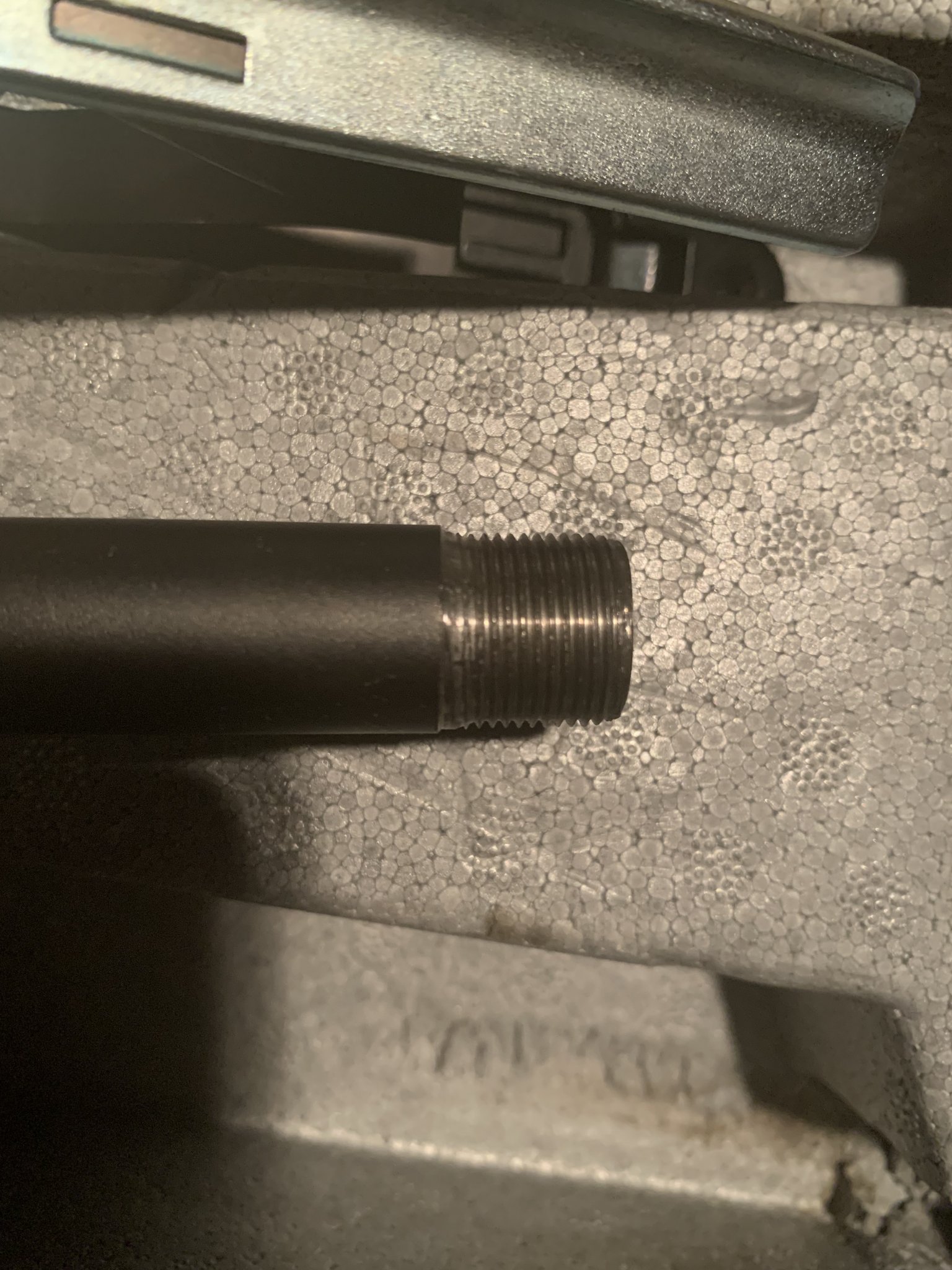

Hey y'all this is my first post unfortunately. I was about to mount a Razor Gen II 3-18 I just bought off of @xxflyingturtlexx (great condition and nice packaging btw no issue there), on a bergara b14 hunter .300wm that I had the barrel threaded by someone in MS who seems to be a wannabe gunsmith. I am attaching pics to show the damage caused to my crown. I ran a qtip inside the barrel and the burred edges were so sharp it cut the qtip in half! Glad I didn't start shooting...
Unfortunately the man would not back up his work so I am going to take it to someone who is competent. Let this be a warning to those are considering taking their property to an unknown smith. I learned my lesson the hard way..

Not enough of a shoulder for a suppressor mount. Post #50 by @doubloon covers some good solutions, but I would not fudge the minimum shoulder dimension with a 300WM suppressor. Another option might be a MD which indexes off the crown instead of the shoulder, I don't know if the YHM is suitable. Watch your minimum barrel length for a 300WM with a suppressor, for the YHM can it's 20".
If you haven't already ordered the suppressor and these solutions are beyond your budget, chamfering the crown and throwing on a thread protector would be the cheapest option. A T-handle chamfering tool with a pilot is OK, but you can mess up the bore if used incorrectly.

It’s sitting at 23.25” rn so I have room to work

There’s no protector on it. Pics look good on my end.
Then there may have been some compression on upload, below is what I see. Also that donut around the outside looked like a really thin protector to me from the forward angle ... that's why I couldn't decide if you had a .650" or .700" barrel profile.

I wouldn't shoot it suppressed as is but I wouldn't have any fear of seeing what it does at 100 yds unsuppressed. But if all you have is hunting ammo that could be an expensive experiment with little value. I've seen some pretty nasty muzzles that shoot just fine. Then there's this guy who cut a barrel at less than 90 degrees with a grinder and still got ~MOA average groups.
I am glad you stopped before you had a baffle strike in your suppressor. I am sure the places mentioned can explain what you need to get enough shoulder for s suppressor on that barrel. A lot need around .720-.750 at the muzzle.

Try tapping on the screen where the threads are before taking the photo. The camera will focus on the tapped area. Might help with the clarity.
Reactions: vh20
Yeah, the camera is focused on the table in the background, not the barrel.
Wow. Not sure which is better, the crown, the threads, or that shoulder. 🙃
On the plus side, when you have that cut off you might have enough meat for a proper shoulder for the can or brake.

I seen some bad ones, but got me beat. Holy shit. I can see why you didn't screw a can on it. 🤣🤣🤣 makes some of the shitty threads I have seen lately look downright respectable.
It's bullshit. You should be out enjoying it instead of having some dickwadgunplumer screw it up for you. I bet 20 bucks just like posted above. That goof ball threaded your barrel with die.
