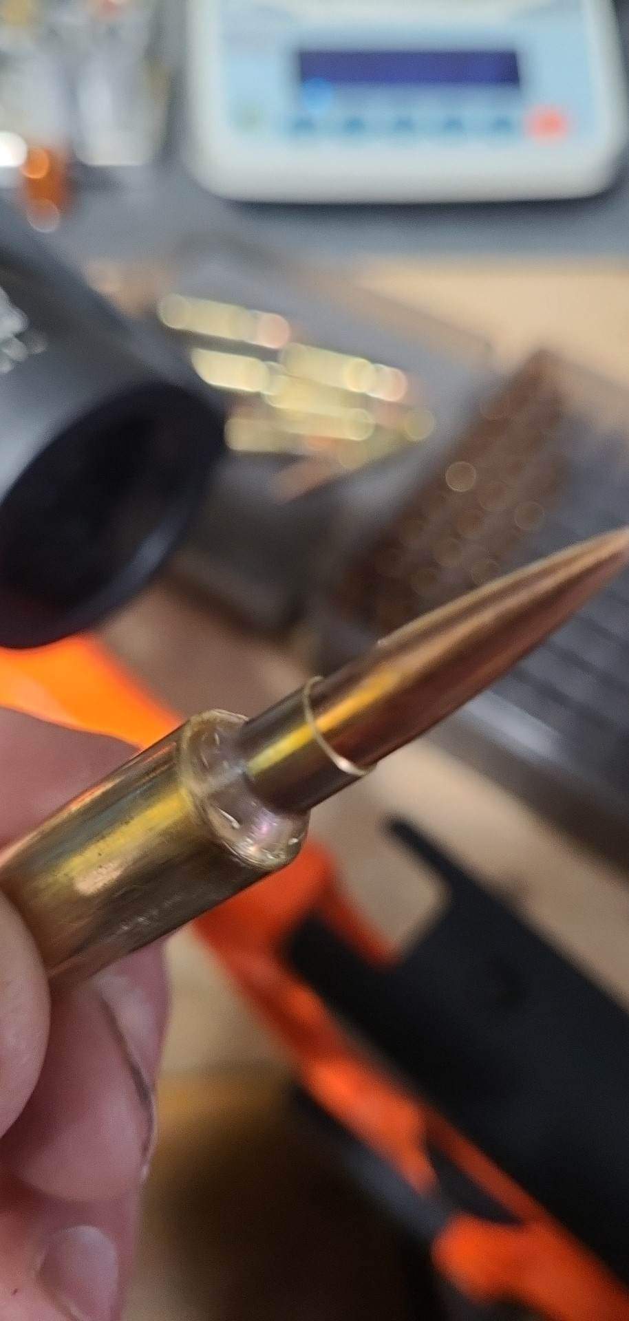

Digging up a old tread, but wanted to comment my experience with the vector and different brands of mags.
Mdt chassis and aics style mags did the same as the op, so I switched to aw. I was running br and it solved all my problems. Feed lips will catch the bolt lugs if not turned in.
Recently switched to dasher and I had problems with jamming came back.
After struggling I realized the shoulder of the case were catching inside the action. On each side of the feed ramp there was a hard point. It was in the perfect point to bind the round in the mag and the action. I had to take a deburring die and grind down each side to get it to feed correctly.
