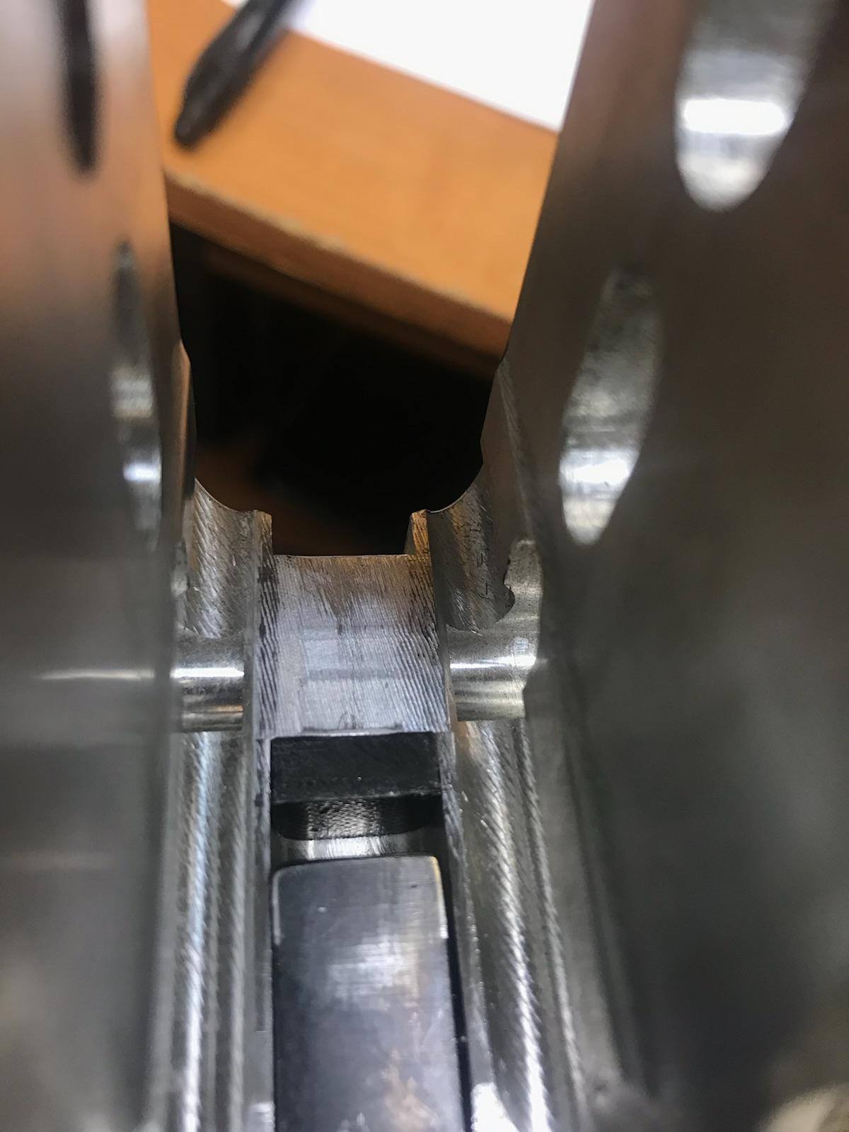

Mpa has a fix for the AI mags.. I had my gunsmith measure the vector and compare it to 4 or 5 actions 1 was a aw style cut action and the vector was .200 longer in the mag well area which explains why AI mags wont work with up pressure because theres nothing to stop it.. I hear Chase is going to build an AI style action but who knows when that will be.. I've attached a picture of MPA's fix..its the Black peice above the mag latch.

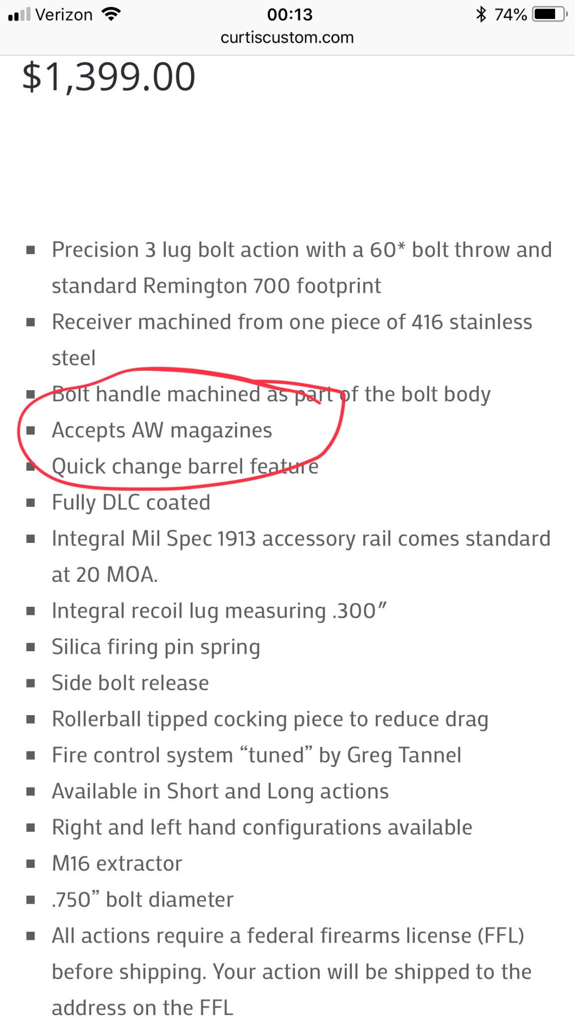

Btw... maybe he should have started with what’s described on the website?
Correct, I’m being a bit of a Smartass cause “worthless” was not the correct choice of words for a barrel that new.
As for my favorite flavor Curtis kool-aid. Tempests, impacts and AIs....

Where does it say does not accept AI mags. Also my rifle wouldn’t run with AW mags out of the box. They wouldn’t even insert. I had to modify my chassis. Even after that they still wouldn’t feed. The rounds wouldn’t not center up and would hit the face of the barrel. So many of you are making claims and accusations without actually understanding the issue clearly. I’m not an idiot. This is not my first rifle/action. I’ve been shooting factory and custom bolt guns for over 10 years.

I get the screenshot of the action description mentioning that it has an AW cut. Wonderful.... but it is switch caliber and there are bolts for 223 and 6.5 Grendel. Show me an AW mag that will feed 223REM, 224V, and 6.5 Grendel. AFAIK, that doesn't exist. It has to support a mag that supports these calibers. It is going to have to feed something AICS patterned.

Must be something then, hopefully chase will address the issue. I know it sucks but there are usually growing pains with actions that deviate from the market standard (2-lug/pushfeed/small bolt body/700 footprint). Shane on here had several with his tempest shroud that were unexplainable to the point that i think he just switched. Which i couldn't blame him for. I've never had it happen to mind and have been pretty fortunate in that regard.
I wonder if the reason why my receiver and two bolts haven't shipped is that they are trying to find a fix for this problem.
I was able to fix my issues with AW mags. I filed down the mag catch and used and un-modified AW mags and it runs like butter now.
I had 3 other AW mags that I had filed the feed lips down slightly on and those would get the 2nd to last round jammed up. Ordered a new AW and it works great now.
Still no fix for the aics upward pressure problem. And no you can not file the feed lips on the aics, you won’t have any lips left.
Cool, ty. What about the set screws do those hold up well to hold the barrel in place?
No problems with the set screws BUT DO NOT TORQUE TO 25 in/lbs. You will strip them. I couldn’t even get to 15 in/lbs. mine is probably at like 5 in/lbs but with 100+ rounds so far no problems with them backing out or anything.
Update: just received a brand new AW mag I ordered from Core and it too gave me issues feeding the 2nd from the last round loaded in the mag. So I filed a couple thou (measuring with a caliper) off the back of the mag catch on the AW and now it won’t feed a single round.
When the bolt pushed the round forward the nose immediately goes right and hits the feed ramp on the right side.
So I’ve got 1 AW that works and 1 brand new one that’s not working and an AICS that works as long as I don’t put upward pressure on it. Jesus why couldn’t AI just make a light weight AXMC or even AT with a mag bolt face lol this is SO FRUSTRATING
