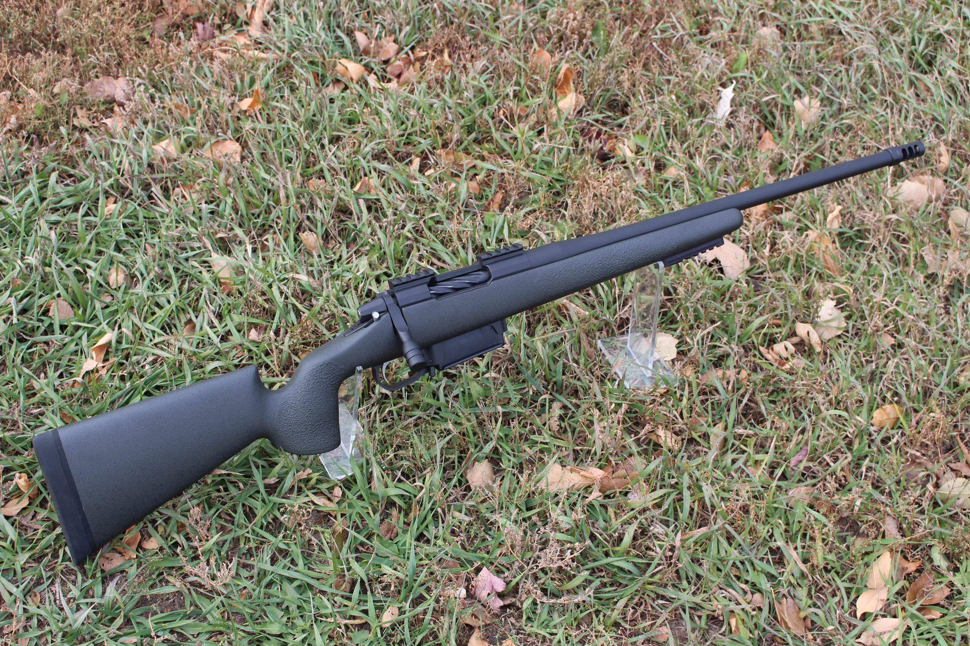

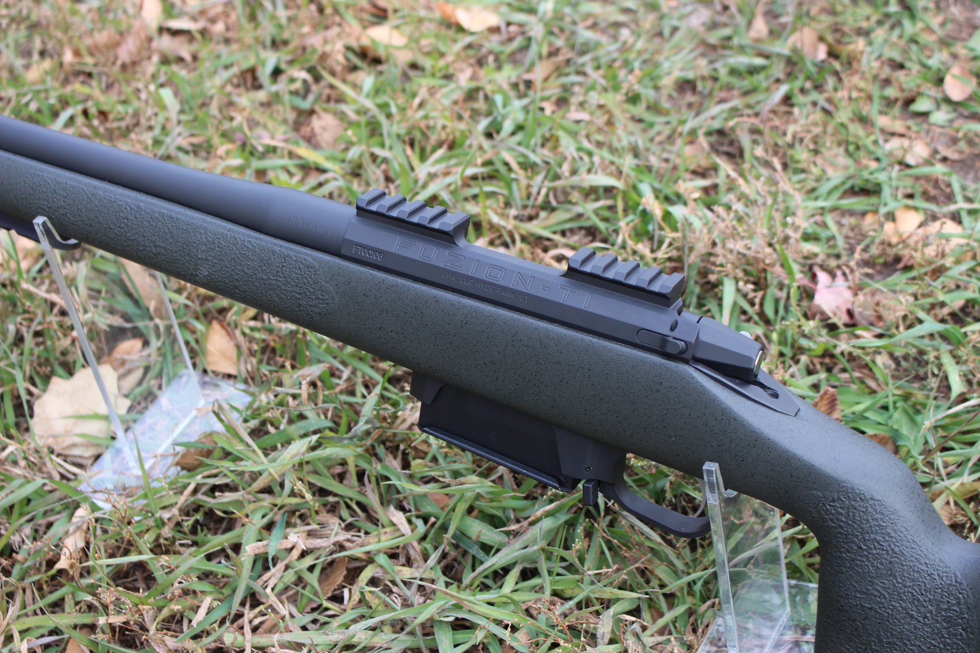

Treat yourself to the LP Fussion Ti you will not be sorry.Here is a pic of mine.28947300_1256581461153229_8689985136329342564_o.jpg29064181_1256581444486564_4088587793116500890_o copy.jpg
