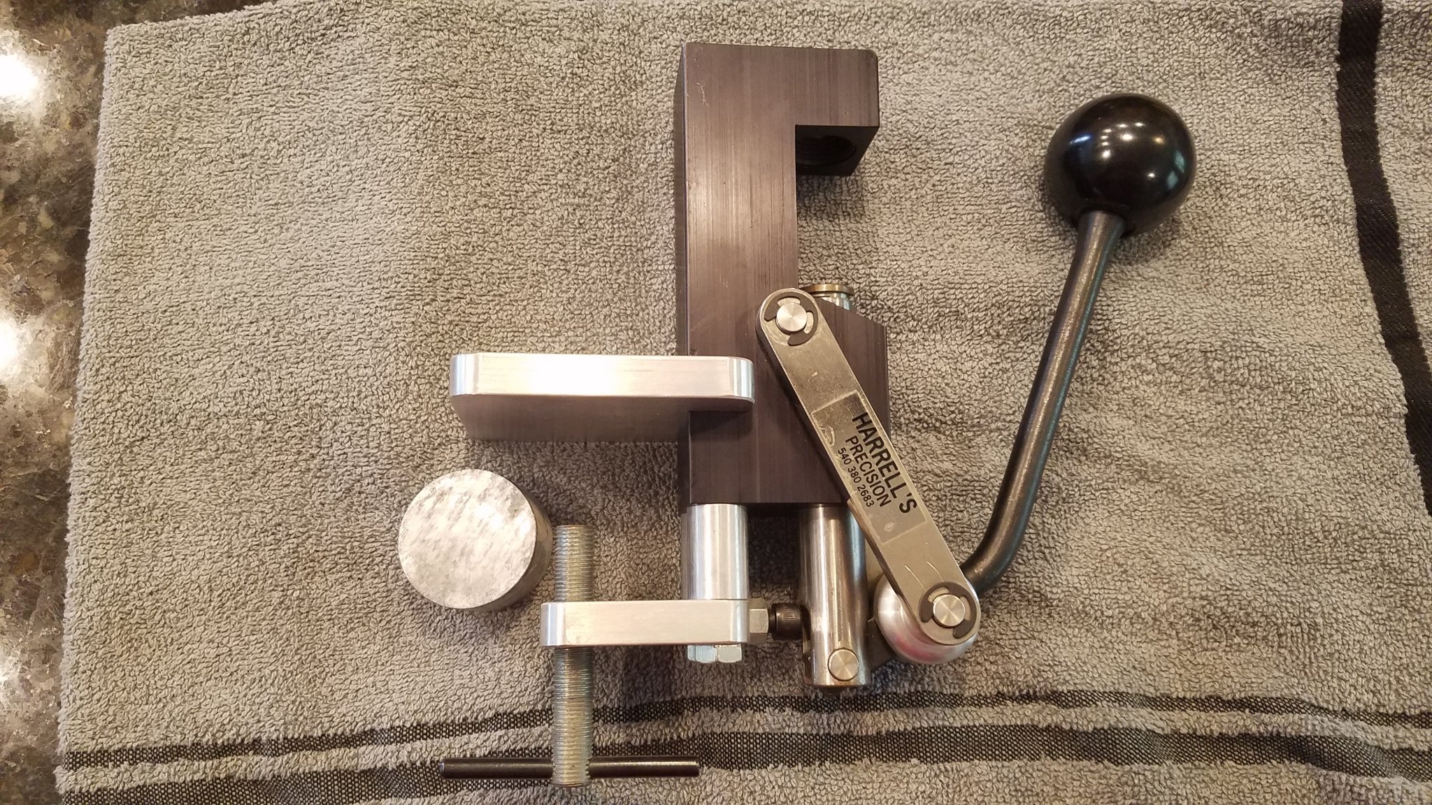

I like Harrell’s compact press.
I'd 2nd the little Harrell's compact press.
It's built for PPC/BR sized cases.

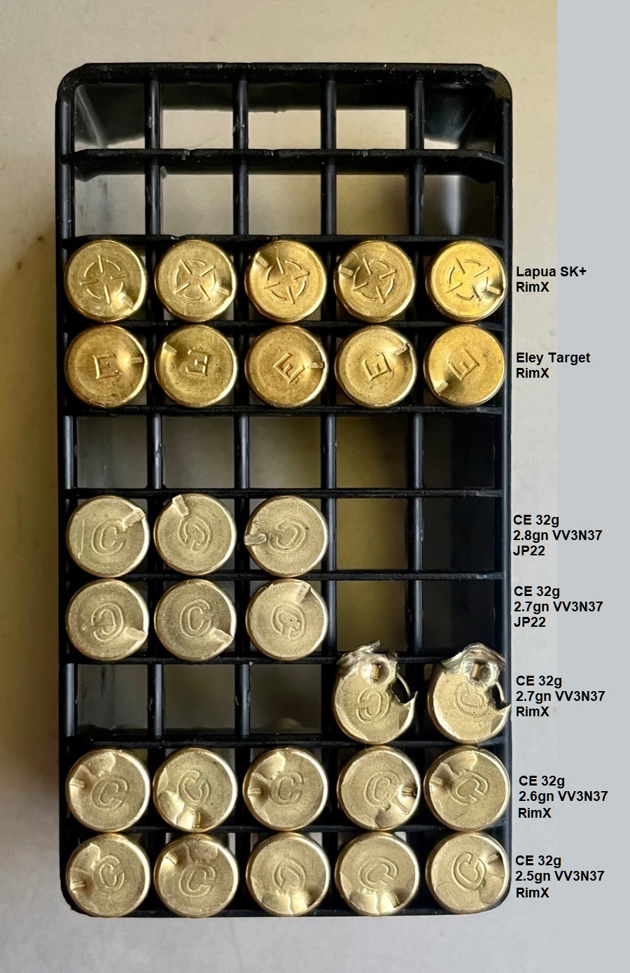

Here are some results from my first attempt at loads for the 32gn CE bullets.
The gun I am loading for is a RimX action with a Bartlein barrel, match Eachus chamber done by Keystone. As noted previously, this is a tight chamber and I cannot throw the bolt with the brass as provided because the bullet jams hard. In order to get it to work, I trimmed the brass to .588 +/- .001. At that length, the bullets still jam but allow the bolt to close without undue force.
I started with VV3N37, loads ranging from 2.5gn to 2.8gn in .1 gn increments.
I was not able to get velocity readings with my LabRadar, so unfortunately I lost some valuable data. I do think that the CE rounds were super sonic due to the change in sound.
The 5 round group from the 2.5 gn load was .75 MOA, measured .38" with OnTarget (50yards).
The group for 2.6gn was 1.2 MOA, measured .61 with OnTarget.
The brass showed pressure signs for both 2.5 and 2.6gn, with the base expanding into the unsupported area; the brass ruptured at 2.7gn. In retrospect I should have started at a lower charge (maybe the 2.1gn recommended by CE), especially since I knew I had a tight chamber and was jamming the bullets. The 2.7gn and 2.8gn loads fired fine in my JP22, which has a much looser/longer chamber, and the brass did not show pressure signs.
Overall, I think this shows a lot of promise, although I really wish I had gotten some velocity data. I want to use the 32gn bullet for hunting, and if I am able to consistently get .75 MOA I will be very happy with it, that would be an order of magnitude better than any commercial lead-free 22 ammo. But there is a lot more development that I need to do, and I still have a lot to learn about loading for .22LR.
What are the bore and groove diameters of your barrel?
The bulge is at an area where there is no support in the RimX bolt, there is an open spot right below the tensioner. This is my first venture into rimfire loading; I'm not sure what that says about the pressure other than that it is clearly more than a round that does not show any bulge at all (and I have not seen that with commercial ammo, although I have not shot any high velocity ammo). If I remember, I will run some mini mag rounds through and see if the CCI brass with a higher velocity commercial round looks any different.
