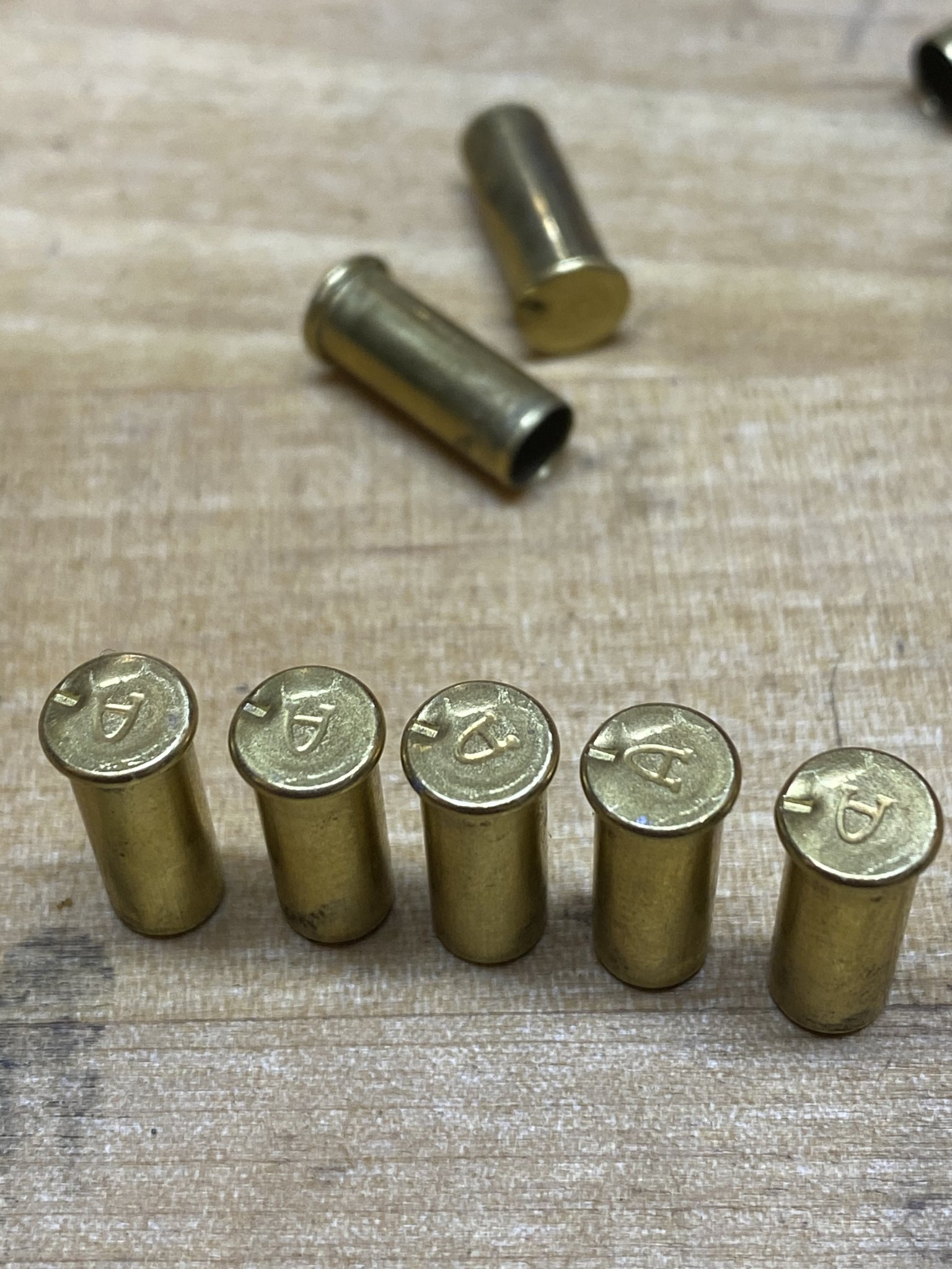

How do the cases look at 1514 ?
If you look at the picture I posted in post #147 for 2.5gn load, it’s pretty much the same as that. For this last round, I cleaned the barrel and did not foul with lead bullets. I think it may have lowered the pressure slightly, but from 2.3 to 2.5 there are definitely pressure signs. This is with 3N37; I think I may try Longshot next.

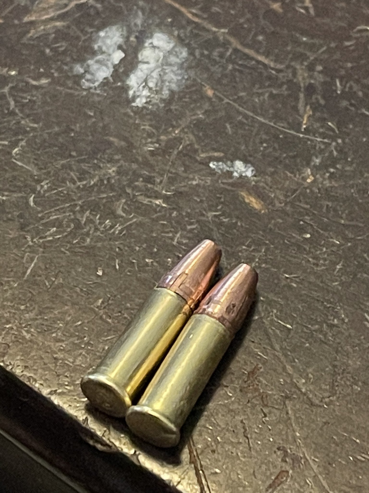

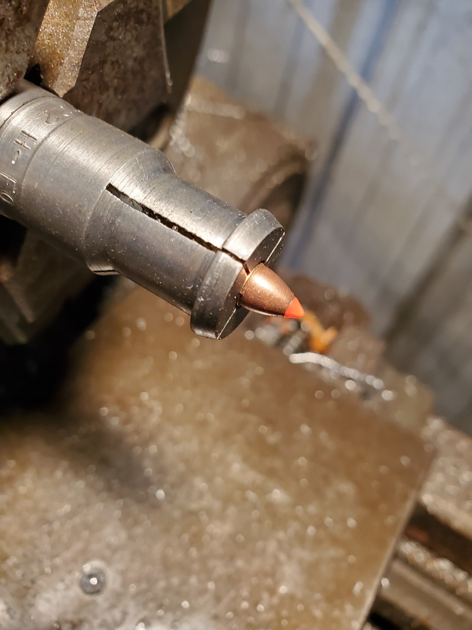

The crimp die just doesn't work or doesn't seem to make a difference in this instance ?
A friend of mine and I were scheming on tweaking 22 mag ammo and we ended up just crimping factory ammo. He came up with a custom shell holder to go with a lee factory crimp die originally intended for 22 hornet.
It worked out better than we thought it would so I tried it on long rifle stuff. I got good results with the high velocity ammo but sv/subsonic ammo either got worse or had no effect at all. High velocity showed improvement every time.

If I put bare brass in the crimp die, it definitely crimps. If I put loaded case in with a bullet that is loose enough to move by hand and try to crimp it, I can’t tell that it makes any difference. I think the copper is hard enough that the crimp is ineffective.
Reactions: Geno C. and XP1K

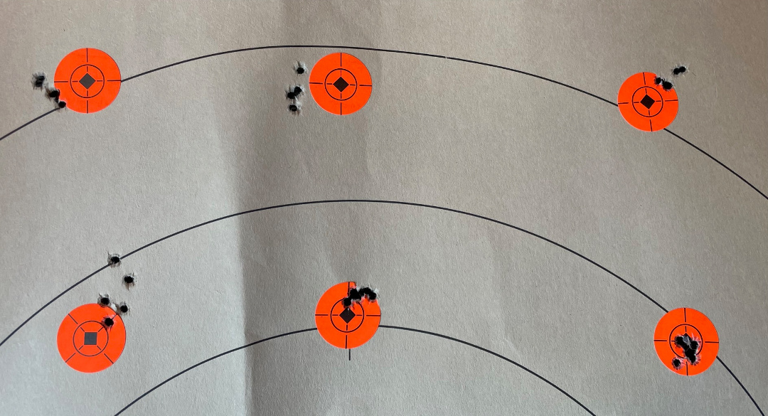

Here are 5 different loads at 50 yards on a windy day. Top left and bottom right are the same load; other than that, loads increase from left to right, top to bottom). 5 shot groups from a hard bench with bag and bipod. Group sizes ranged from .7 MOA to 1.8MOA, average velocities from 1380 to 1670, SDs from 11 to 21. The SDs were slightly better on average than what I was seeing without HBN, but at this point I have not shot enough to know whether that is random variation or a real benefit of the HBN.
It will be interesting to see the effect of the HBN on the heavier bullets, as I suspect it might be more significant than with the 32gn bullets. But that will wait until I have a fast twist barrel.

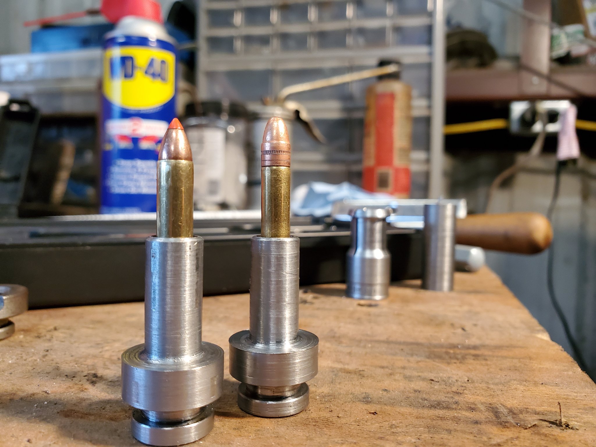

What resu did you have with crimping 22 mag factory rounds? Guy in Australia did that, observed significant velocity increase, SD decrease. Also, you modified a 22 hornet die for the crimping?
I started at .001" and crimped up to .006" I think. Where it worked best for me was .004"
I noticed the same things as the guy in Australia. Increase in velocity, and decrease in sd. Most of my testing was with the hornady 33gr vmax load in a fedderson barreled 10/22 magnum. At .004" crimp it shot consistently in the .003" range at 50 yards. That was good enough for me so I crimped the remainder of that lot and really haven't messed with it anymore.
And yes, I used a standard lee 22 hornet factory rimp die with a custom shell holder I made. Basically just elevates the 22mag round to the correct location to be crimped. I used to have a pic of the results but I guess I deleted it. There was a substantial increase in velocity. Worth the trouble for me.
