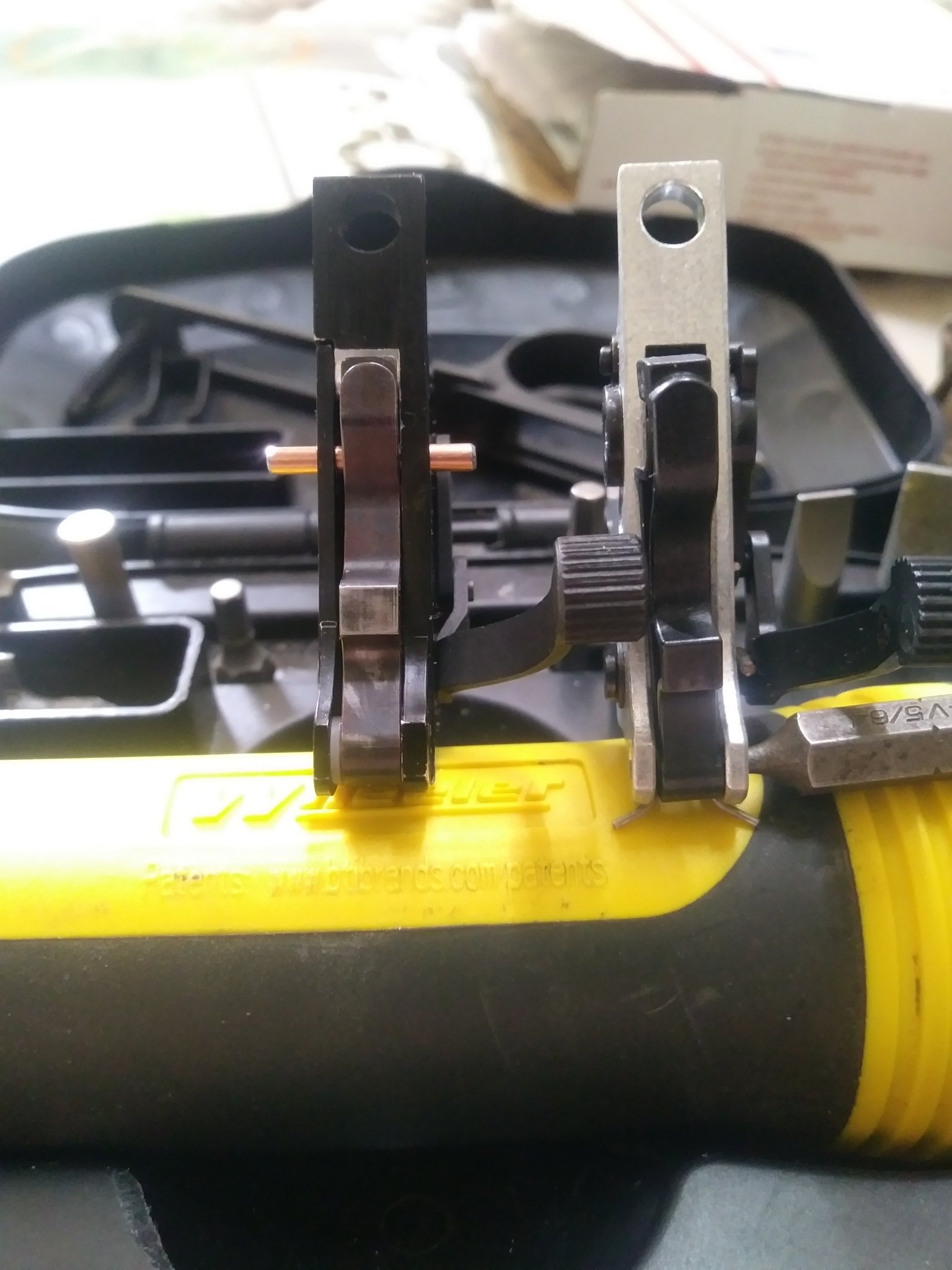

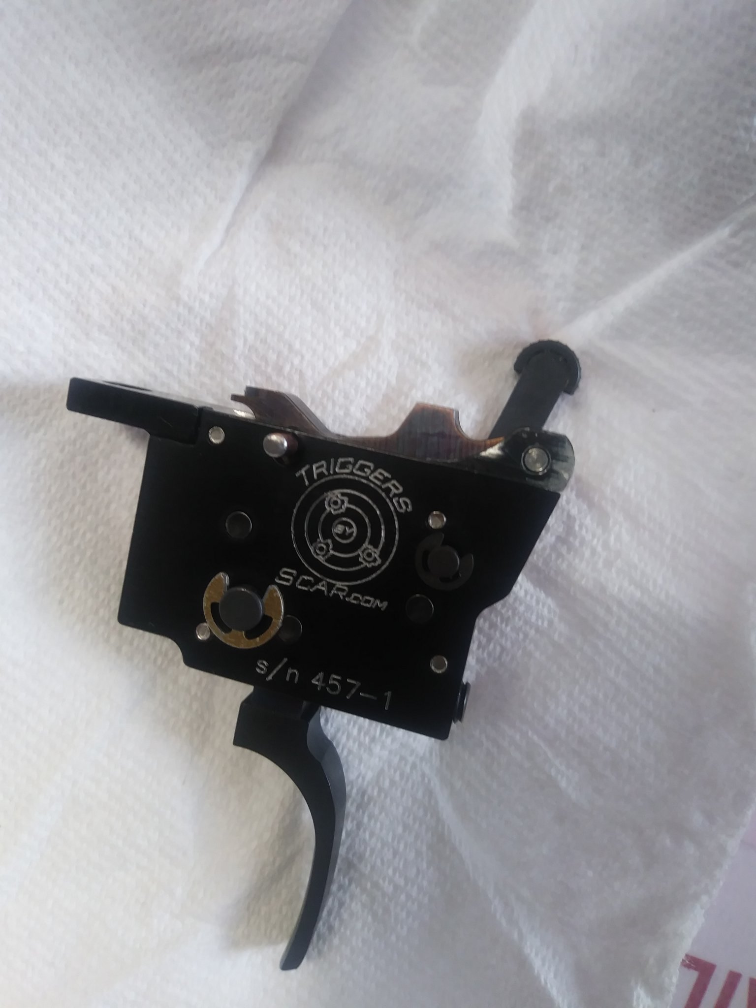

Well... Wait no longer. Bscar (Bill Scaramuzzo) has come through for us! He sent me the pictured trigger a week ago so that I could put it through it's paces.
All I can say is WOW! Bill has done it again! It's every bit as nice of a trigger as the one that he designed and sells for the 455.
The trigger arrived preset at 6 and 12 oz, per my request. The first stage is smooth, and then you hit the 2nd stage wall. There is no mistaking the wall, it is very definite. Then apply a little more pressure and "the glass breaks". The break is very crisp and clean.

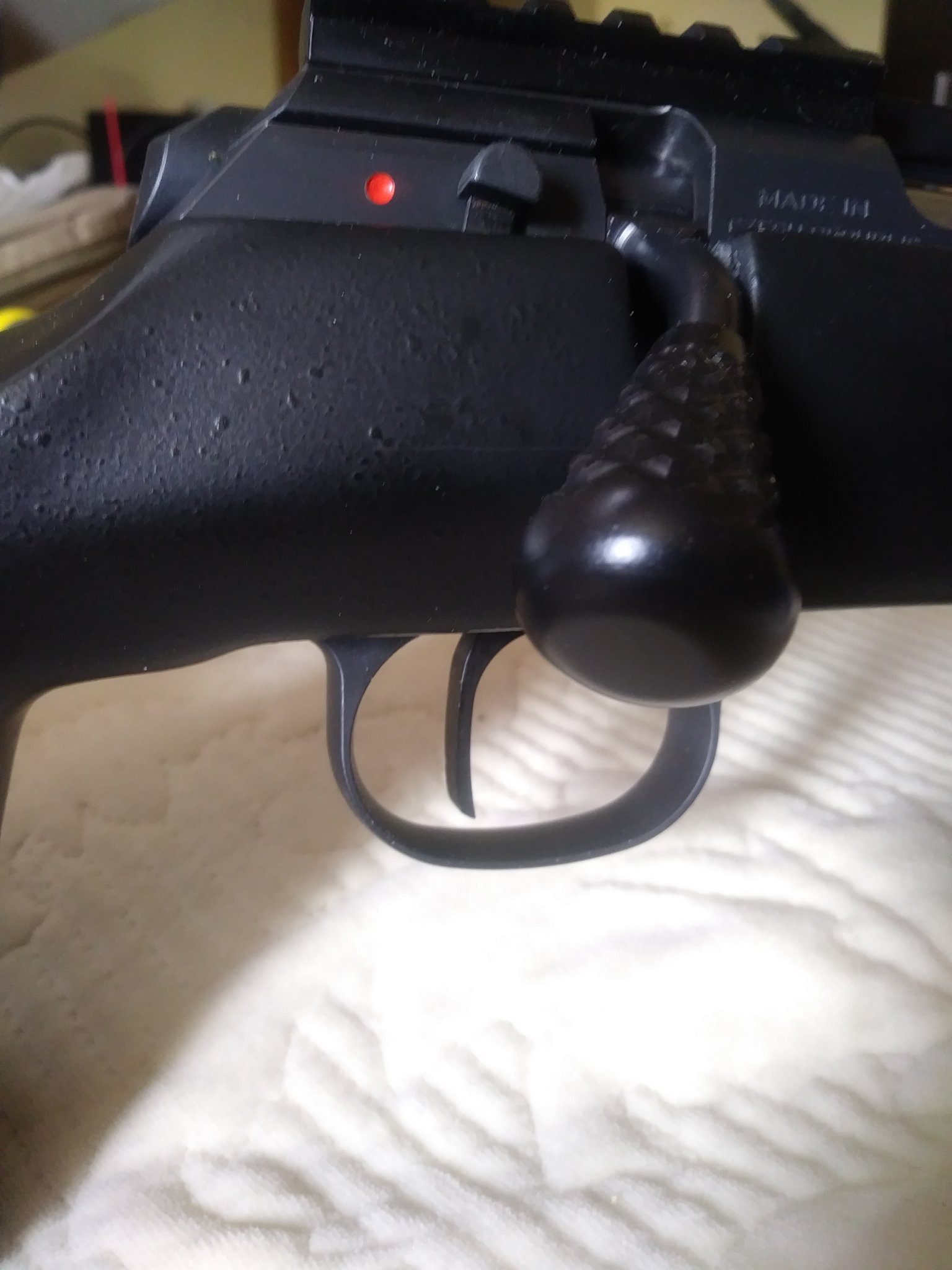

One of my biggest complaints with the stock CZ trigger is the trigger blade profile. The cross section is "D" shaped and the front part that my finger engages is smooth and round. It's proved to be a bad combo in matches. Especially with bullet lube on my finger. This trigger is much flatter and I can get a much better and consistent purchase with my finger pad.
Bill is trying to gauge interest, so make sure to let him know via this thread or PM.
All I can say is that I have mine and the stock trigger isn't going back on...EVER! This one got installed on my test rifle. Now I need one for my match rifle!
I forgot to mention how consistent the pull is... I didn't need to average. It was identical on 8 of 8 pulls measured with my cheap wheeler gauge. 👍

Bad news guys..
I've had some discussions with Bill and things aren't quite like he'd like them to be before he starts mass producing these triggers. Here's a copy of the note that he has been replying to those who have been expressing interest...
"I want to thank you for your interest in the 457 two stage trigger.
The test trigger that you may have read about is performing very well. The trigger though has some manufacturing problems. It is extremely hard to setup and it has a very limited pull weight range.
After much thought, I have decided that I will not be offering this trigger as it is today. Even though it is performing well, it does not live up to my expectations.
I will continue to work on a design that I can feel good about.
Thanks for your support,
Bill"
