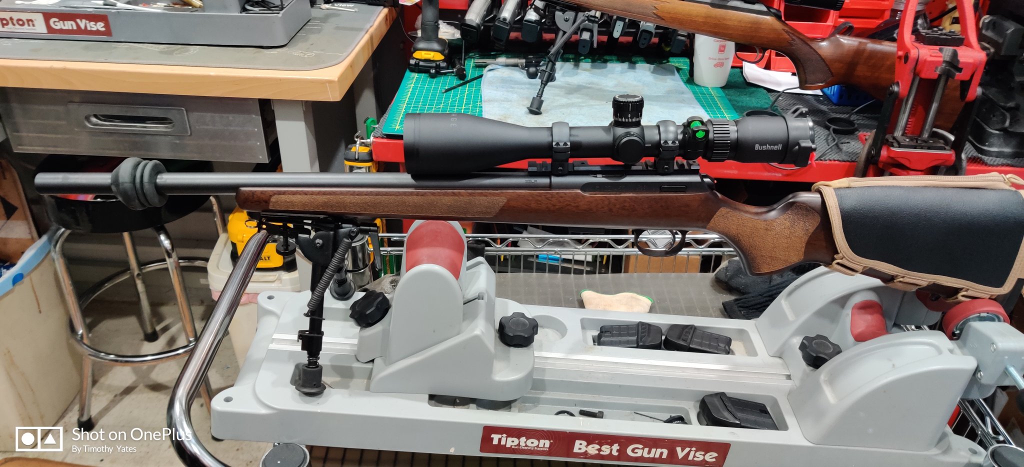

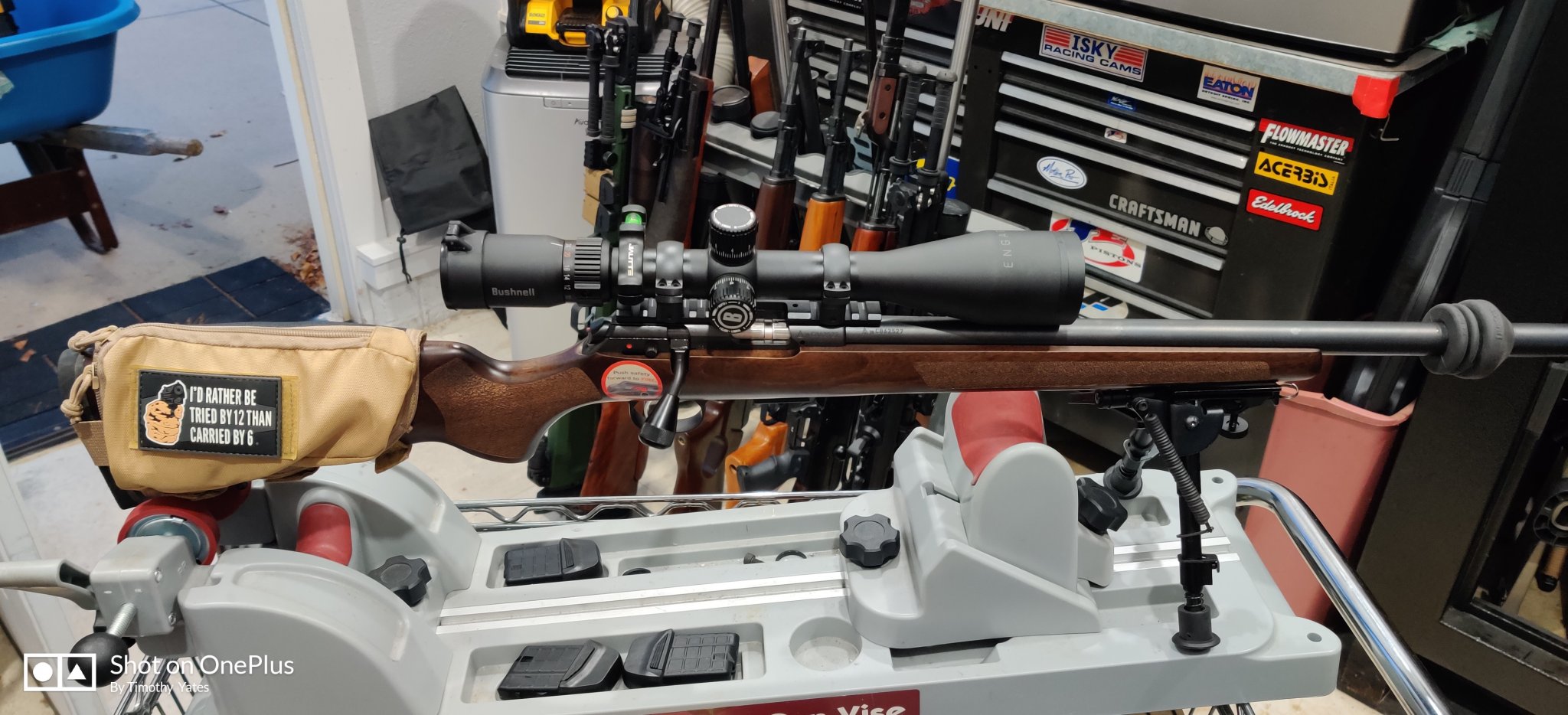

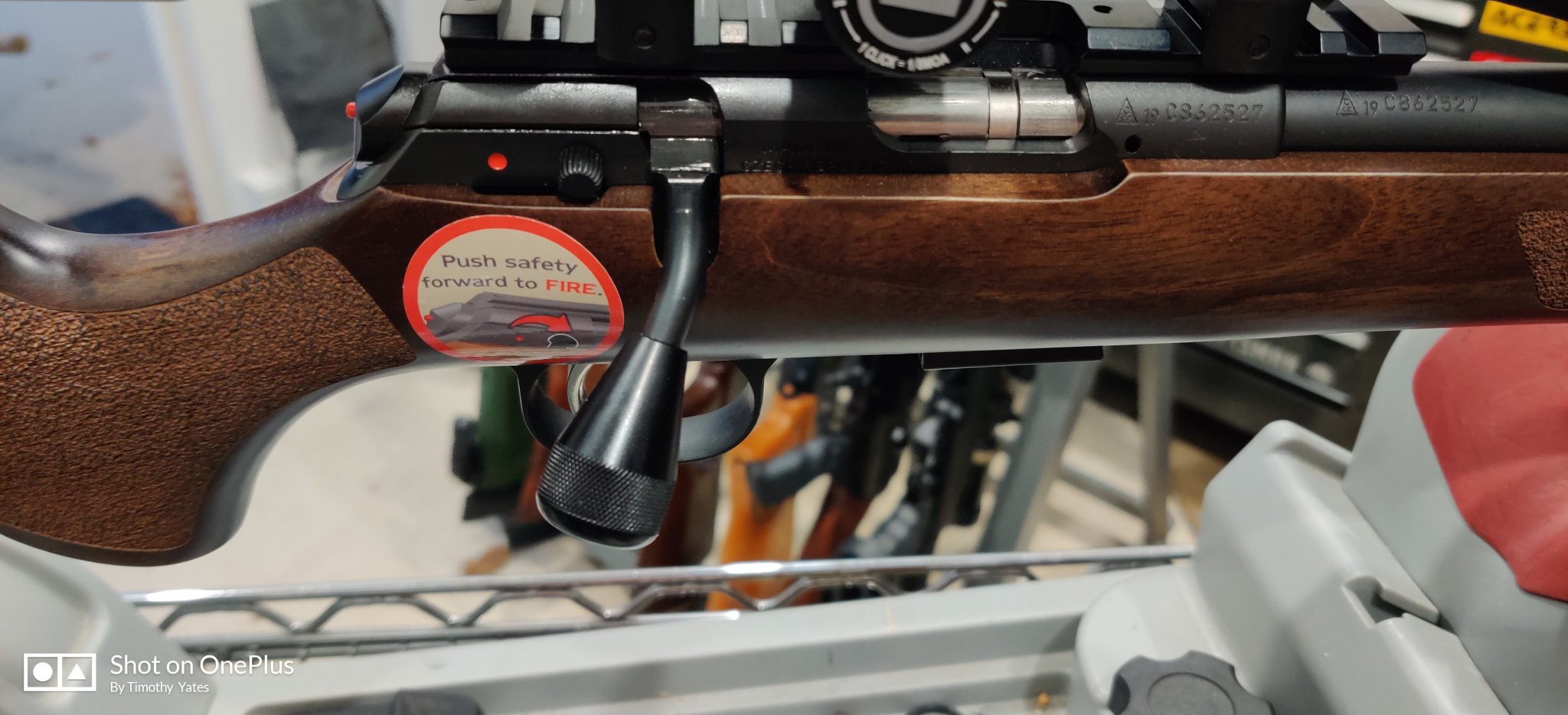

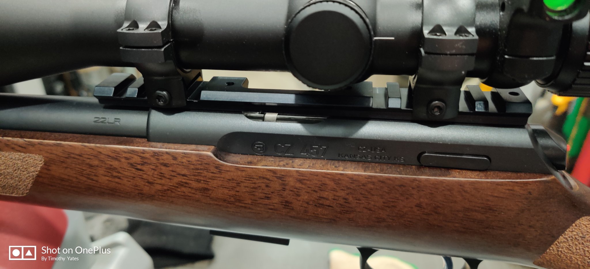

457 receivers are drilled and tapped for the scope base, 455 are not. You may be able to use a 455 base on a 457 but why would you want to. I have a friend whos 455 base works on his Tikka T1x. 0 MOA or 20 MOA would work fine at 100 yards. Here are some photos of my 457 Varmint showing the DIP scope base and a DIP bolt knob.
IMG_20191006_191500.jpgIMG_20191006_191527.jpgIMG_20191006_191552.jpgIMG_20191006_191621.jpg
