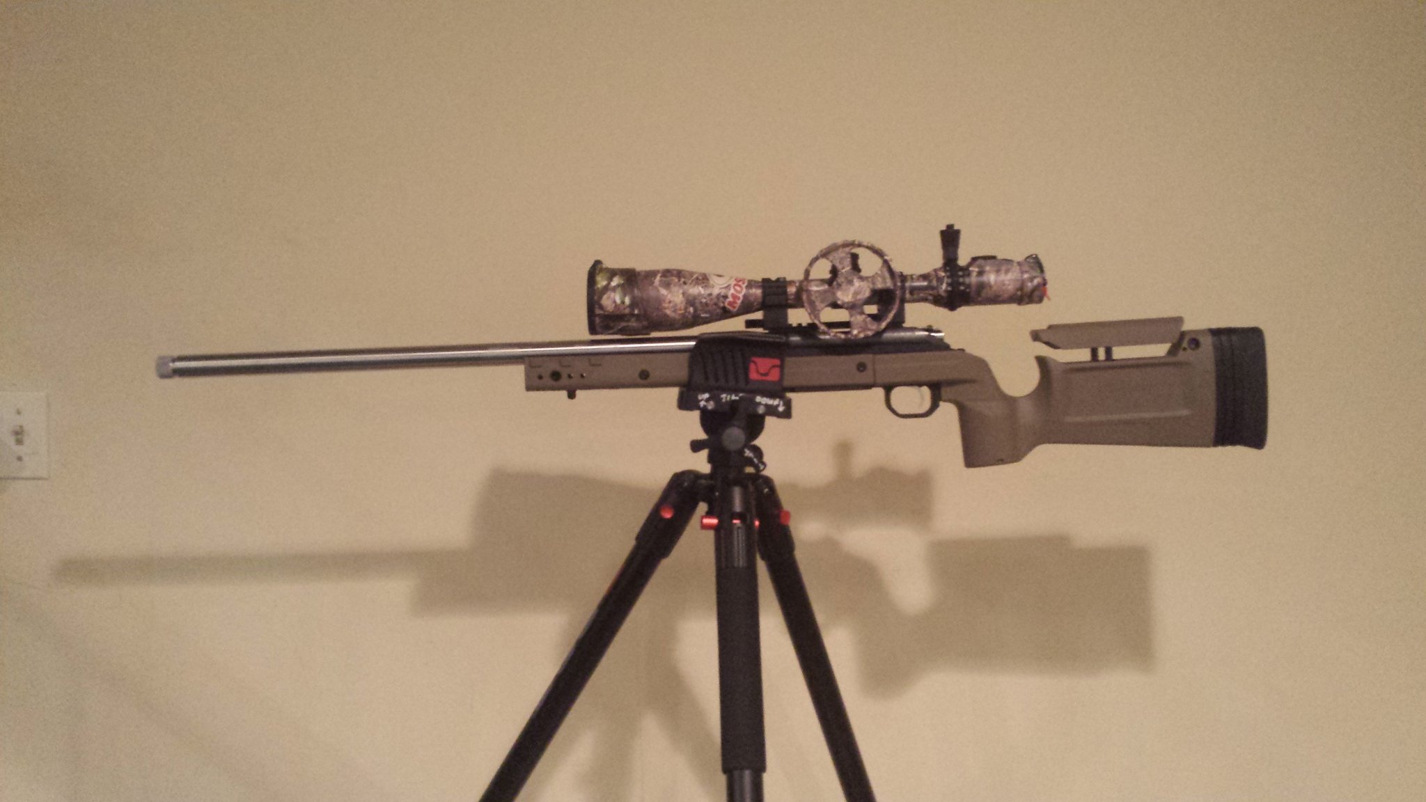

My VPT and Custom Lilja 3g w/ lilja chamber CZ455 + Firefly trigger 1st stage 8oz./2nd 8oz.

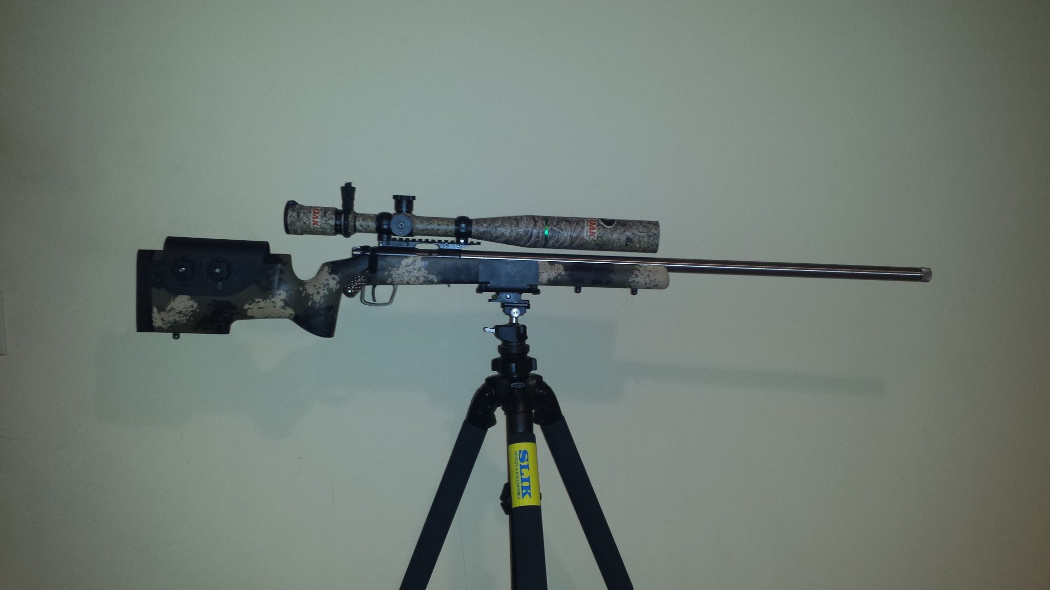

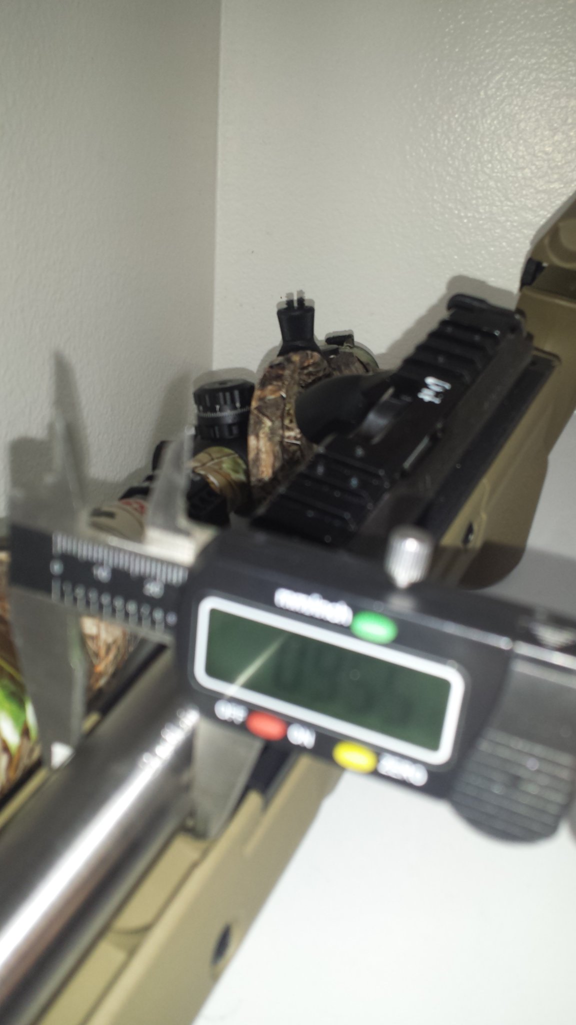

Here is my other CZ455 bartlein custom .950 OD straight barrel 5r/16t SS bart chamber 26".Timney trigger set to 1lbs. this is the old timney setup,dip rail 25moa,high power spring installed,screws/pins ugrades to SS,aluminum dip well etc.

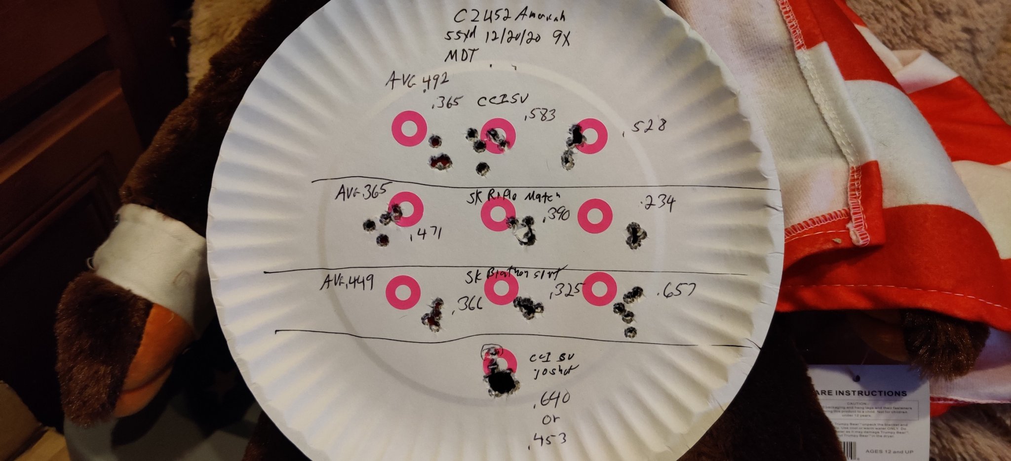

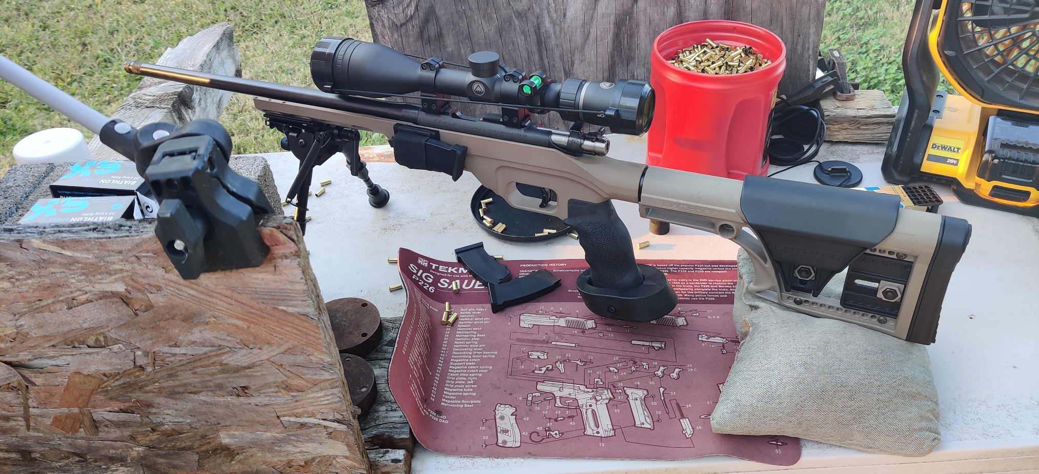

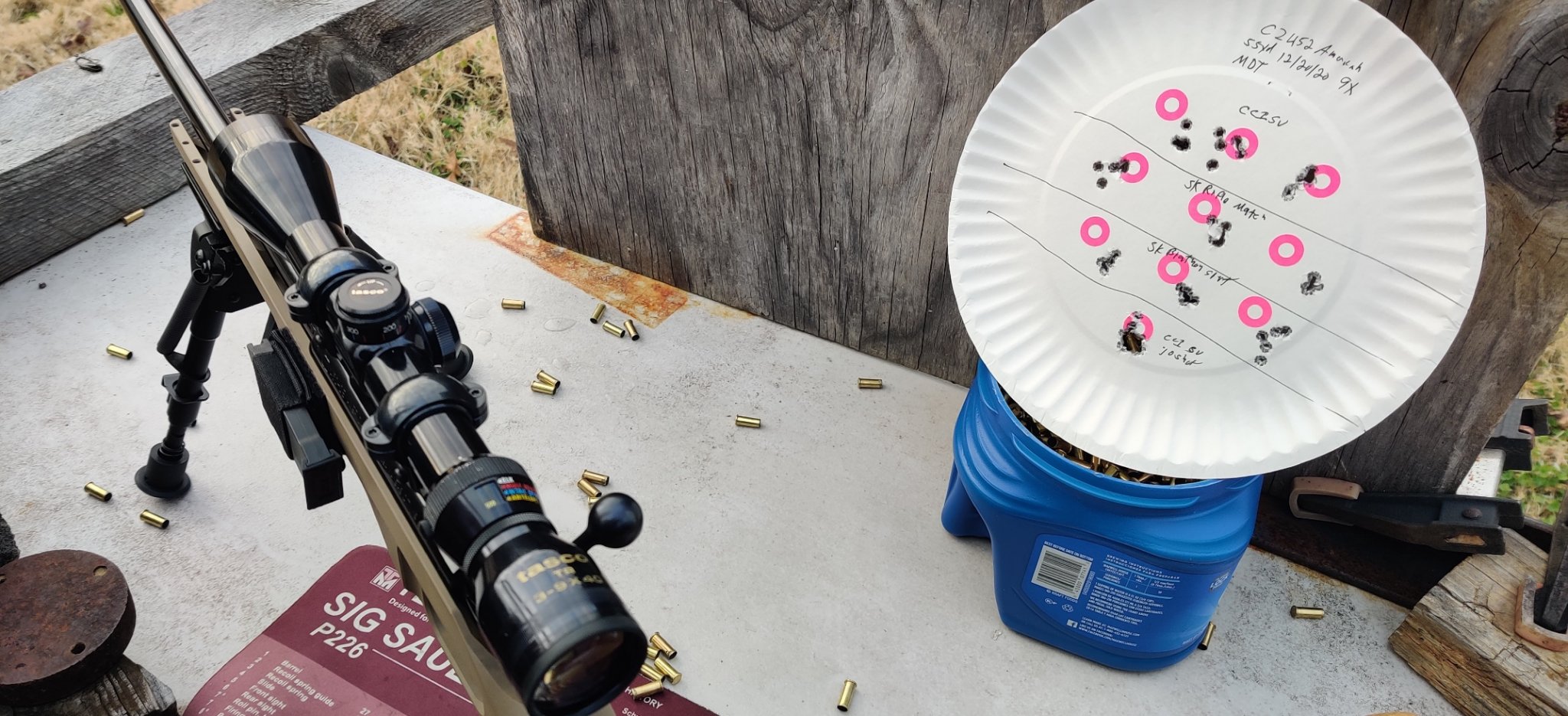

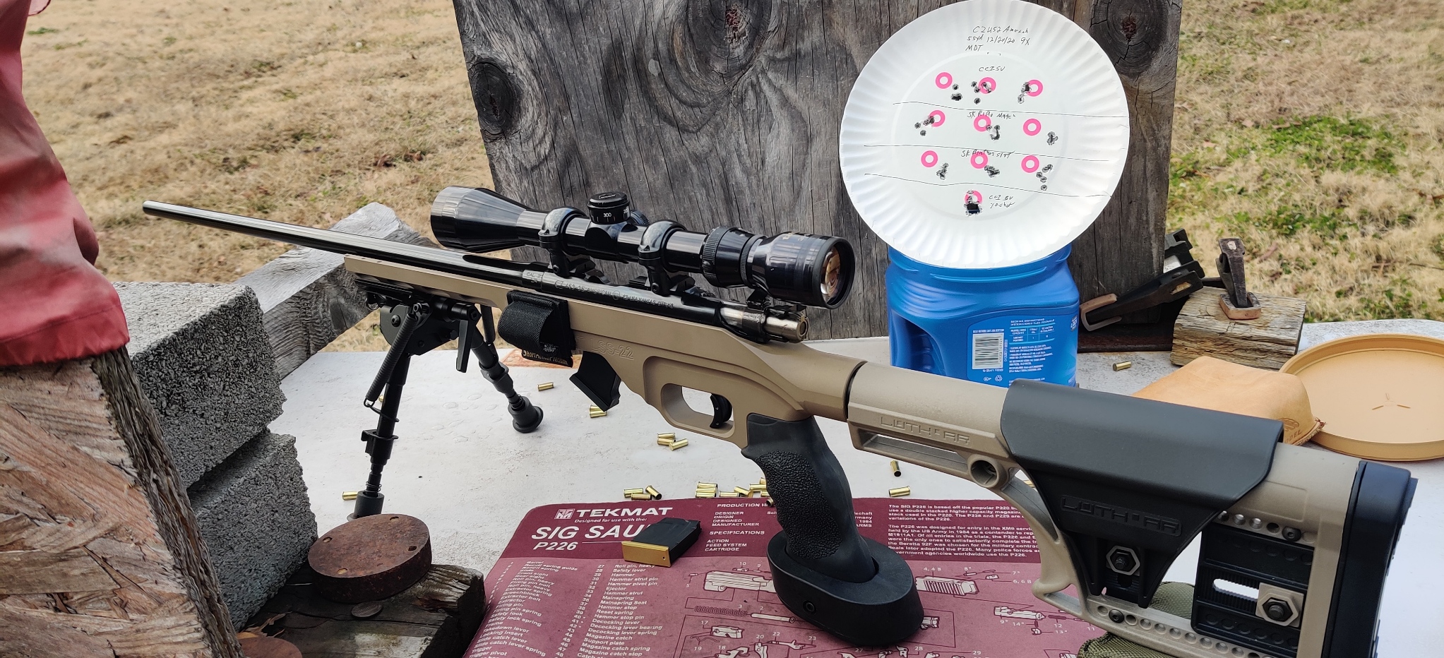

Decided to put my 452 American in the MDT. What a difference the chassis made on this one. Below target was shot with a 3-9x 20 year old Tasco scope. The reticle covered up the dot. Trigger on this one is really crappy, I haven't messed with it yet. I'll probably leave this one just like it is.
View attachment 7508947View attachment 7508948View attachment 7508949
Imagine what it could do with a Yo Dave kit, higher magnification and better conditions.

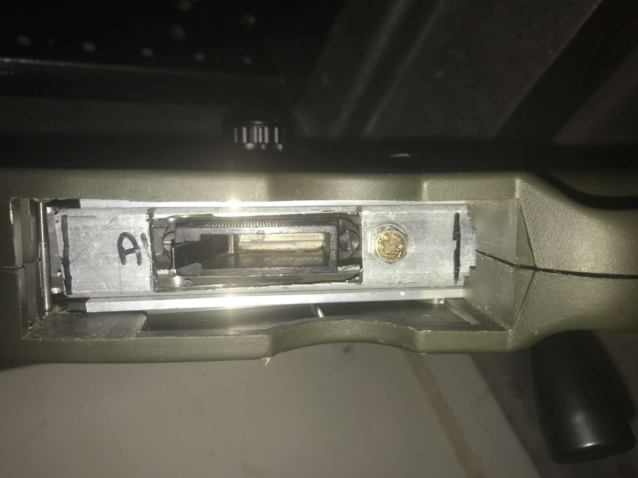

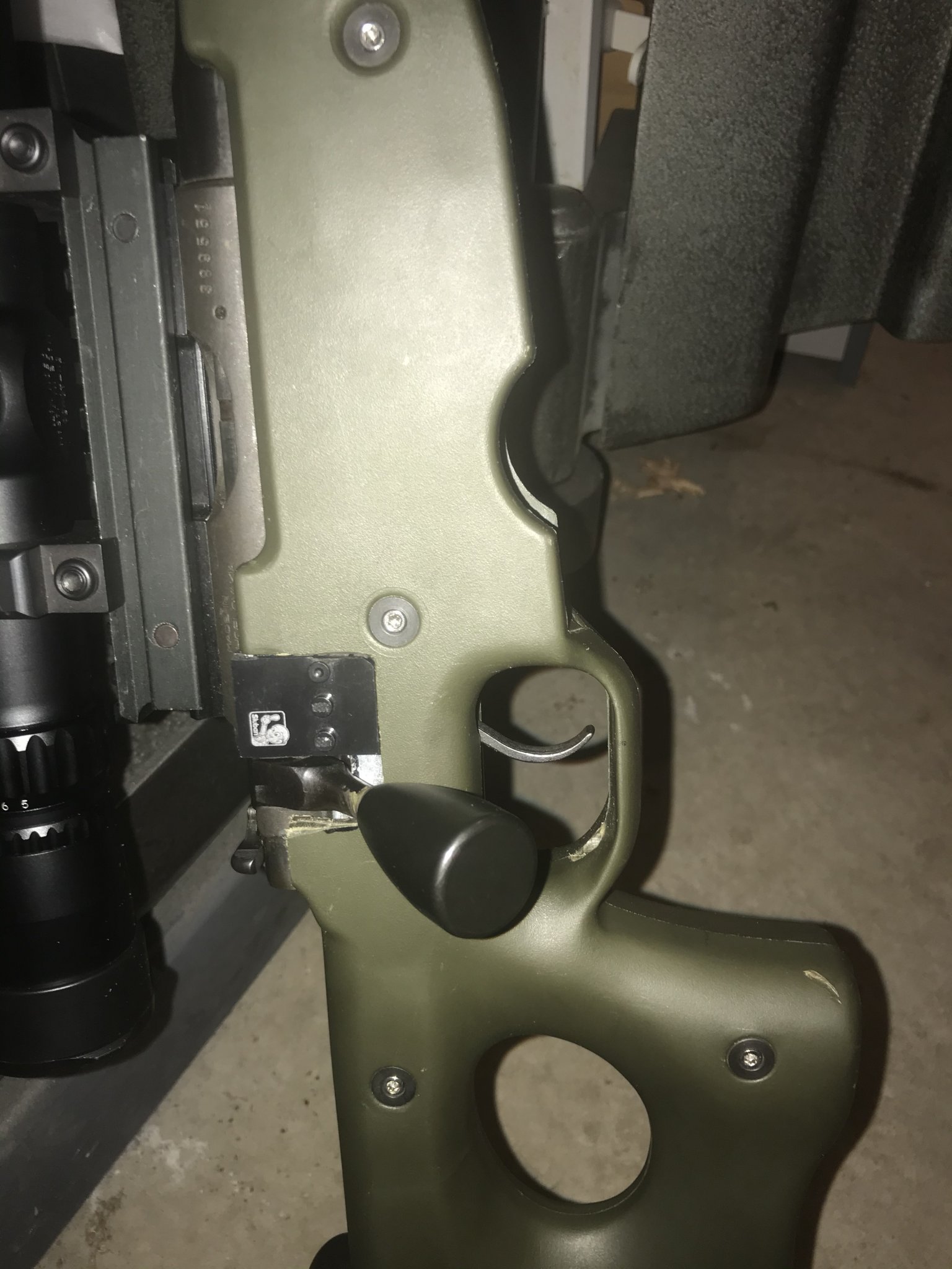

The key thing to be aware of is the barrel band and the tang are on the same level so you end up bedding metal to metal. I had a benchmark accuracy point for this project using Tenex and it met, then exceeded my requirement. I used some AICS Long Action skins that were in the spares cabinet but am now aware that the AI airsoft stock has most of the compatible furniture you would need.
If I was going to do it again, I would impose myself on someone's mill for an hour or so.
But, because of the lawyer-proof trigger, doing a nice Yo-Dave tigger adjustment is key.
Got some photos somewhere.
Reactions: goneballistic
Sadly no - and I really don't want to take those skins off again (and as version 1 the cutting is rough)! But it is 3D puzzle of making the cross bolt holes, drilling, bending a 90 deg for the recoil pad and cutting for the action footprint.
I thought I would need to fill and steel bed the action. Amazingly I did not. And all the CZ screws are M6 so the tuning became finding the right length to hold the action in place.

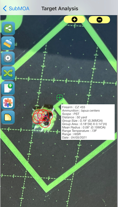

Finally got my 455 figured out. Played with the action bolt torque values and had to sand down the barrel channel a little more to float the barrel afterwards. I'd still like to get a chassis for it, but had several nice 5 round groups with this being the best. A little interpretation required to place the impacts in the right place but it's ~0.40 MOA group.

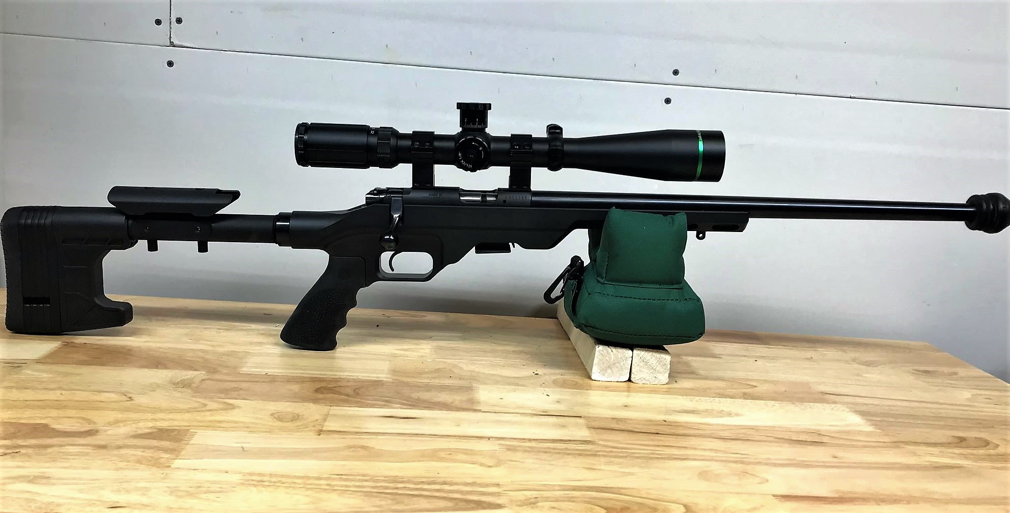

Based on some of your posts here, I checked on Optics Planet and found an MDT chassis for my CZ 452 Varmint. The barreled action dropped in perfectly. Now, waiting for a buttstock, I'm anxious to try this out because I bought an MDT action for my Anschutz 1710 and it made a big difference in accuracy.

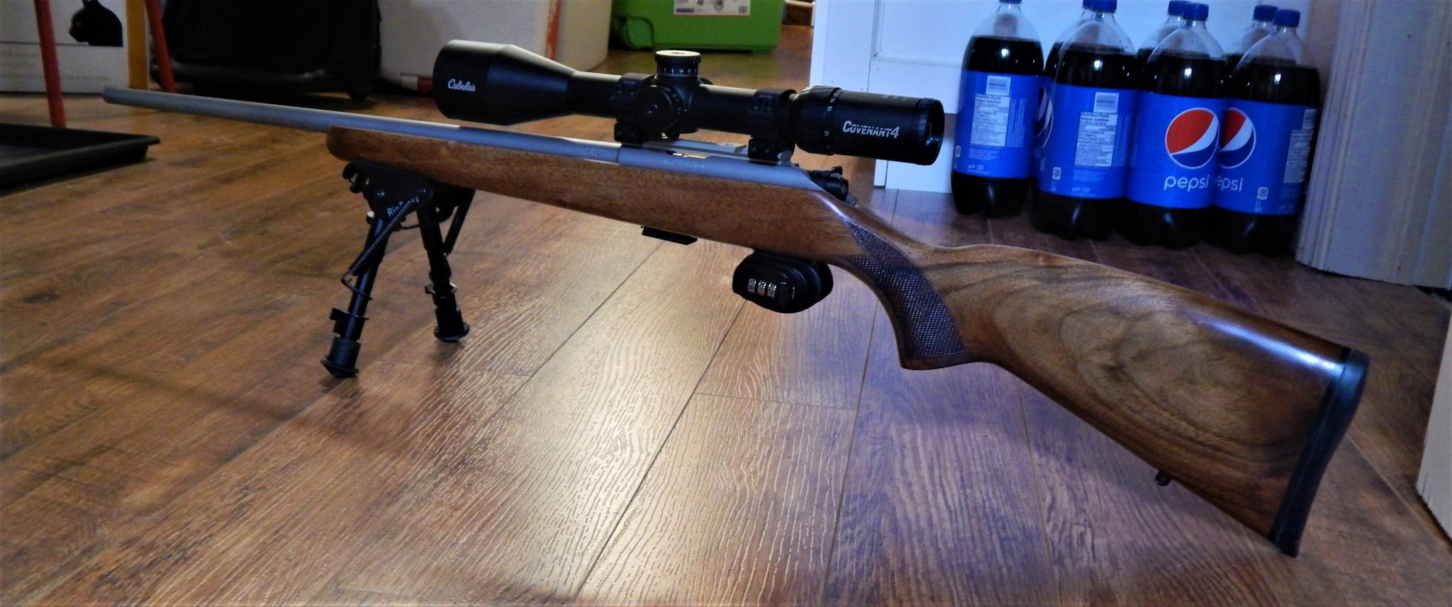

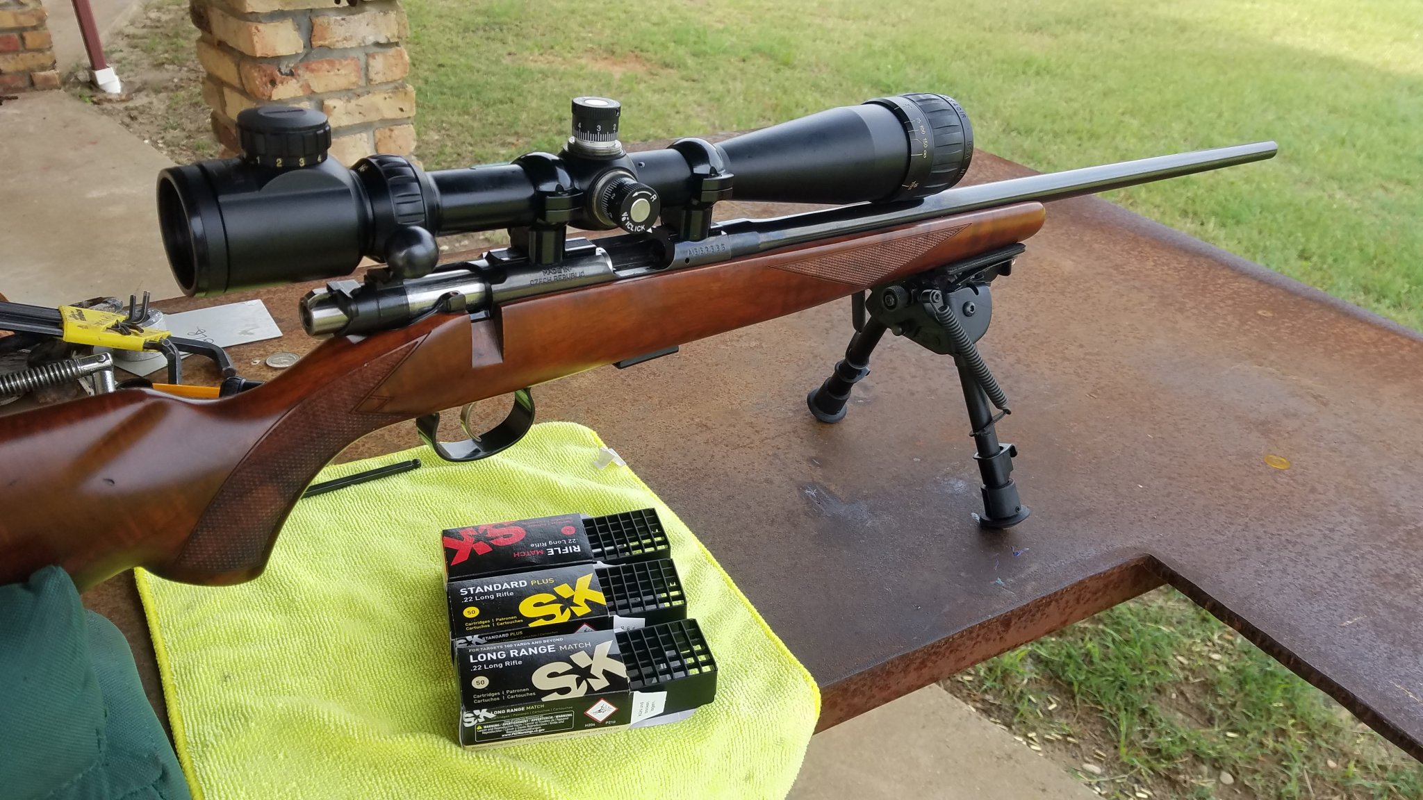

Highreview, I got a CZ455 SS Lux (2017 mfg) new2me in Feb. Only been out a couple times - east coast weather - but I got a CZ 0* rail and can mount a 50mm scope using Vortex Pro Low rings. I have about 1/4 " clearance on the bolt and also on the barrel. The scope is a Cabelas Covenant-4 6-24x50 FFP-SF w-MOA Tree, the 4th bars are numbered allowing easy hold-over for distance or wind. Still working on consistent 1/2" @ 50, but getting them often.
