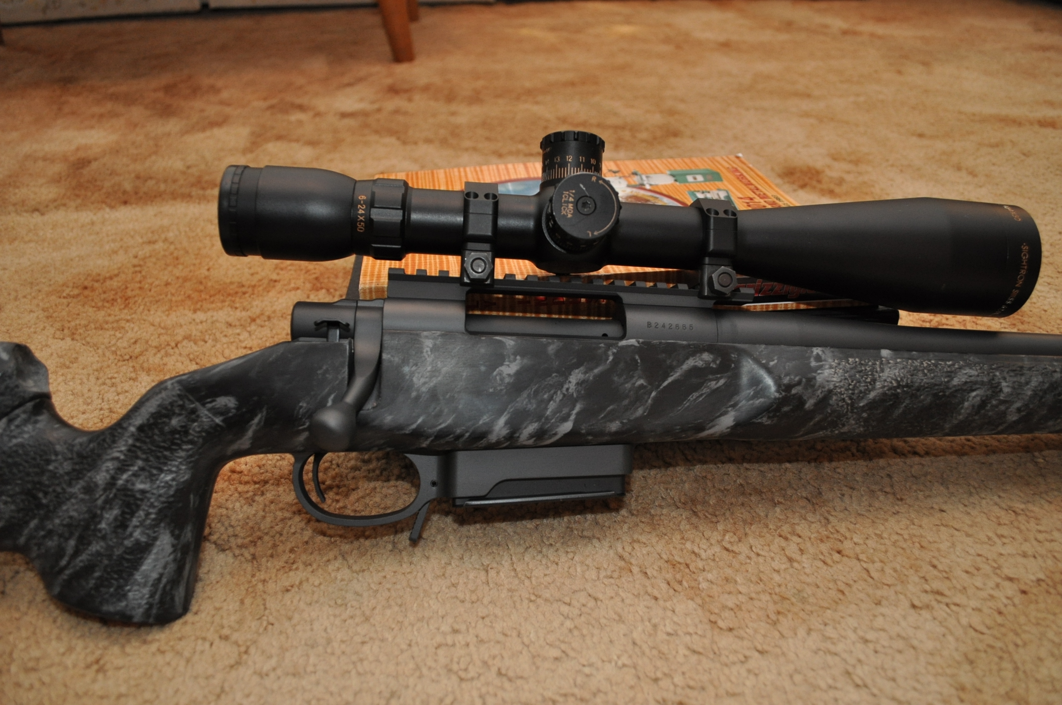

I've done a few Howas in the past; the one pictured here was one of the newer bbl'd actions with their HACT trigger. I didn't bother to true this one, as several of their short actions I'd dialed-in in the past hadn't had enough run-out on the receiver face to justify the time & effort. Instead, I fitted & chambered a 26" Krieger 1-8tw sendero contour in 260 Imp 30*, machined the projection at the rear of the mag well to allow AICS mags to seat, and bedded it into a McM A5 after adding an EGW 20 MOA sloped rail. I used a Harrell's Precision tactical brake, then CeraKoted the bbl'd action & PTG DBM in sniper gray. It's a good shooter, and feeds reliably with the AICS mags - only thing I think it needs is an extended bolt knob, as bolt lift effort is stiffer than a M700.
ETA - I've done a couple more of the latest Howa SAs since doing this one, and found that after dialing them in in my action trueing fixture they had 2-3 thou runout on the receiver face. Went ahead and trued the faces & lug seats on these, and am contemplating pulling this rifle apart to check its action for runout. However, it's shot so well to date that I'm not sure it's worth the time & trouble.....will have to do some shooting with it from 1000yds and compare the results with those of my Rem M700 with a Bartlein chambered for the same ctdg.
