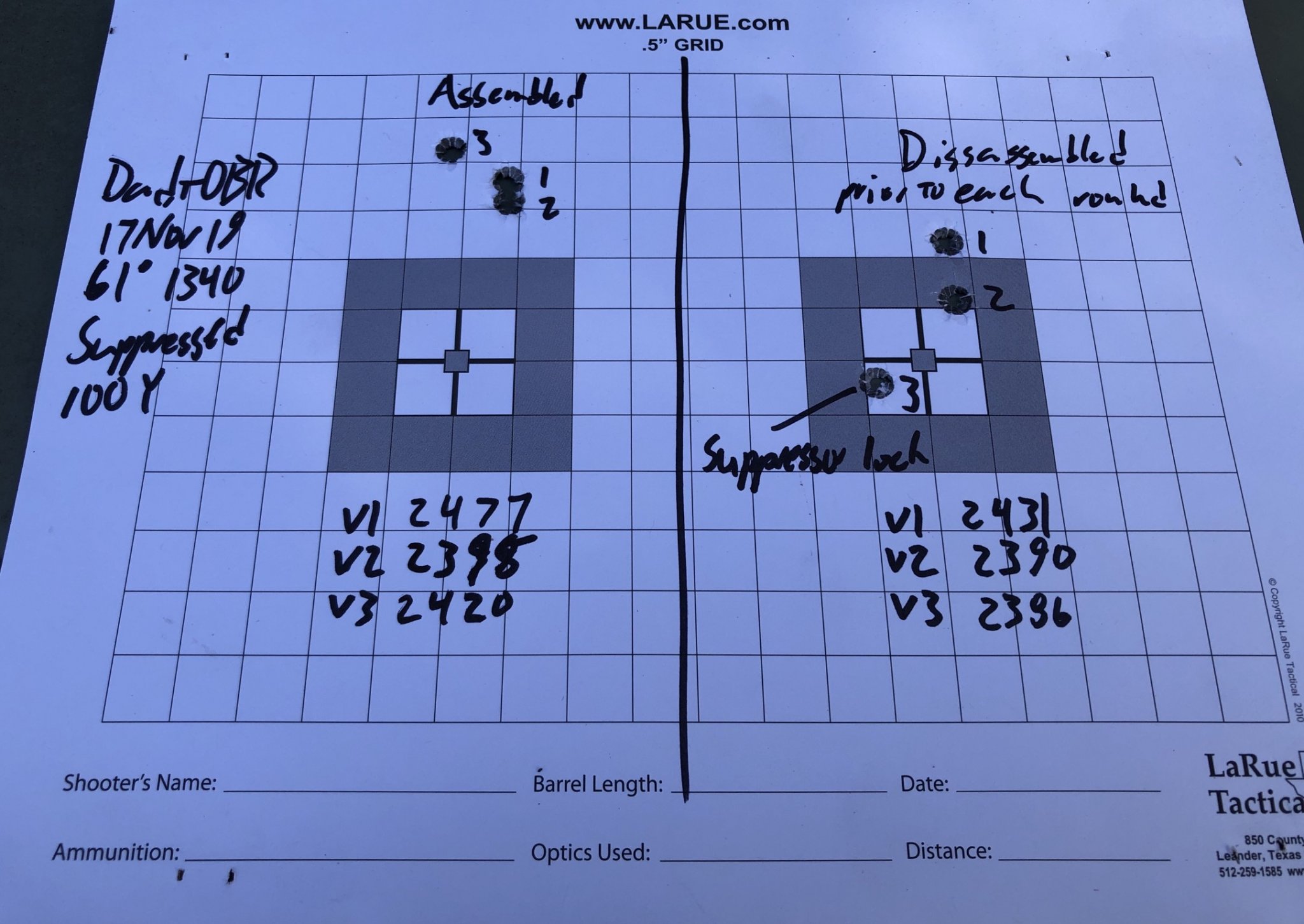

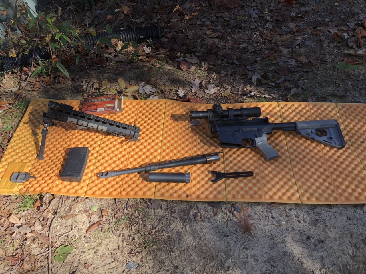

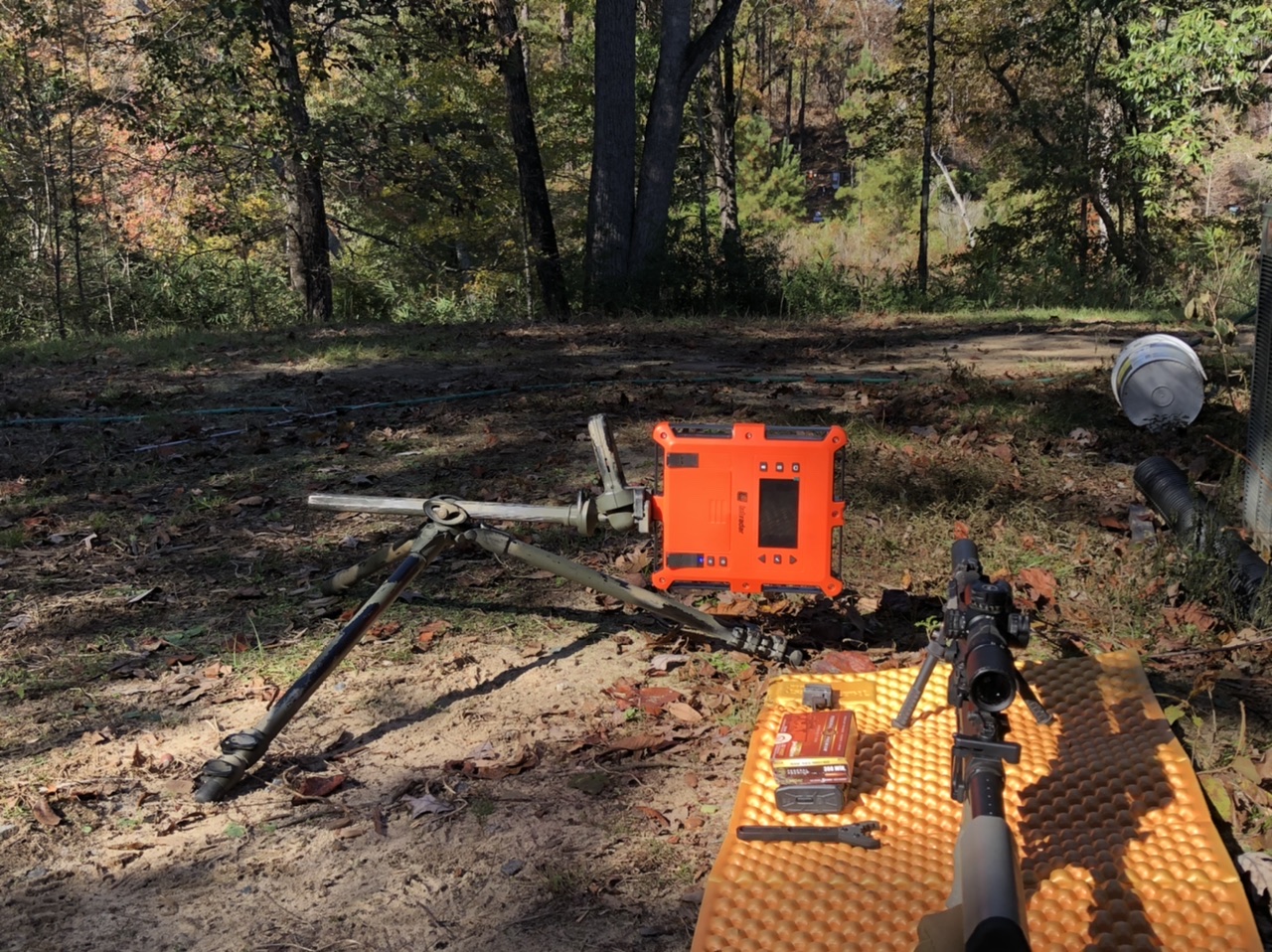

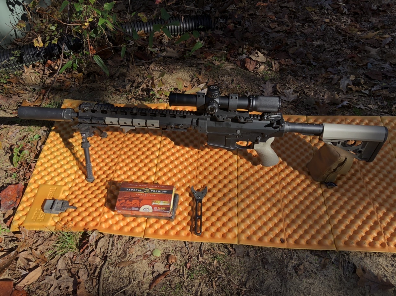

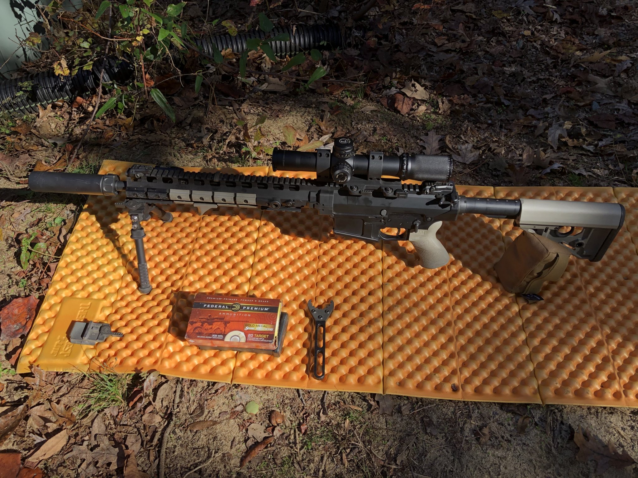

Sorry I’m late. I made a huge error in the test...can’t get the barrel off without taking the suppressor off. Third assembly I tried getting the can on three times and it had some slop, I never should have let it go but was too lazy to clean it right then...and generally I’m not a good shot so might not even be the can. Rifle is sighted in for 150m with a SF warden for hunting season so expected to shoot high-ish with a can. Groups at 100y.
Range.
Rifle set up as shot, note I broke out factory ammo for this.
Disassembly between shot 3&4, others to the same level.
Not happy with that third round on the disassembled side but too cheap to repeat it for free;-)

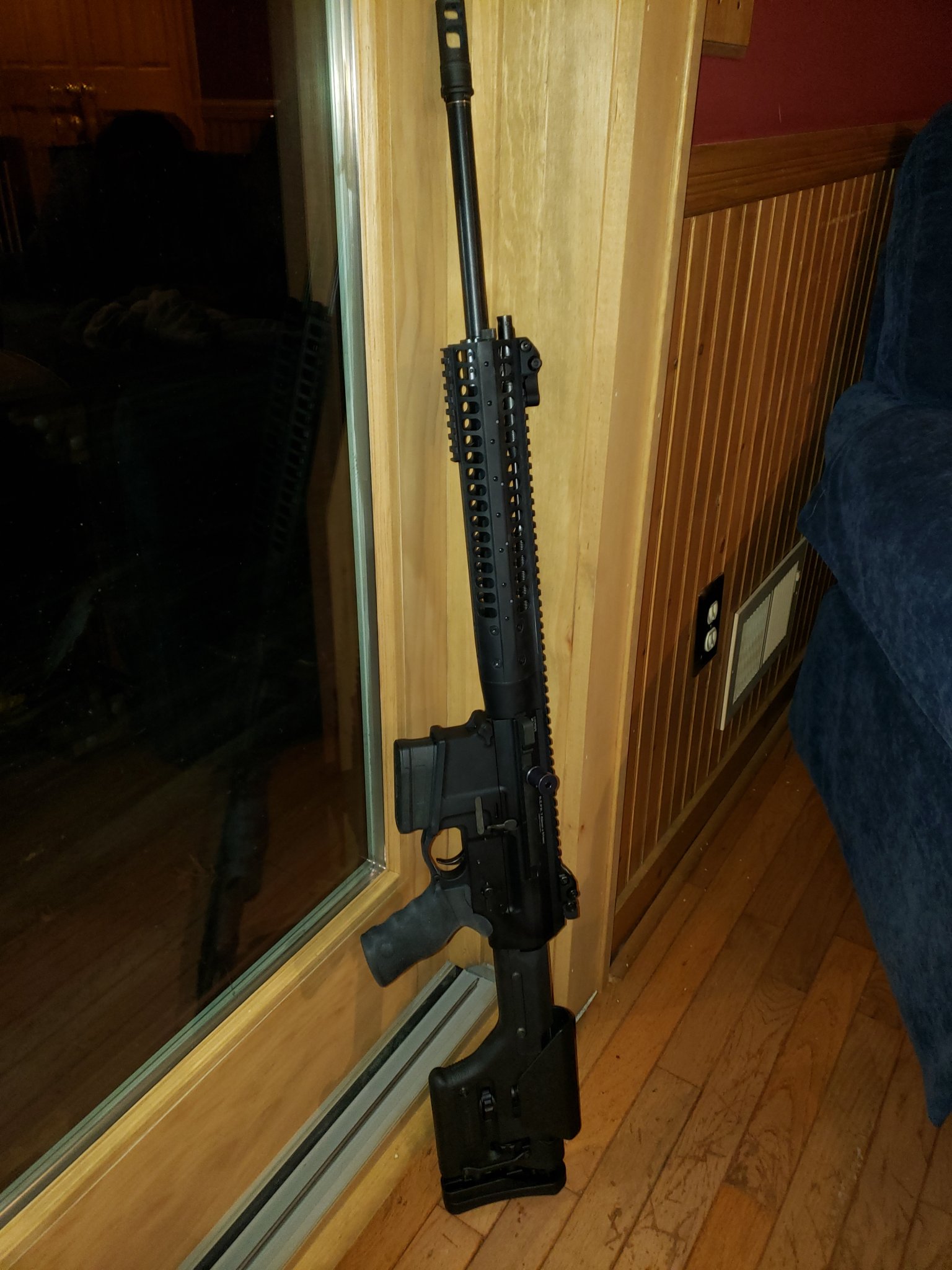

Savage msr ar10 with proof reserch carbon fiber barrel. Side charger.

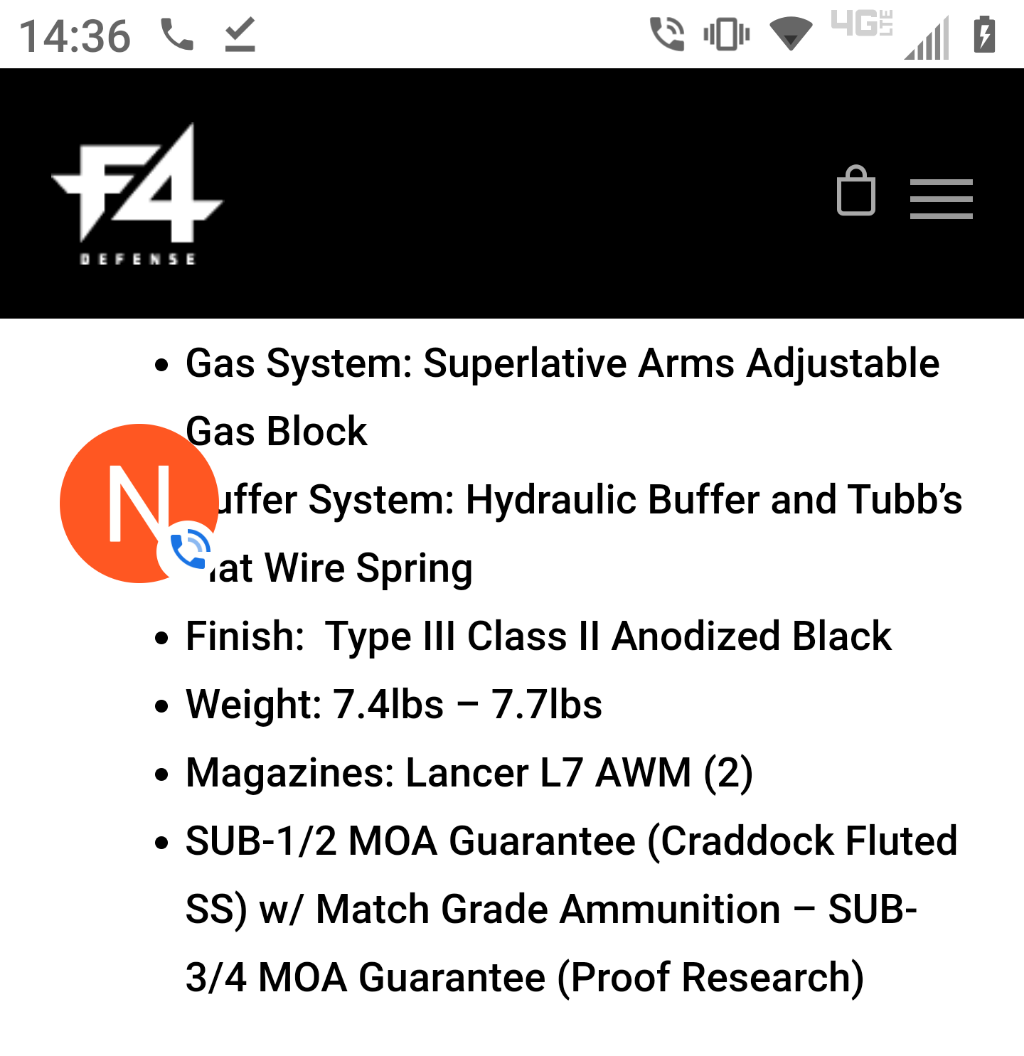

Has anyone shot one or seen a real review? Site says 1/2 MOA guaranteed...I somehow find that hard to believe, if true, that we haven’t heard about it.

That's was kinda my point, F4 isn't doing anything a knowledgeable Home Builder isn't... They're just outfitting their receivers with some of the best parts available.
Well they are doing one thing we cannot: machining their own G2-size receivers that weigh a lot less than anything we can buy (without going to the 2a Xanthos which is not very stiff) and adding their own "intermediate" sized G2 BCGs. They are an inch shorter OAL all things being equal, and also lighter (while retaining more rigidity) than anything you can build yourself in an AR10 platform.
I totally agree bigjake that the accuracy is nothing special and you could probably build the same or even better IF weight/size weren't a big concern. But if size/weight is a primary consideration, I don't really see that they have a peer in the large frame world.
I’d be a lot more impressed if they looked like they weren’t styled by teenagers. Also they should remove the forward assist.
Agreed, the forward assist should go, and their handguards could certainly look better. But function>form to me.
I shot the 308 (7.8lbs version) at a demo and liked it a lot. Will probably be buying one in the near future if I can shift some inventory. Again, I think using a Craddock Precision Bartlein and promising 1/2moa 5 shot (not 25 shot) isn't outlandish. We see those results all the time from members of this forum with those barrels.
I would think a guarantee means every group...
I don’t see many semi’s home built or otherwise consistently putting up 1/2 MOA. Yes they exist but not in a number close to expected let alone guranteeable IMHO.
