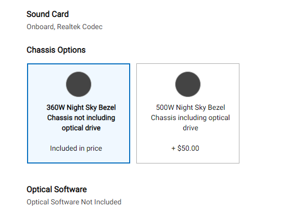

    Im on Dell’s website looking into XPS, picked i7 processor 8 core 2.9-4.8GHz, Intel uhd 630 graphics which are the base im assuming (lowest option) 1TB M.2 PCIe NVMe SSD, I cant see anywhere to choose different power supplies? 16gb memory. So hows that list look
    Near the bottom:
    Get the 500W one for sure, the 360W version will leave you short of power in a hurry.
