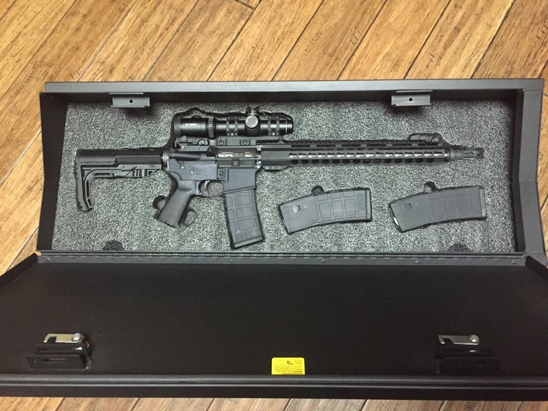

B8DF01C1-D6E9-499F-8964-64FCB1D9CB8D.jpg I did this one for a safe under my truck seat. Turned out pretty good

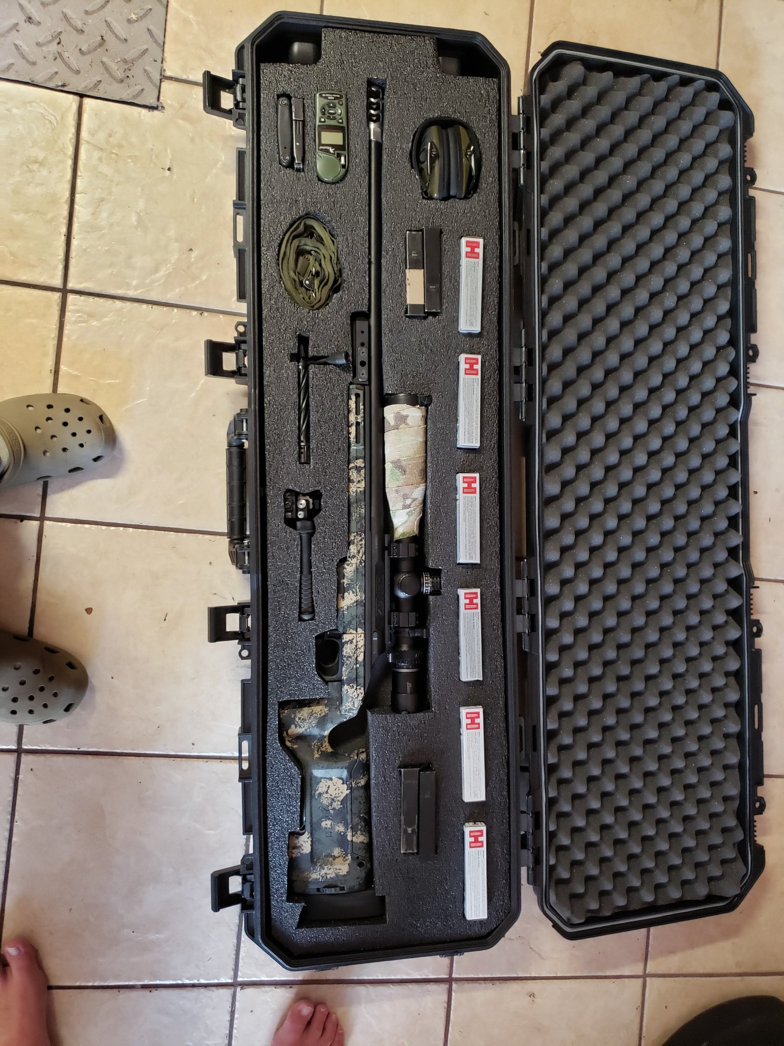

Good video. I guess the old electric knife Carver from the 80s I was using wasn't to great so I ended up using a jigsaw which yielded great results. Also used a silver washable marker so I can better see my outline. I tried to do the whole mirroring thing but my inability to cut straight down into the foam resulted in the underside looking sloppy and not form fitting around the edges.
