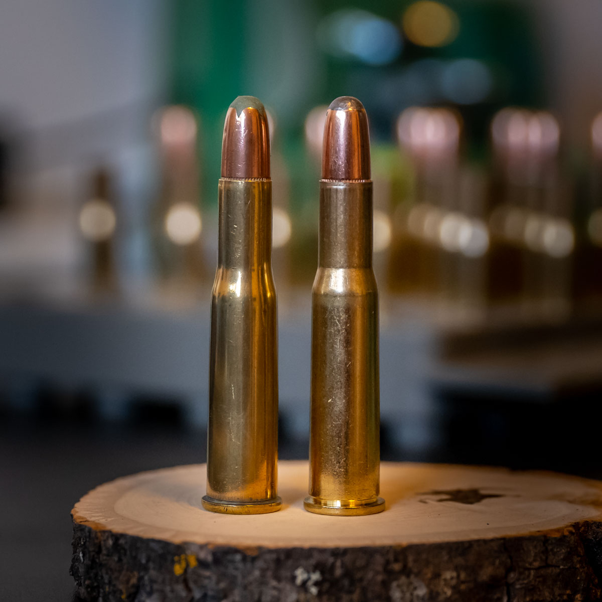

I have recently completed my conservation and refurbishment project on my father's 1920's 303 Savage. Restoration and background story.
I have about 100 rounds of 303 in various condition. I have the reloading dies for the caliber. I'd like to "complete" the project my firing it and examine the legendary accuracy.

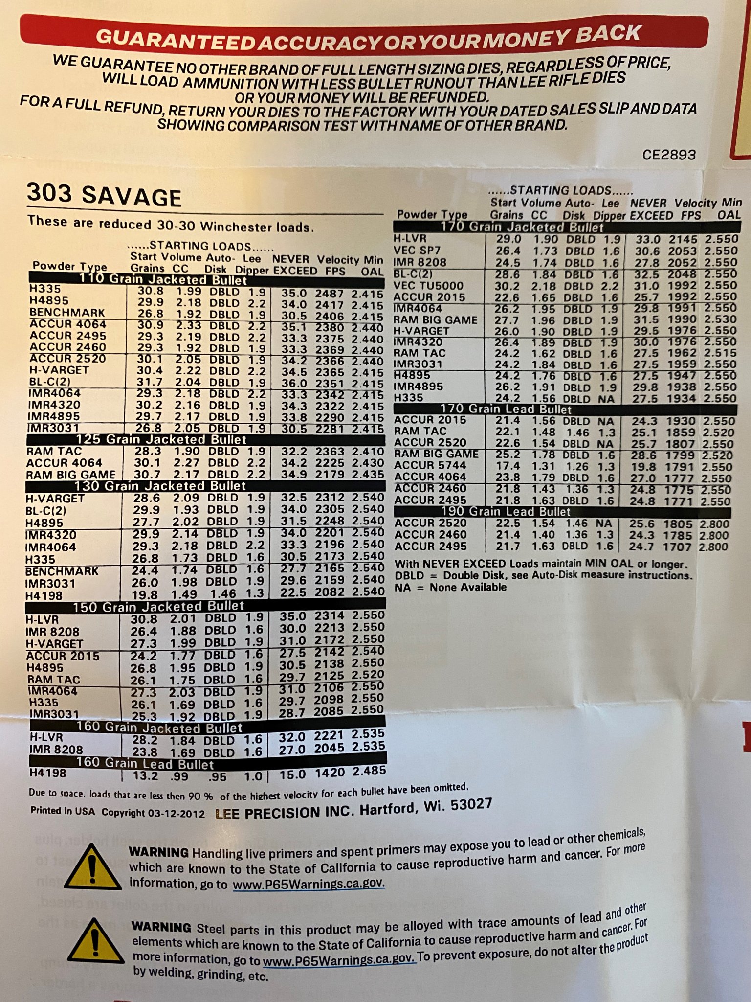

Measuring my Lee Pacesetter sizing die, the expander measures .304. Reviewing the included doc I found the attached load data as well.
My powder stores contain H4350, Superformance, and Win StaBALL 6.5.
Any thoughts on the use of these to build up a load or should I be looking for something more appropriate?

Your data sheet says those loads are "reduced 30-30 loads". H335 seems to come up available fairly often on Hodgdon's website and Powder Valley.

Thanks, I found some IMR 4895 and ordered some .308 Round Nose. Looking forward to testing it all out.
