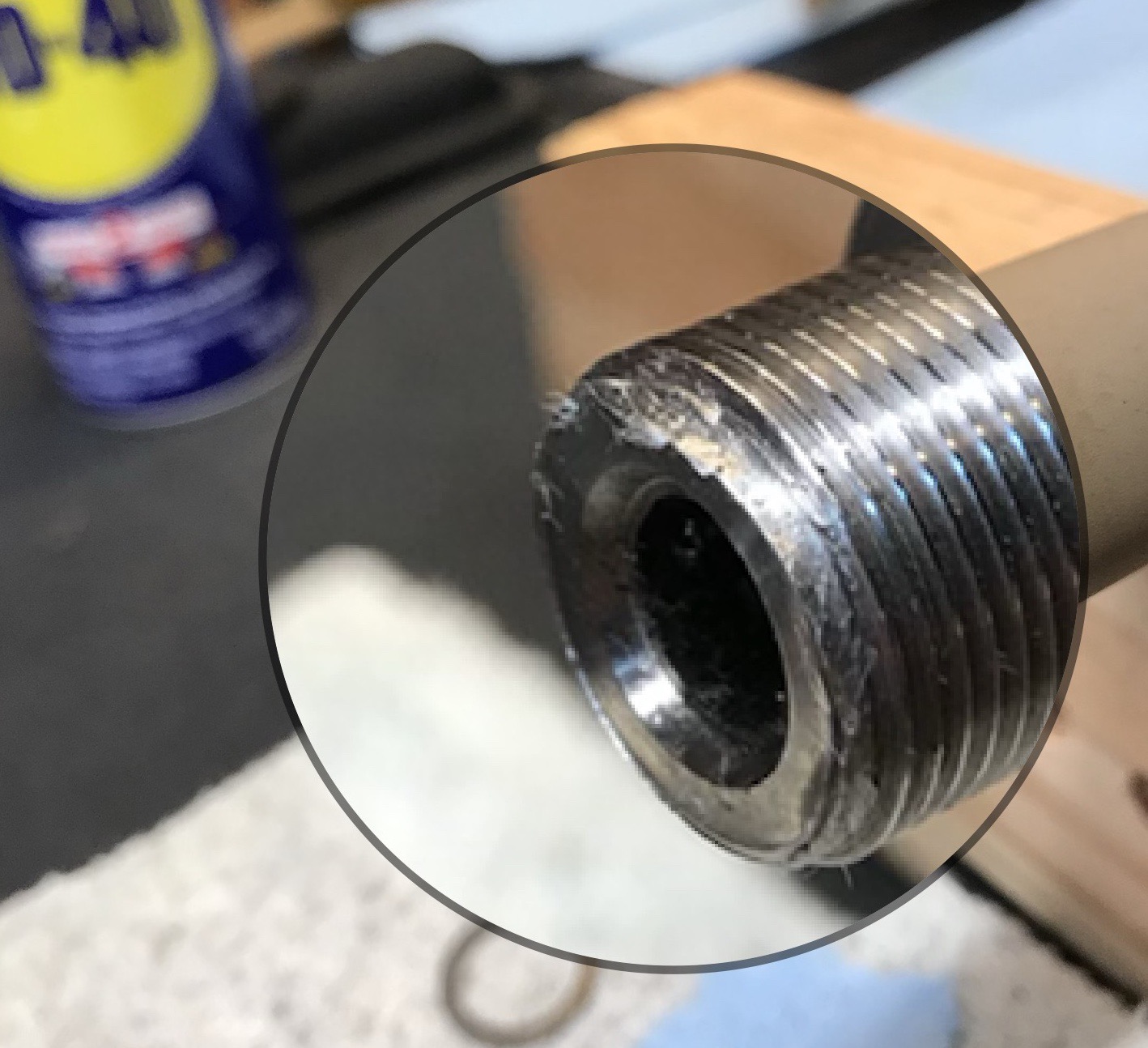

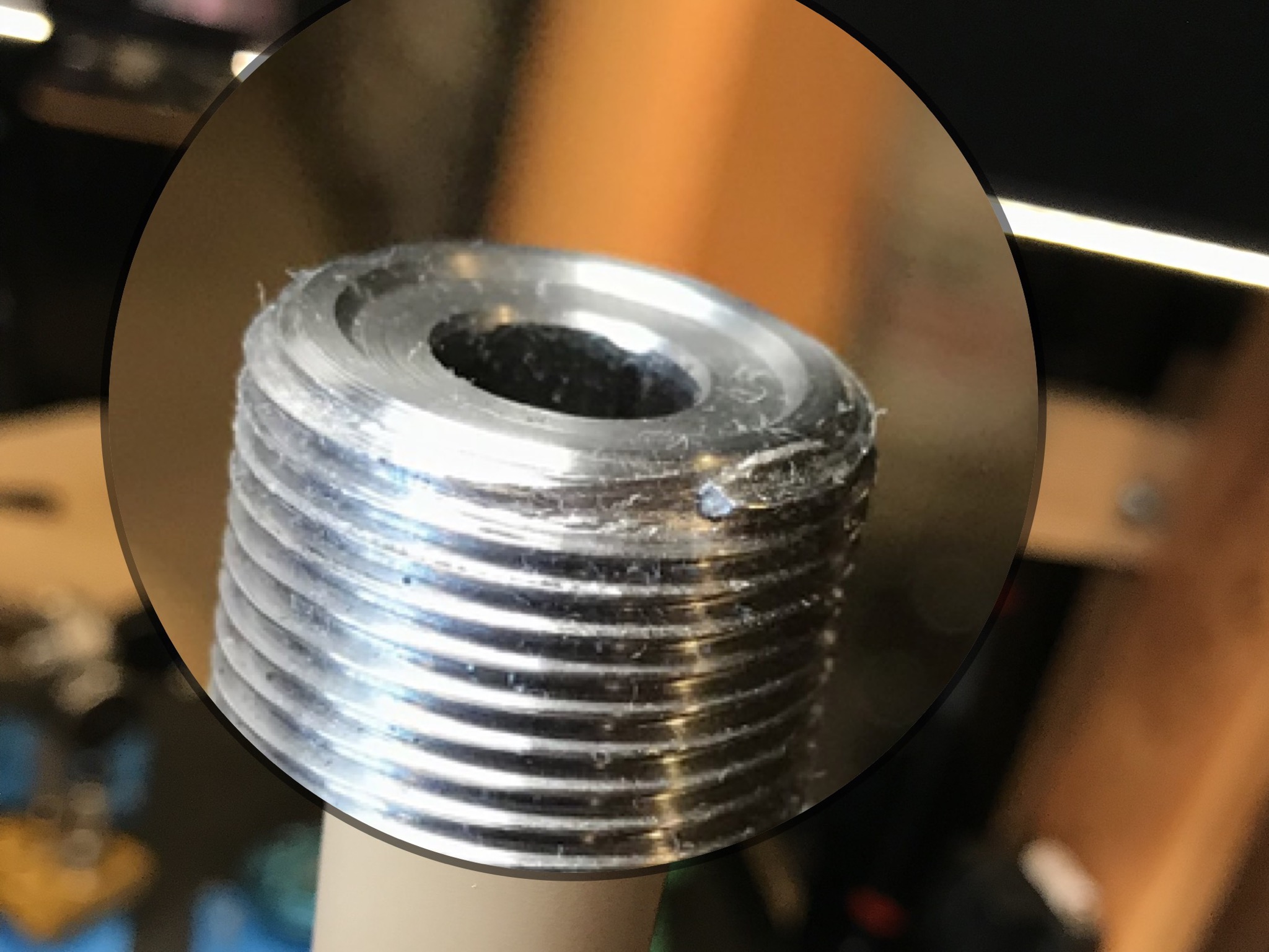

Have two new barrels that I was removing muzzle devices from, to switch over the Area 419 system, and noted the ends of the threads look f@cked up. Method of removal was butane torch while slow-roasting the brake over the flame, rotesserie style.
1. What would cause galling on new barrel threads?
2. Can this be remedied without re-cutting and re-threading?
I have never had this happen before. Just wondering if I caused this by improperly removing the devices. Thoughts?

I would just have a smith clean it up. By the looks of it, you won't have to worry about losing any length. Was it hard to screw off the whole time or just towards the end? Stainless galls pretty easily.
After about 270 degrees of turn, it got harder. First few quarter turns were easy.

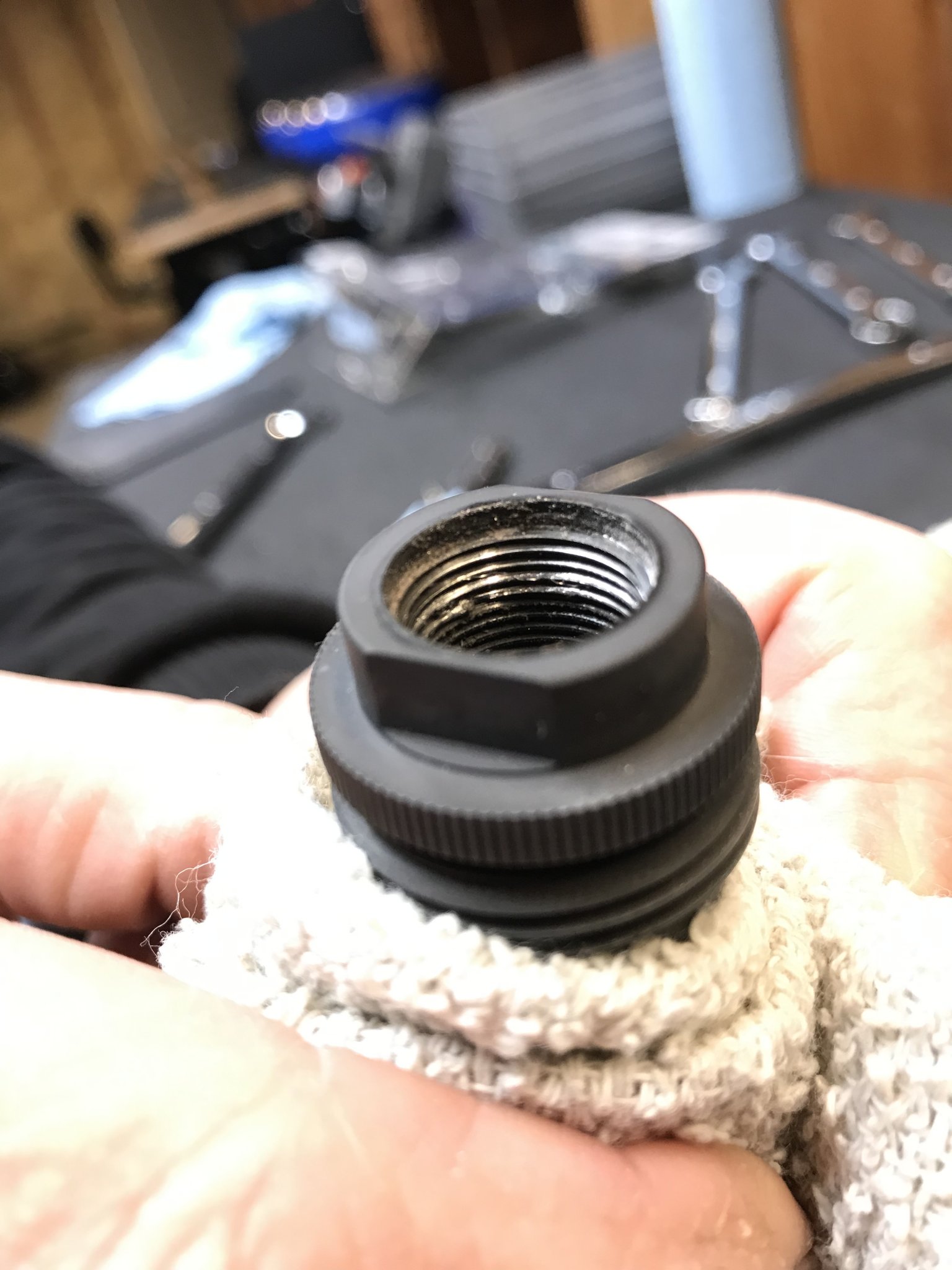

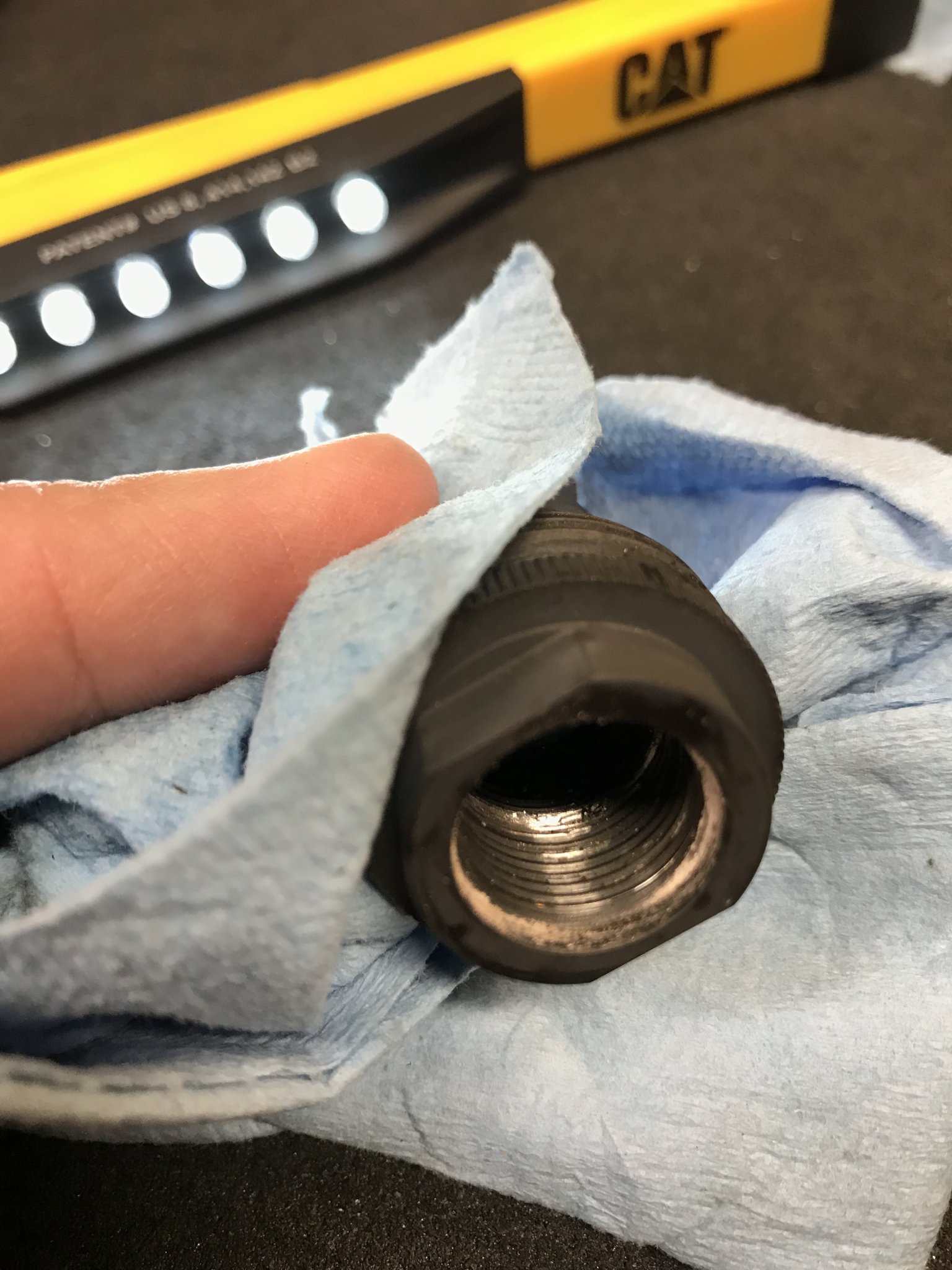

Brakes have similar damage, far inside of the brake. The brakes were installed at the smith, so I never put them on.
It don't look like your barrel is damaged as far as accuracy wise the way I see it, its just your threads. Deburr the end of your barrel and run a tap and die die over your threads, put anti seize on your threads and then your gtg.....
On stainless steel if you tighten it too tight it will gall and essentially cold weld the two pieces together and then you will have issues that you WILL have to either cut the brake off or cut the threads off with the brake......not good at this point, heating probably won't even work and damage to the barrels accuracy could be damaged.

Brakes have similar damage, far inside of the brake. The brakes were installed at the smith, so I never put them on. View attachment 6994868View attachment 6994867
Run a bottoming tap in there with PLENTY cutting oil/tap and die oil and it will be fine. Those threads don't look that bad at all, I've seen worse. Make sure you put anti seize on you threads!!! It is your friend or don't tighten it too tight.
I've seen worse on the lead in thread on the tenon after removing a few barrels from other rifles...
The crowns look to be OK, at this point you just want to clean up that last thread so the new Area 419 adapters thread on cleanly without further galling or thread pulling. I'd clean up the boogered last thread with the appropriate chaser or thread file followed by buffing with a wire wheel, then install the new adapters with anti-seize. Hell, you could even hold the barrel up to a belt sander at a 45 degree angle while spinning it to chamfer that last thread and clean it up.

Looks like he tightened it down dry and it galled. Always put something on it, especially stainless. Even thread locker acts as a lubricant during assembly.
Eta:On second look probably bottomed out inside the adapter and deformed the last thread. Clean it up and it'll be fine.
