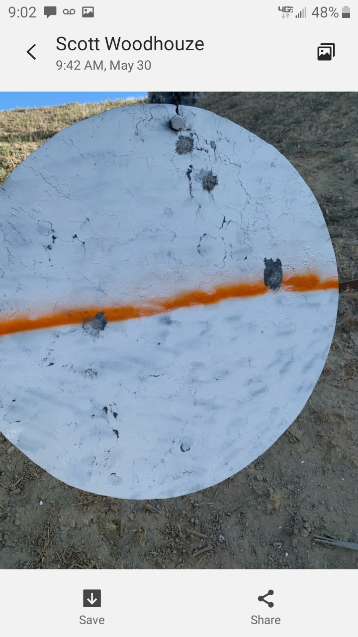

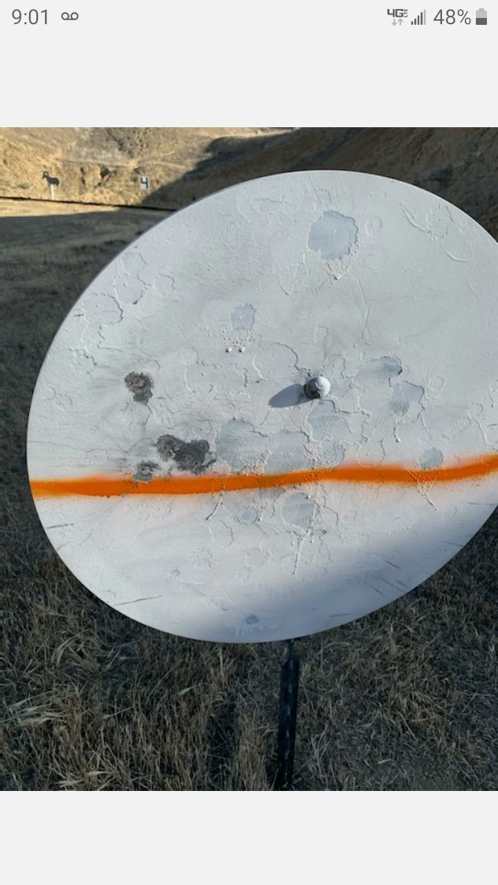

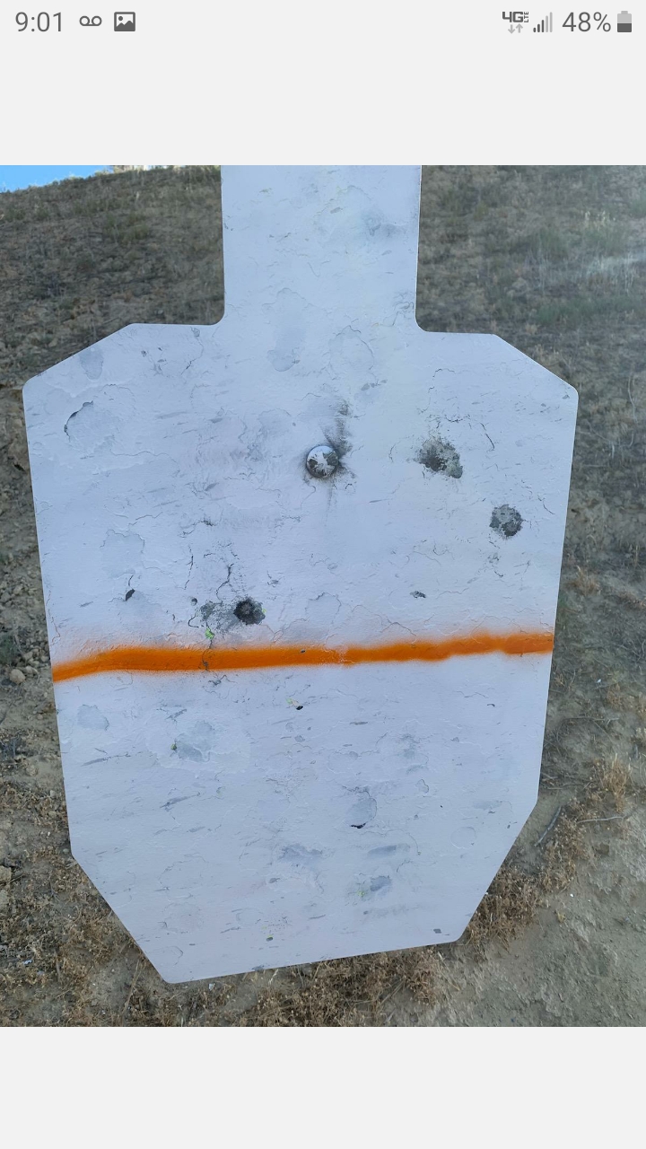

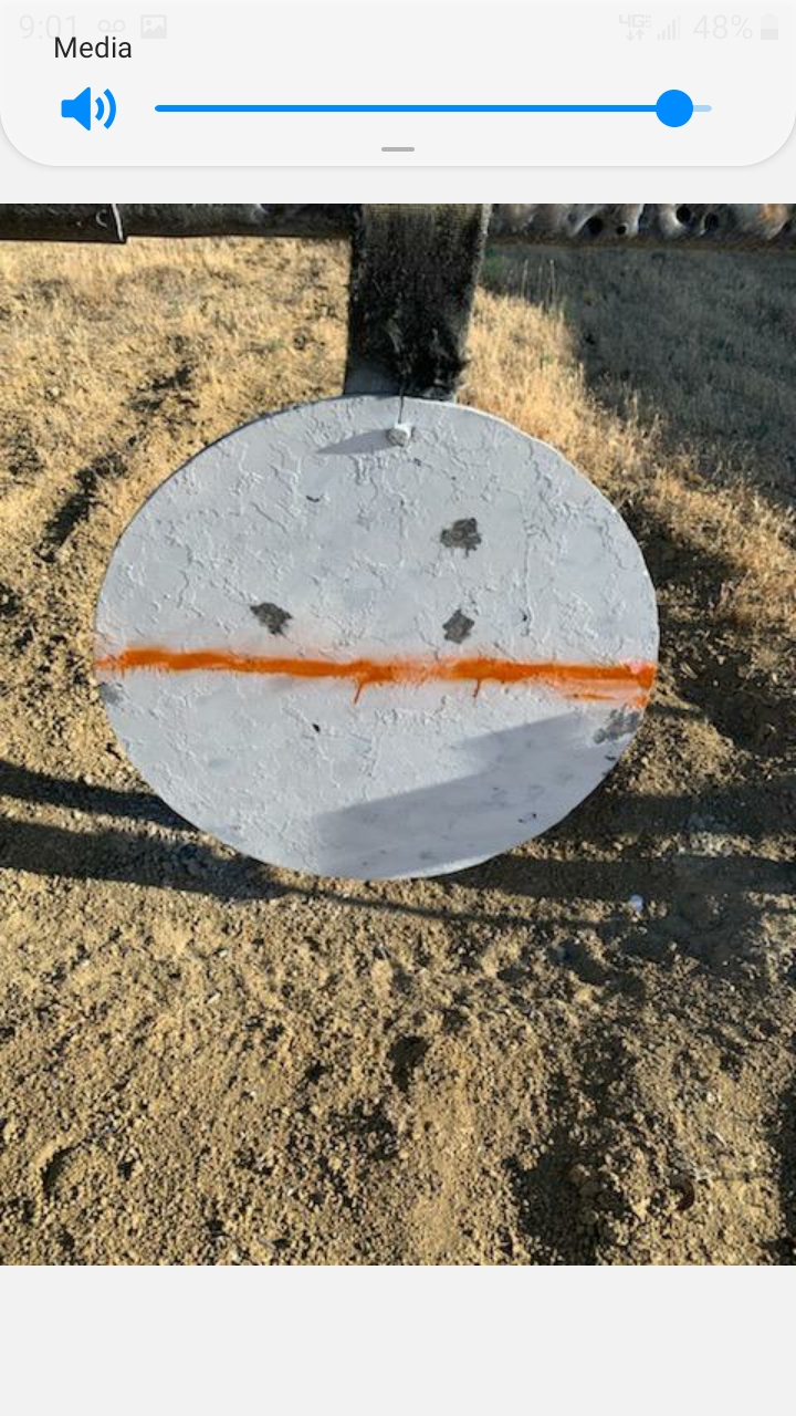

Done a seating depth test ,ill trying to explain as good as a I can.
My testing was done on a 308 shooting 185 juggernauts.
Rem 308
185 juggernaut
Mv 2734
Ctbo 2.365
This is my ftr rifle I usually only run it single feed since it is throated long
As t 2.365 ctbo I'm jumping these bullets 15 thousandths.
So to do the seating test I shot this load to 800 and 900.
Then I took the same bullets loaded with the same powder charge, same cases ,same primers. The only difference is I seated the bullets to mag length a ctbo 2.226 that's a different of 0.139 seated farther in the case .
I shot the groups all prone from the same position within a minute from another .
1st pic 800 ctbo of 2.365
2nd pic 800 ctbo 2.226
3rd pic 900 ctbo 2.365
4th pic 900 ctbo 2.226
If u look at groups they all r slightly above water with the center of the groups virtually the same
The only difference is the groups shot with the ctbo of 2.226 r bigger. This us few to the fact that with the seating depth of 2.226 is shoots about a .75 inch group.
As compared to the 2.365 seating depth it shoots a group size. 2.
To me it doesn't seem to change much of anything .there was about a 7-8 mph wind
