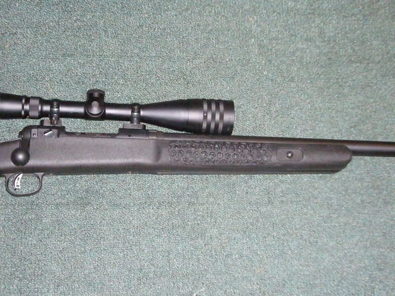

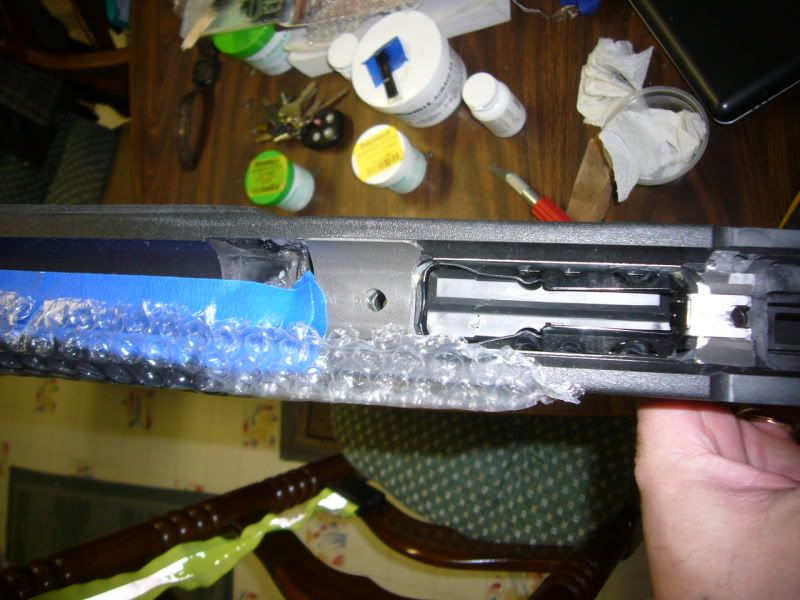

So I wanted to texture my new Savage Tac with choate tac stock, I have seen all of the ideas passed around but wanted larger grip holes, I sanded the stock, cleaned it, masked the area, mixed accru-glass gel, added black dye,

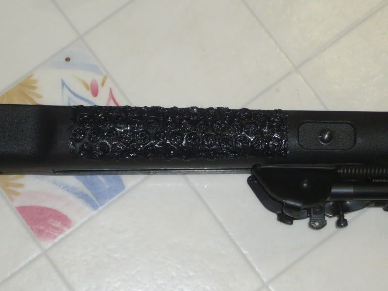

put it on the stock, took some Bubble rap –sprayed it with Remington Rem-Oil, brushed in the valley’s on the bubble wrap them placed it on the bedding I pressed firmly allowing the bedding to seep into the valleys, I let dry about 5 hours then took off the bedding
The next morning I filed / sanded it and painted it.
Feels very good
