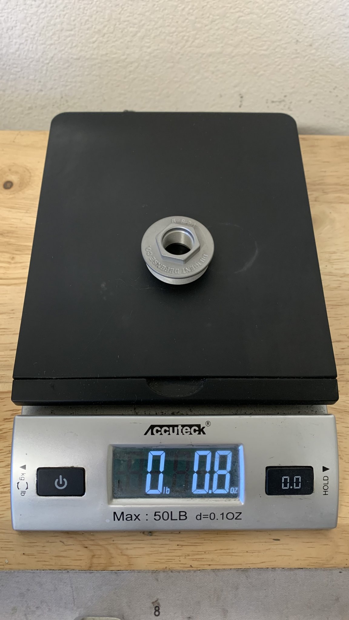

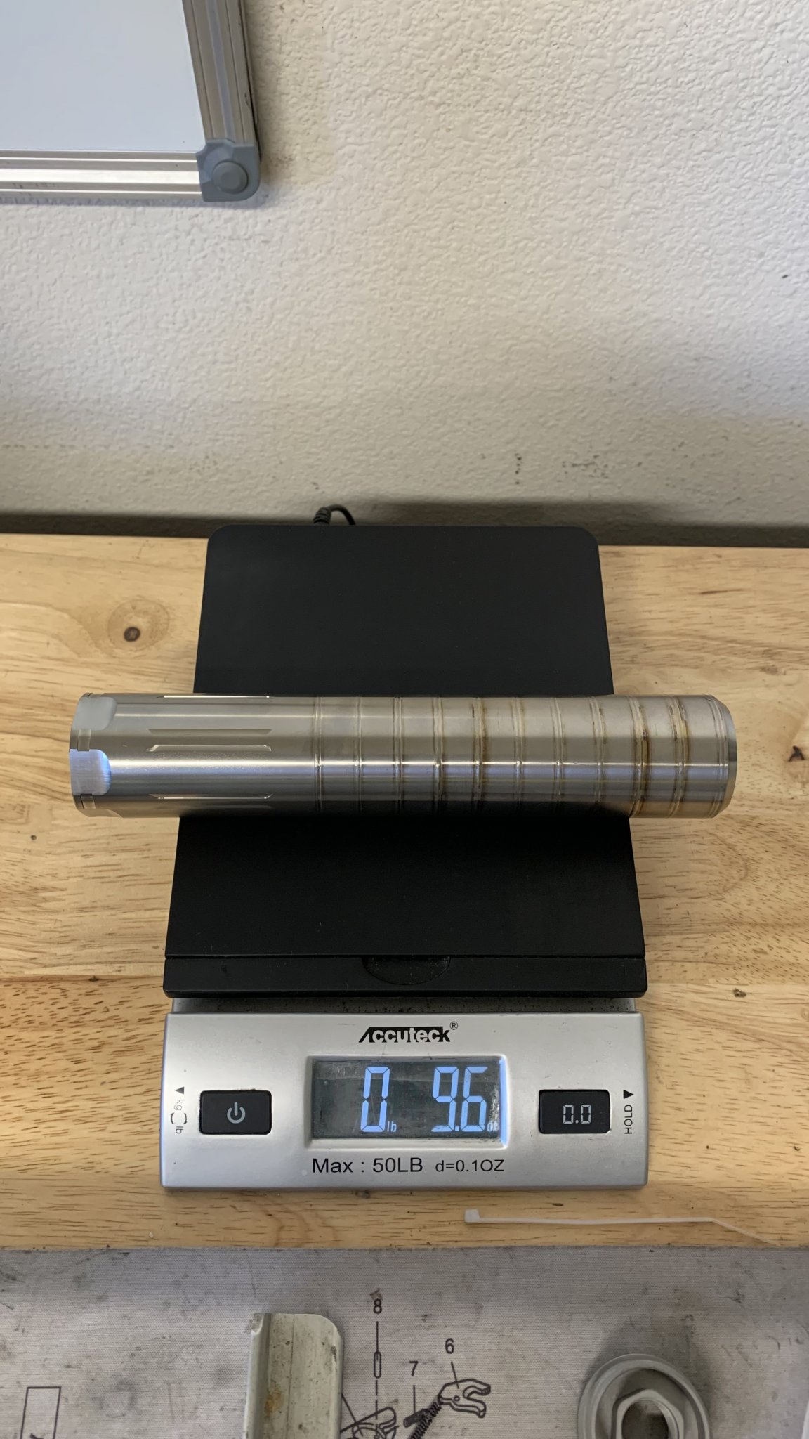

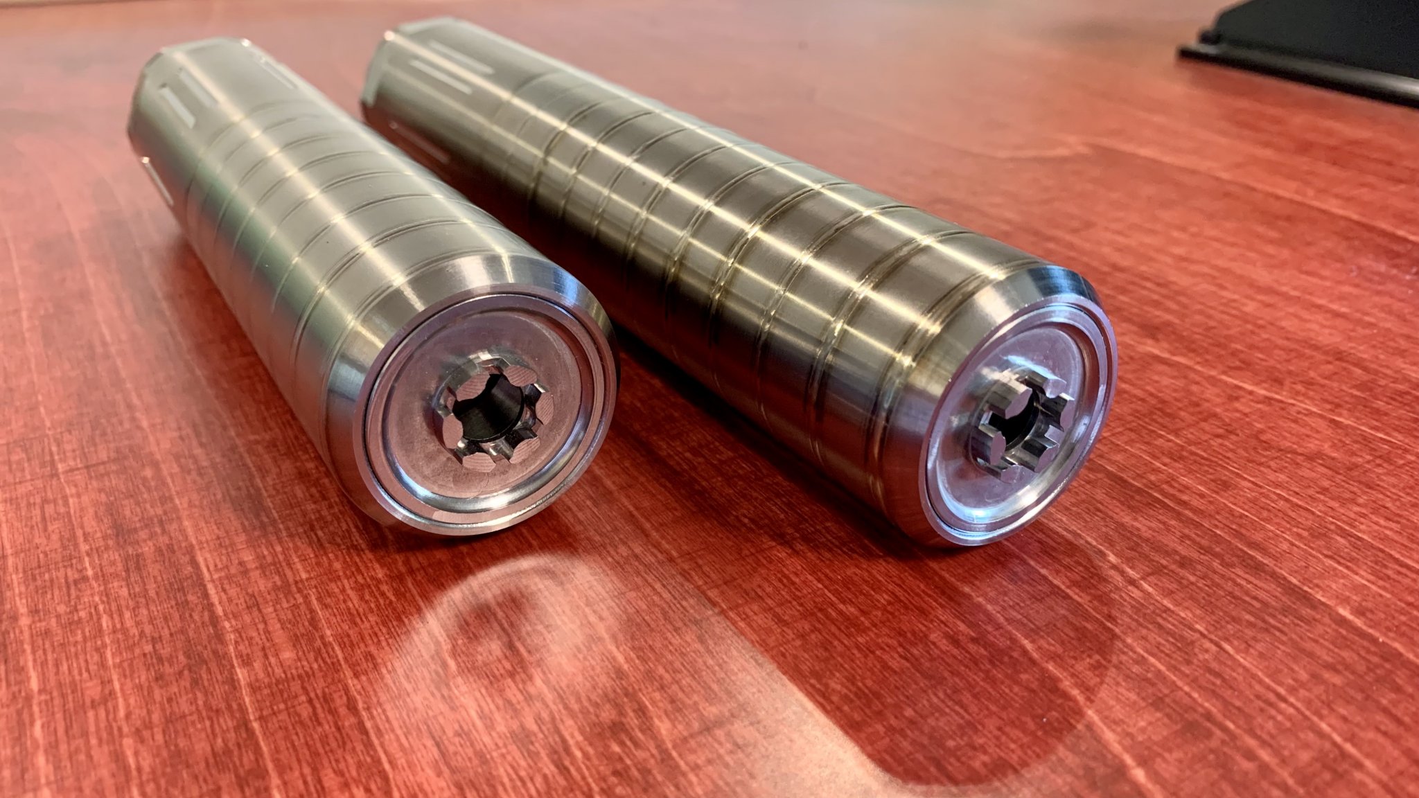

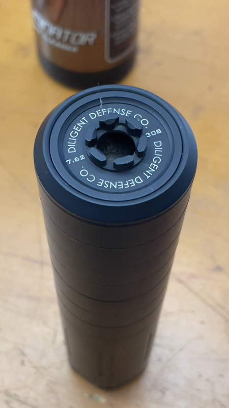

    A friend of mine tipped me off to a new manufacturer in March called Diligent Defense Co. https://diligentdefense.com/
    There isnt a ton written about them since they just opened in January, but they've been in the form 1 kit business for a while.
    Tbac did include one of their cans in a recent 300blk sbr sound test which they posted here on the hide, but there wasn't any discussion about them. Most surprising about Diligent was the fact that the largest of their cans, the Enticer L Ti, topped the shooters ear rankings on Pewscience.com using a supersonic .308.

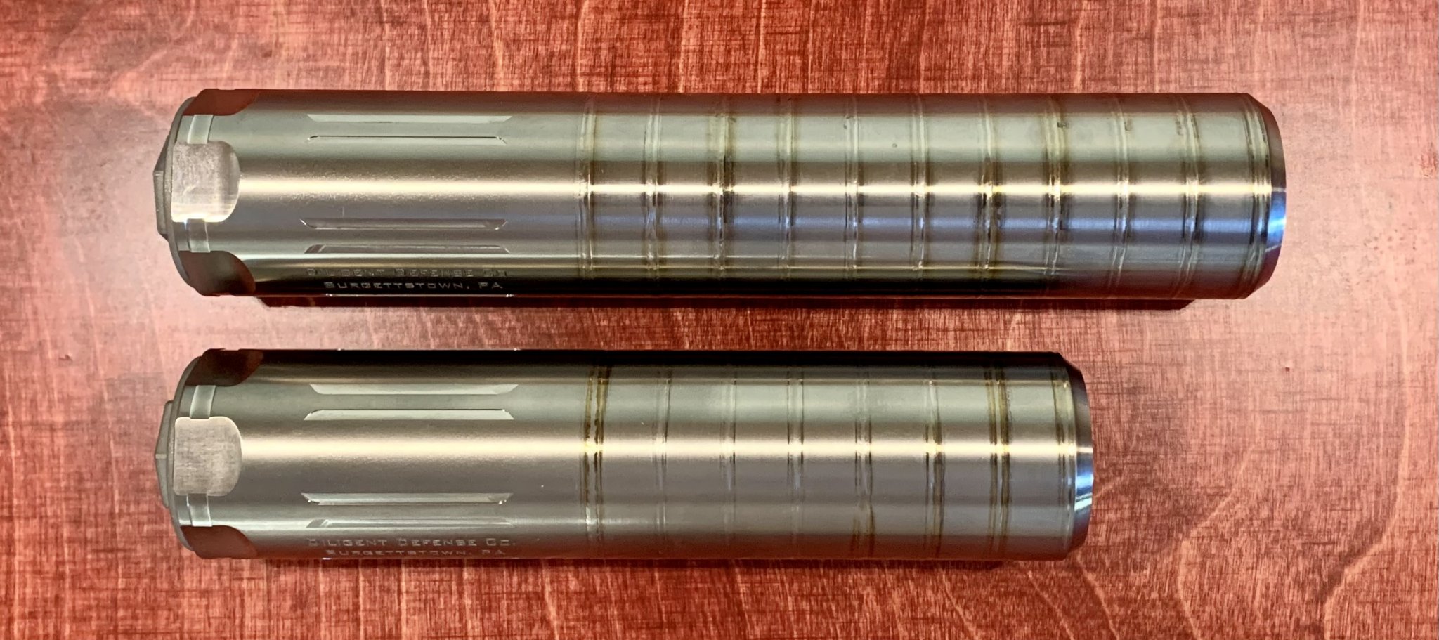

    They make basically four cans in 7.62mm. Two different lengths (8.25" and 7.75") in steel or titanium construction. all are 1.625" in diameter, and all have HUB rear threads. The features and performance come at a very reasonable price point as well. a Ti L without a mount and mill finish is $905. For comparison, the DA Nomad LT is $1100, and a Thunder Beast Ultra 9 is about the same as the DA. I appreciate light weigh small POI shift cans, and these appear to match the Tbac in that regard, see below.
    I’m most interested in the Ti variants for precision rifle, so I got one of each. The Ti cans are extremely light at 7.7 and 9.6 ounces without a mount. Both have symmetrical blast baffles, asymmetrical baffles in the center of the stack, and the forward most baffle is symmetrical. I'm no suppressor designer, so i'm sure there are design elements i'm missing. The end caps thread on and center up via a steep taper, which is unique in my experience. The end caps have a flash suppression feature as well, which I haven't tested. All of their cans are are rated to 300 WM with a 10.5" barrel.

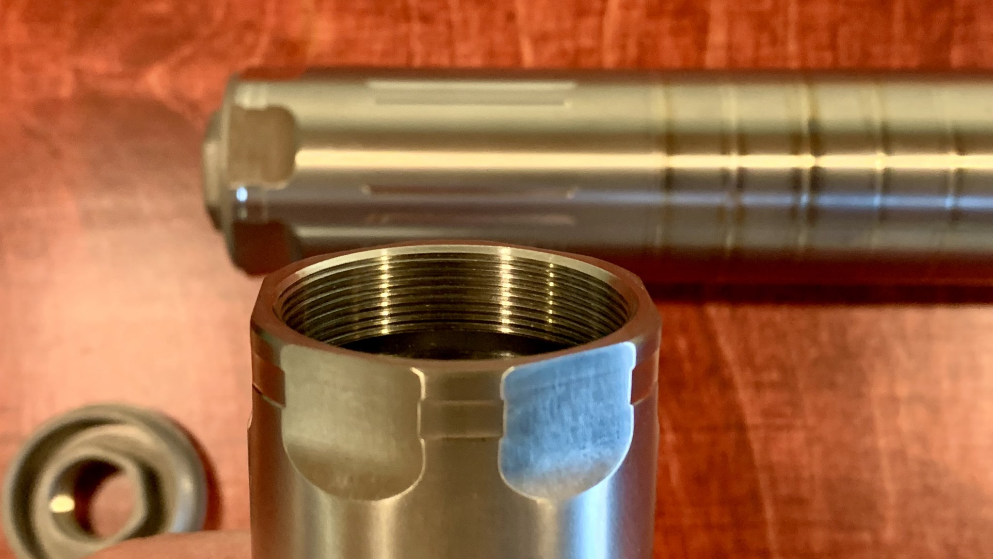

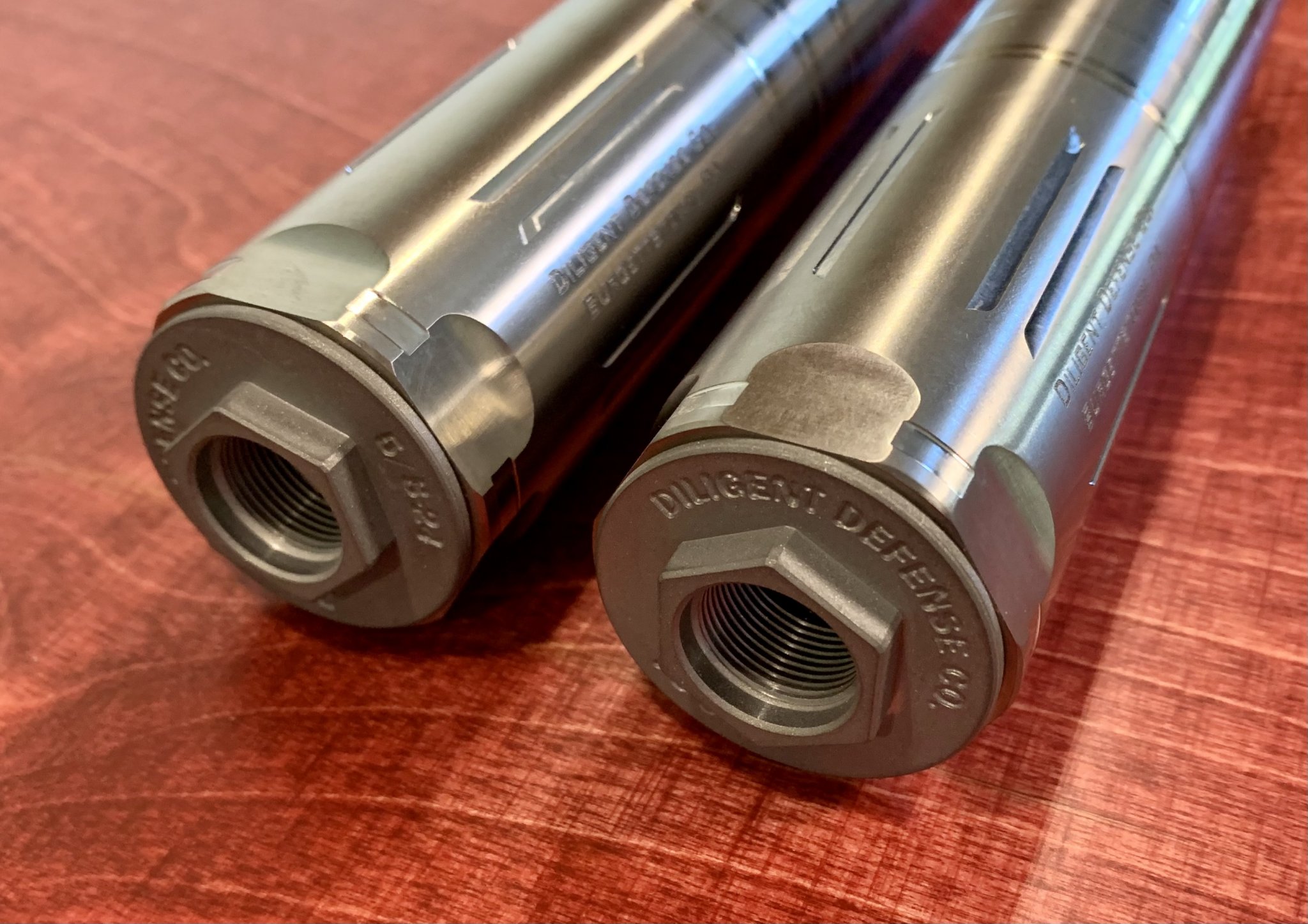

    The finish shown below is called “Mill Finish”. They're also available in black and FDE for additional cost. They can also be had with no mount for some additional savings for those that are already vested in another mount system.
    While I don't do a lot of social media, check them on Instagram, they're pretty sporty. They also have some funny T-shirts.
    Its hard to make a can unique and interesting externally, but these are definitely attractive.

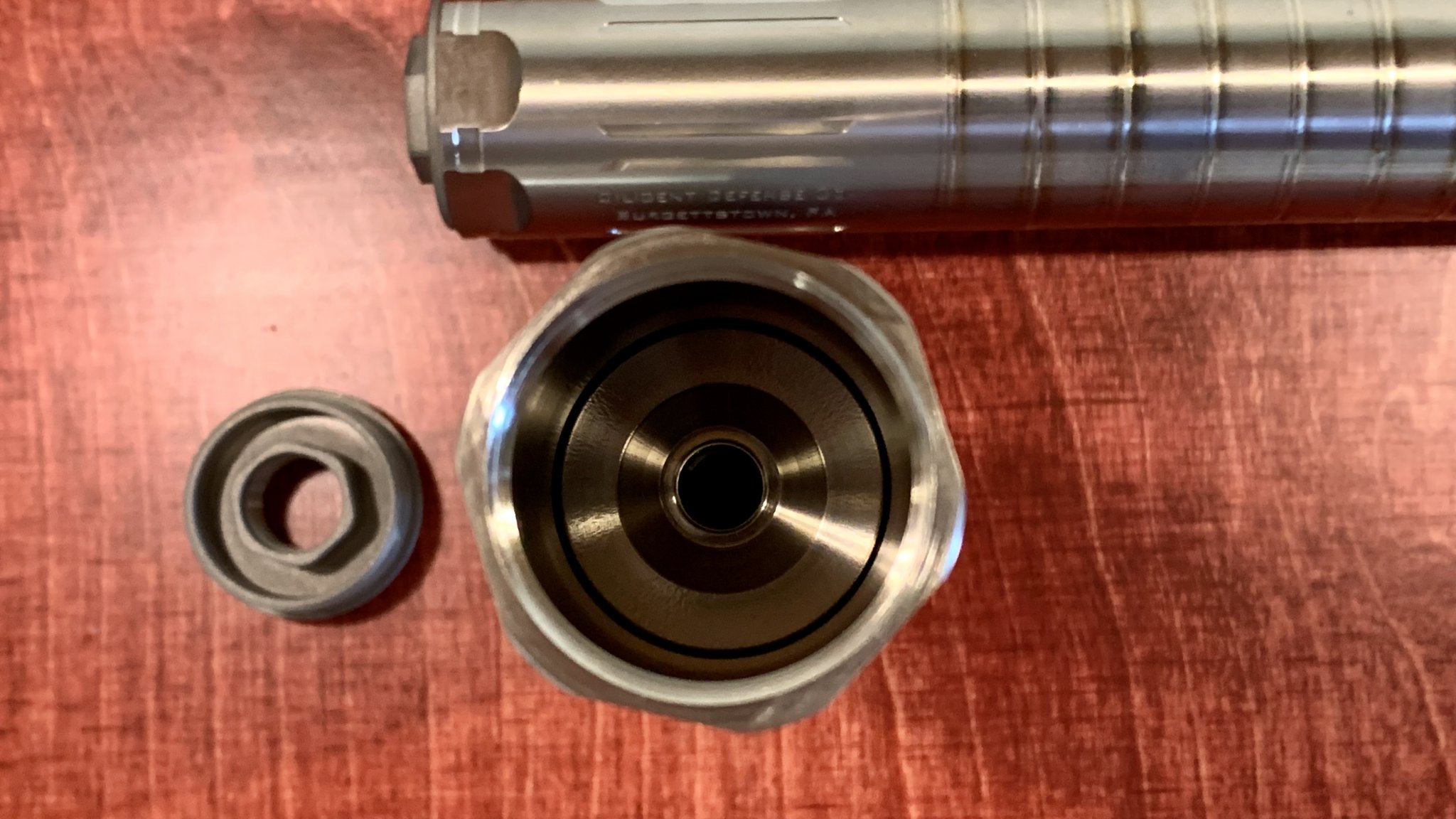

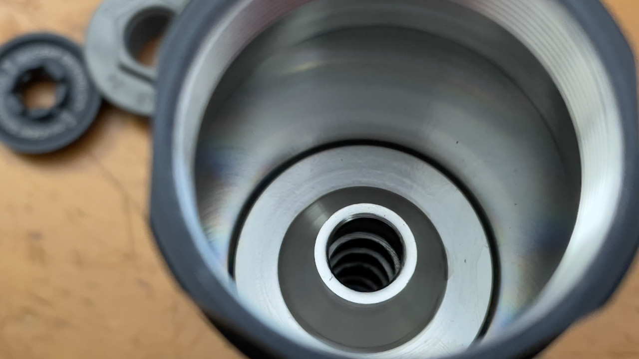

    Blast baffle

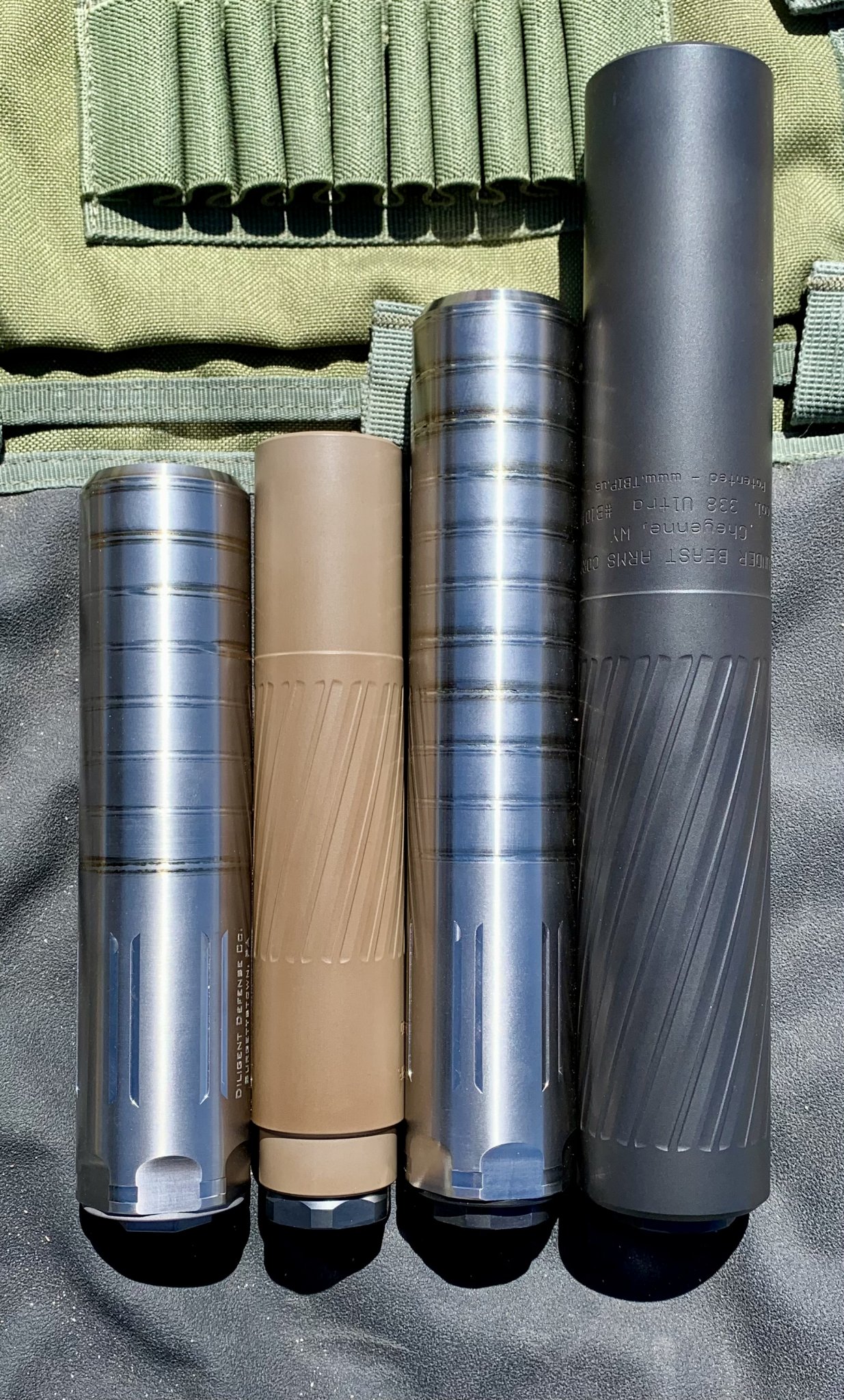

    Ultra 7 and 338 Ultra for comparison

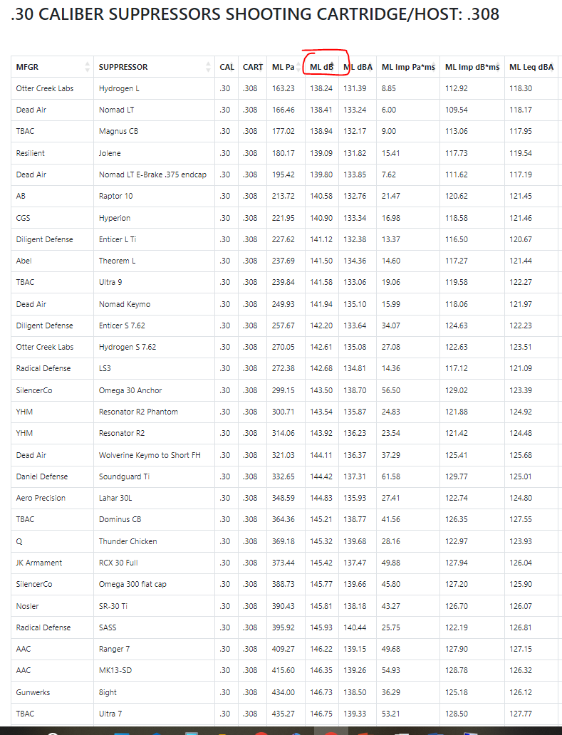

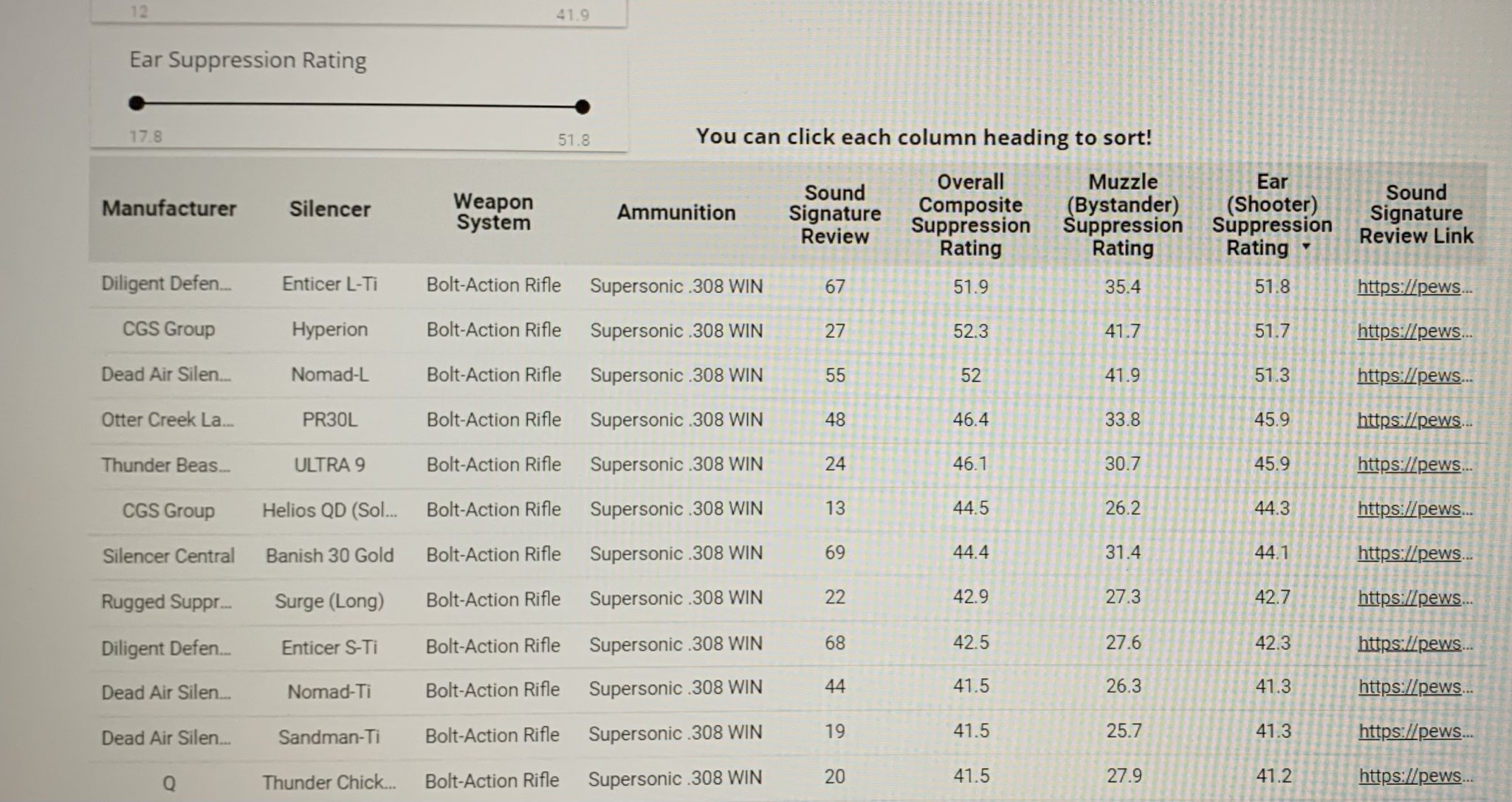

    Pew rankings sorted by shooters ear.
    I probably should have put some rounds through them before this, as both blew some goo onto my labradar, and may have caused some deviation on the first shot of the L. I added some rounds to the L string because of it. All were shot with area 419 universal adapters and mounts, and no zero changes were made between cans. The grid spacing on the target is .1 mil. I’m pleased that there was so little shift between them and the Tbac U7/30, which is zeroed on this rifle. They both appear accurate. Very rudimentary test of course. Sound performance was good, with the S being slightly quieter than the U7, and I couldn't really tell the difference between the Gen 1 338U and the L Ti. I spent some time spinning around in circles and shooting into distant hillsides to try and isolate the character of each without terrain reverberations. The 338 U must be quieter using telemetry, I just couldn't hear it.
    I’ll get some more testing in as time allows. Diligent appears to have made a very solid entrance into the ultra light Ti can market for precision shooting. If one doesn't care about weight, the steel Enticer L with no mount is $600.
    Full disclosure I am a dealer, but NOT a hide seller so don't ask. I also did this review independent of Diligent. Hit up your local dealer and have them contact Diligent. Very easy for them to set up an account via the website and order in a suppressor for you. Below is a dealer list with existing dealers, but this isn't a complete list.

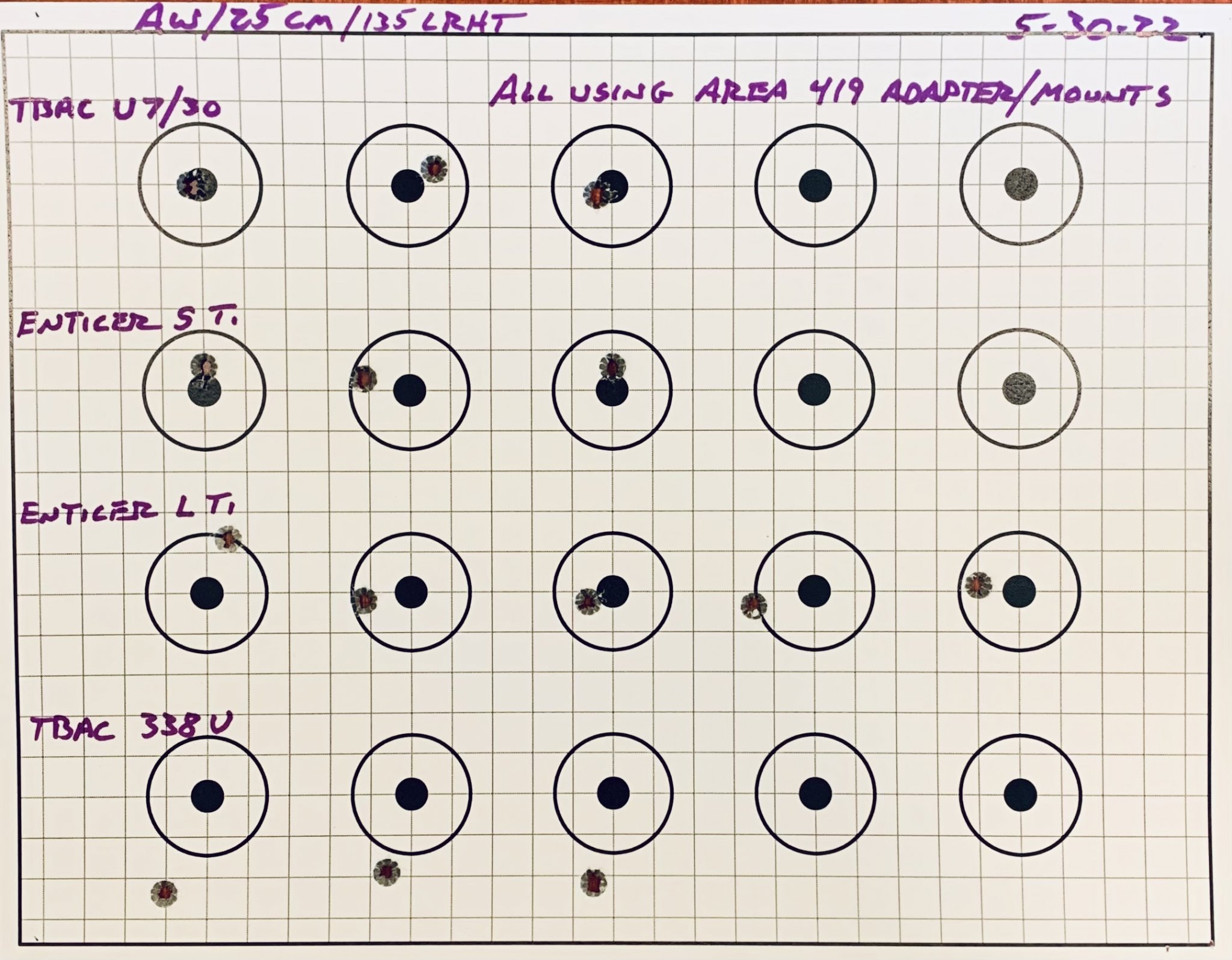

    Based on low round count testing it looks like the TBAC 338 kicked the crap out of the other ones in group size.
    That was a small group indeed. Kind of at the limits of my ability to shoot frankly, and there’s no cherry picking here. Impressive that all the shots from the first three cans went into ~ .75 moa. Overall a very small sample size.
    I am beginning to lightly experiment with the possibility that suppressor position messes with barrel harmonics....and most cans still deliver the same performance as a raw muzzle harmonics aside. Adjusting exact can position with shims is how its gonna get tested.

    Blast baffle
    Sorted for shooters ear

    Blast baffle

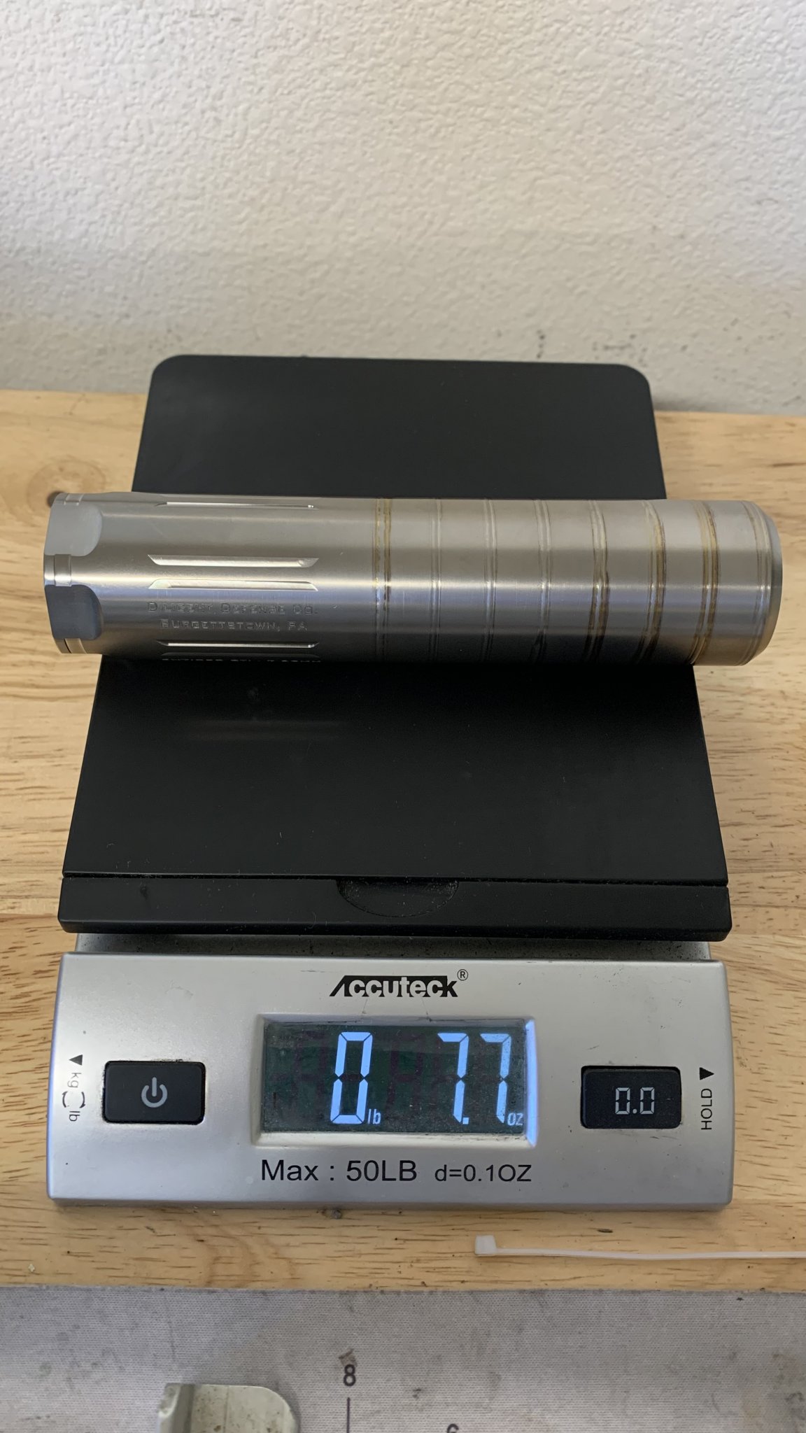

    The ti version is also 8oz

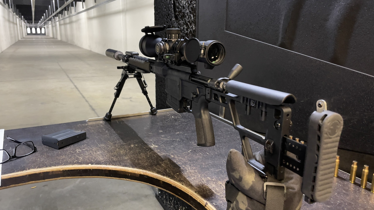

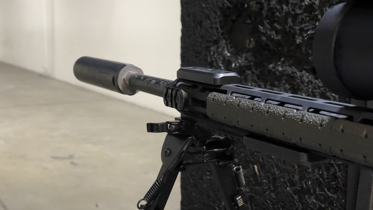

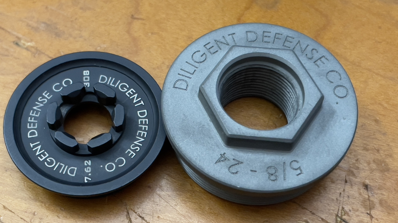

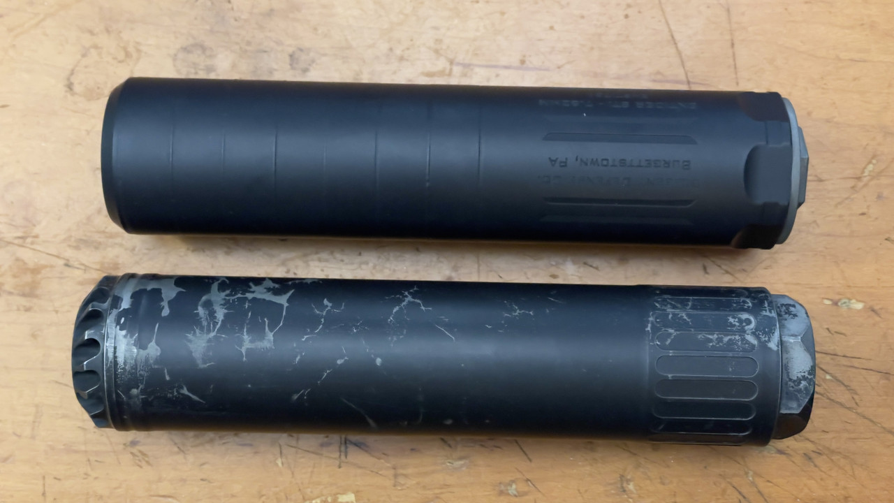

    Picked my Enticer S Ti up today, 205 day wait. After the fiasco with my Dead Air Sierra 5 which arrived damaged, I wanted to see the Enticer in person before I took it home so I drove 2 hours each way to snag it from Capitol Armory. It's impressively light, just a smidge shorter than my Huxwrx HX-QD 762 Ti. Kinda glad I went with the S even though the L will ultimately be quieter, I wouldn't want it any longer. I thought I'd purchased the naked version but I'm happy either way. I can always strip the cerakote.
    Right now I have the DD titanium direct thread mount, going to wait for the Huxwrx HUB mount as it looks like it utilizes their muzzle devices. I have half a dozen of those so it'll be nice to be able to switch between suppressors from different manufacturers and not have a different muzzle device on certain rifles. I have a Huxwrx Flow 762 in time out as well. Was able to fondle one of those today along with the Flow 556 which is impressively compact.
    The Enticer will be mostly dedicated to my one and only bolt gun. I'll likely test it on the Spear LT 300 blackout with subs just to see but I'm expecting good things from the Flow 762.
    I did take the time to mount it and check alignment and it was spot-on. My only negative comment in regards to the Enticer is Diligent needs to include the Torx tool for the front flash hider cap. Otherwise there's no way for the owner to secure it properly. It's a T60 Torx and Amazon is coming to the rescue. Still...include the tool as it's cheap. It'd be nice if wrenches were included as well. Luckily I have a bunch of thin wrenches specifically for suppressors.
    No cracked rear baffle (cough, Dead Air).
    Hux 762 on the bottom. Gets lots of use on multiple guns, hence the "relic'd" look.

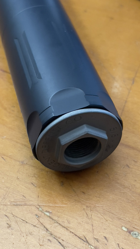

    Ran home from work, grabbed the Sig Cross and Spear LT 300 Blk and headed out to the local indoor range. I whipped out the Cross first and used a Sierra 169MK load. It was so quiet, the first five shots had me laughing as I was shooting the the resulting group showed as much. After the 4th shot, the mirage was pretty bad (it's always bad at this indoor range) so a cover is definitely needed. Hunkered down for the next five shots and I could cover them with a nickel, again battling the mirage. I'm sure with a bit more airflow in there, I could shrink the group by a good bit.
    I brought some supers and subs for the 300 blackout and with the subs, I only heard the action cycling. Nothing more. More laughter ensued.
    While I was shooting the .308, the rest of the benches cleared out to find out what can it was. I asked if it seemed really quiet and I guess the guy in the booth next to me thought it was .22LR. He was new to rifles so I'll chalk it up to that. I can only imagine how quiet the longer L version is.
    The can definitely didn't affect accuracy at all and it had a very modest POI shift. Once Huxwrx releases their HUB mount, I'll test repeatability.
    Being a traditional baffle can, it made the Spear LT quite gassy. It's already gassy to begin with but the first few shots had me checking to make sure I'd adjust the gas down. According to PEW, the Enticer S Ti and the Huxwrx Flow are almost identical in performance and I have the Flow in time out. The Enticer would work on a gas gun with subs if you weren't doing a lot of running and gunning.

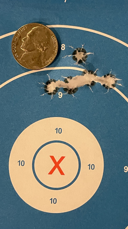

    First five shots and not my best showing but seriously I was actually laughing as I was shooting.
    Next five. Much better.
    Without a doubt, it's significantly quieter than my Huxwrx HD-QD 762Ti with both .308 supers and 300 blackout subs. I shot a few supersonic 300 blackout rounds and thought it was actually a bit louder than the .308 bolt with a 20" barrel and double the powder being consumed. I didn't really notice flash on any of them but wasn't paying super close attention.

    The quality of the welds and machining seemed top notch. The ability to use them via direct thread and its ability to use a variety of muzzle attachments and end caps seems very nice.

    I was just at my local dealer today. I went specifically looking for a DA titanium Nomad for my young son’s bolt gun. They didn’t have one.
    However being that I live just outside of Pittsburgh, the owner pulled out a Diligent Defense Enticer S and placed it next to a ThunderBeast Ultra 7. My interest was peaked instantly. I had never heard of Diligent Defense….and their manufacturing facility is located 15min from my house.
    In all honesty this may be my next can. I have a few DeadAir and Thunderbeast cans which have all been great. Maybe I’ll be another Guinea Pig for the hide and report back my results.
    Get it. Highly recommended, just a great can in either S or L configuration.

    TBAC tested the Enticer L Ti as well in their 2023 Silencer Summit if you haven't seen it. I don't know how you really eliminate first round pop. Every can will be filled with air after the first shot to some degree. It allegedly takes a 3 decibel change to hear a difference. If you're wearing ear pro, there will be zero heard difference between them.
    I will say this...I have the S version and on a 30 cal bolt gun, it's amazingly quiet. I can't even imagine what the L sounds like. Mouse fart?
    Reactions: benfrench093
    excellent article for data nerds. I bought my LTi based on that test. Quiet was a major factor, then weight and cost. I think I sorted it right, ML db from quietest to loudest.
    I am in the market for a 30 cal suppressor and am having a heck of a time making up my mind between the TBAC ultra 9 and an enticer LTI. I dont want the price difference to be a factor. They are nearly the same weight, and the enticer is a bit fatter but a touch shorter. I want the quietest 30 cal can I can get without the weight penalty of a hyperion. Pew science rates the DDC can quieter than the ultra 9 with the exeption of notable FRP which obviously is an issue for hunters when the first round matters.
    My question is: how much of a difference is a decibal or two? Is one noticeably quieter than the other? Difference in tones? Is the FRP as much of an issue as they make it seam and how much louder is the first round than subsequent rounds? If you could grab one or the other at the same cost with maximum suppression in mind, which one would you choose?
    Quote Reply
    Report
    The DD is quieter, no doubt about it. Unless you go do a demo with them side by side though, all you have is the data you mentioned. Only you can make the call.
