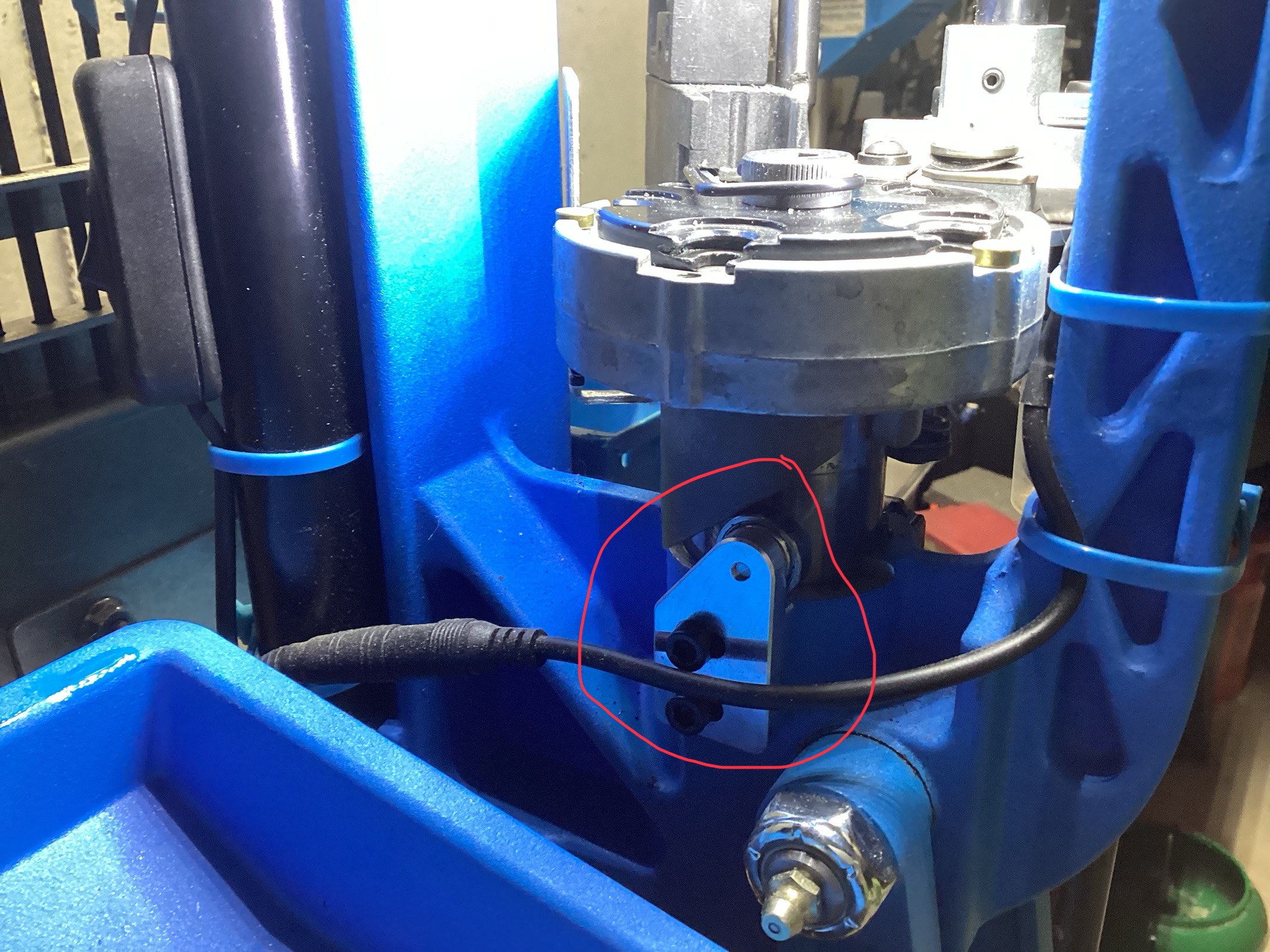

    Mine has this aftermarket thing but I’m almost positive you can move the factory one back and forth for case alignment alsoView attachment 8683822
    Oh, that’s kinda nice. I’ll take a picture of mine. I’ve used mine so much that the metal is actually worn. I’ve replaced several of the advancement plastic brawl thing jiggy because that gets jammed up and breaks when you get powder up in the top part.
    that doesn’t look to be anything with alignment, though that will help make advancement smoother yet the plates only going to stop and rest where the ball detent is

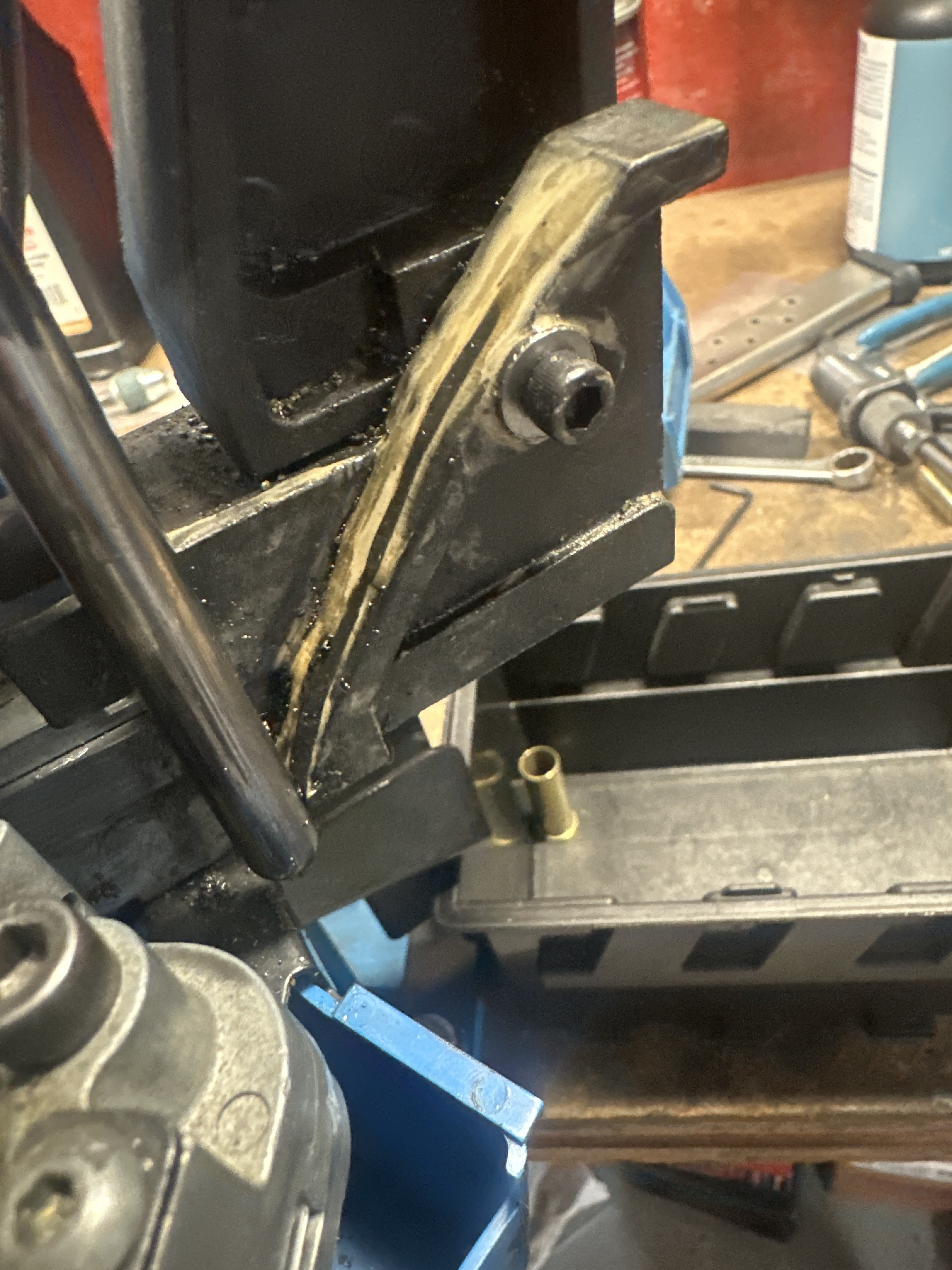

    I had a massive groove worn in my case advancement part thing so I filled it with some hard, marineepoxy!
    Many many thousands of rounds later I don’t see any wear or groove pattern since!

    Is the plastic indexing arm above the red circled part worn out? That would probably cause an issue. Mine about a month ago would not always index far enough and clip a case going into station one sizing die. I adjusted that red circled part just a touch and it’s run flawlessly ever since.

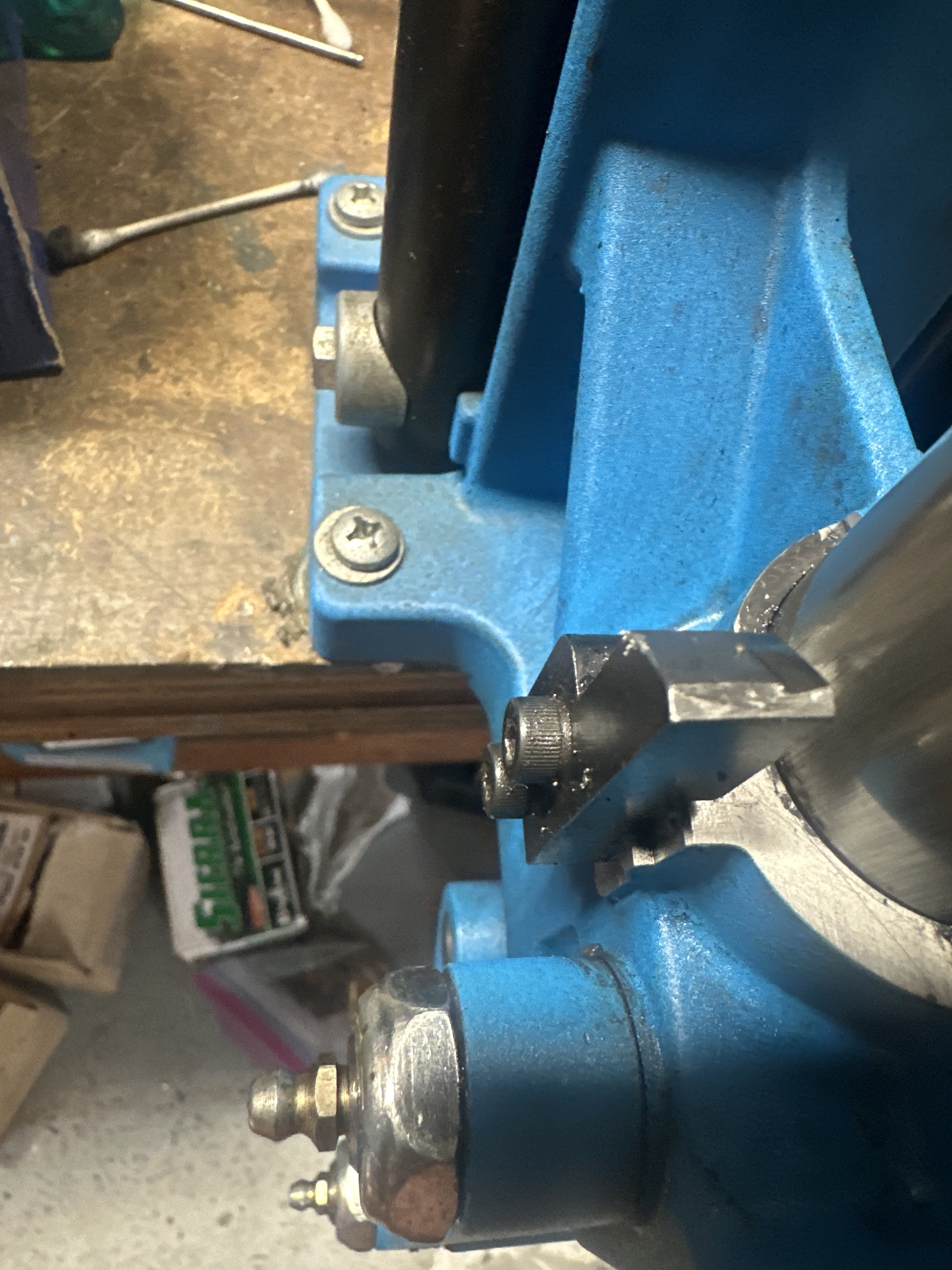

    You are correct there is a tiny bit of a movement that you can adjust when an indexes.. but it appears it is the hole they drilled or machine with a knee milll.. through the press , but you have to physically pull the entire head assembly to the left for it order to lineup.
    If I could line it up just right I’d put the Rod/ram it in my heavy duty frame press and bend the ram so that everything lined up
    That black plastic thing in your second photo has something to do with indexing also. Like @Threadcutter308 said it’s been so long since I messed with indexing mine. I’m just guessing. But Call Dillon don’t waste your money unless you just want a new press
    IIRC, it's called a "Ring Indexer". I have broken one or two of them in the past. I'm fairly certain that the reason they make them out of plastic is that they want them to be sacrificial, so that other, more expensive parts don't break if a serious jam up occurs. I also seem to recall it's about the same cost as the complete spare parts kit, which includes one ring indexer. So.....buying the spare parts kit is a no brainer.
