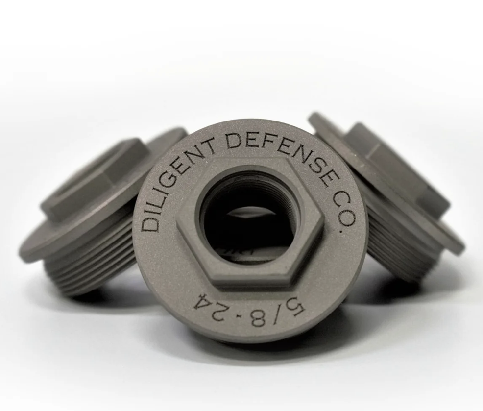

Any idea what a good solution would be for this? I know I could do the A419 system and it should fix it.
Crush washers are bad, is there anything else I am thinking off.
I can ughah ugahing the shit out of the can and it still comes loose after a few strings of fire. I assume thermal contraction is causing it to loosen up no matter how hard I tighten it. I really dont want to have to tac weld this can to the barrel if I dont have to.
5/8x24 barrel with a titanium dillegent defence HUB adapter mated to KGM R30K.
Is this the adapter you have?

Why this over a $30 plan B mount? What's the advantage for someone looking to DT with retention?
basic answer: interfaces using the HUB mount as the primary thread have more mechanical advantage going for them (combination of factors) and you can be a bit more brutal with making sure the smaller thread section stays put using higher torque and/or a high-temp threadlocker.
the plan-b stuff works, but I would not underestimate the results having the pin wrench notches handy can yield for keeping shit in place
Ah, I missed the fact that the muzzle device threads were hub on first glance. That's a heavy direct thread Hub adapter but it does makes sense in a way.
they also make a normal-ish mount, but the best advantages of that one is the fact it acts as a primary blast baffle (brake) and also the hex design is made so you can torque it on with a socket. since it's not timed
