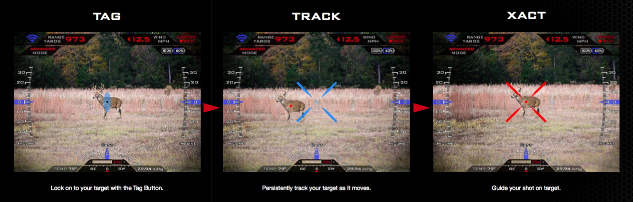

Basically is an auto adjusting reticle based on range and computations from a ballistics computer. Kinda like the Tracking Point ones:
Hopefully they found a way to miniaturize it though, that is BIG heavy gear (we won't even discuss price) that I wouldn't want on a combat rifle.

I will be damned. So the laser and the computer are not optional, then, the sight needs them?
To work as designed as a "disturbed reticle", yes. I know on military fighter HUD's some of them have a boresite default reticle if the computer goes tits up, but it's all spray and pray at that point. I imagine in a riflescope you could have a zero (boresite) crosshair or dot that would always be displayed and could be used like a normal scope in case the electronics failed, at least that's the way I would design it.
