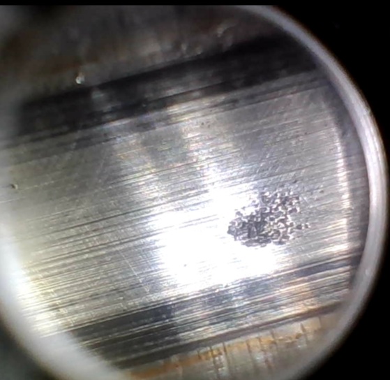

I'm glad I have mine. I wish I'd had it when I first unboxed the Remington as a new rifle back in 2013. Then I'd have a frame of reference. At least I'd know how a factory Remington looks out of the box. Looking through the borescope again, in addition to the divots I posted about originally, I can also see what looks like pitting in a few places. Odd, since the gun was never stored outdoors or in humidity, but rather in a humidity-controlled gun safe. I've cleaned it at about 300-400 round intervals, but I really have no idea whether or not I got all the carbon out. But now, going forward, I know what's in there.
By comparison, I have a Criterion barrel in .223 Wylde on an AR15 that has about 400 rounds through it. Stored in the same place as the R700. The Criterion barrel is nearly perfect inside, with just a small amount of carbon near the throat.
With less than 1000 rounds on the Remington, it just surprises me that it's in this rough a condition.

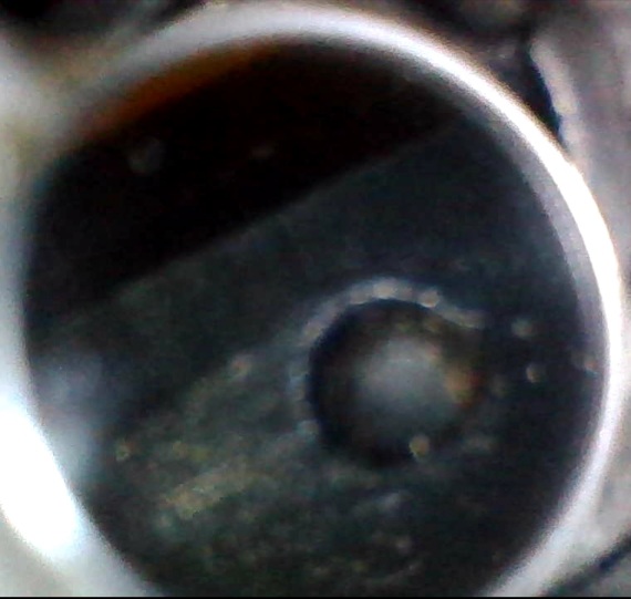

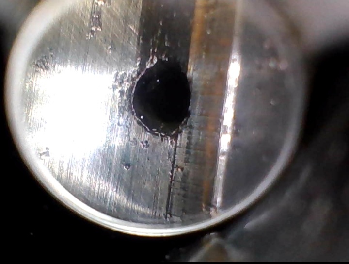

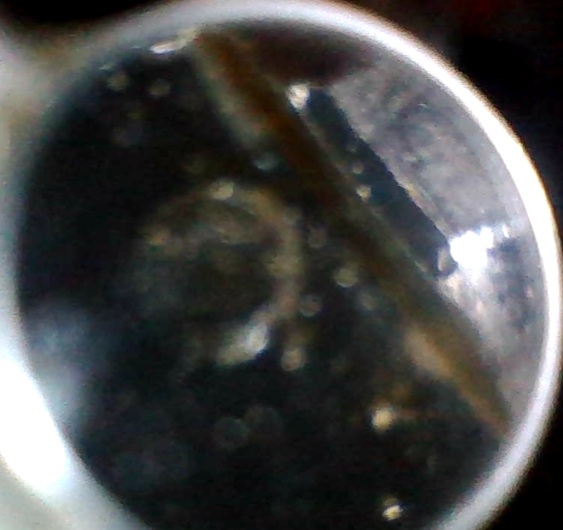

Edit: I added 4 photos. 1&2 are the WTH? They certainly look different than the OP's divot. 3 is a corrosion pit & 4 is a gas port. The barrel is on a '63' M100 that was abused for decades before it was saved.
