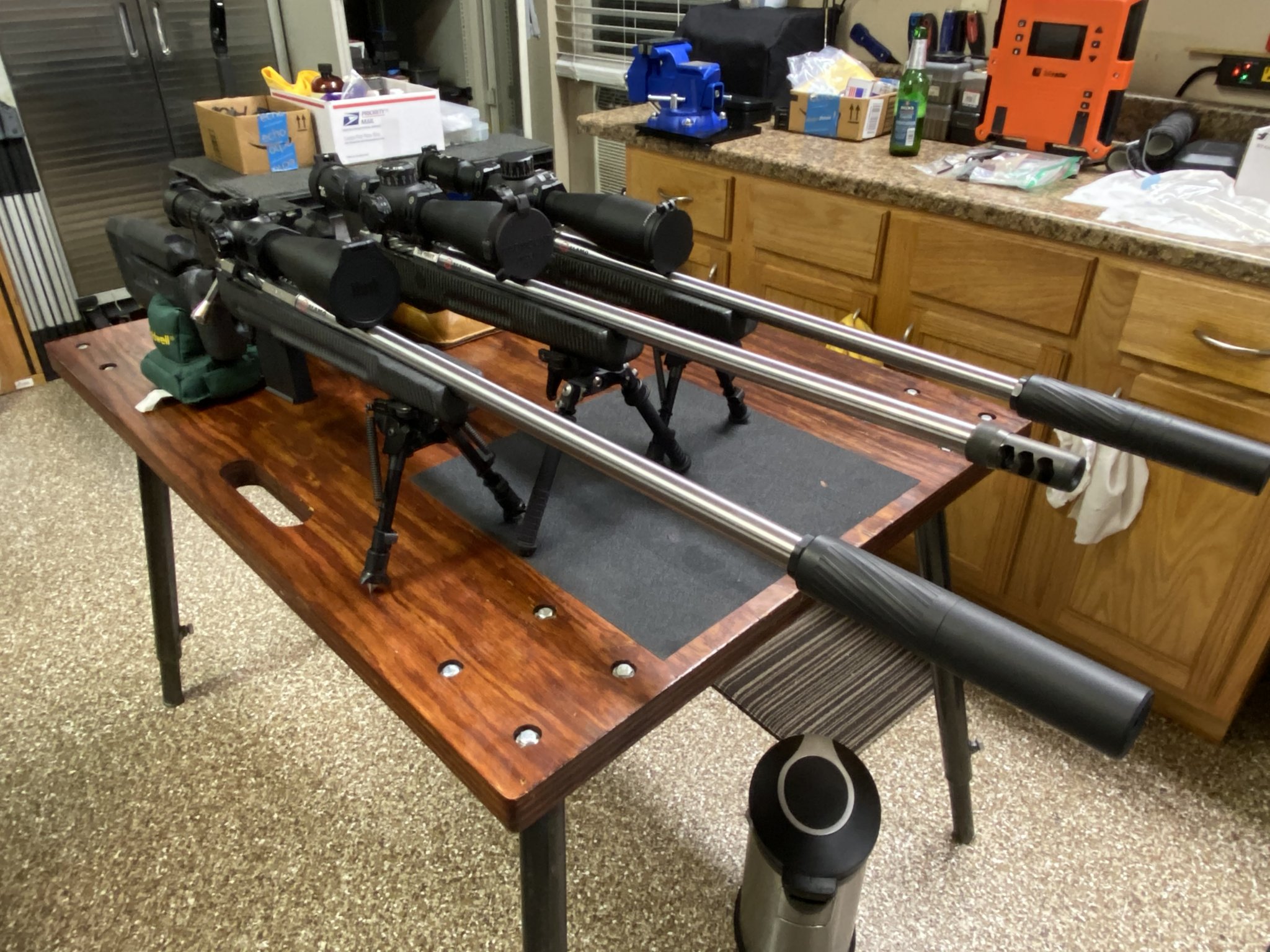

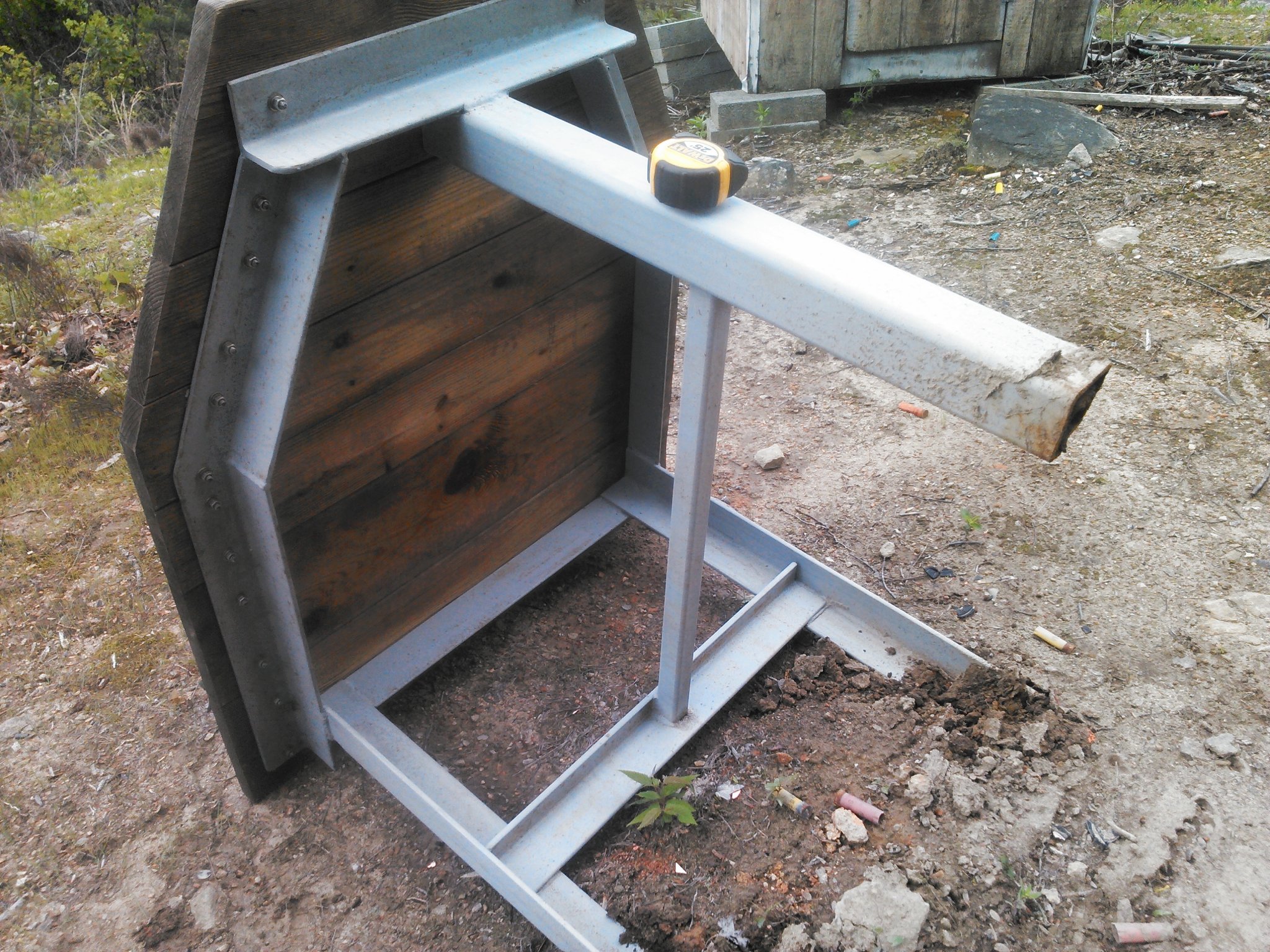

4E371F89-32BC-406D-86CD-1C2B6502BF4D.jpegI framed mine out of scrap angle.. an used treated 2x6 for the top .. holding up good so far..
Reactions: Ramius

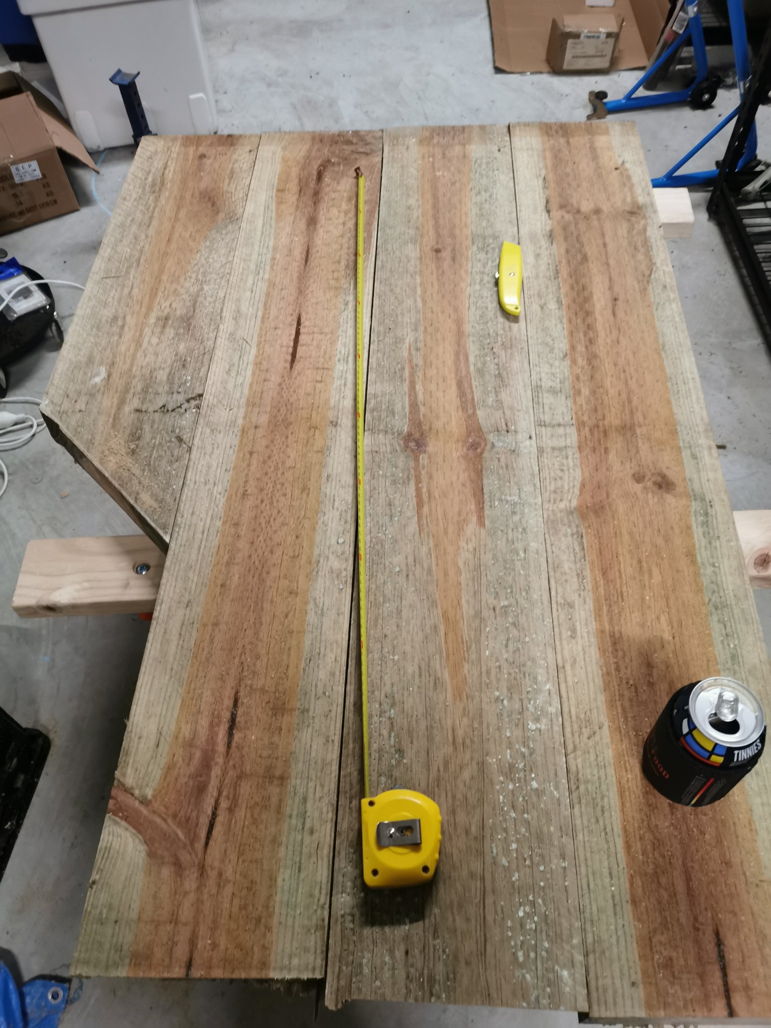

I've bought some treated pine sleepers to make a bench out of 2 x 8ft sleepers.
Should give a front area of 32" that will taper to 16" at the rear length will be 4ft.
With some treated 2x4 for braces.
Feet wise I've went with saw horses which will be screwed to the top table shall be a little lower than a standard table. Seat wise I'm hoping to use a plastic milk create with some sleeper off cuts to boost it up followed by a outdoor cushion for comfort.
Which means it will be 100% outdoor friendly and moveable by myself (just)
I have some marine carpet I plan to cut to size to use for the top, which I can roll up and keep behind my ute/truck seat. Which will mean I can also use it for prone shooting.
If its still to rough I can quite easyly cut some thin ply or similar for the top.

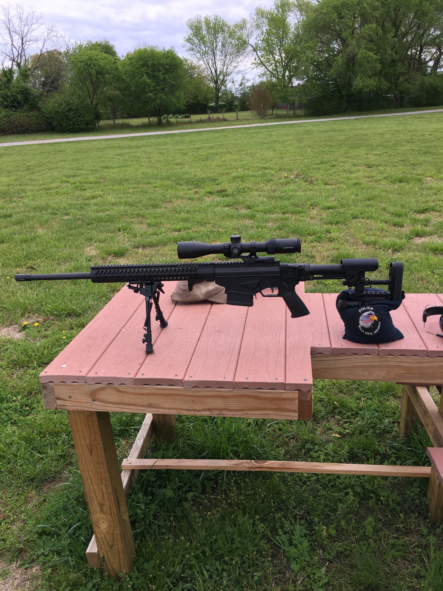

Here is the table so far. Please note back leg will be rotated 90 degrees. I decided bugger my 1 or 2 mates that are leftys. This gives me a 32" front and 24" rear.
A 165mm/7" circular saw juuuuust deep enough but will fix the end cuts at the end.
Table is a touch low may table top is 27" high my milk crete seat is 13" high.
I may need to use the 2x4" to bump the hight up a touch.
I'll grab my file rest and a rifle with a bipod to see how it feels height wise. However I'm I australia and don't want to let my neighbours know I have several firearms. Over the back are pretty darn dodgey 24/7 fighting in this lockdown.
So far pretty impressed how simple and half decent it looks maybe my cheap saw horses will only last a few years but meh top should last ages.

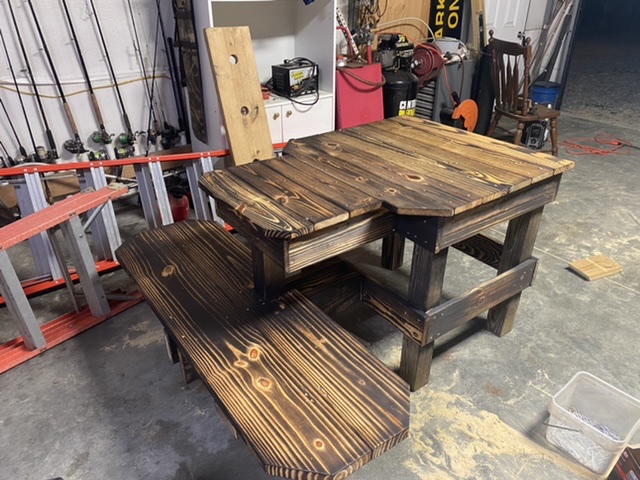

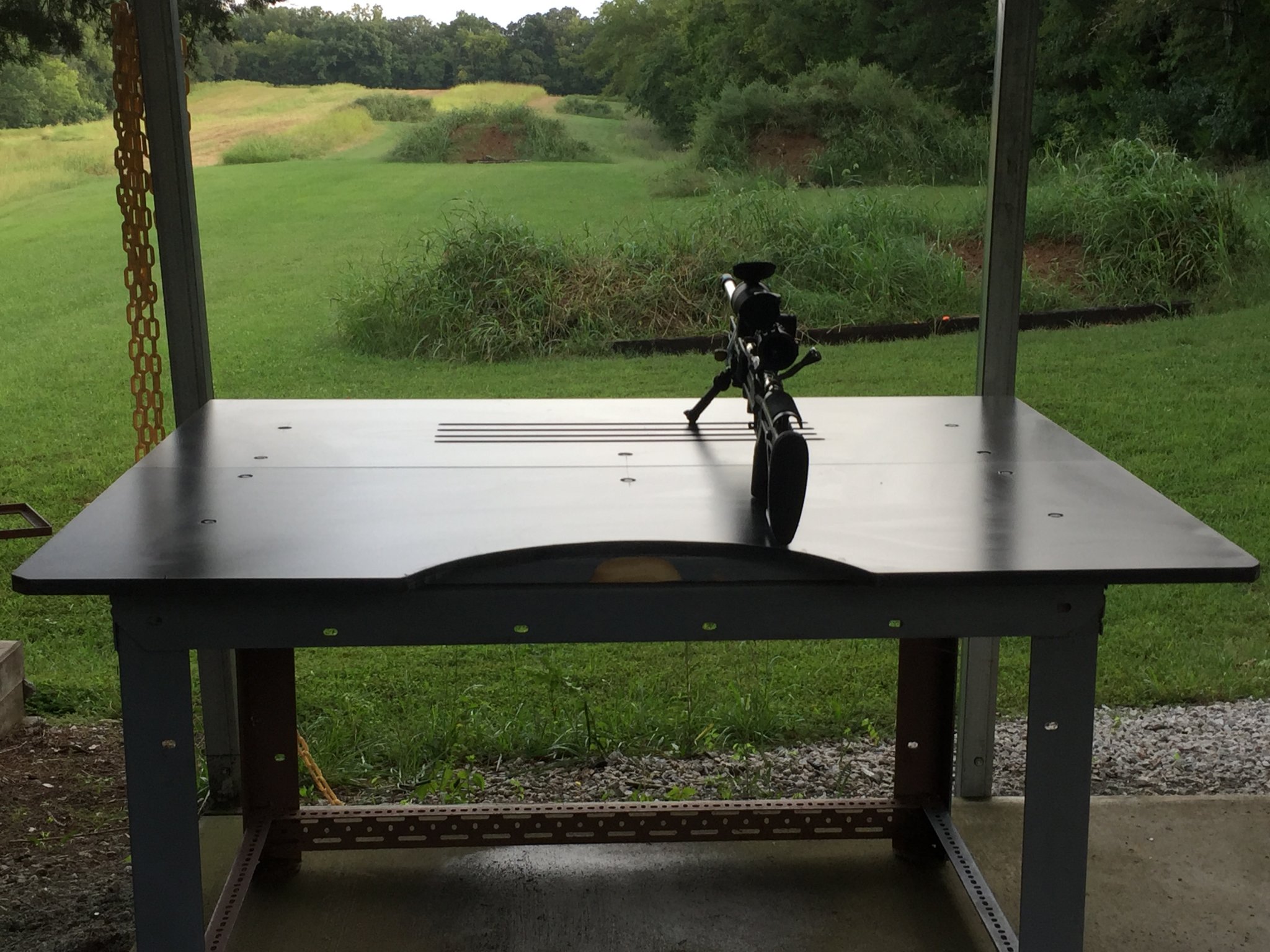

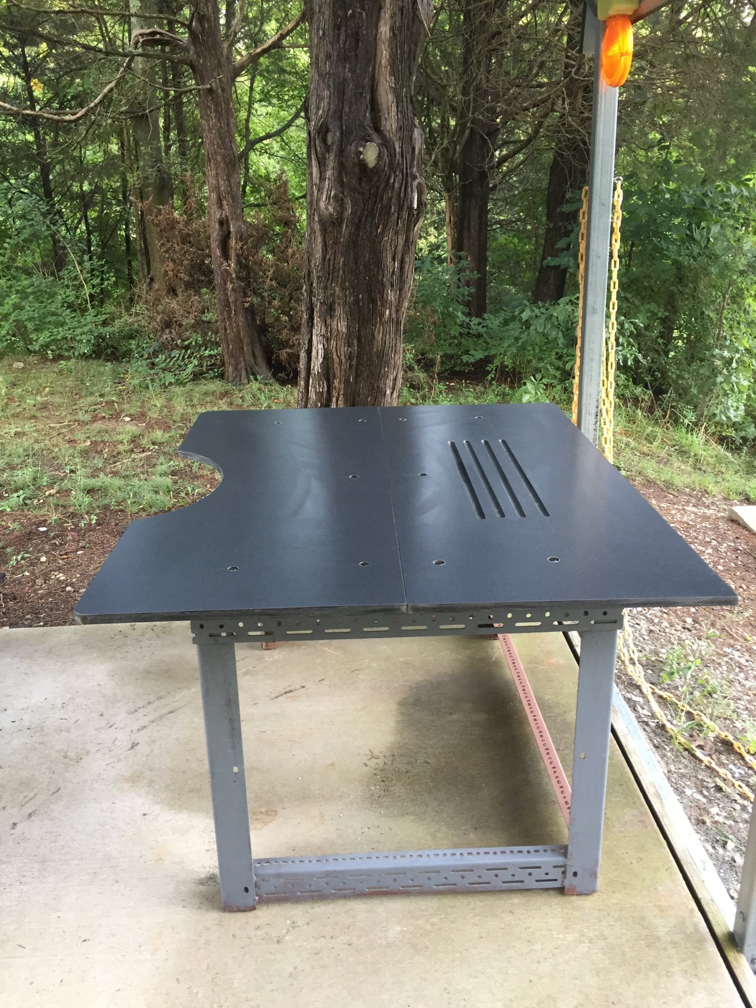

At a club I was a member at I did this( see pics ).
I found some pieces of industrial racking and ended together a simple frame. Also scavenged a restroom partition that didn’t get used on a job and bolted it to a treated wood top. Super sturdy and weather proof. Even was able to give it a few convenient features.

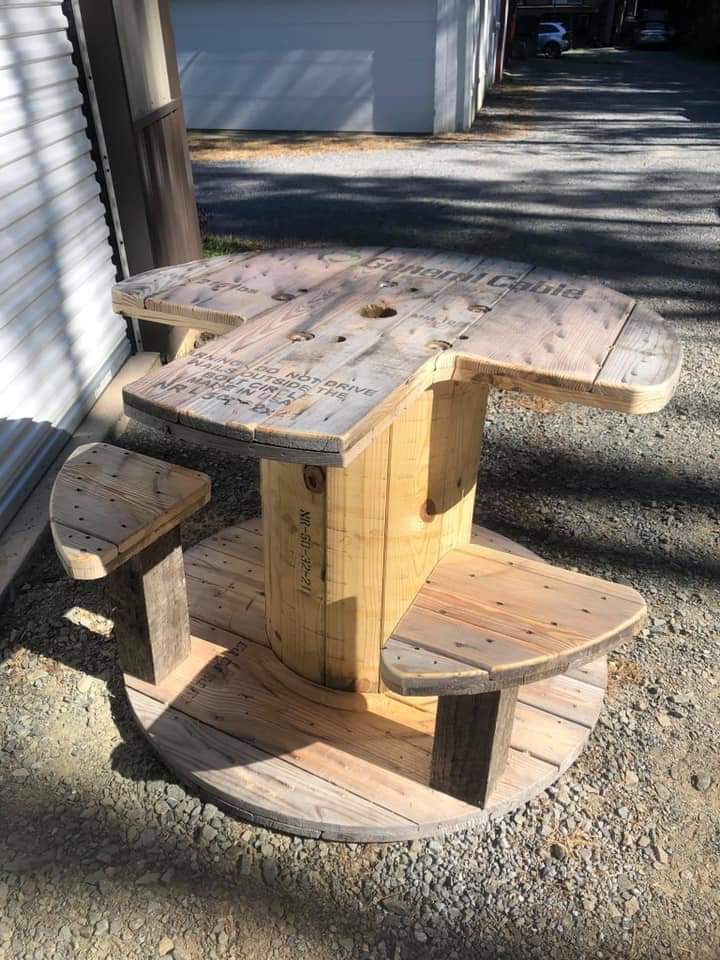

I have access to a small property now and I’m going to use a heavy duty Shipping pallet/ skid and attach legs to it. The top deck boards are 2x6 and it’s roughly 5x6’. A few good coats of deck sealer should do the trick for most of the year.

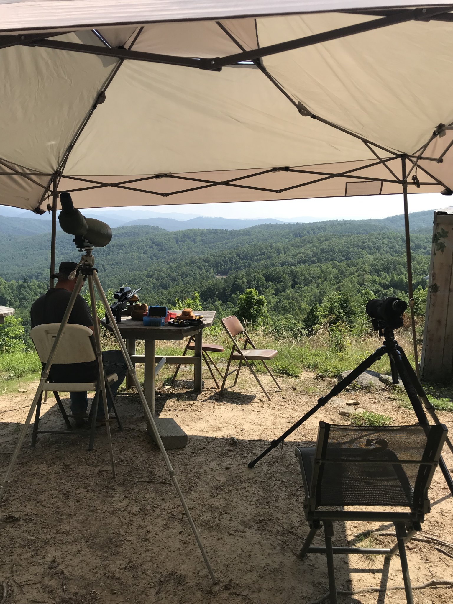

As far as cover goes, I would t leave a pop up outside all year. They’re not meant for that in my opinion. Try Costco or Sams for a more permanent “car port” or “garage” type or cover. If the soft cover gets ruined usually they sell replacements.
Another idea is to get a wall tent angle bracket set that you can customize with DIY conduit pieces. Those conduit diameters can be large enough to screw in to (steel panels) or you can use canvas tarps.

BTW nice looking table, I did look at doing similar but new racking was crazy expensive.

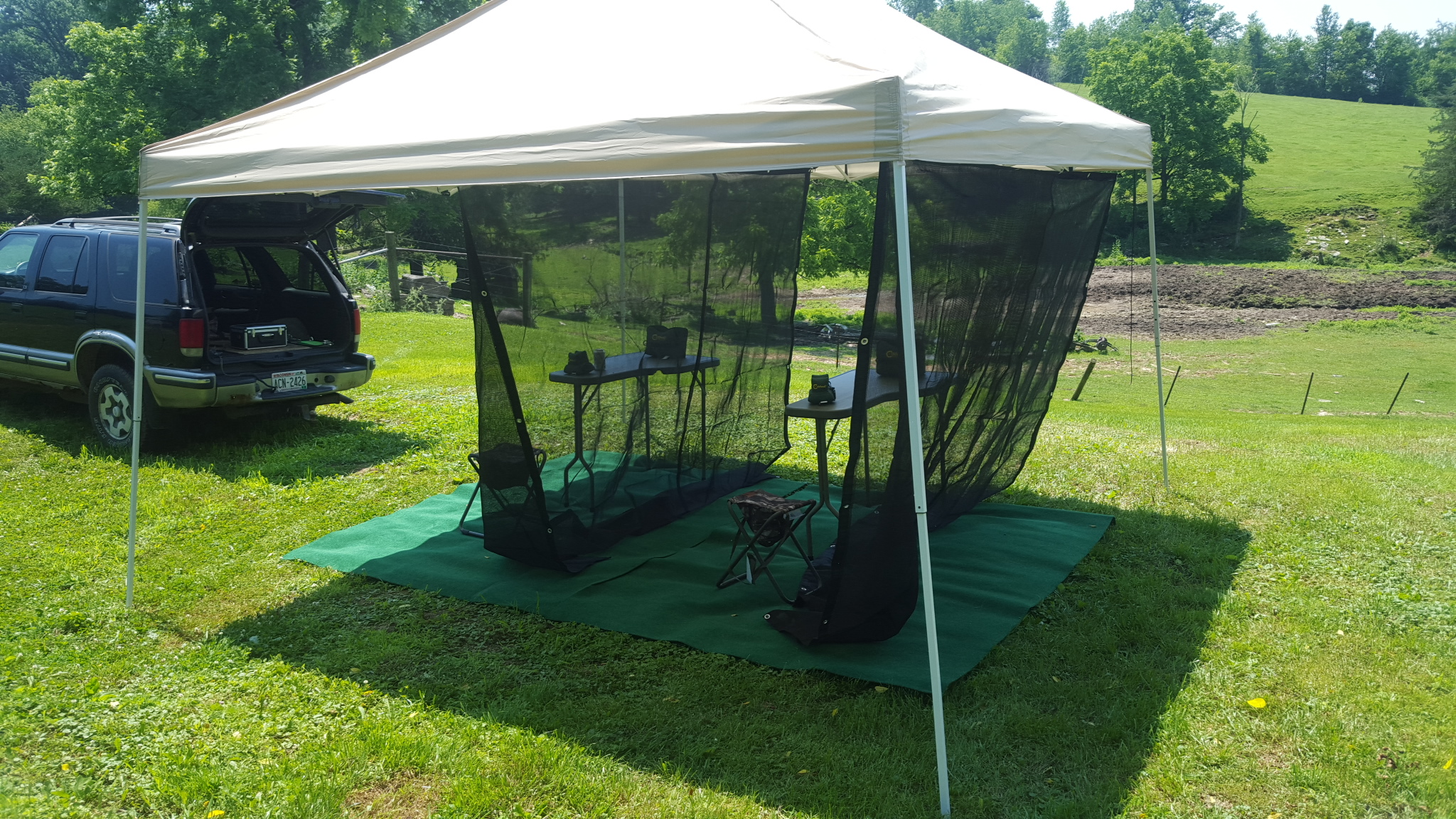

I prefer to keep my crap portable. I bought an old beater blazer that I keep everything in. This makes it possible to go shoot anywhere I want and have shade, benches, carpet and screens to catch brass no matter where I go. If I get an invite from a buddy I just grab a few guns and toss them in the blazer and go. This was shot in my back yard. I have 3 ranges on my property so portable is what works for me

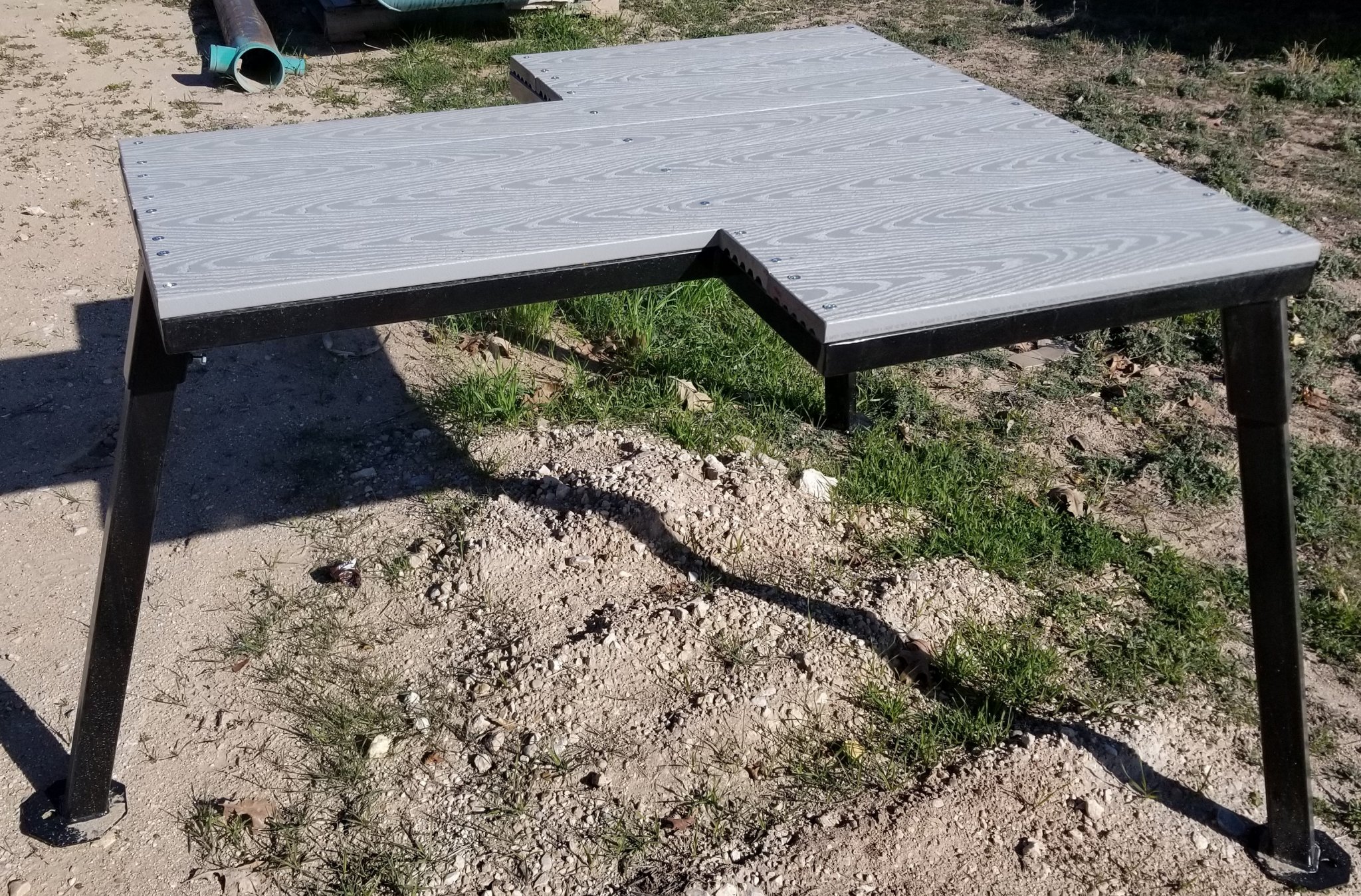

I have the single of this version with that I topped with the same composite decking material. It has been powder coated and hasn't shown any signs of adverse wear from being left outside. The guy that makes the frame is in San Angelo, but would be very easy to copy or modify as you needed.

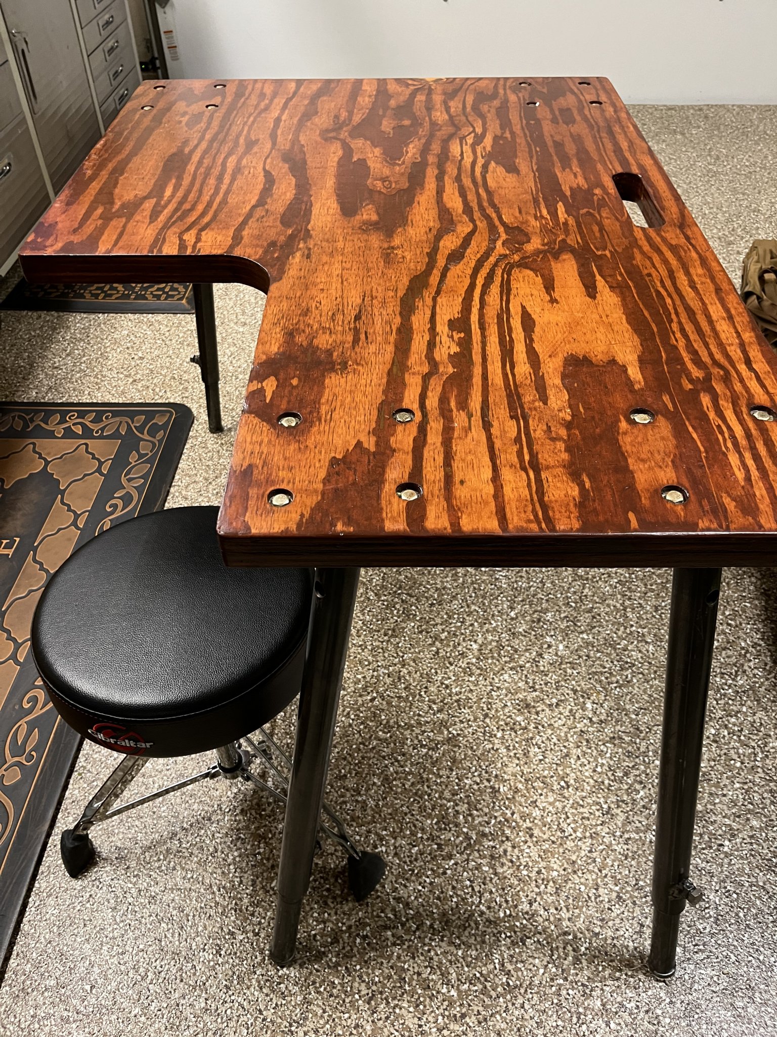

Question on your table. I'm assuming at some point you have shot from a less than stable table and you get that little wobble bobble. If I'm on a concrete bench it's just beautiful no motion at all. My bench meh could be a lot better. Looking at your build I'm going to guess that mofo doesn't move a mm looks like a tank. Is that an accurate assessment?

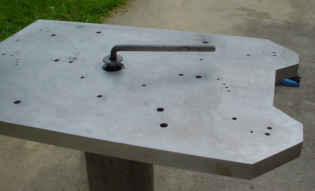

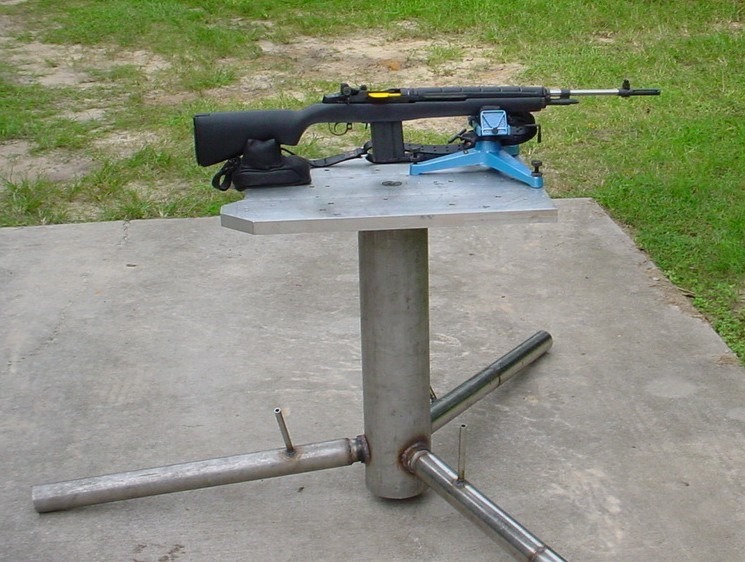

I use angled flanges build by a guy off 24hourcampfire and 1.25" NPT threaded pipe. Height fits me great, but darn if I have not figured out how to get the teeny build of wobble out like a concrete bench.....it may be that this is just the limit of it. Thanks for any insights. This is pretty much what mine looks like(same flanges, pipes, stacked-glued-screwed).
Have you tried unscrewing a leg or two until you get good contact im assuming the ground isn't perfectly flat. Also might be worth looking into putting some larger feet on it to disperse weight that way it won't want to sink into the ground. Great looking table by the way it looks pretty portable!
Yea we have tried different point of contact: sand, grass, when it's muddy will sit on it to anchor in a bit. That table is from the thread where I found the flanges, but not mine.....looks pretty much like it. His grass is too nice to be my yard! Thanks for the ideas on feet. My *guess* feels that it's a tiny bit of flex going on and not the table shifting off the 3 points of contact. Since I have 3 legs that left rear section is kind of hanging there w/o support. Thanks
Same concept, but smaller OD pipe inside attached legs allows for each leg adjustment.
Ah I missed the part where it was only three legs. Maybe try adding another leg temporarily just to see if it helps.

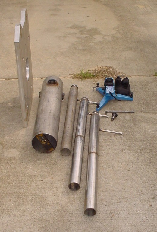

Grass, dirt, gravel - works great. Can‘t take credit for the design. I spoke at length with the gent who provided the angled mounts and went with his recommendation. He’d built a bunch for others and settled on the design and shape as the most stable. His name is Greg Culpepper, great guy.
“Get four pieces of 1 1/4" black iron pipe 24" long threaded on one end but reamed on both ends. Drill a 5/8" hole all the way through 4" from the threaded ends for tightening with a screwwdriver or similar tool. Drill 5/8" holes through one side 2" from the unthreaded ends for clamp bolt clearance. Weld a SS 1/2" nut (supplied) over that hole. Chase the threads in the nut to clean up after welding. Get four pieces of 1" black iron pipe 15" or longer if you want and weld a washer (supplied) to one end for the adjustable part of the leg.”

Usually when I see someone shooting from a bench with a cutout in the corner they are leaning sideways over their rifle, instead of directly behind it. My bench is a rectangle and the shooter sits behind it. It makes it a lot easier to square up my rifle and shoulders with the target.
