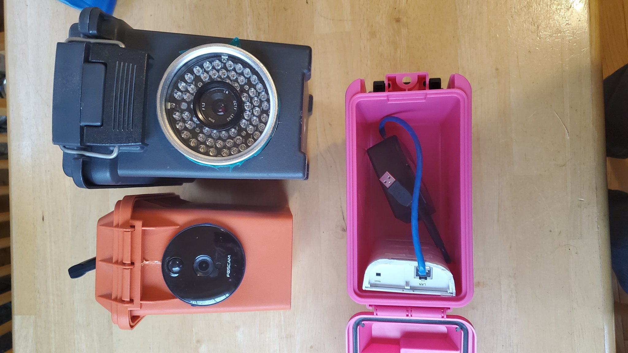

Thought I would share about a target camera I build a few years ago, well really it’s just a copy of the Bullseye target system. I hadn’t looked up the company in a while and now see the original owner sold out? and they have a new version that looks pretty sweet. Seems like a nice design with an movable camera and external focus adjustment?. I also read some comments on the new phone app not working with the old ammo can system, another reason to post so I can comment on that.
This is not a build guide but just what I did and some basic incoherent rambling
When I first saw the bullseye camera system I was really curious and thought the software was pretty cool. I checked out the demo version and windows app to see how it connected to the cameras, plus scoured over all the videos and pictures I could to see what hardware it used. What I found was it used ip security cameras either wifi or Ethernet with a mini wifi router or a wifi point to point bridge for the long range version. The original version looked like all basic off the shelf parts so I figured I could make something work.
My first version used the larger camera and mini wifi router. Over time I changed parts out and now use the smaller camera and the point to point bridge. The current version I have used at 600 yards at the range and did a test at 1000 yards in falling snow down a road with good connection. Theoretically the wifi bridges claim a distance of 10km but I suspect with dirty usb power and imperfect alignment it will never get that far. I haven’t tested a max range but if I remember right it was like 70-80% signal at 1000 yards?

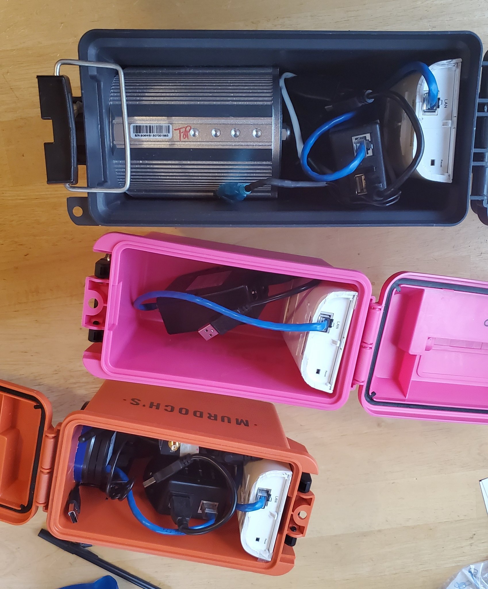

The setup is a ip security camera powered by usb connected with an ethernet cord to the wifi bridge powered with an usb to POE (power over ethernet) injector. A dual usb power brick powers it. Originally I did a power draw testing but that was 2-3 years ago so no idea on what the load was.
Hardware:
Camera 1 (v1 large can)
Ubiquiti locom5 wifi bridge (bought used)
Foscam f1806w ip camera
tycon usb to POE injector
USB power bank (already had)
Camera 2 (v2 small)
Foscam C1 720p ip camera
Receiver (pink can)
How it works is pretty simple. The camera side connects to the other shooter side wifi bridge with its fancy point to point wifi and the receiver bridge also outputs a wifi signal to connect to. Basically its just like a network at your house with a network security camera.

The software will only look for one camera with an ip address of 192.168.1.252 with no ability for users to change. Since I had an extra camera I set its address to .251 and edited the software code to use that address. This allowed me to setup and use both cameras at once each with its own software. I was even able to do this same trick with the android app. So one app opens camera 1 and another opens camera 2, I get to use both cameras at the same time at different distances with the 1 network. This does require properly setting up each wifi bridge

Overall once it is configured properly the system works pretty well. Connect power, drive out to the target, use my phone to setup the position, drive back and I am shooting. The most important note I will say is I built this a few years ago and then bought a proper spotting scope hahaha. Sure it’s cool but unless I am shooting paper past 500-600 yards which can be hard to see paper holes in I never use it. But when I do it’s nice to have. So maybe 5 times a year... my range goes to 600
