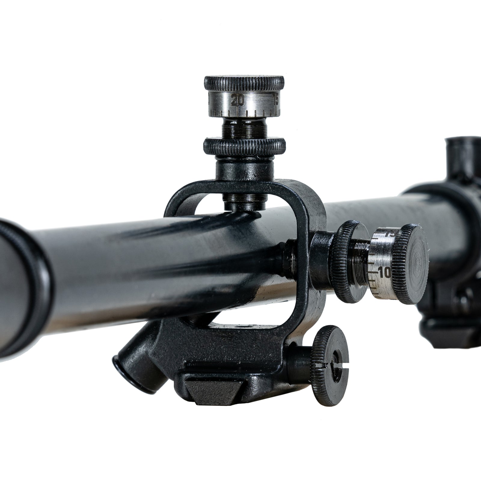

I like to use plain fine crosshairs on old friction adjust turrets.

I tried to get my brother to let me help him with one of his rifles, a sporterized 03 with a duplex scope in 30-06. He figured that if he sighted in 2" high at 100 yards, he'd be good to go. The very next month, he ranged a huge muley buck at 400 yards and missed it. Twice. He's a damned good shot and it was very pleasant to see him so humbled..HAHAHA
Even a 3-9 duplex second focal plane scope can be dialed for elevation by using the zoom feature. But you gotta know how far down the top of the arrow on the fat part of the reticle is. You can fairly accurately guess 1/2 or even 1/3 or 1/4 of that distance. If you shoot it at say 3x at the top of the fat part and then again at 9x, your bullet will impact in different places. If you figure that out at 3x, 6x and 9x and then take some practice shots at each of those zoom levels for 1/4, 1/3, 1/2, 3/4 of the reticle and write that shit down, you can use a laser range finder, look at your DOPE, choose the zoom and hold...
