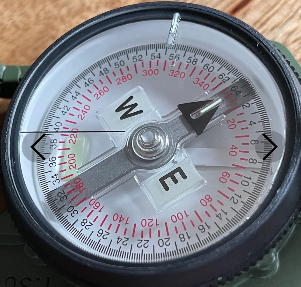

I agree with all that, but what about land navigation? That’s angles and minutes, or is there a method that’s mil?

One minute true north or south is basically one nautical mile, east to west, it trends to zero as you get to the poles.
One degree is sixty nautical miles.
One second is one hundred feet.
So your hundred yard zero is a three second distance to target.

Heard stuff guys dicking with the M551 Sheridans (before I got out the first time)were saying about calibrating its system, but don't remember much about it. The 551 was the hot rod of armor in its day & could chunk man made sunshine, also.
If memory serves me correctly, there are actually a little over 6,283 MILs in a circle. However, the US military uses 6,400 MILs. IIRC, the Soviet military used 6,700 MILs.
Don't ask me to explain it. I just accept it.
There are 2π radians in a circle. There are 2000π mils in a circle. So 6283.18531..............
Soviets used 6000 which is divisible by 12 and makes sense to me. There are 500 units between every clock number...also easily divided by 10.
6400 does not make any sense to me.
The rounding, in both cases, is about being able to do some math easier on a big gun before every private had a calculator in his pocket. But..why not go with 6300 so its a little closer? Or...better yet, 6360? I'm sure some French mathematician assigned to an artillery piece came up with it just to be different.
If you consider the Soviet system, each clock minute is divided by 100. Decimal minutes? Uh oh.
