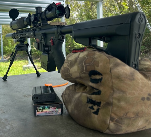

I use the sunshade on all scopes/rifles that can equip them. The shades do a pretty good job of keeping rain/dust off of the objective when the lens covers are open.
This one looks a bit goofy as the shade overhangs the handguard, but it is effective.
