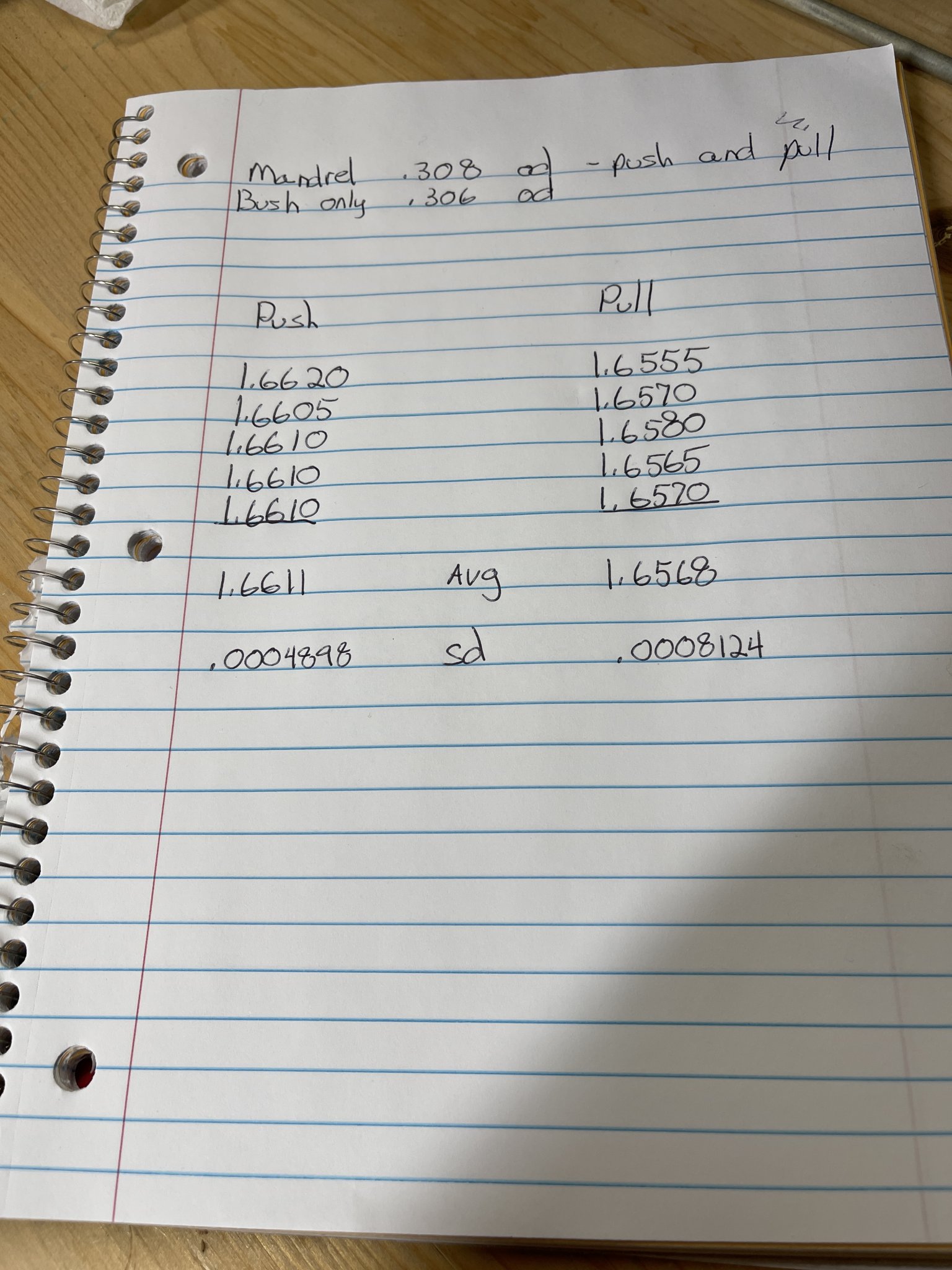

Interesting results. It appears the shoulder is shorter on the pull than on the push. I thought I might have gotten confused so I replicated it. Only an assumption but is it possible the lack of time between the bushing and the mandrel on the pull…. Hell I don’t know.
Push 1.6611 average .0004898 sd
Pull 1.6568 average .0008124 sd
Two things are certain. The push is more consistent and I refuse to tell how I determined my sd in light of recent events.
In conclusion is far too small of a sample with on 5 each to draw any serious conclusions BUT there was zero overlap between the two.

It’s also worth noting that the push is longer than my fired brass. I double checked that as well. My die is set up for the pull with a .002” bump. 1.6590” fired.
It’s also interesting that my bushing is .308” but bushing only yields .306”. I would have thought bigger if anything.
No, I’m not drinking, yet, and I do understand numbers, maybe.

Did you use that dirty population sd???

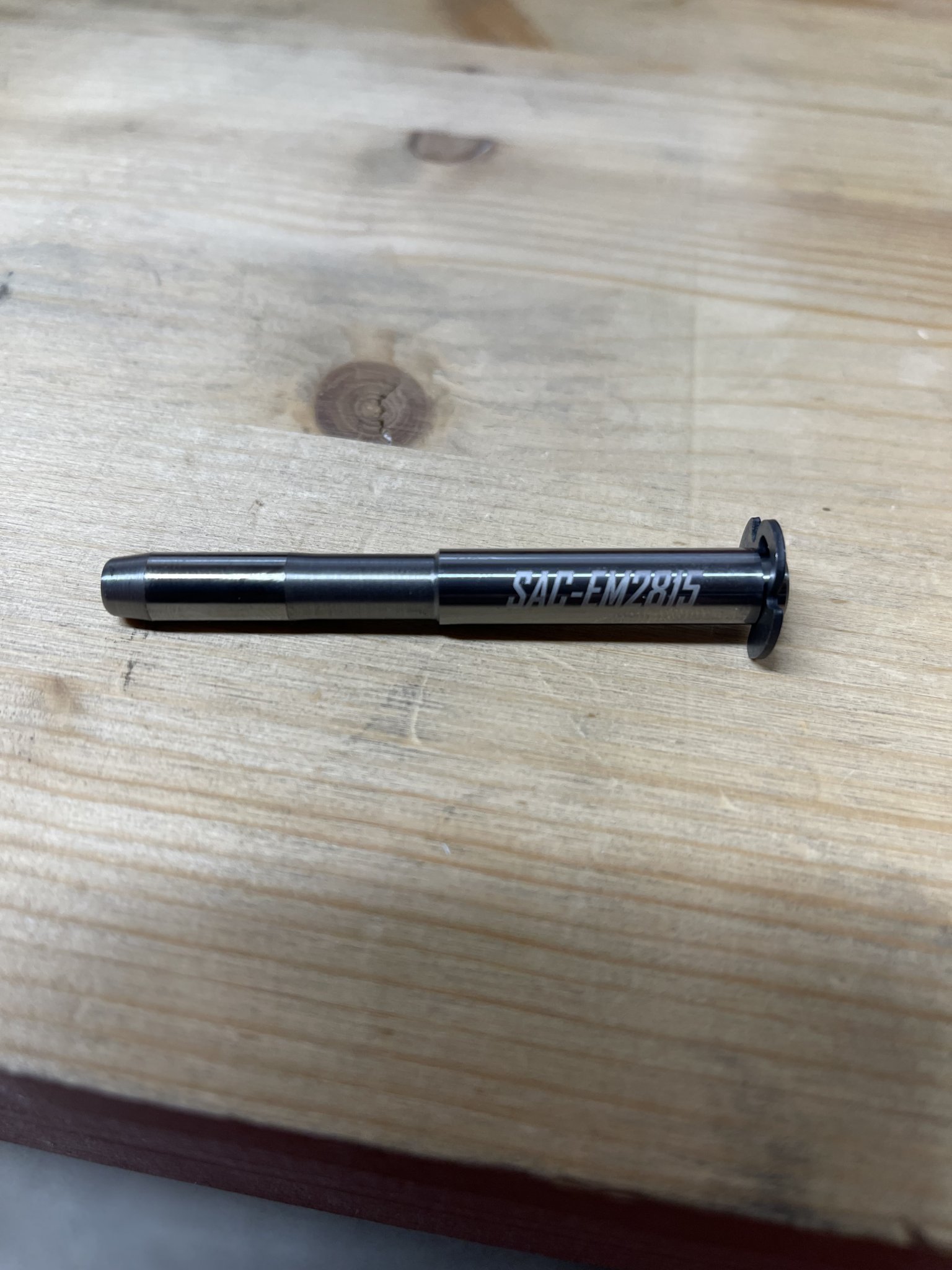

Interesting. Did you replace the mandrel with a regular decapping rod?
I don't own one, but - I know you can adjust the headspace of those dies with shims, I don't know if running rod-less (giggity) affects how the collet system and/or neck shoulder bushing sits.
wrt to SAC bushing die "mandrel"....to me, this is just a long expander ball. What would be the difference?
Now, I'm not saying it doesn't work...never used one. Probably works very well.
And I'm not saying that pushing a mandrel vs pulling a long expander ball generates better results. I defer to the testing gurus here for that.
But, IMO the terminology has gotten beaten up a bit for marketing purposes.
