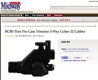

I have used these for years and think they do an excellent job on trimming brass. Any comment about them?

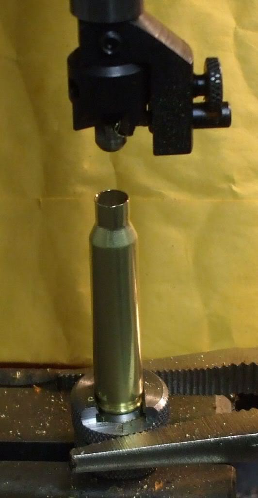

This is trimming, inner chamfer, and outer chamfer every 6 seconds with drill press or vertical mill with the RCBS 3-way

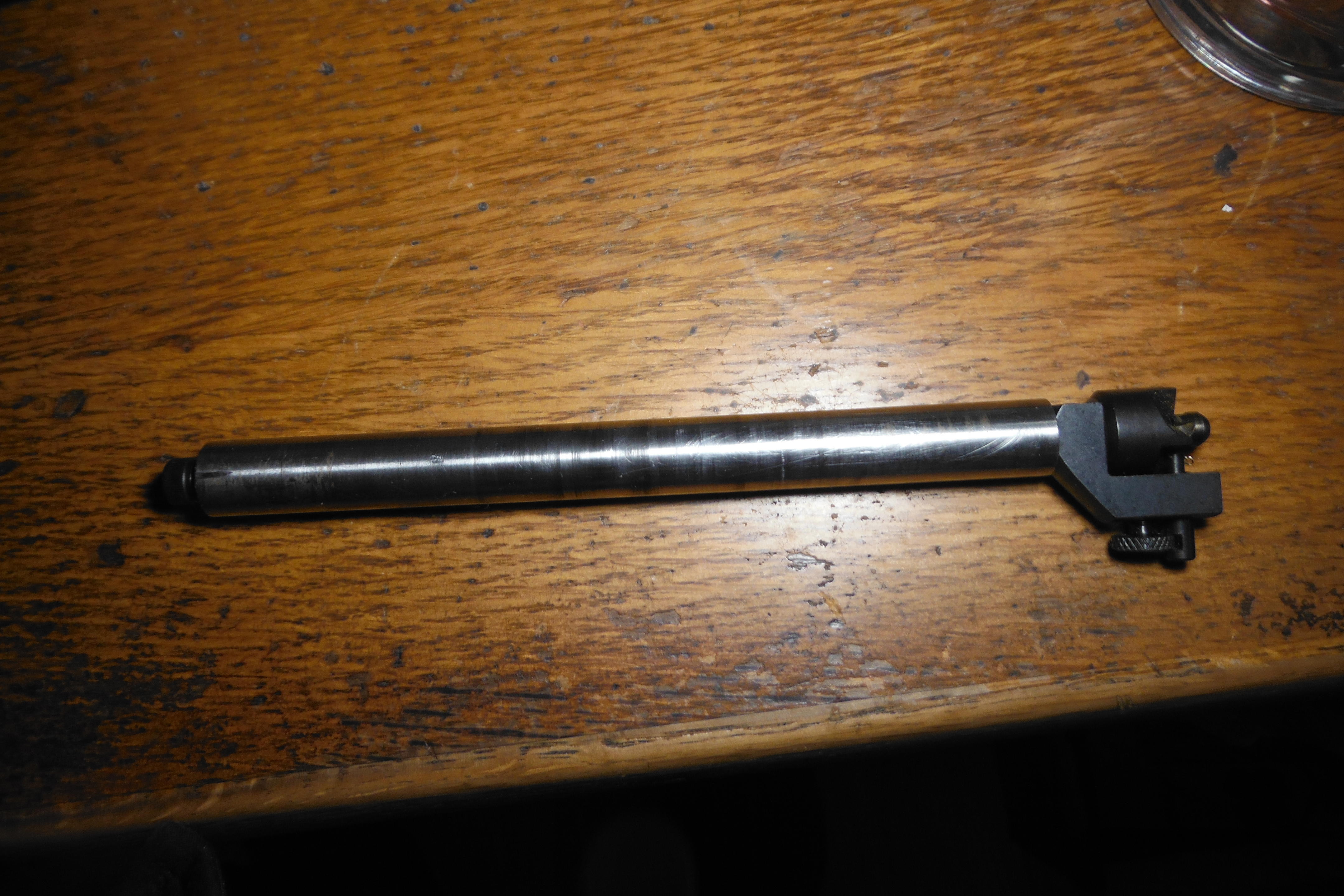

Is this your set up in the video? I have one of these three way cutting heads I bought for my rcbs trimmer I used with a hand drill, but I also have the forster power trimmer on my drill press and find it is easier to use. I would love to mount the 3 way cutter but not sure how to chuck it into my drill press. What did you use as a shaft/adapter?

Yes, that is my video.
I took the 0.0495" diameter shaft with 3/8-24 UNF class 1A internal threads [that fits the RCBS 3-way cutter] from my RCBS Trim Pro manual trimmer.
A breakdown can be seen on page 12 or 13 of
http://www.rcbs.com/downloads/Parts_Book.pdf
RCBS Trim Pro 2 RTC Cutter shaft (3) [RCBS part number 09405]
I either put that RCBS shaft in a 1/2" chuck in the mill or a 1/2" R8 collet in the mill.
I have had the RCBS shaft in the drill press chuck for neck turning, but that was something else.
My drill press is a 50 year old 15-017 Rockwell with 3/8" chuck that I updated to an Enco 0-1/2 X 33 JT KEYLESS DRILL CHUCK.
I updated the video notes on the parts used
1) RCBS Trim Pro 3-Way Cutter 22 Caliber,2) Lee threaded Shellholder 223, [Lee case gauge and shell holder 90114, but not using the gauge]
3) Lee Lock stud, [Lee cutter and stud 90110, but not using the cutter]
4) 1963 21-100 Rockwell mill,
5) 6" Kurt vise,
6) small needle nose vise grips,
7) 0.0495" diameter RCBS trim pro cutter shaft part number 09405

I could not get RCBS nor could I get Forster 3 way trimmers to support that in time for the 2012 hunting season.
After neck turning, I had to do the trimming and chamfering the slow way.
It looks like availability is still not good on much of the 3 way gear.
