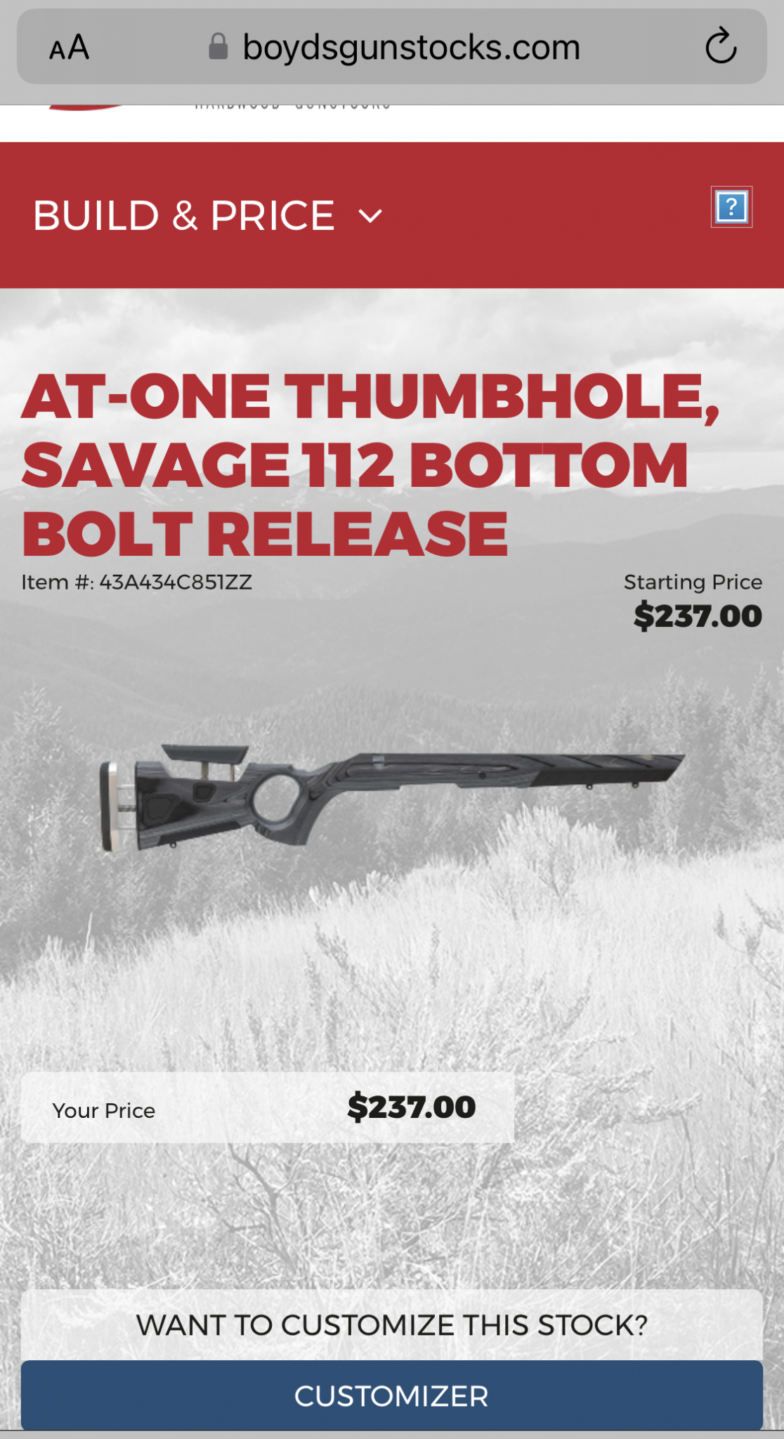

Have you looked at the Boyd’s stock line?
I did look at this, thank you for the info. I'd need to add a stock-end adjustable height device but that's not too difficult.

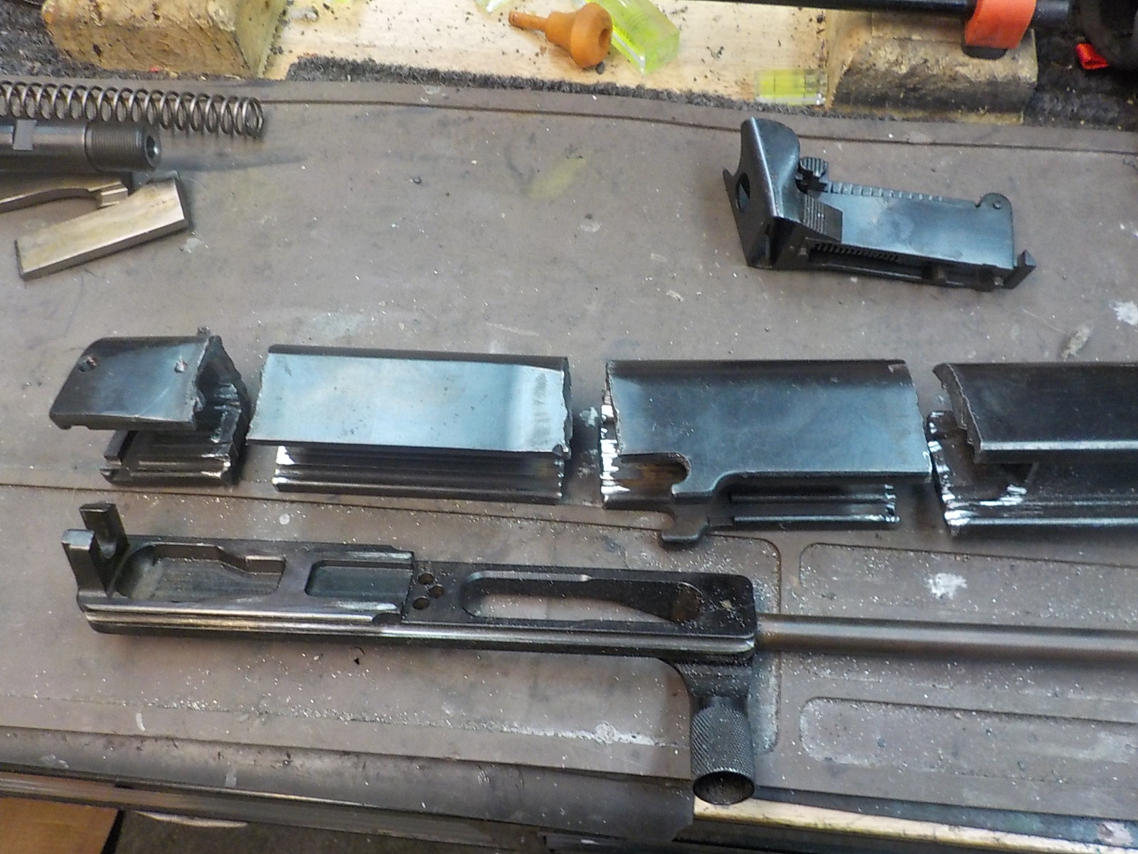

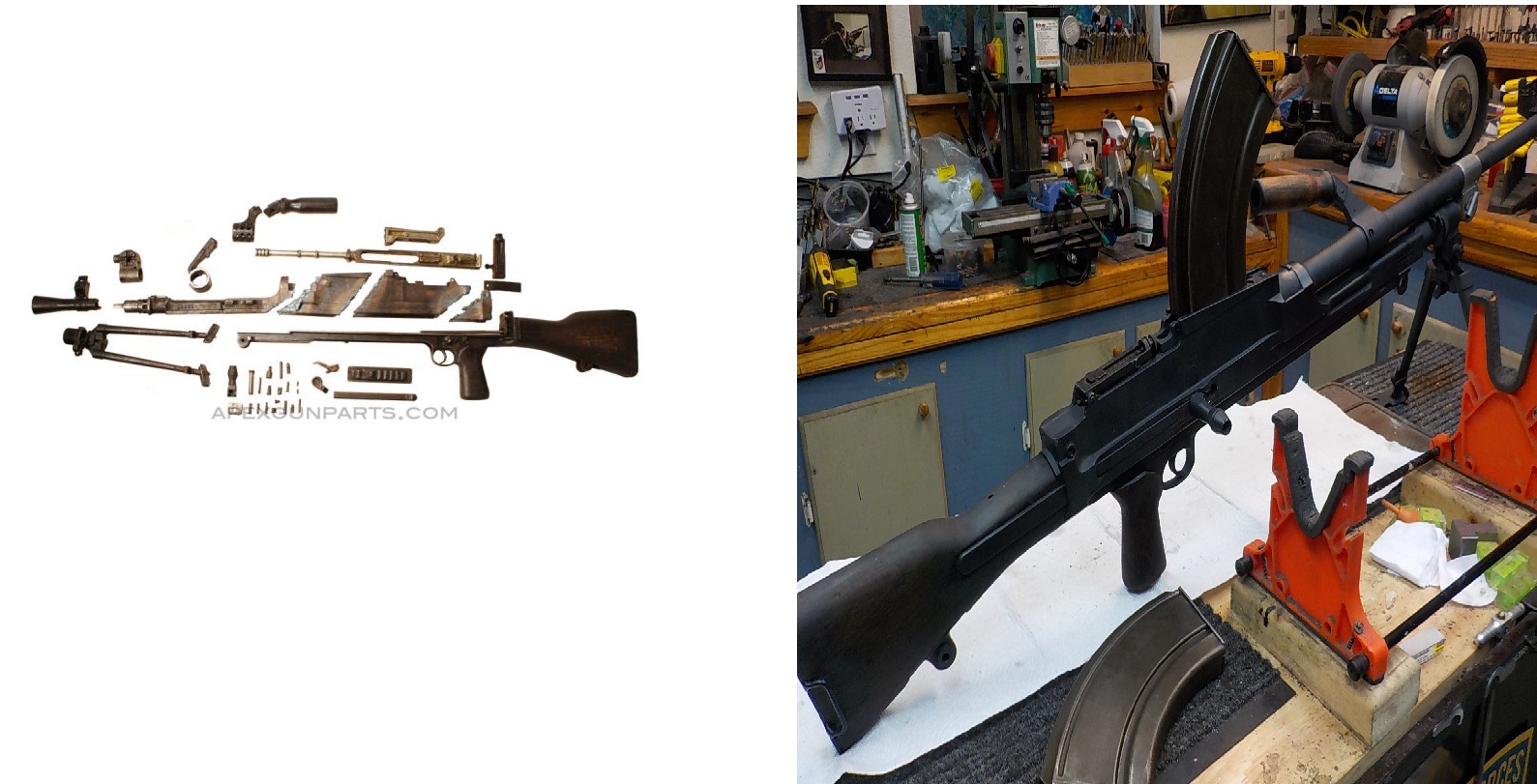

Mine come pre-disassembled
I have torque wrenches for my cars too but I don't take the wheels off to wash them.
Your car wheels being cleaned on a microscopic level don’t affect the accuracy of something you pump 100’s of dollars out the end of in competition and travel expense. You can clean chamber and throat exponentially better with your action out of the way and don’t get solvents and crap in your trigger and raceways.
