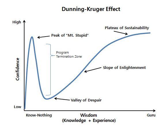

Dunning-Krugger effect, if I’ve ever seen it.
1]View attachment 7093022
