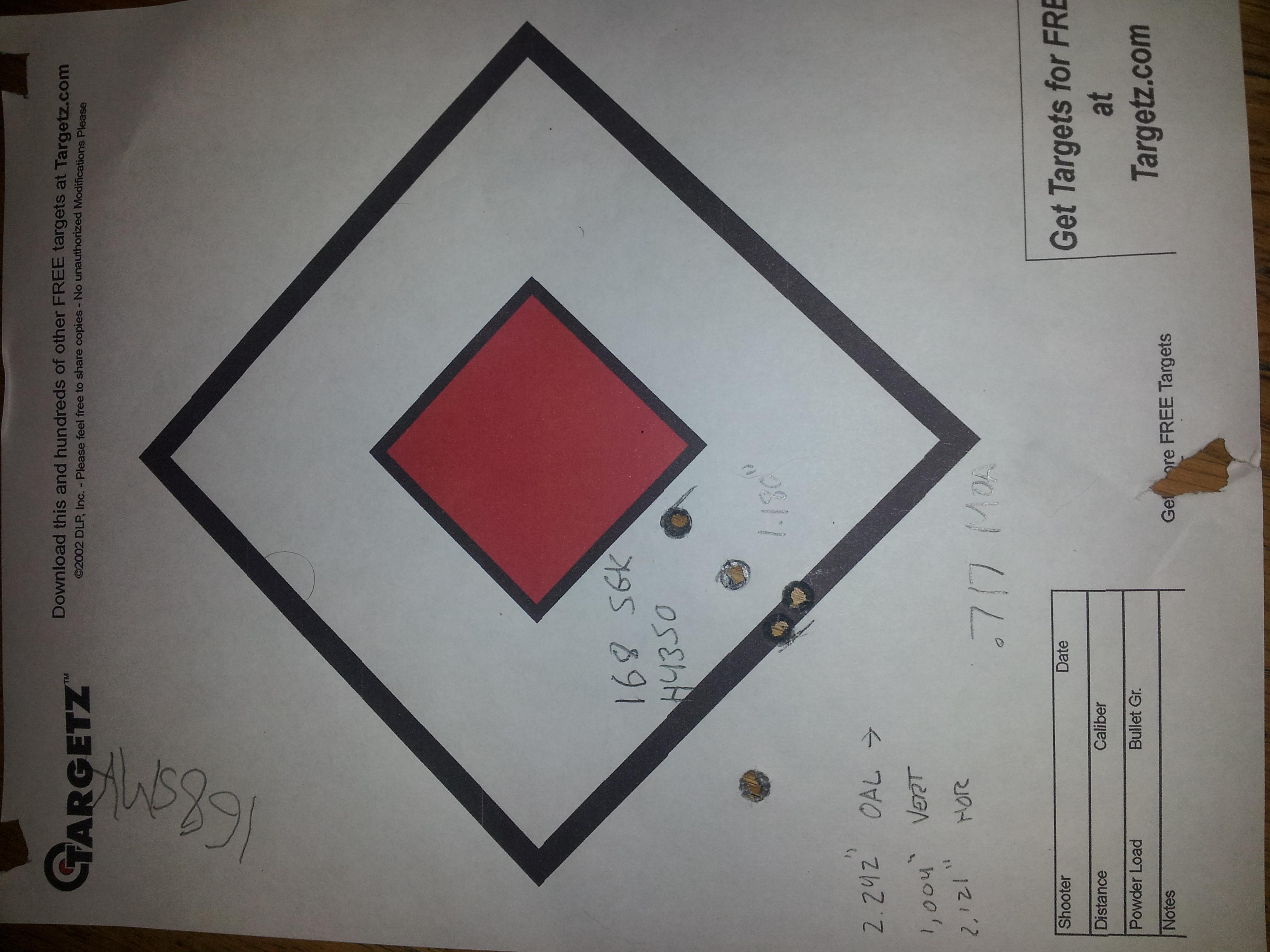

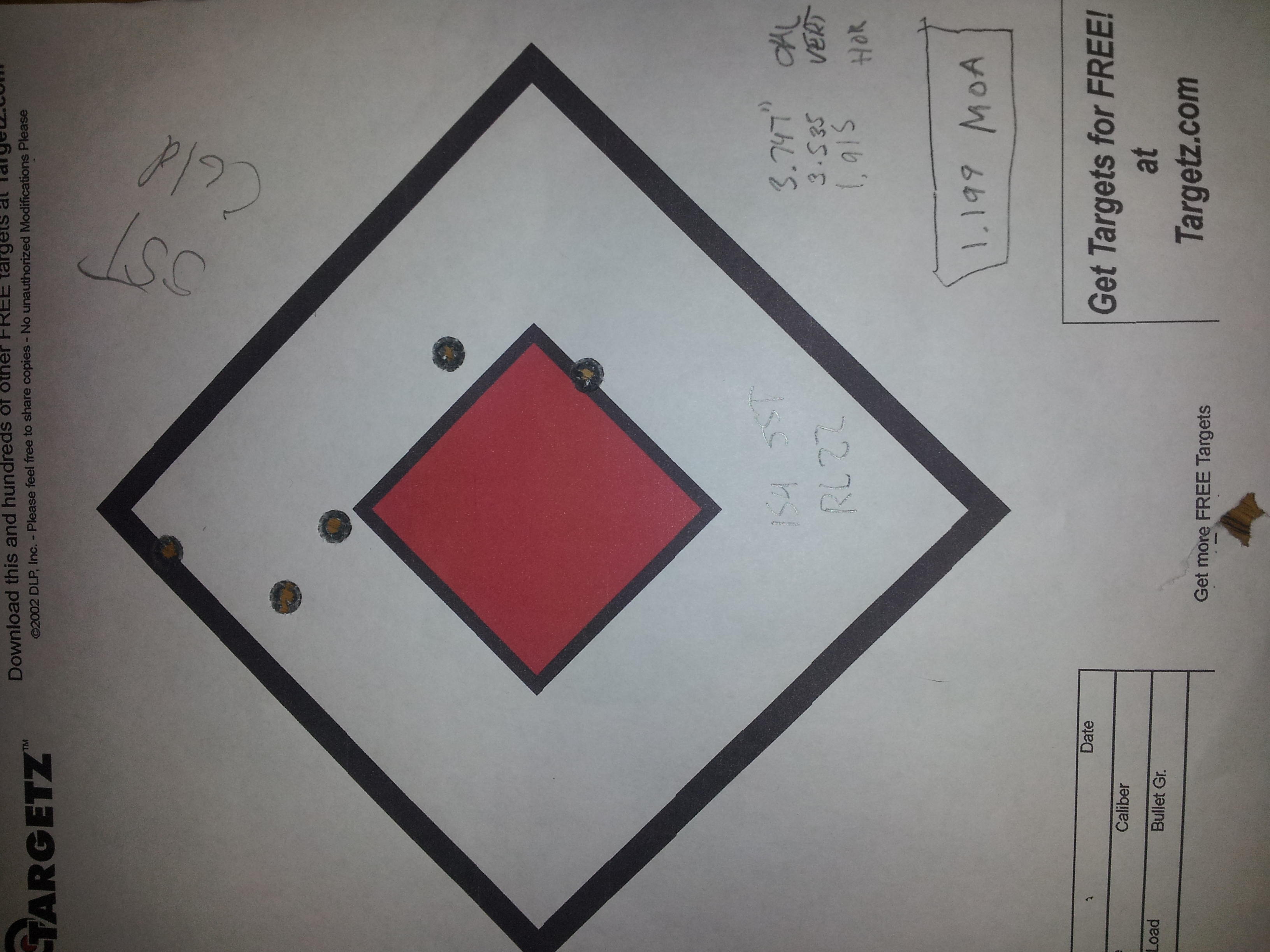

Here are the results from today, better but still poor.
There is a lot of Vertical dispersion on the Hornady SST Load (3120 fps)
Also below is a mild 168 SMK (not sgk as the target reads)... 2930 fps.
Much less vertical dispersion, and without that winger (probably me), it would have a good group.
Hope it all works out. The thing to remember about the 7mm Weatherby, is it was designed in an age when speed was king...It had a 1 in 12 twist! to launch small light bullets and be the fastest kid on the block. Today, we understand and appreciate high BCs. Those high BCs are achieved with long slender HEAVY bullets. So today's manufactures of the 7mm Weatherby increase the twist to 1 in 9 instead the orginal 1 in 12 assuming you will be using the highest BC / heaviest bullet you can get your hands on.
