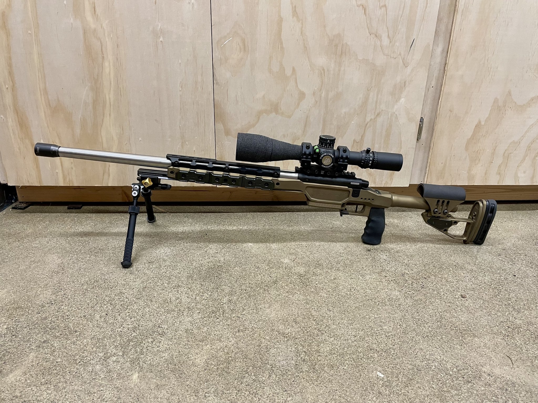

So currently I have mine in a MDT XRS that I had laying around while I wait for my ACC to arrive. Went this way as my Centerfire Comp gun is in an ACC. It does mean that the Voddoo will end up pretty heavy, which in this case is what I want. If however I wanted to use it stand alone and not as a trainer I would be pretty temped to just leave it in the XRS or put it in a quality stock.

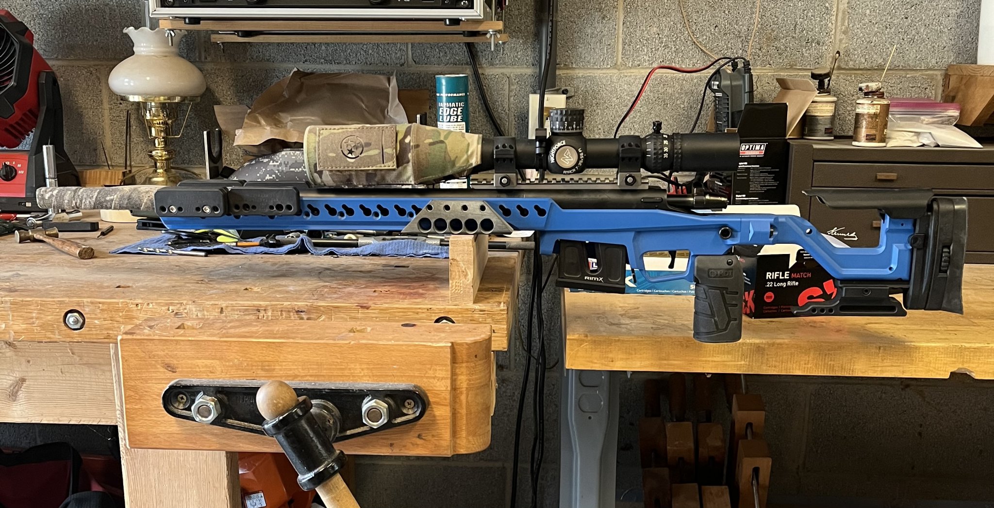

I started with a Vudoo barreled action from a member here and being in a rush to shoot it, I dropped it into a XLR Carbon with a Viper PST (Gen 1). It shot well but the balance was extremely butt heavy. Wanted to get it to more closely resemble my centerfire rifle so it now sits like this. In reading through most threads one would think you need to have a 22" MTU contour to get great balance but it would appear not

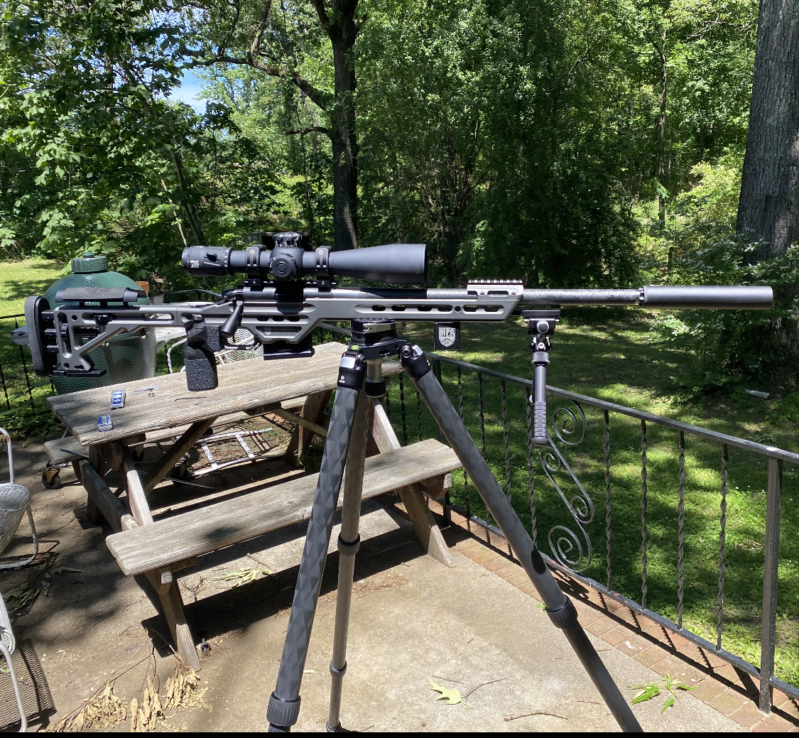

Action : Vudoo V-22 (6 x 5 posted)
Barrel: Ace 16.5" Kukri Contour - Surefire Ryder 22S Suppressor
Stock: Manners T4-A Team Elite Fill - Mini Chassis (Gen 2)
Scope: Viper PST 5-25x50 (Gen 2)
Trigger: Timney 2 Stage (8oz / 8oz)
Arca Rail: Area 419 12" Arcalock
Bipod: Ckyepod w/Gray Ops adapter / Area 419 Clamp
Weight: 13lbs 14oz (As pictured)
Dream rifle? Maybe not, but once I upgrade to a NX8 it will match my centerfire and is way more fun to shoot than I ever imagined. :cool:

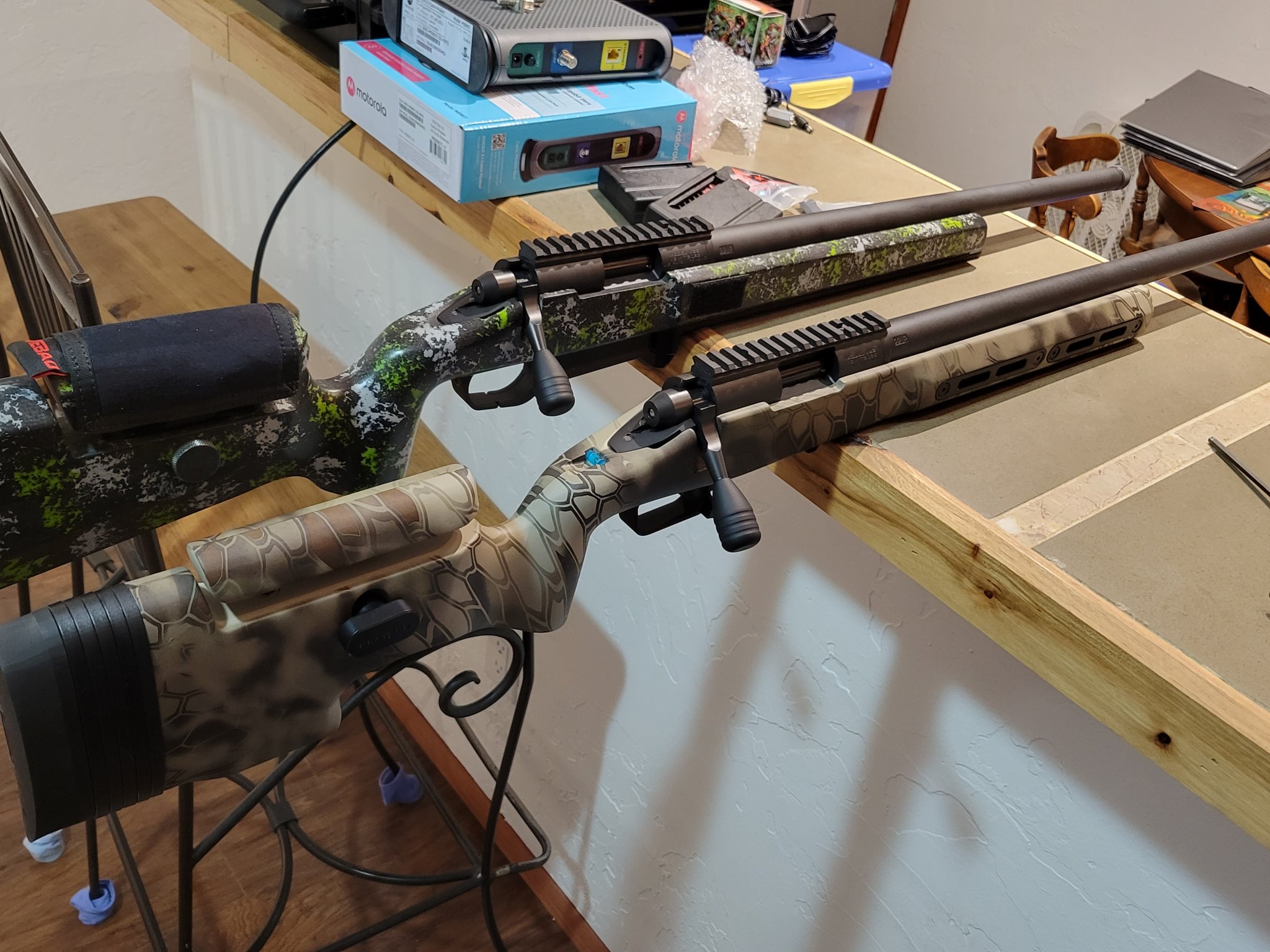

Somebody at my local club showed-up with a Vudoo action placed into a dark distressed Foundation stock. That was easily one of the prettiest rifles I've ever seen. Currently, I'm putting the finishing touches on a Vudoo mounted in an American Rifle Company Xylo. Total overkill, but I decided to treat myself for Christmas. The Xylo seems to straddle the best of the stock vs. chassis debate IMHO, and considering all you get, the price is good (ARCA rail built in, no need for bottom metal, etc.). FWIW it has an 18" Kukri and even with a bipod and suppressor mounted, it still needs a bit more weight up front to balance.
Know the feeling.... They're "majestic" lol

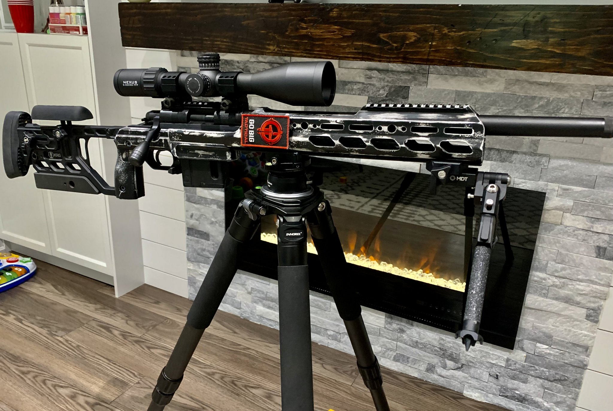

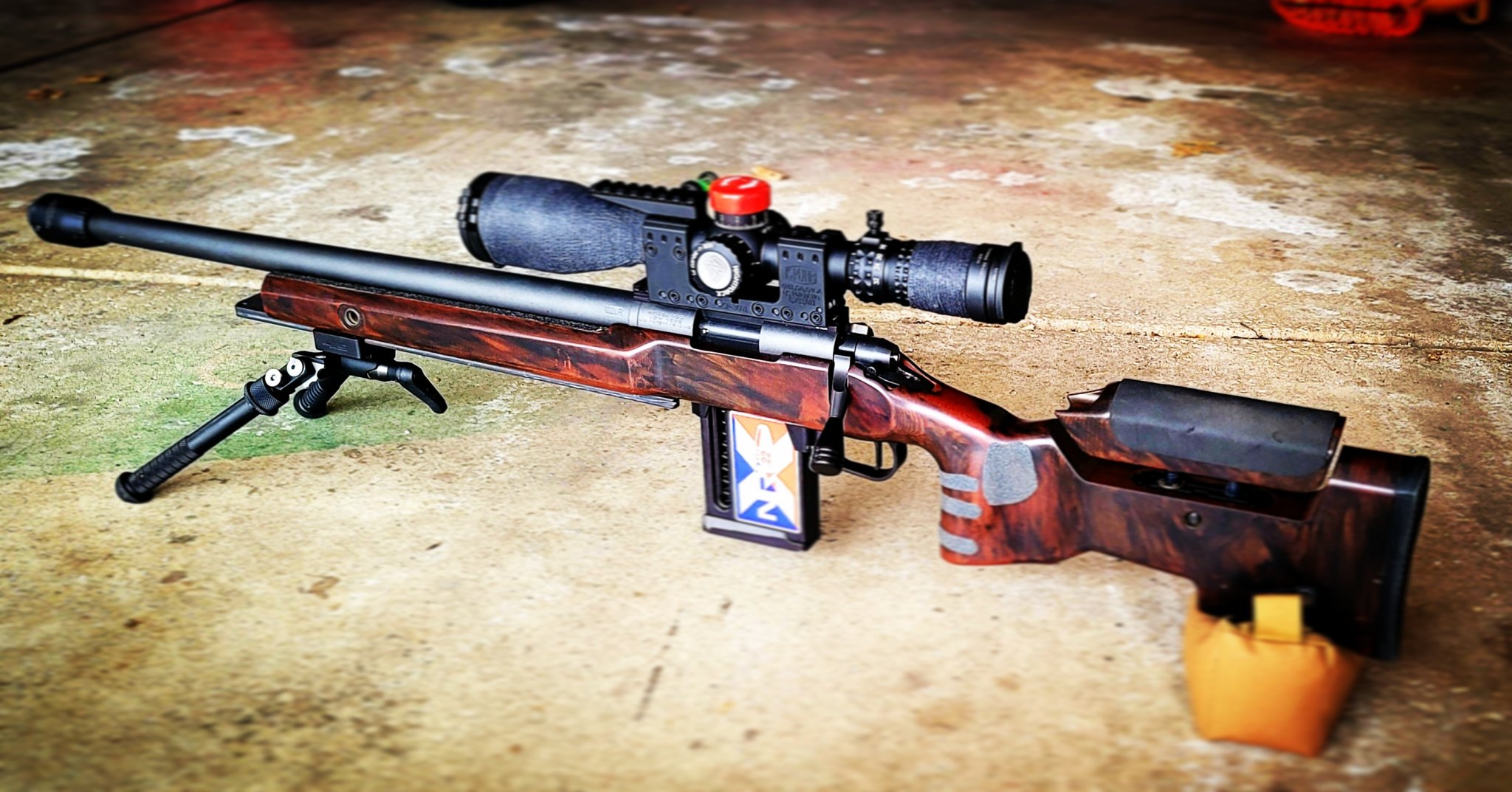

22" MTU V22 in Foundation Centurion.
Yes, i know......the bolt is on the wrong side 😉

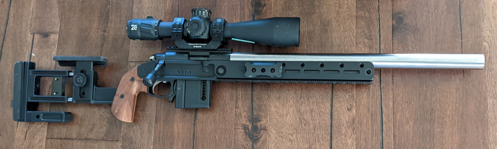

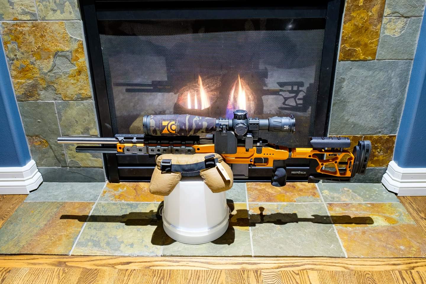

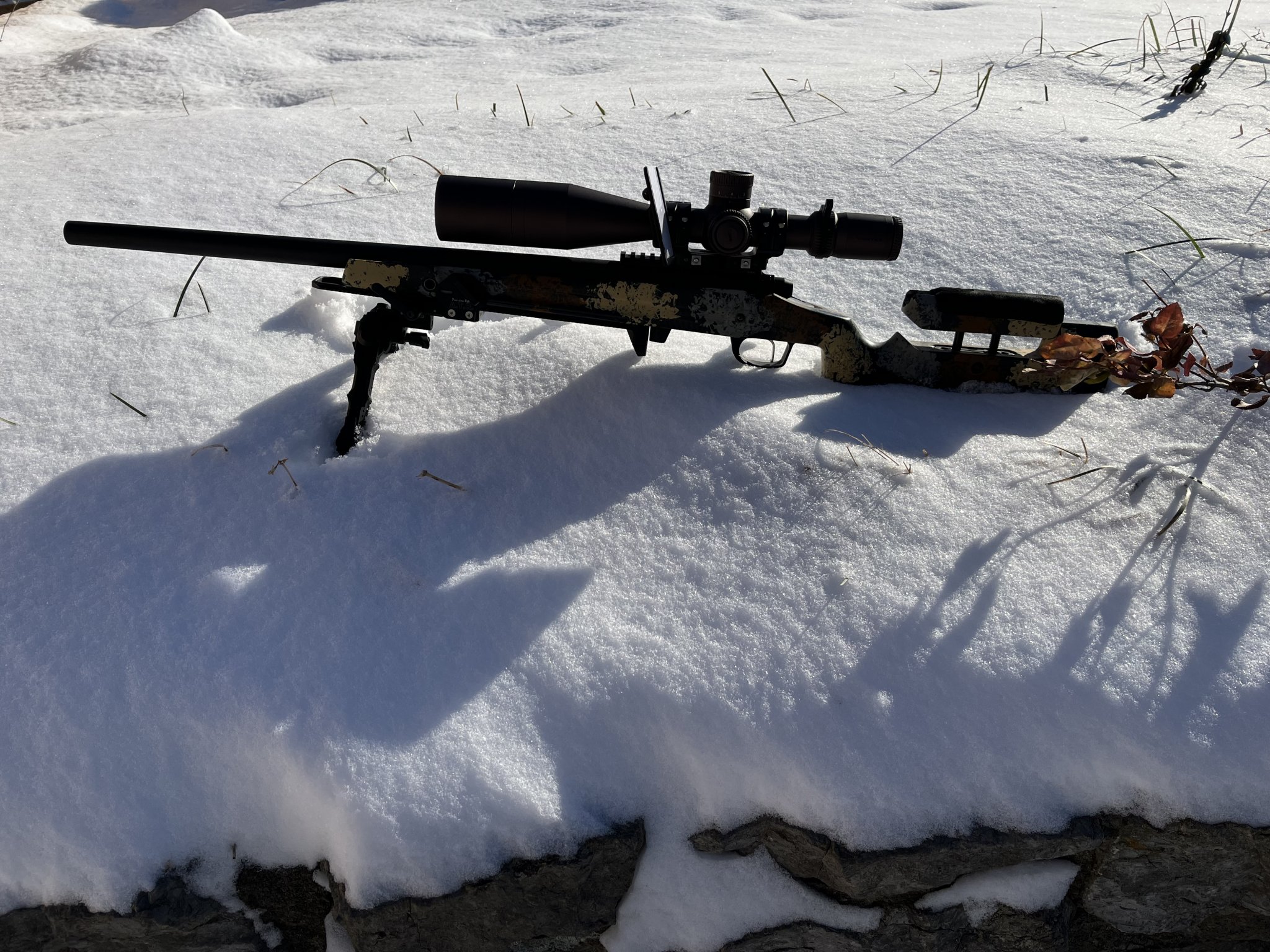

Vudoo 360
30moa base
22in Bartlein stainless, mtu, wrought iron fluted threaded.
TT diamond flat single stage 10oz
Foundation centurion dark distressed
Hawkins bottom metal with extended mag latch
Foundation arca rail
This is my next build
Reactions: Badjujuu

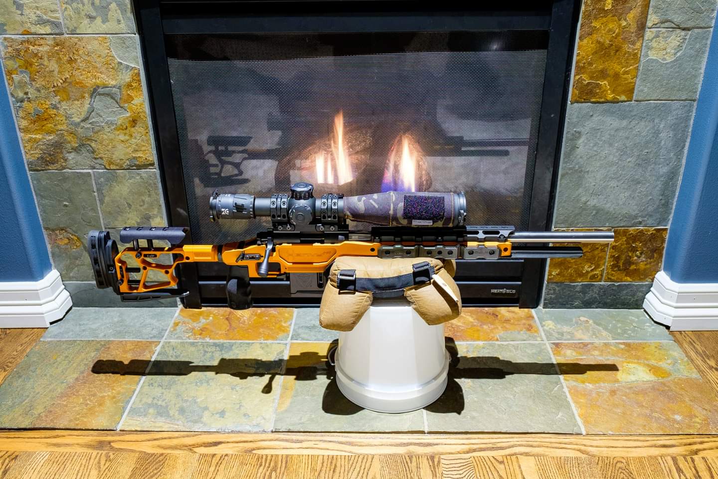

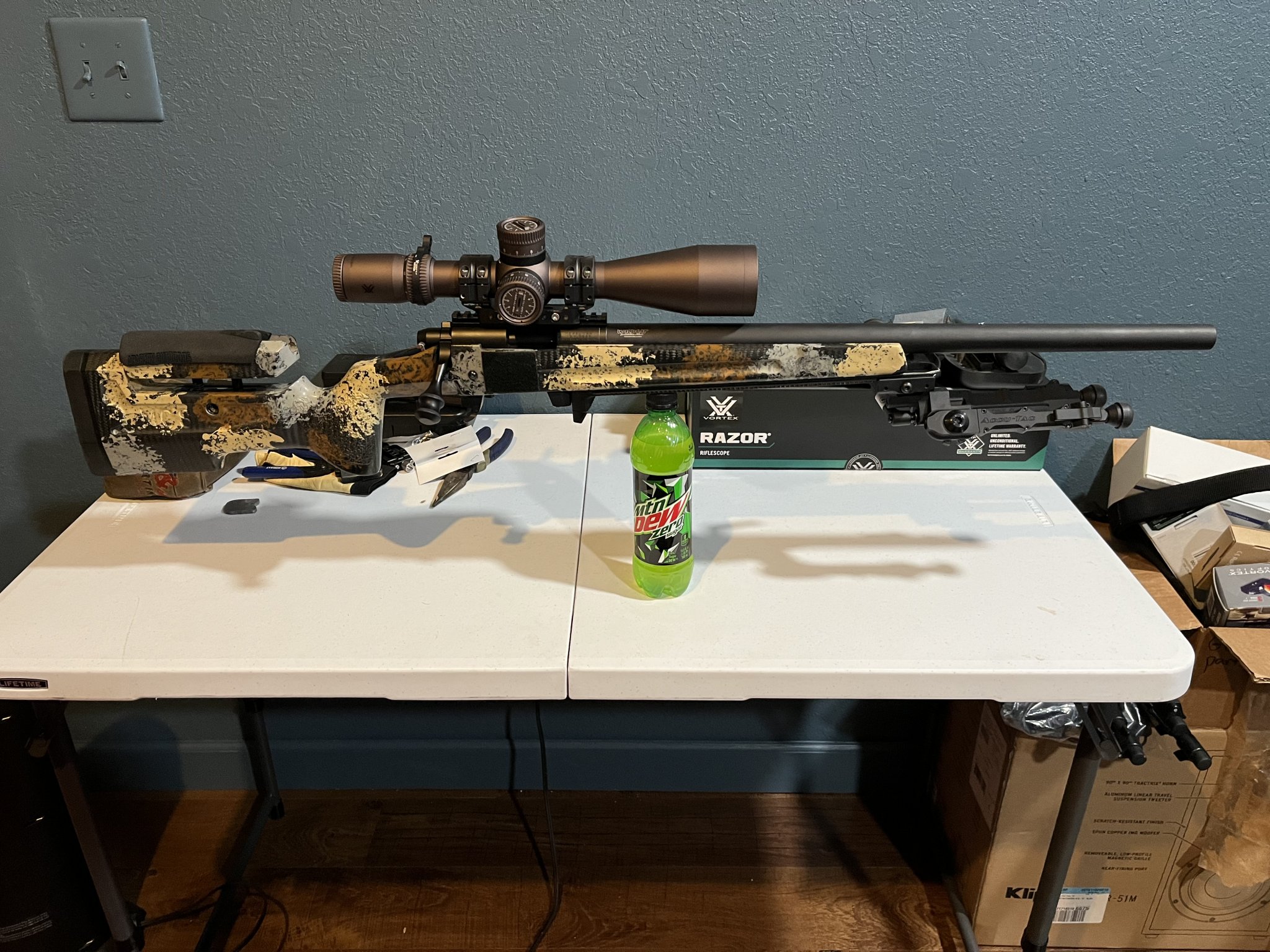

Current-
V22 360, atlas bt10 v8, mpa hybrid, strike eagle, xtr rings
Dream- as above plus- mpa ba comp,
NF 7-35 atacr

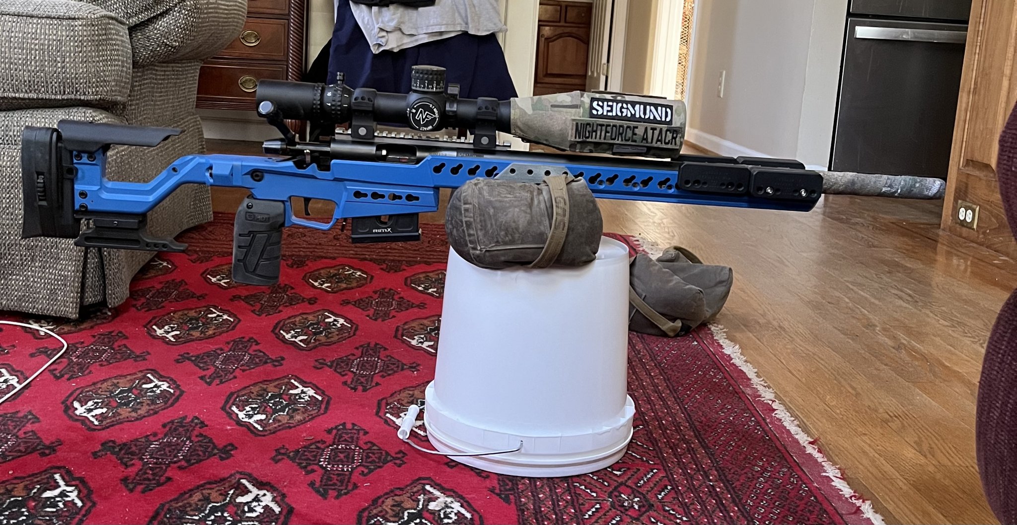

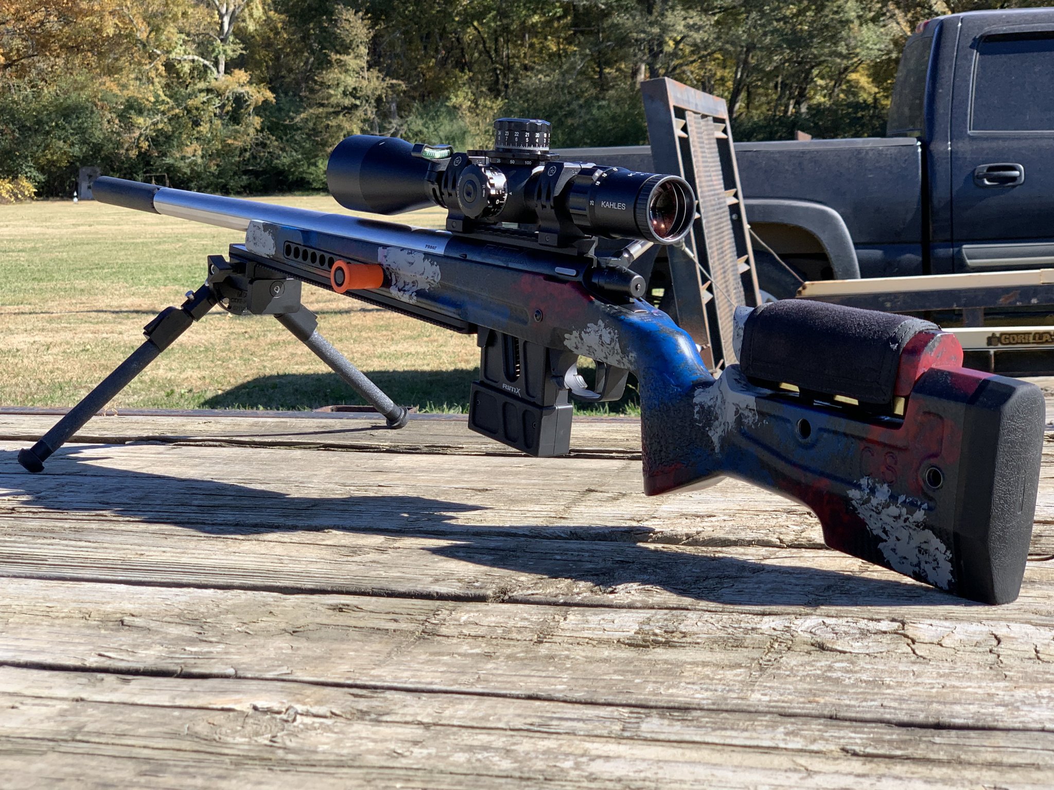

Mounted matching strike eagle 5 to 25s on them. Shortly after this pic. Son and i both getting into nrl22
Reactions: camocorvette

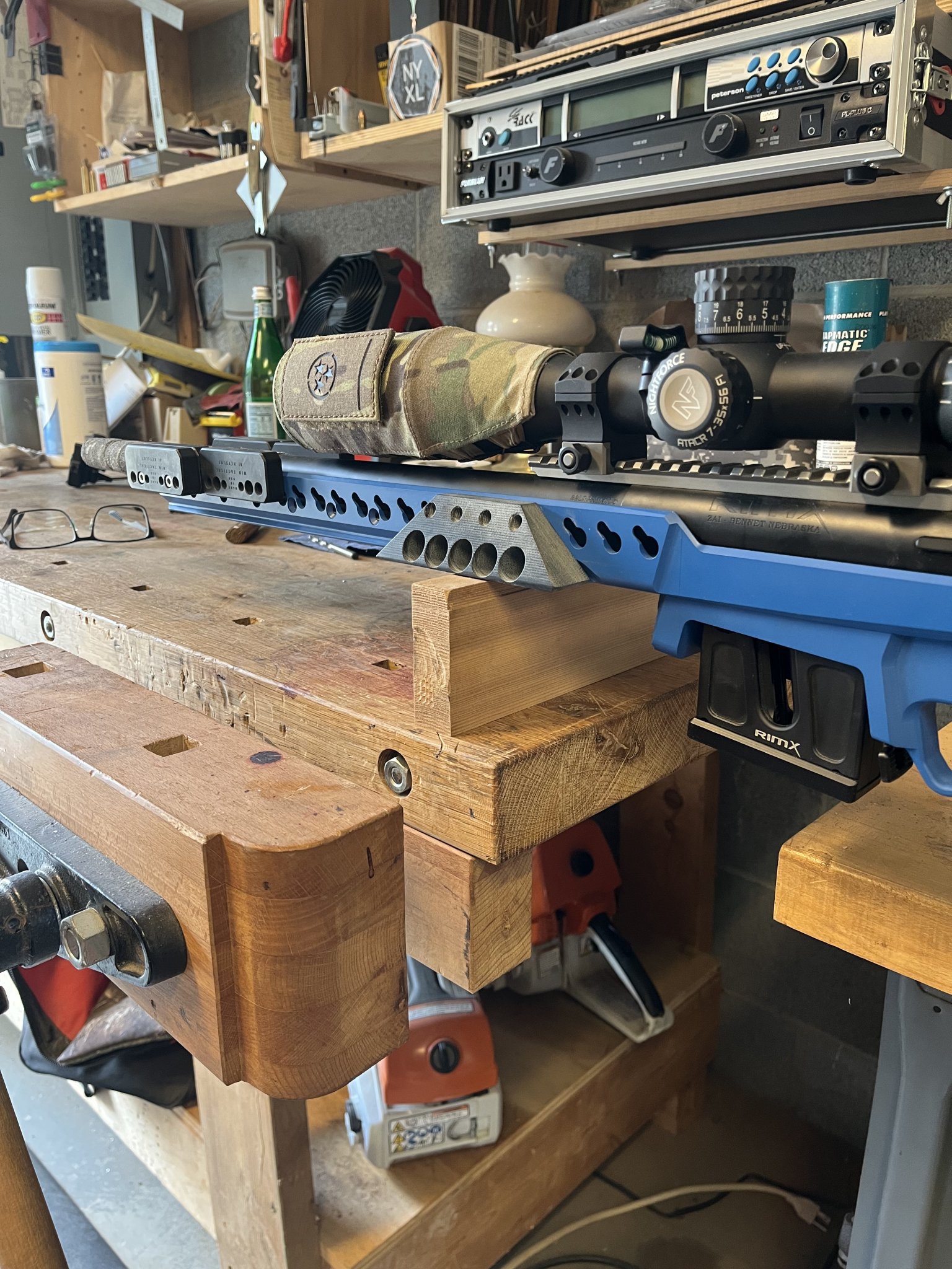

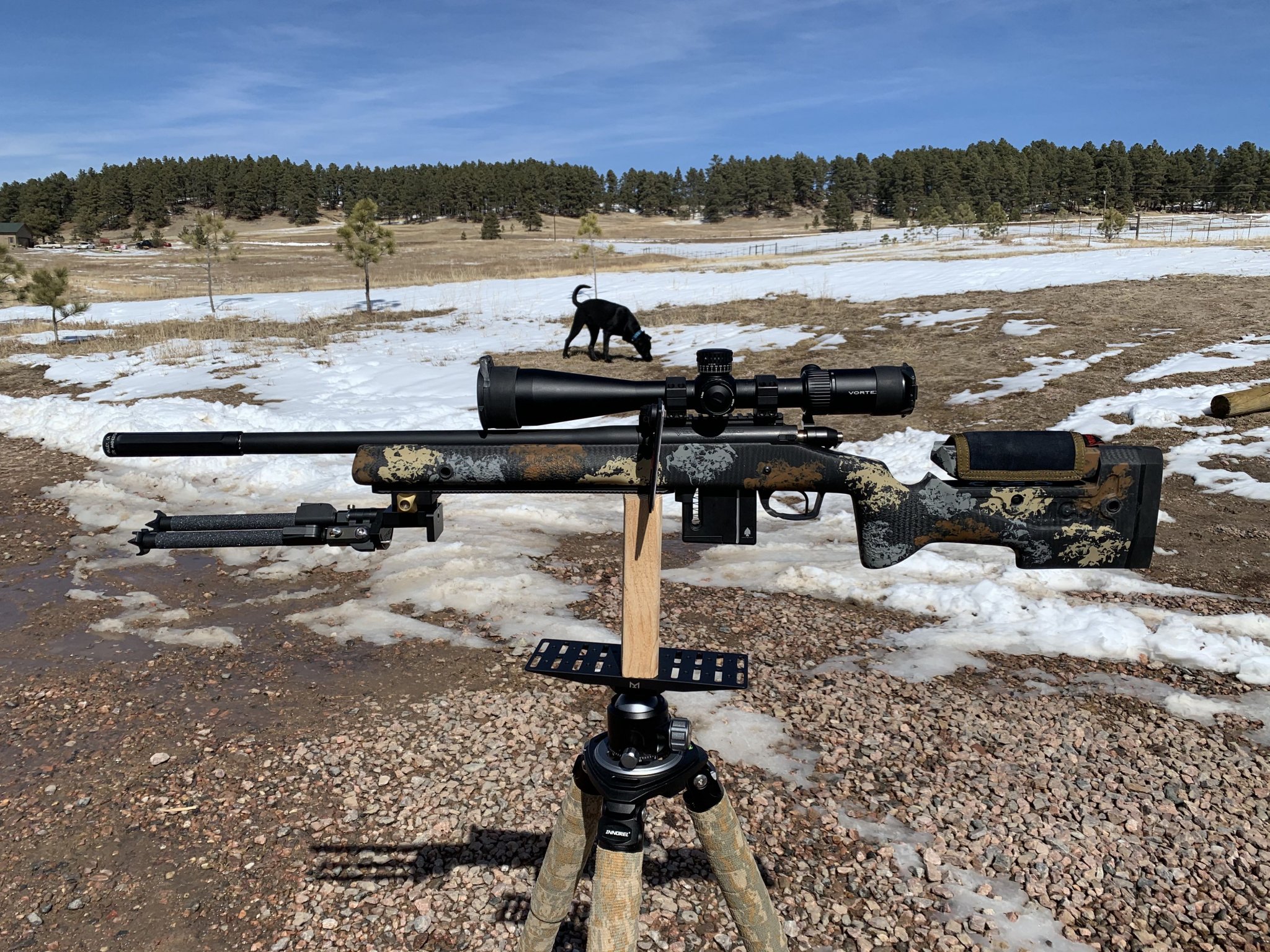

Rimx, Proof 20” comp contour, PRS 1 with weight, Kahles 525i, TT diamond- except for barrel length and stock (changed to TCS), this is identical to my comp gun.

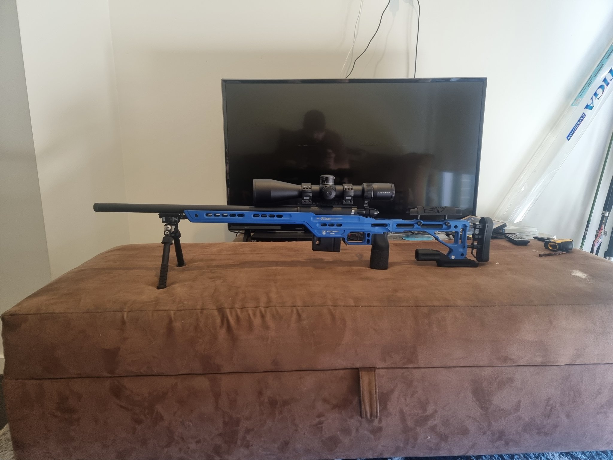

have a new 22 build in the works for this season.
- ultimatum deuce
- ibi 1:12 twist and a KS 1:10 twist both competition/mtu contours at 22”
- diamond flat shoe
- mdt acc
- apex rival optic 4-32

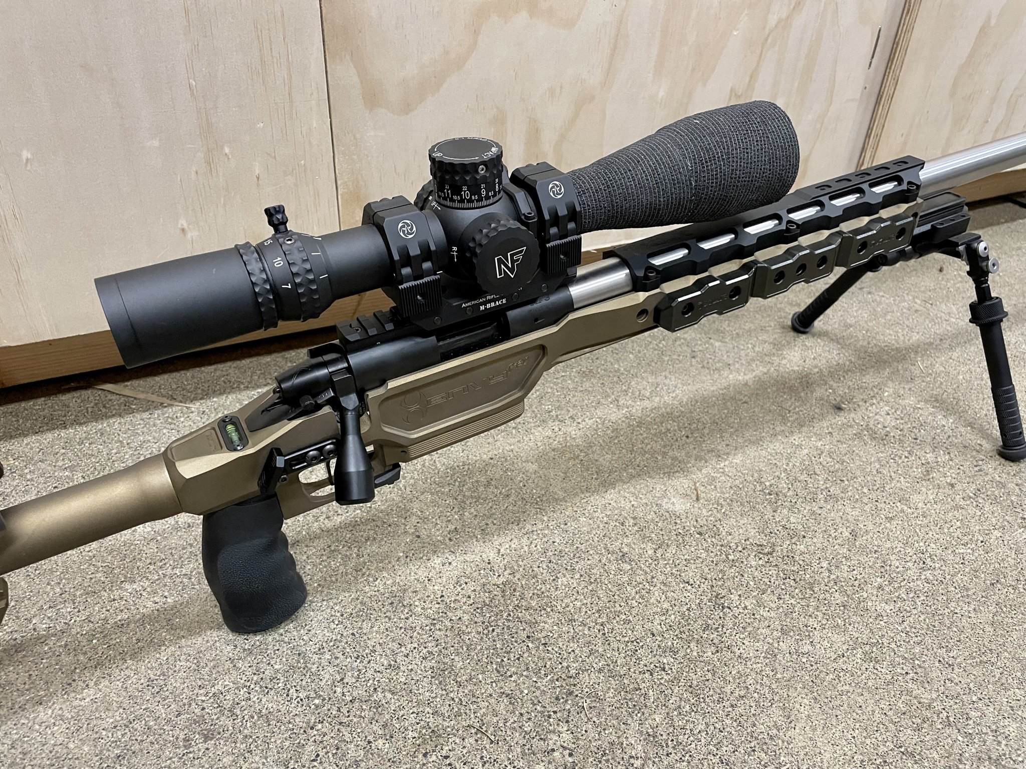

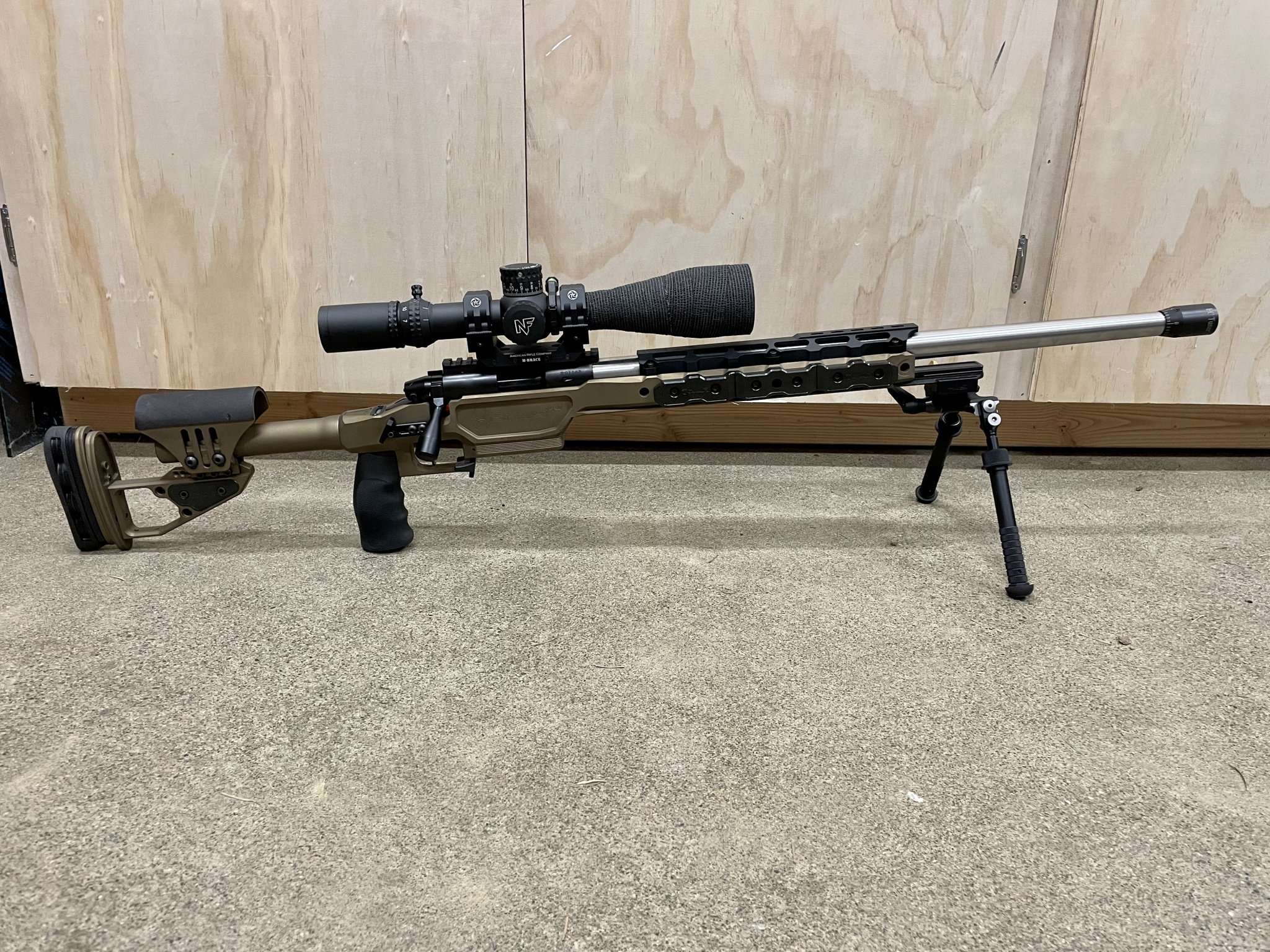

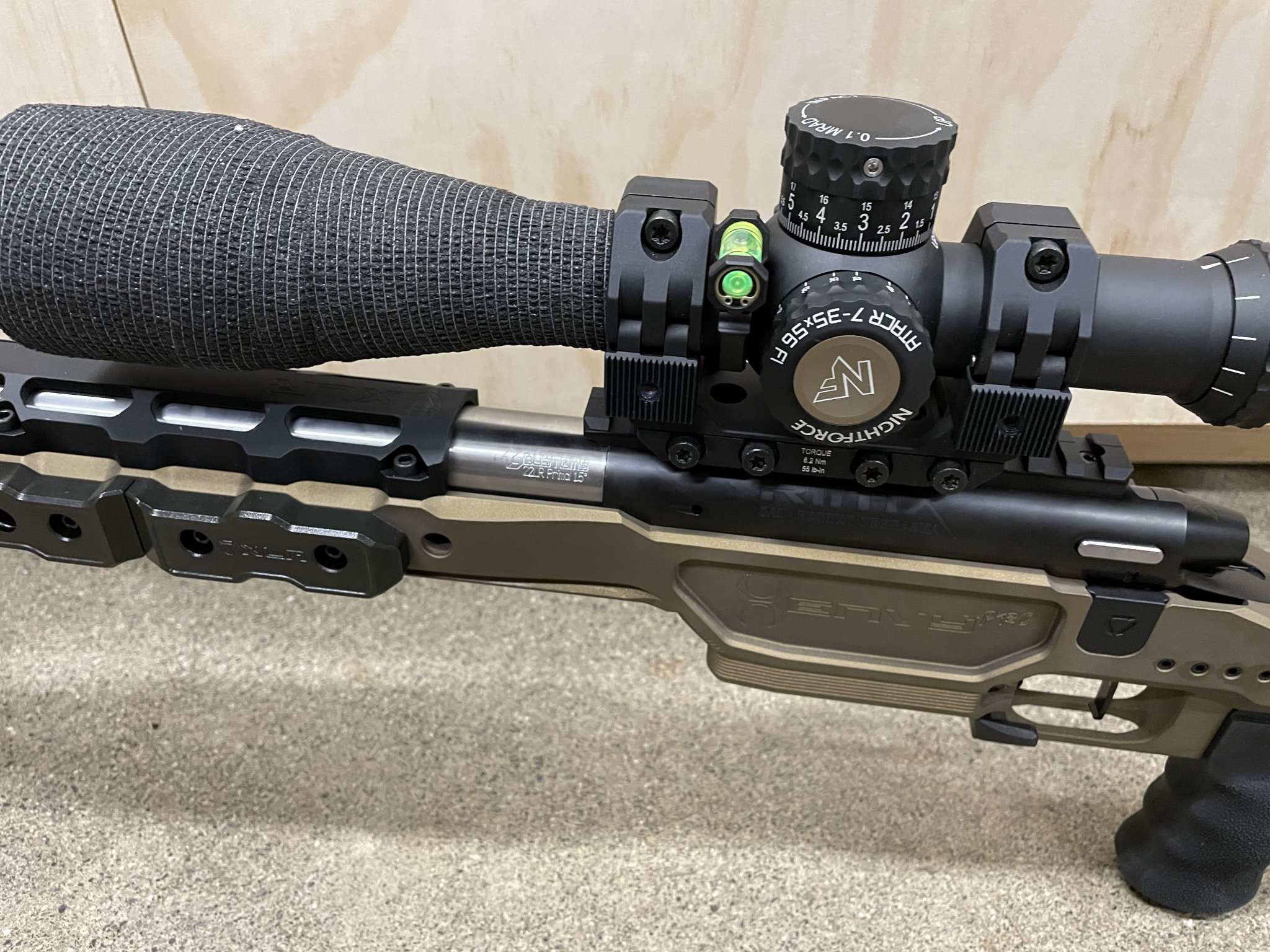

I’ve achieved my dream
Rim-x
TS Customs barrel with Tuner
XLR Envy Pro with JV Kit
TT Diamond
NF ATACR 7-35
ARC M-Brace 1 piece mount
Flat Line Ops Halo Level
Atlas Cal Bipod
(3) mags with +5 extensions
It’s shooting .2” at 50 yards and .4” at 100 with Midas +
