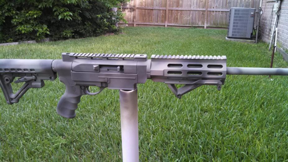

Well guys I got the paint from USGUNWORKS a while back, got the rifle back from the smith two weeks ago, and got all the supplies I needed to paint so I went at it today and here are the results.
