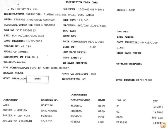

308, fgmm load data (2009)
Powder, bullet and primer seem to mirror AB39 (aka Mk316 mod 0), just the brass was stamped different (prob has the same case capacity). I think Federal changed the GMM powders a couple times since but not sure exactly which powders; I heard/read 2000MR or AR Comp but could be way off on that.

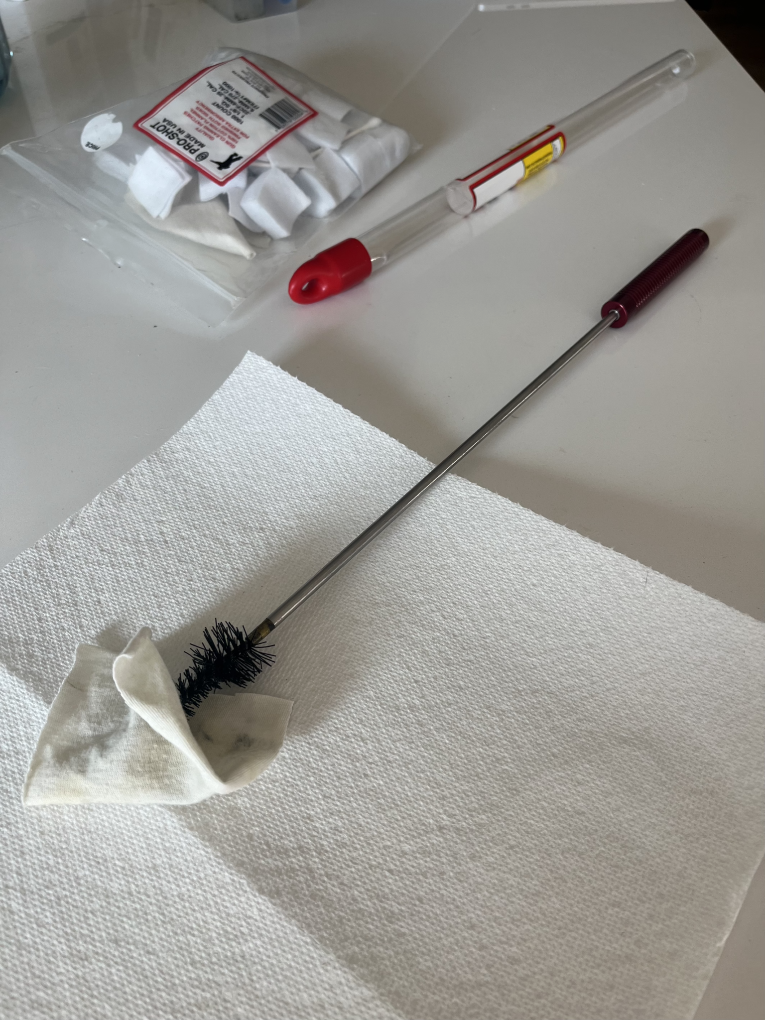

You beat me to it. In 6mm I use one of those with a square of cut-up old t-shirt and an AR chamber brush.

Visual aid:
