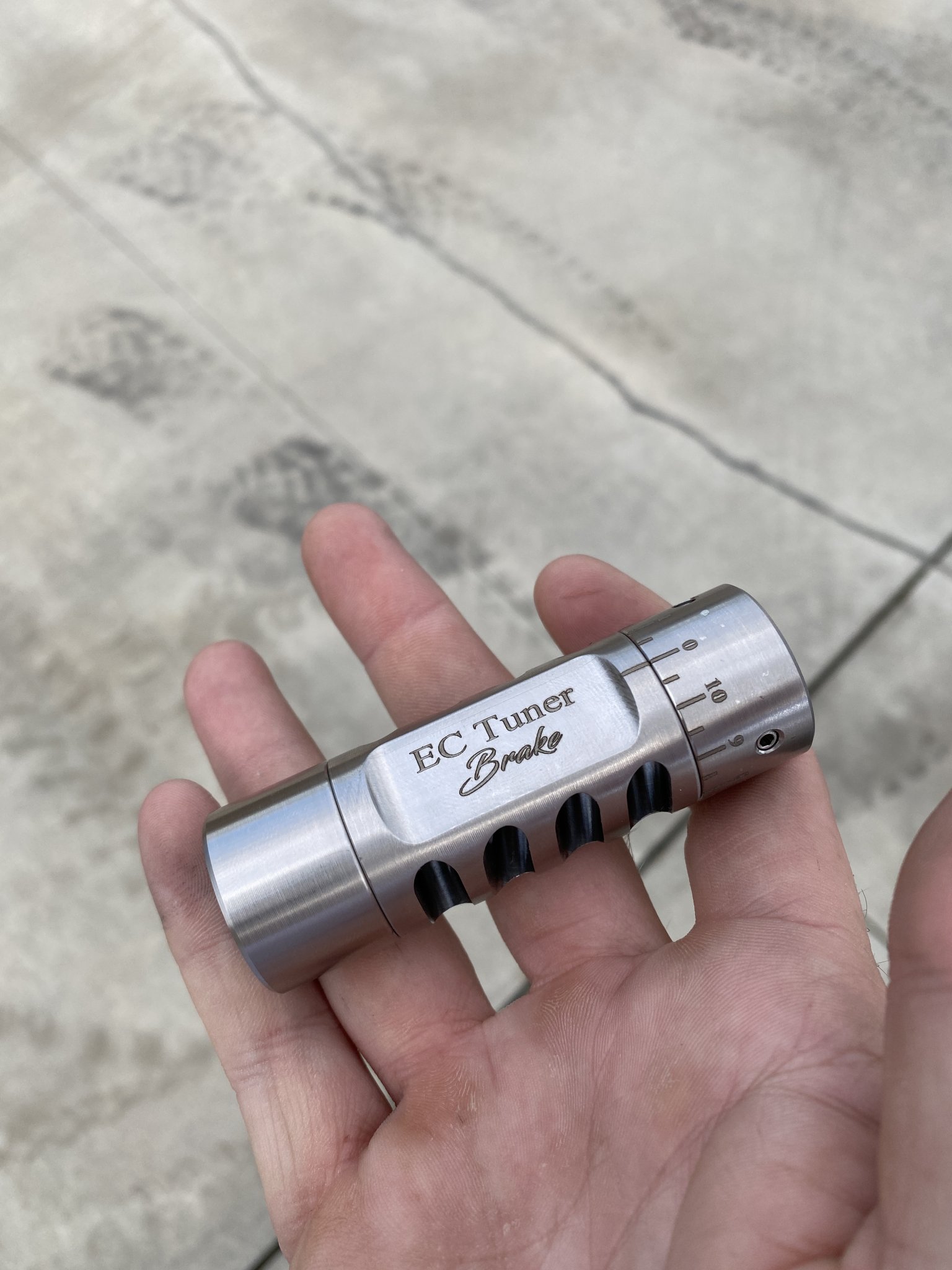

Got mine today. Will play with it tomorrow at the range for sure

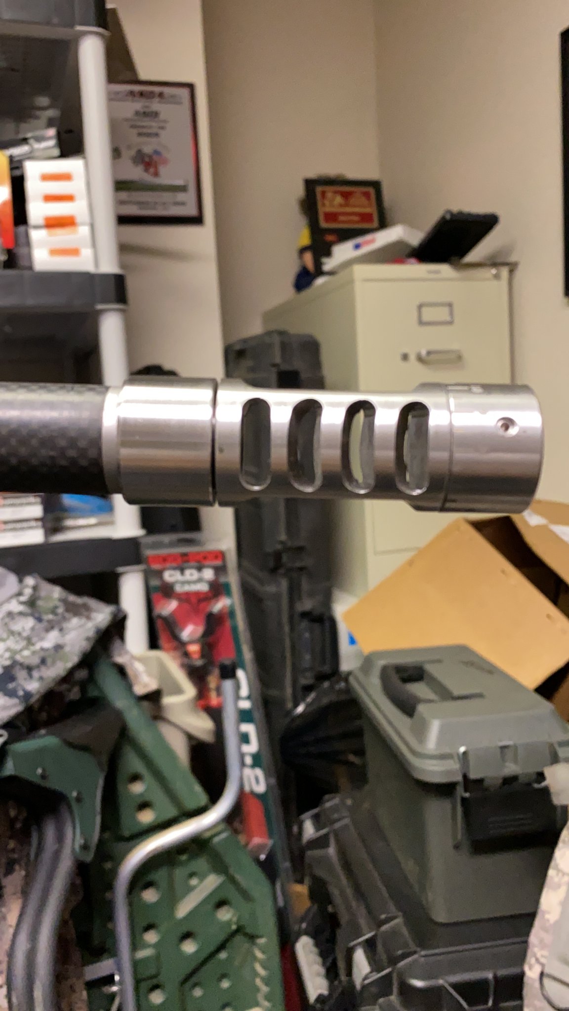

I just mounted it on my dads ca ba tactical 6.5 prc to test out tomorrow. It will end up going on my gap prc with mtu or my heavy straight bartlien prc

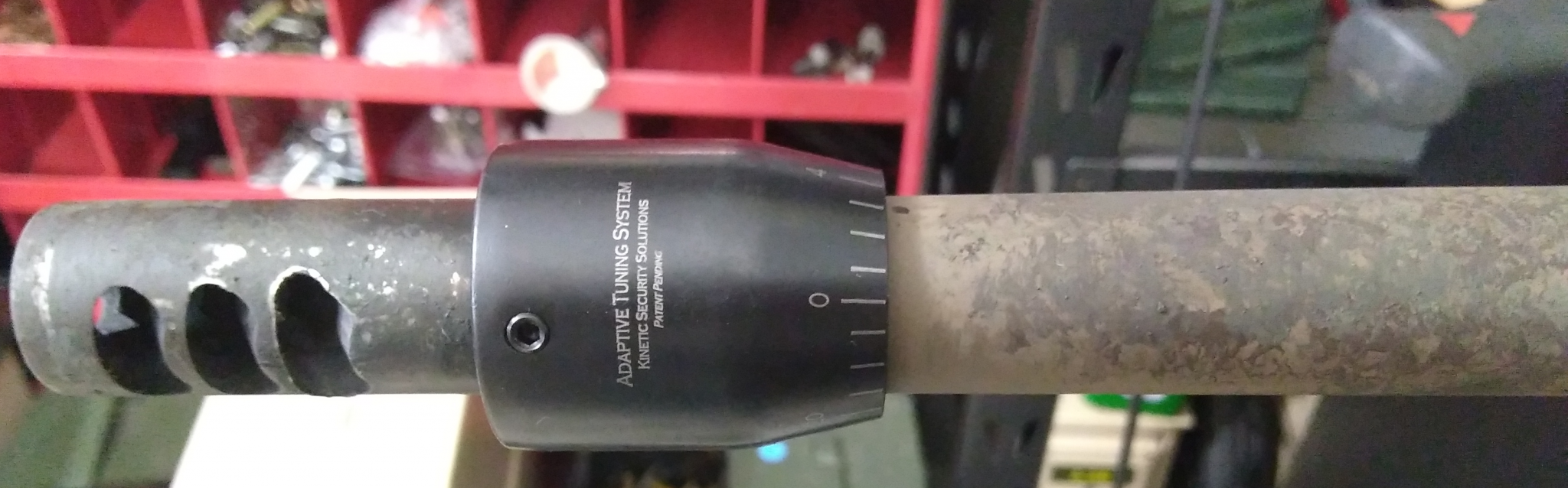

I installed the ATS on my 300PRC heavy varmit 29.5" Bartlein....I will be getting the EC Tuner/Brake soon. I'm highly interested in how they compare. I'm about to install an Area 419 Sidewider Magnum Brake with the universal adapter. I think this solution would be best for running a suppressor and back and forth to a brake. Just write down your settings of each.
I found the ATS to be extremely quick to tune a load on a thick profile barrel. I think the EC Tuner/Brake would be a better option when I shoot benchrest, F Class, and belly type matches that don't allow suppressors. I'm going to test this Winter with both systems and see which one works best for my needs.
