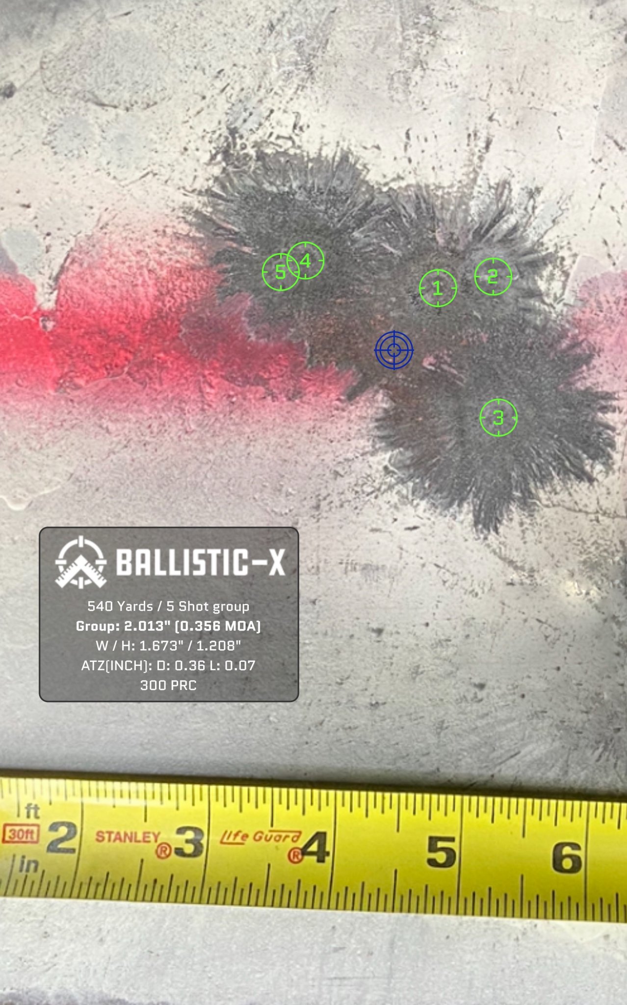

Ive shot it a few times since, and can confirm that staying with the same grain (140), the performance is consistent with different ammo. Shot federal gold medal sierra match kings and the groups were all less than .5 moa, even with larger sample sizes (5-10 shot groups). I'll have to measure my 200 yard performance as well, but it was my 3rd time ever trying 200 (with holdovers only) and 3 different 10 shot groups were all approx. 0.7 MOA
I'll probably do some more testing on it but with a proper front rest, this was off a bipod. Also these rounds were made with brand new Hornady brass with only a mandrel run down the necks. I waiting for my AMP to come in then I'll do another ladder to make sure it's still good for this barrel now that it's got 900 rounds through it. Still for PRS work any of these groups are sub-moa and should be fine.
I imagine it will only get better with a real front rest or bag. I shot all of mine off a bipod too, I really enjoy the atlas and dont want to go back to a front bag. Its too much fun in its current setup.

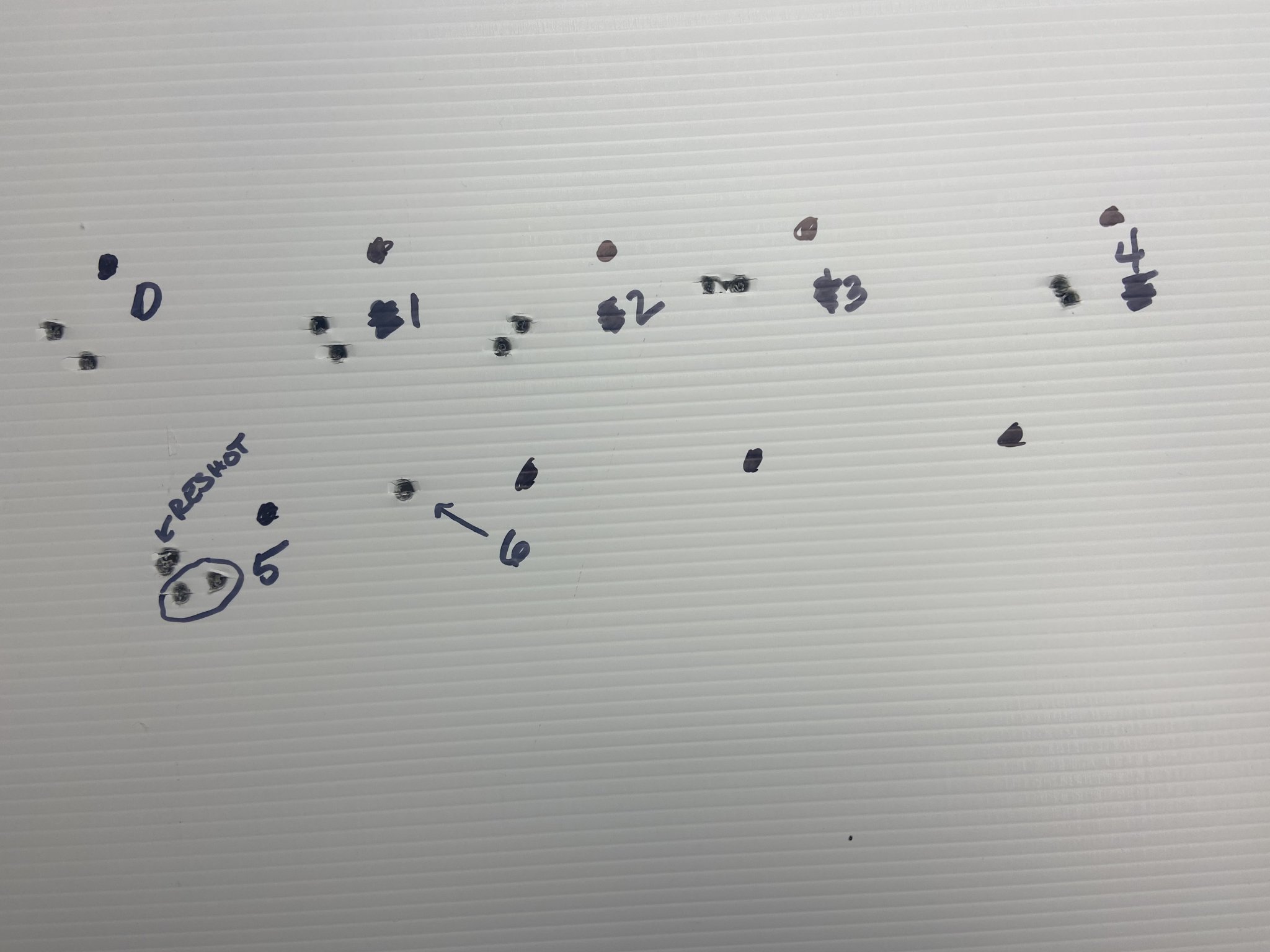

EC tuner brake update 300 PRC:
So I settled on a load in a velocity load with low es/sd numbers. I went a shot today and used the tuner. The first was the load at 0 on the brake. About 3/4” CTC. Turned the tuner to “1” (which is two marks) then to 2 and so on. You can see as I turned the 2 shot groups consistently shrunk. For those guys that are “well you have to have 3 or 5 shot groups”. Read the directions.
#5 needs explained. I was waiting on the barrel to cool a bit before I shot. I read a work email… bad choice. I know when I shot those 2 circled they were bad pulls as my brain was still thinking about the email. Seeing the tightening consistency of the prior shots. I re-shot that setting.

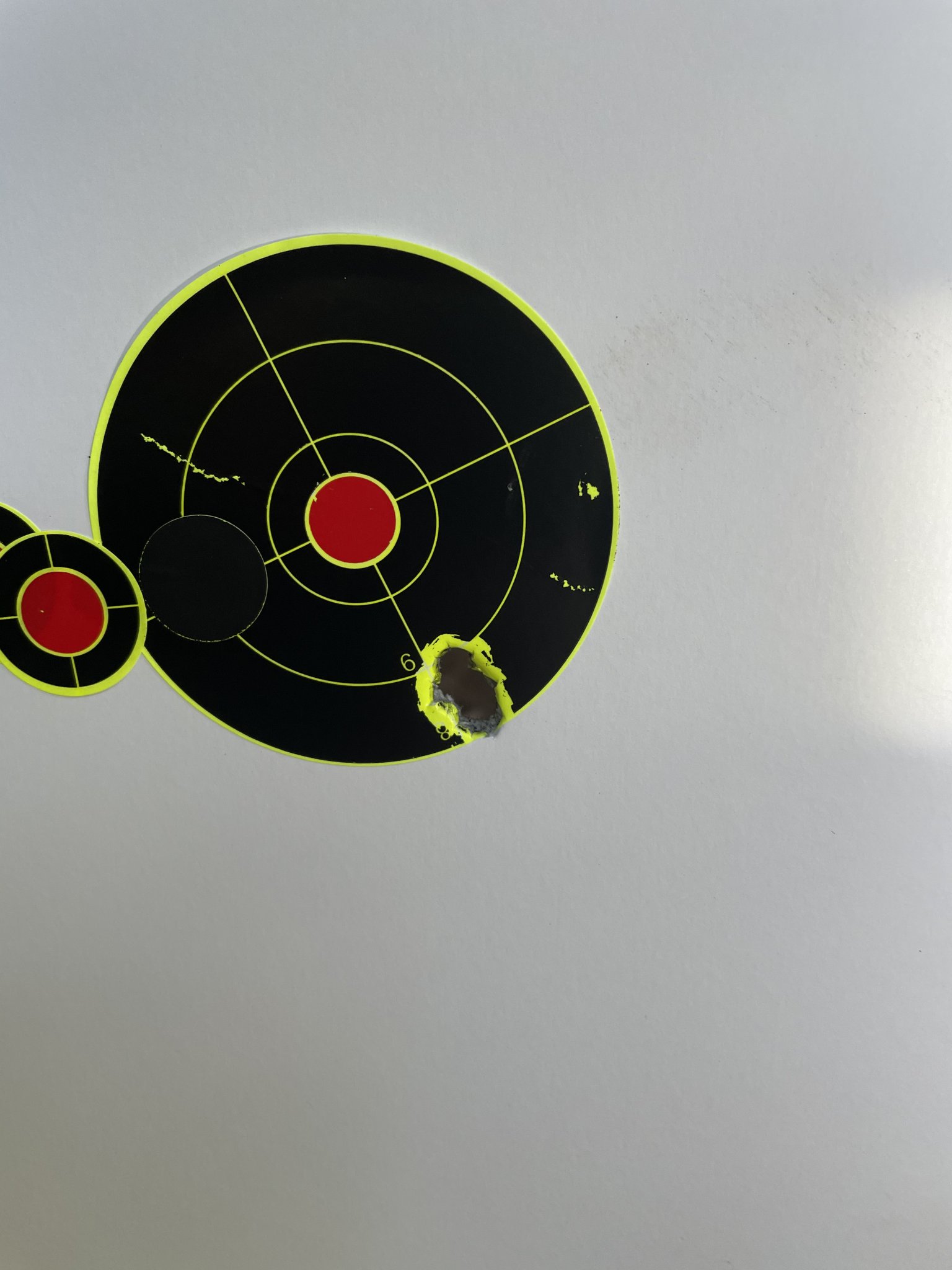

Then number 6 is 2 shots 1 hole.I decided to stop there. I am convinced this thing tunes! And felt like the brake would really well for recoil reduction.
Side note I didn’t worry about zeroing before shooting.

He does say in the video "you can use 2 shots if you're really good". based on your group 6, I'd say you fit that criteria..
Kinda wonder if developing a load why set it at zero and not like 5 or 10 while you test the ocw.
Then start at zero to tweek it.
