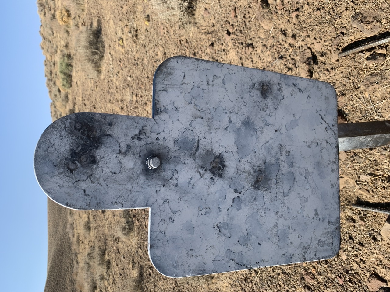

    While I have not shot as many 109s as @Dthomas3523 has I have shot at least a couple thousand and have not had any explainable issues.
    11 rounds at 100yds
    3/4 IPSC...5 in the head at 714yds.
    these are from lot# 1786 which i believe someone said they had issues with...and to add to that these are all loaded on a dillon 750 and had a 35fps ES when i checked at the 100yd target.
