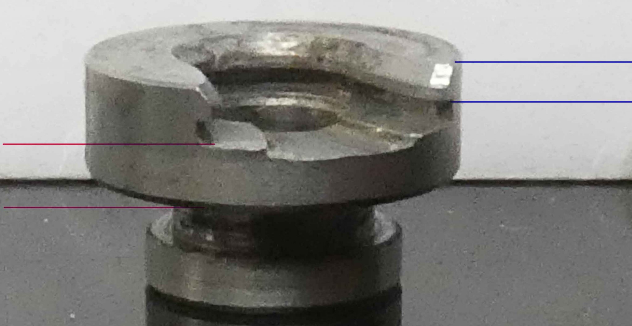

    The "standard" shell holder thickness is 0.125".
    The Competition Shellholder Set DECREASES headspace by 2, 4, 6 ,8, 10 thou.
    I got this wrong:
    That is each one sizes MORE than a standard.
    Makes sense, since you can size LESS by backing out the die .
    Yup backwards. So confusing.
    Makes sense, since you can size LESS by backing out the die :)
    You have that backwards. The point is for the die to be in contact with the shell holder for consistent sizing.

    I have a Lee press with a hard stop. I get consistent sizing with the die locked down and NOT touching.
    Sounds like you would need two dies or shell holders to size for a minimum headspace target bolt rifle (0.001" to 0.002") and a little more for an AR (0.003" to 0.004").
    Some use shims to get a longer case (shorter headspace).
    Some trust the die manufacturer to know what they want.
    OR, buy the $70 Competition Shellholder Set which ONLY makes shorter cases.
    Sounds like you would need two dies or shell holders to size for a minimum headspace target bolt rifle and a little more for an AR.
    Think about this another way. FL dies oversize by design, so every cartridge fits in every in-spec chamber. Thats how they got a bad name, people screw them all the way, and end up oversizing. Redding comps add height to the top of the shell holder, to hold the case further out of the die so you can minimally size a case. It also allows easy headspace changes for multiple with different chambers instead of chasing a die height ever time you reload.
    You can get consistent sizing without contact with the shell holder, but its far more consistent if you can contact it. The reason is press deflection.

    Now you can control headspace. The new Redding Competition Shellholders are packaged in five piece sets in .002” increments (+.002”, +.004”. +.006”, +.008” and +.010”). Each shellholder has a distinct black oxide finish and is clearly marked to indicate the amount it will decrease case-to-chamber headspace. You can now easily adjust the shoulder bump to customize cases to your specific chamber.
    Which dimension, Red or Blue does the Competition set modify?
    Supersubes
    Heathen
    Supporter+
  • Sep 6, 2006
    7,696
    8,130
    Eastern Sierra
    Vague wording, it does decrease if you go from .010 to .002, which is leading to your mistake. Been using these for 20 years. Why would anyone, let alone a competition shooter, want to take a full length die that already oversizes, and size further still?
    Blue, its taller there by the amount indicated on the shellholder.

    Thanks,
    So it hold the case further out of the die making the base to datum longer, sizing less.
    Found this
    The five shellholders are +.002", +.004", +.006", +.008", and +.010" thicker than normal shellholders (.125" from the bottom of the case head cut to the top of the shellholder).
    I guess that sort of means the thickness from the top red line to the top blue line is increased 2,4,6,8,10.
    I don't have a set so you would know best.
    Found this
    Yes

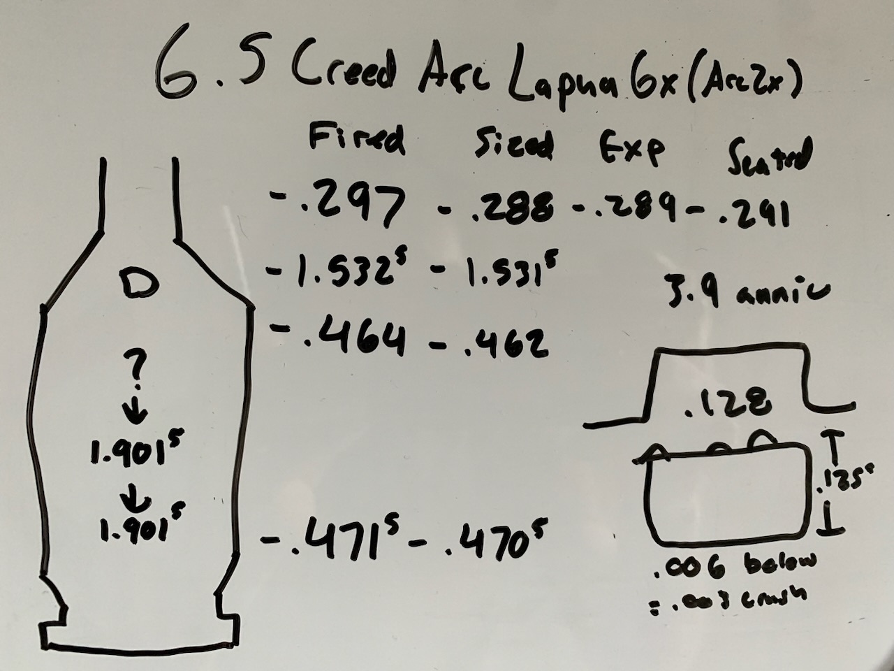

    Here is my 6.5 creed and its resultant measurements from my redding type s full length, just like you are using.
    Taking the base down 3k would make for some super tough sizing regardless of where the shoulder is getting pushed to for example. The answer is in the actual numbers somewhere.

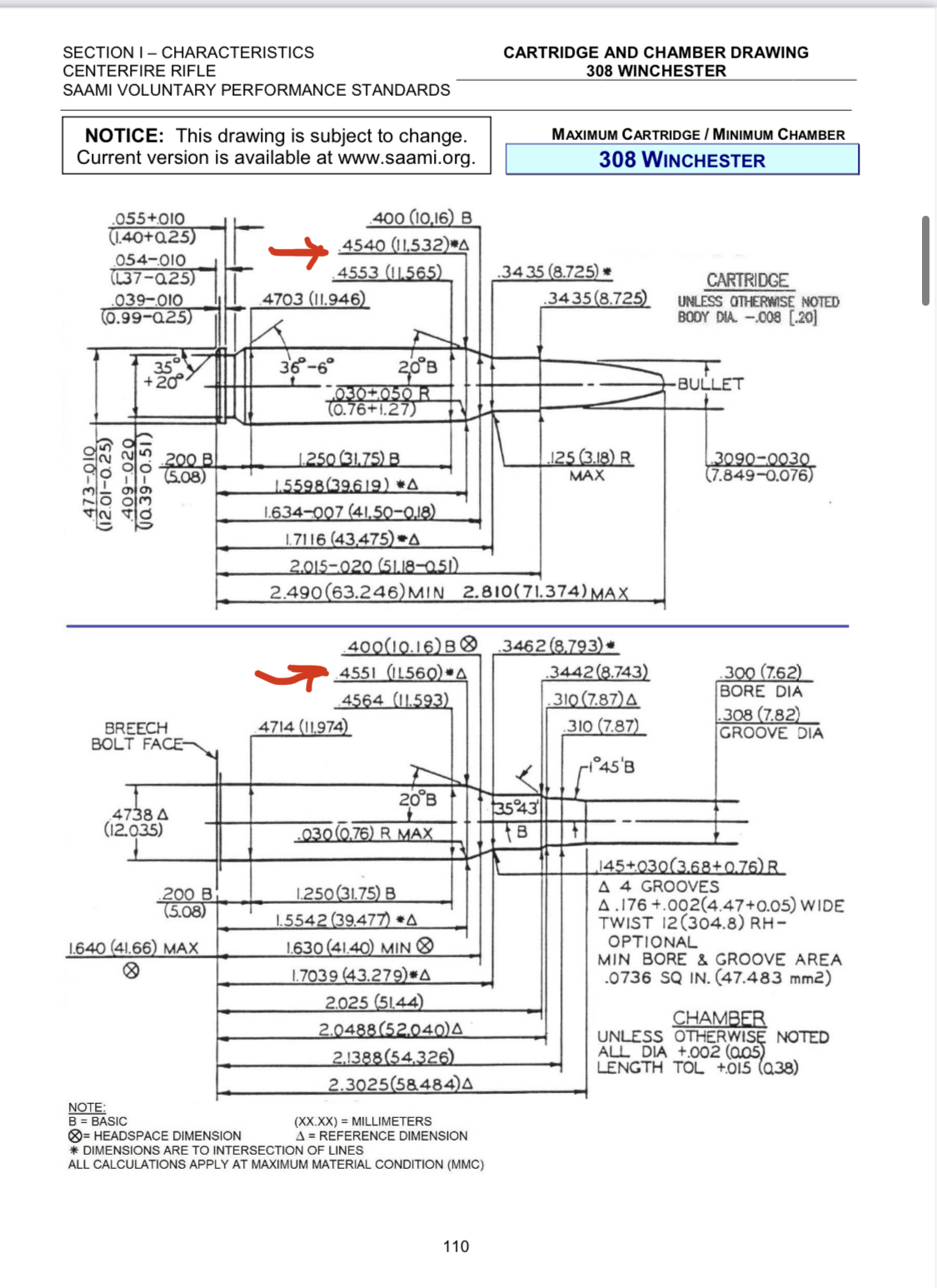

    It sounds like one of the problems you have is that the headspace on your Sig is below SAAMI spec. You might take a look at this info. I could be mistaken but die manufactures create their dies to bring brass back to SAAMI minimum spec and you are trying to make your brass 0.004" below that.

    The Sig's headspace is on the tight side but within SAMMI spec. Measurements are using a Hornady comparator. I've shot a few varieties of factory ammo and the bolt closes easily on all of them. No issues there. Was set up properly by a gunsmith when swapping in the new barrel.
    Technically the dimension of interest is the top blue line to the top red line. That is the amount of casing that cannot go in the die. Top of shellholder to the base the brass sits on.
