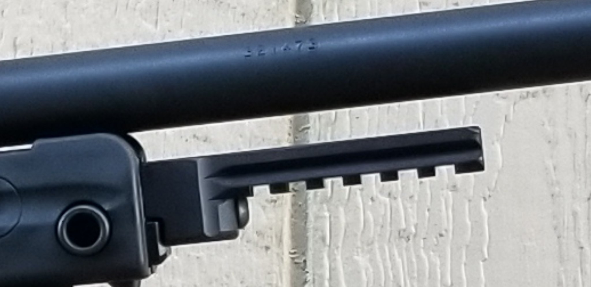

Yes they are seperate peices. The adapter accommodates the standard length/offset bipod that could be used on any other platform.
Here is a photo of just the adapter.
@goldenbear926
Thanks for the answers. Is the whole thing one piece or is the spigot interface a separate piece? If it is separate pice, how does it attach to the bipod.

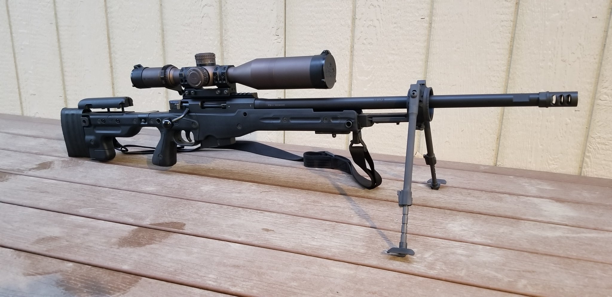

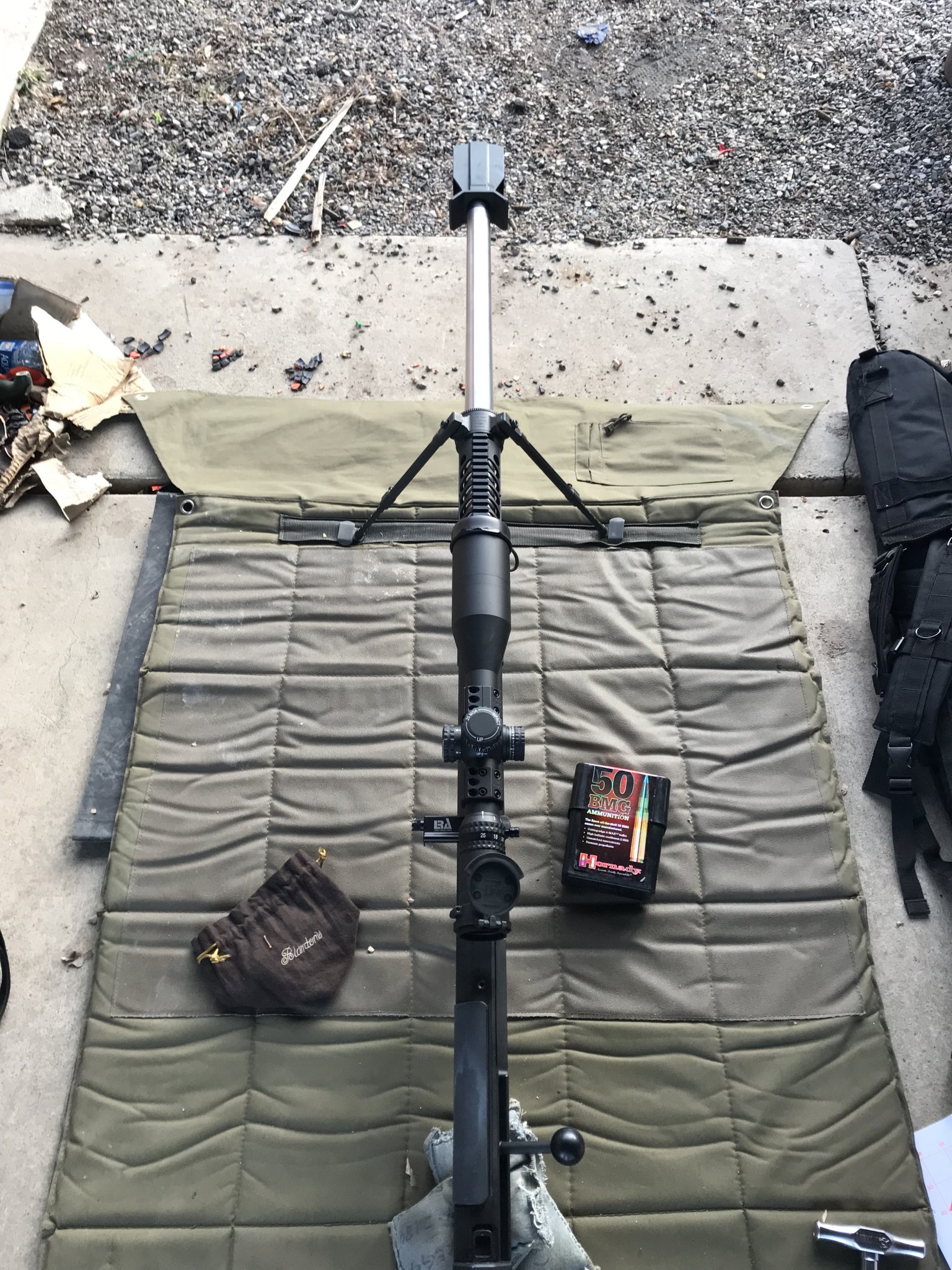

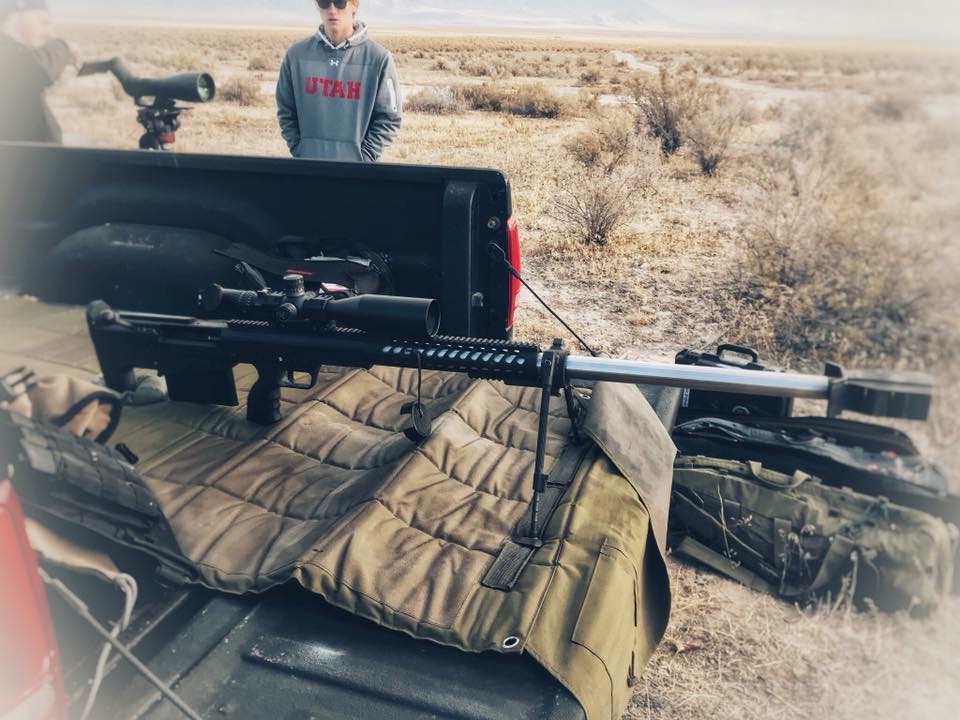

I have two of them, one on a DT HTI in 50 BMG with a 40" barrel and a 35" Cheytac barrel - I would never ever use another bipod for those rifles. LRA is close if they even still make them, but the legs are too short. I also have one on my DT SRS which I got to help with 338 LM recoil. It is an unparalleled product, and it's expensive (in the steel model) because it's so difficult to manufacture. When I spoke with Dale Poling at SHOT several years back he said they don't even make much $$$ profit on them, and was working on making versions of other materials to save cost. Looks like they have done that now with the aluminum models. It is a SUPERB product.
