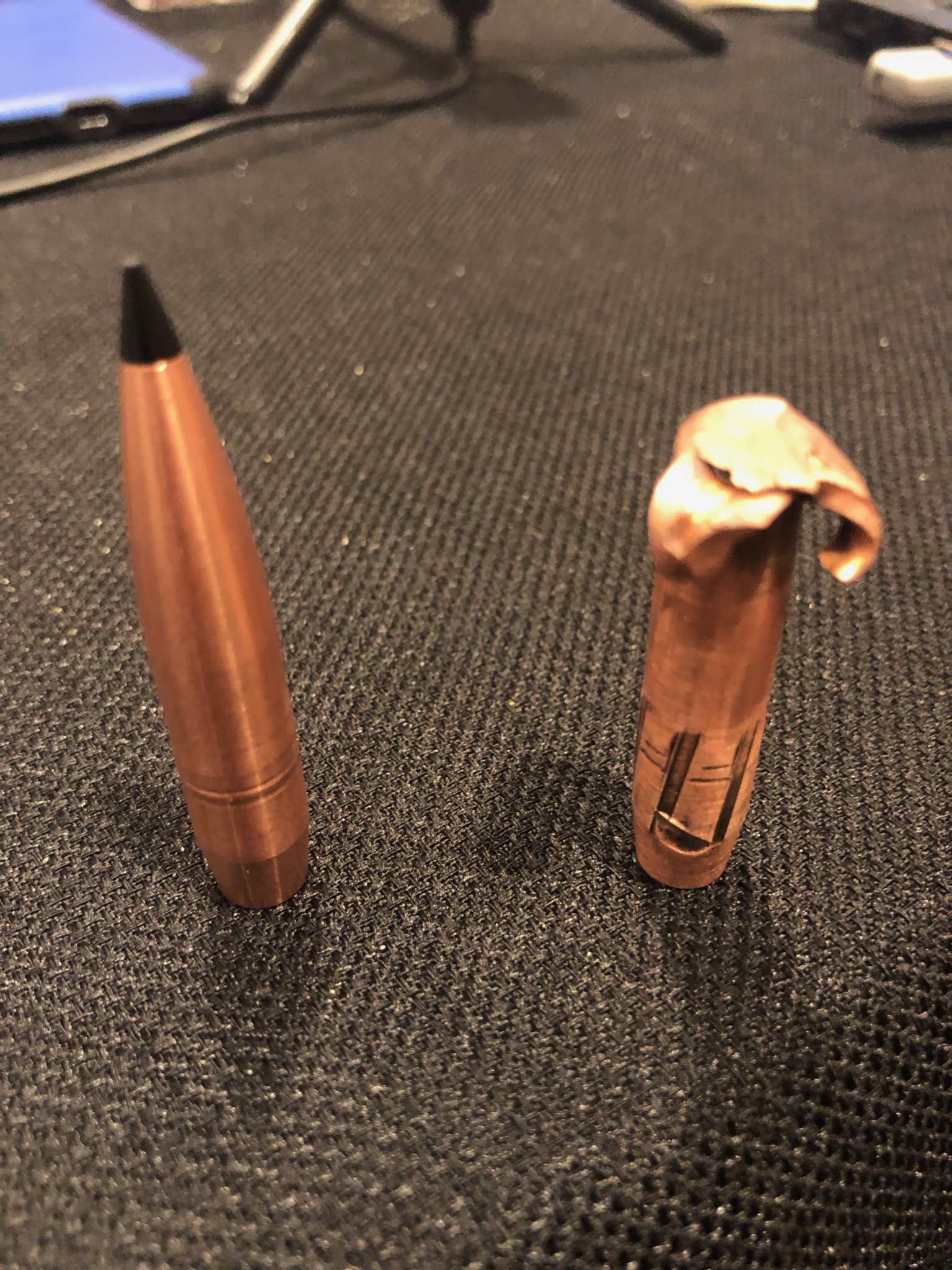

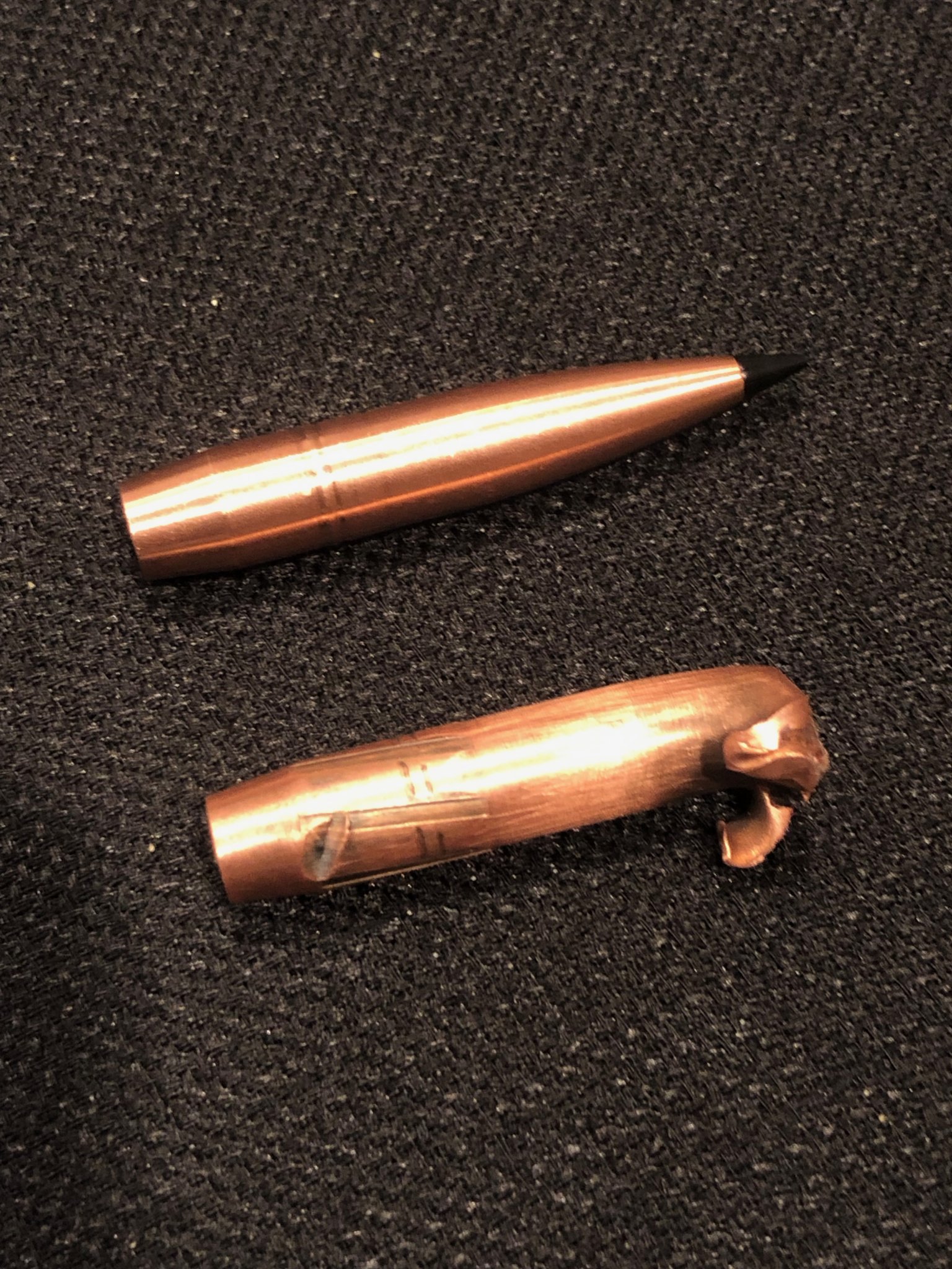

What is unique, especially for you and swamp is that projectile is designed to mushroom and break off the "base" at the ring. So you get the front section that mushrooms followed by the solid mass "base" into the wound channel.

looks cool but not a elr bullet. would be some issues for nato for sure

Nosler partitions have that design as well. Front opens and the base drives forward. Shaped like the letter "A". Tip deforms until the cross acts like a round nose pushing.

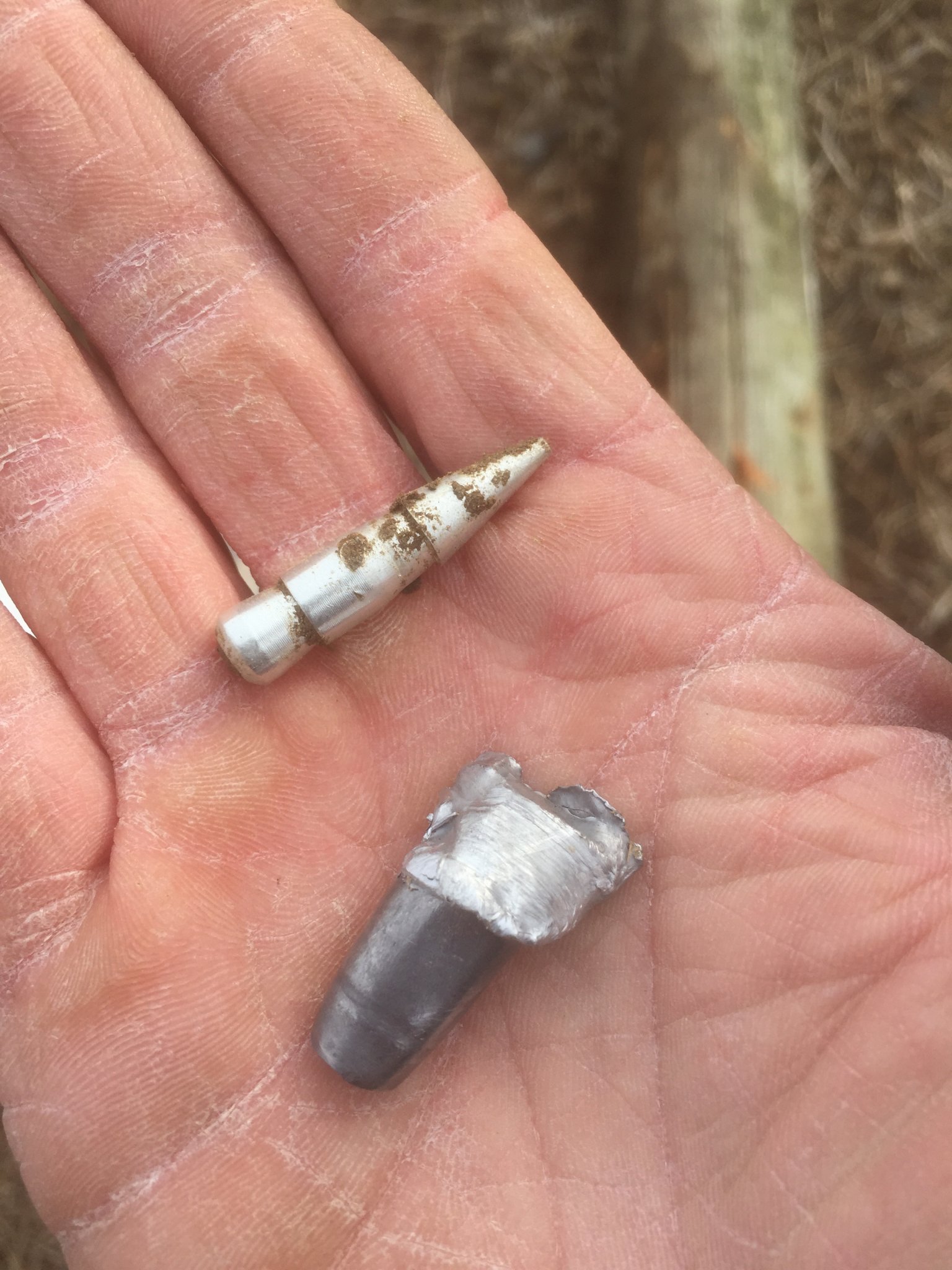

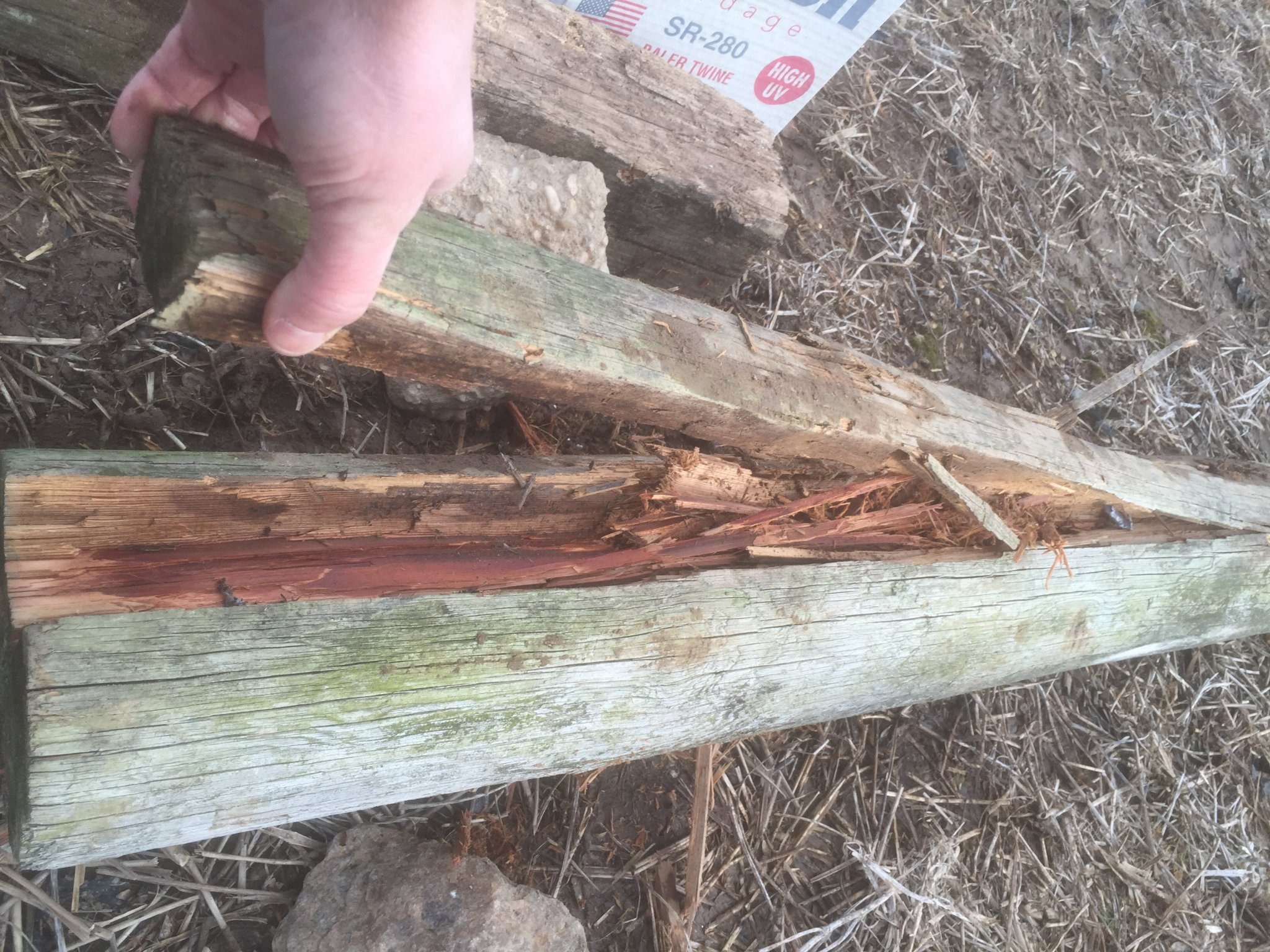

Not ELR, but 750 amax fired into wood at 100 yards. Surprised the aluminum core stayed intact.
Holy CRAP dude! You need to get some lotion on those hands!;);)
In all seriousness, how far and deep into the dirt did the core go? That is a pretty interesting phenomena to see, a bullet with that kind of power and being able to recover it. what kind of wood, and how much damage did the whole bullet do to that? i.e. a tree trunk of x-diameter, hard or soft wood.
