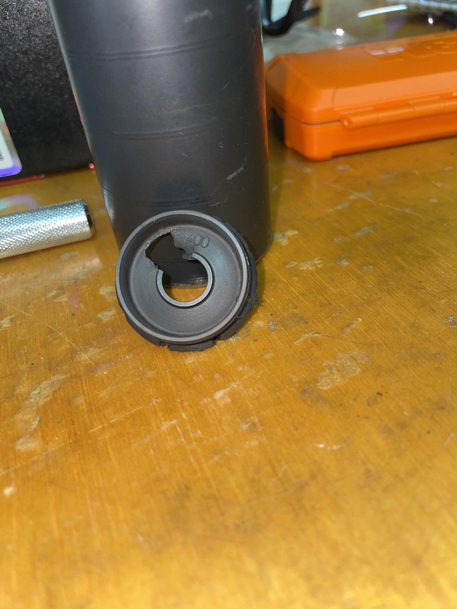

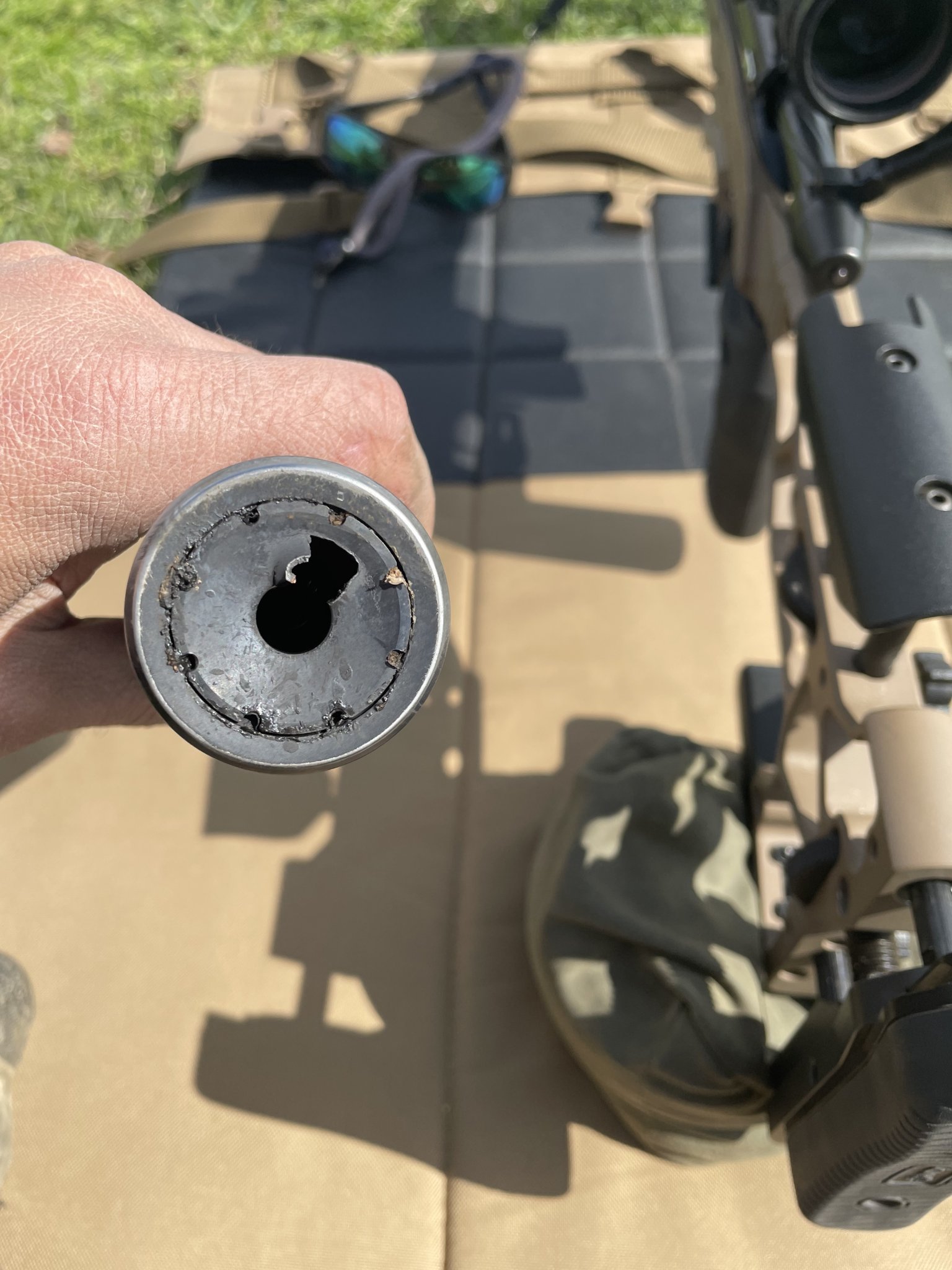

So nice Sunday afternoon came up on the hill and shot some 223 then got my 6.5 out. I screwed my suppressor on and shot 10 shots gave the barrel a few minutes to cool and my next shot was a lot louder than it shoulda been. Sure enough end cap is fucked my question is what the hell caused it?
Dead air nomad L
6.5CM with 140 eldm 41.5g h4350
Bighorn and pva 26”

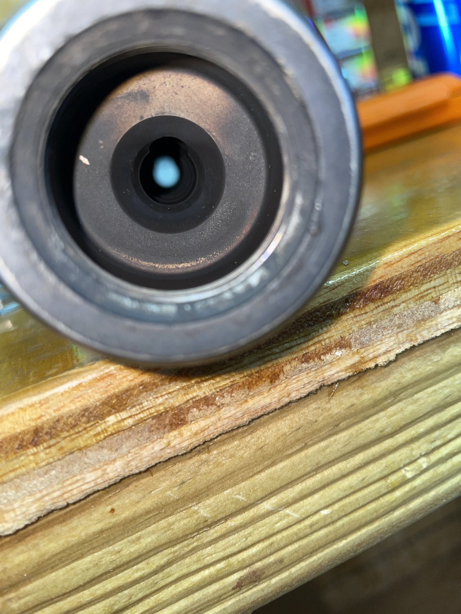

What is your mounting method?
Did you get a baffle strike?
If you shake the can does it rattle at all? Wondering if was the jacket separation.
Did you hit your target?
Possible the bullet came apart. Was there anything foreign that could have possibly been in the ammo? Tumbling pins?
Did the rounds hit the point of aim. That would tell you wether the bullet blew apart or not.
Direct thread
Not that I can see

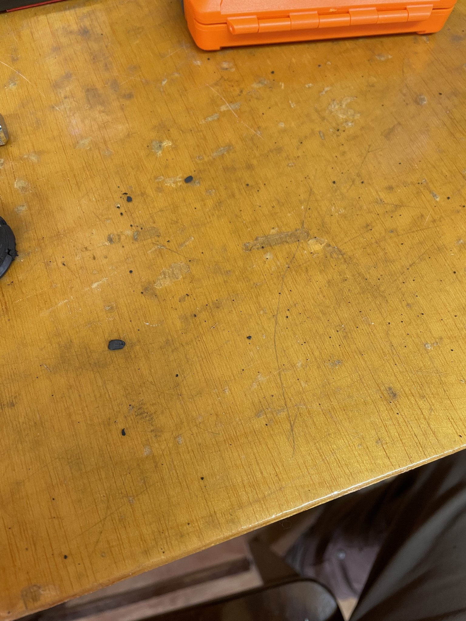

There are some pieces floating around in there. I shook em out so what’s in the pic is all that’s loose inside the can.
Didn’t see impact but it was at 1K with a soft berm
Direct thread
Not that I can see

Good chance the round came apart if you were shaking copper and shit out.
Reactions: AMGtuned
1:8 twist
Just cleaned that largest piece of “debris” in the pic and it’s copper jacket.

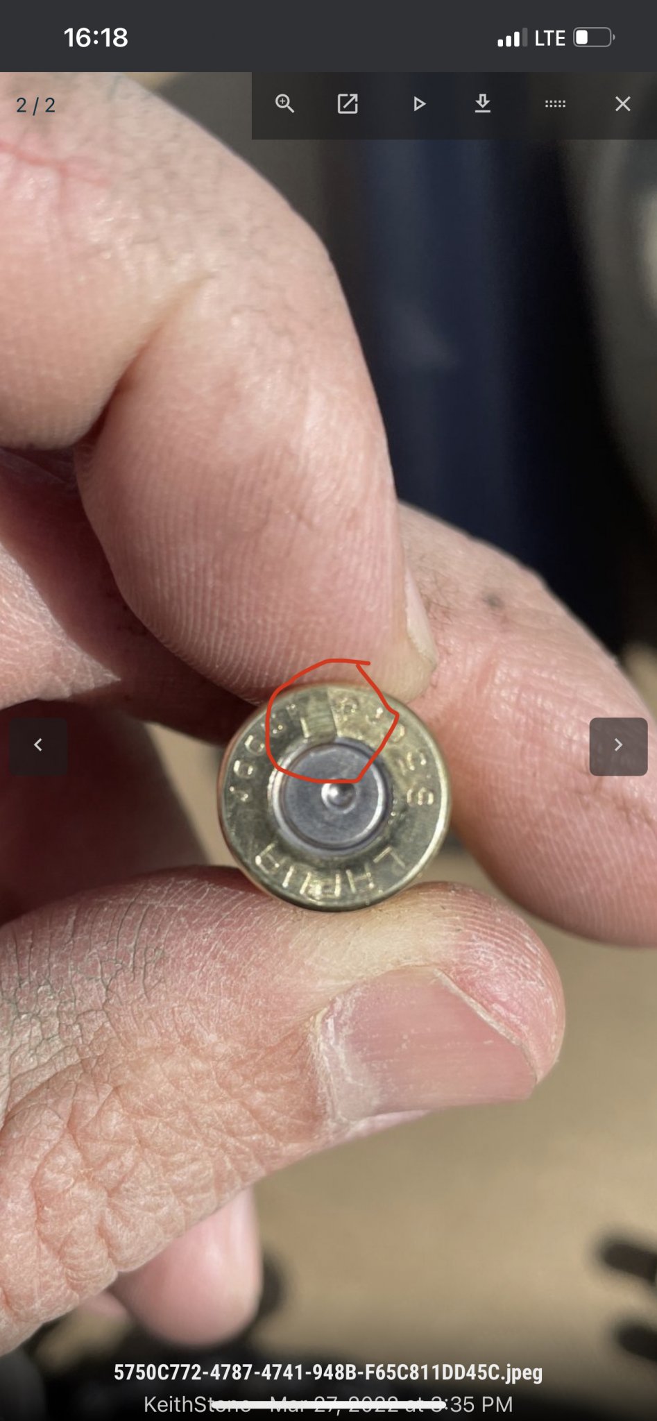

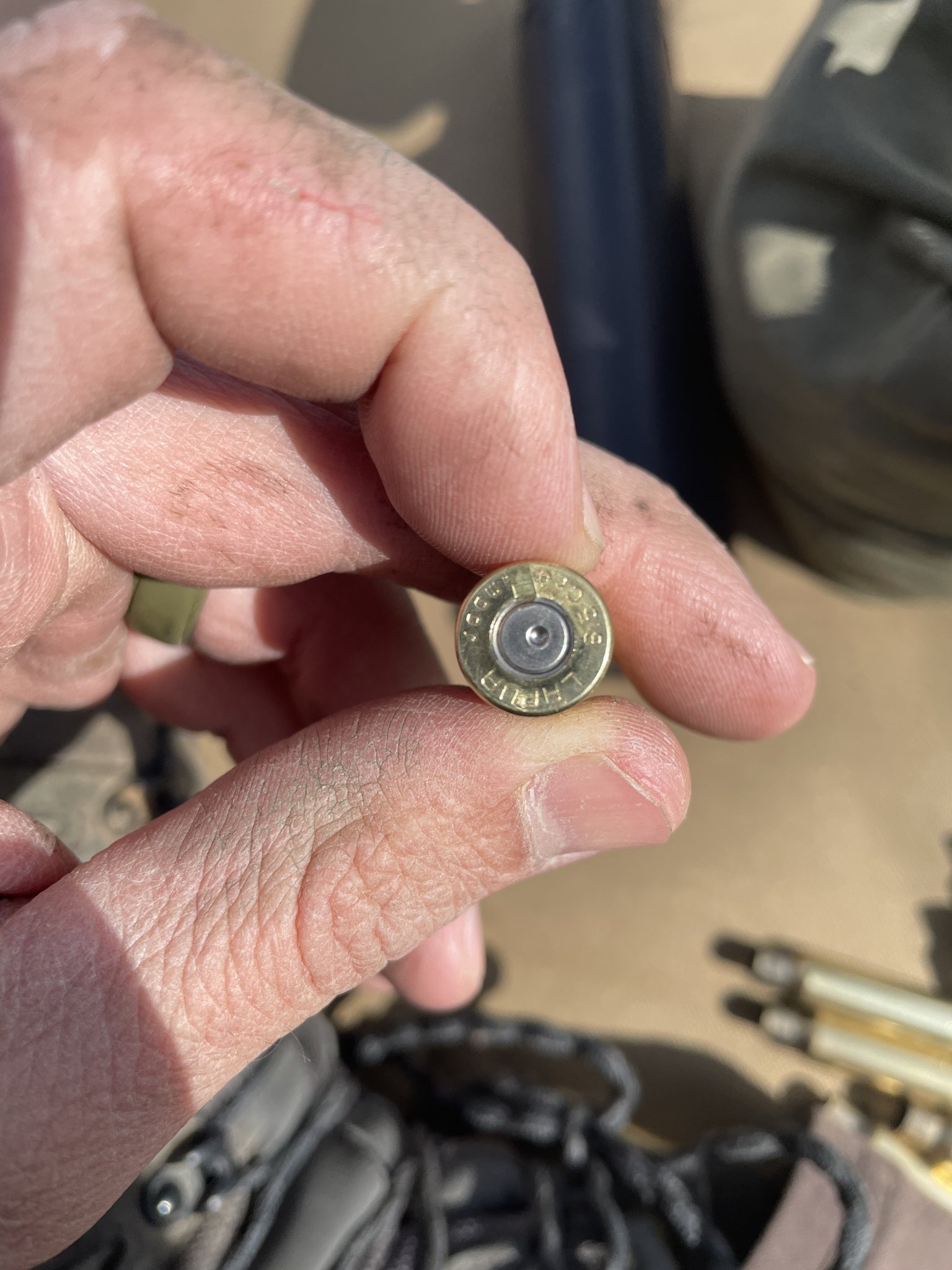

What’s the mark on the rear of the case?
Ejector mark and it flattened the primer.

Looks like you might have gotten a small baffle strike in the upper-right hemisphere of the keyway in your picture, but I don't think that will cause any issues. Might just be able to replace the end cap with a new one, and you'll be good to go.
I would check with @Mageever and the guys at Dead Air first. They'll be able to tell you a more accurate recommendation as to what your next steps should be.
Also, make sure your KeyMo didn't come loose. One time, my KeyMo DID come loose while shooting, and I got a few baffle strikes on a nearly brand new Sandman-S MIL Contract can. Luckily it was just soft-jacketed .300 BLK subsonics, so it didn't do any damage to anything, just shaved a few slivers off the bullet. I didn't even notice until I shot and it sounded weird...Like a weird ricochet/cable-snapping sound, and the bullet hit the ground WAY in front of the target, like 125 yards in front of the target (I saw the dust). So I stopped and checked the can, and it was loose! Never had it happen before, and never had it happen since on a gun. And I know I tightened it down 100% on the gun. Don't know what happened, but sometimes fluke things like that happen. Luckily I didn't have any damage at all, just had to knock the can on the bench a few times and let the lead shavings and chunks drop out the bottom. 😂 It's been good to go ever since. 👍🏼
If your first 10 shots were fine and the 11th wasn't, then it was likely a jacket separation or the can loosened during the first string. If it was the latter, it should have obvious immediately upon removing the can, and since the OP didn't mention that in his post, I'm assuming it wasn't something that was observed.
I'd still recommend checking the bore alignment after the can is repaired, but I'm skeptical that this was a factor (particularly with ~0.050" nominal radial clearance).
