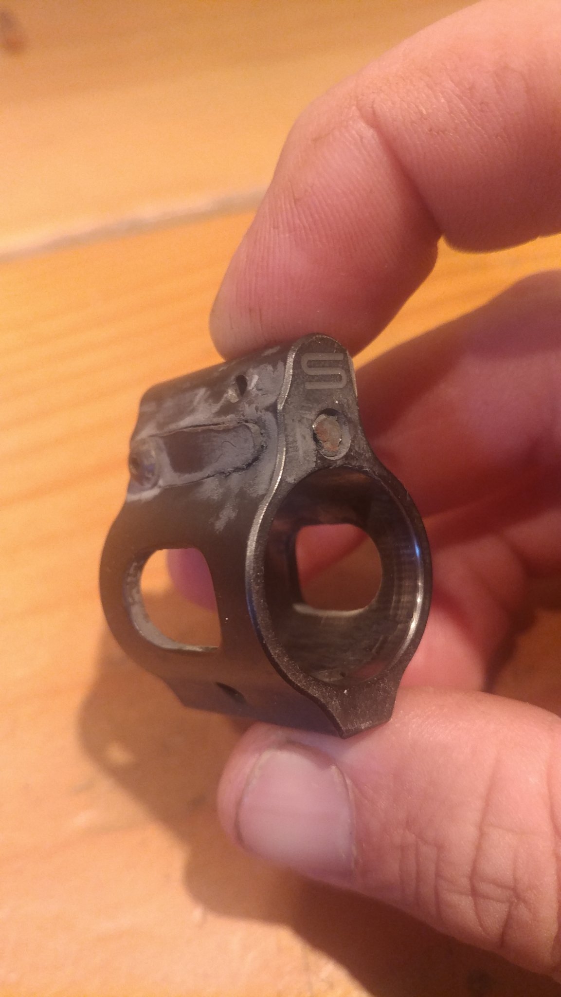

I've never seen one fail in such a way as to cause the rifle to lose function, but there are ways they become fixed gas blocks.
Had this happen to 2 SLR's, the first I just tried to loosen it gently, the second got a full days soaking in PB Blaster ahead of time.
And there are a few reasons to readjust an AGB, I've changed primary loads, changed BCG weights, buffer springs and weights, had a few gas blocks go from a burnt out barrel to the new one..
So if you like to tinker with stuff it's nice when they don't weld themselves in place, not a problem if you set it and plan on replacing when the barrel is toast.

I've never seen one fail in such a way as to cause the rifle to lose function, but there are ways they become fixed gas blocks.View attachment 7133720
Ive had that happen as well during a barrel change. And yes, the rifle still functioned 100%. Call SLR, they will send you a rebuild kit and a nice allen tool for free. Sole reason I stopped using the SLR's and went to SA. Havent had it happen yet.
