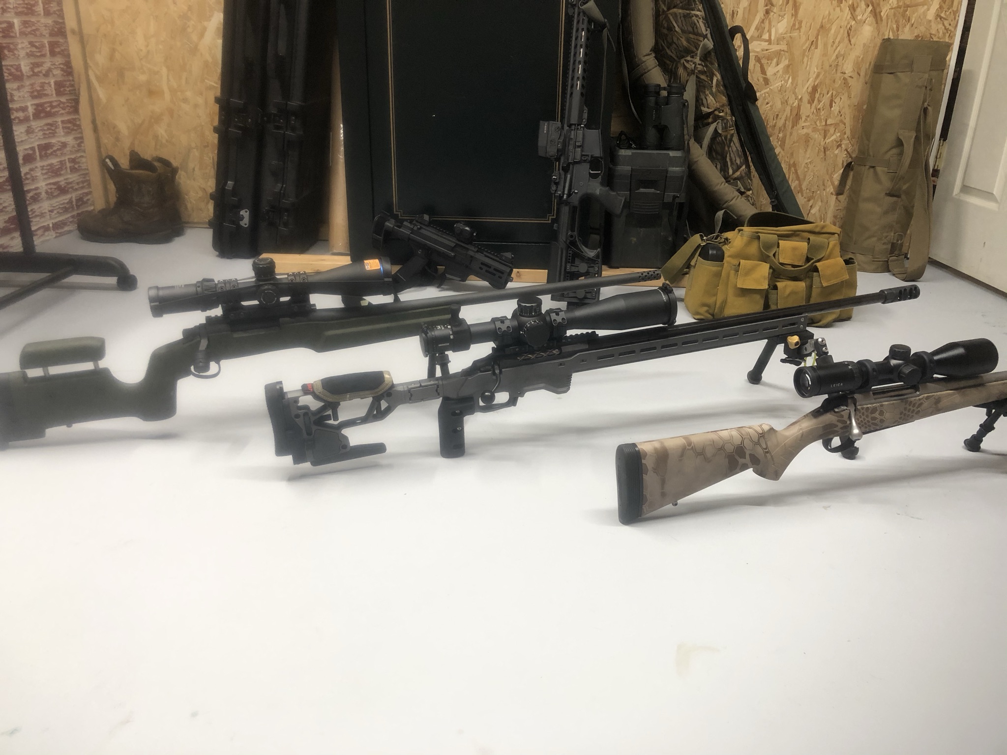

If you aren’t in a hurry watch the PX. I built a rifle from a Tikka barred action purchased from the PX. Also purchased a MDT ACC 50% off code. For not much more than the price of a Tikka TAC A1 I got the chassis I wanted, aftermarket barrel, fluted bolt with sterk bolt knob, and was able to build it the way I wanted. I was deployed and patient while finding components though so maybe you don’t have that time to wait.
