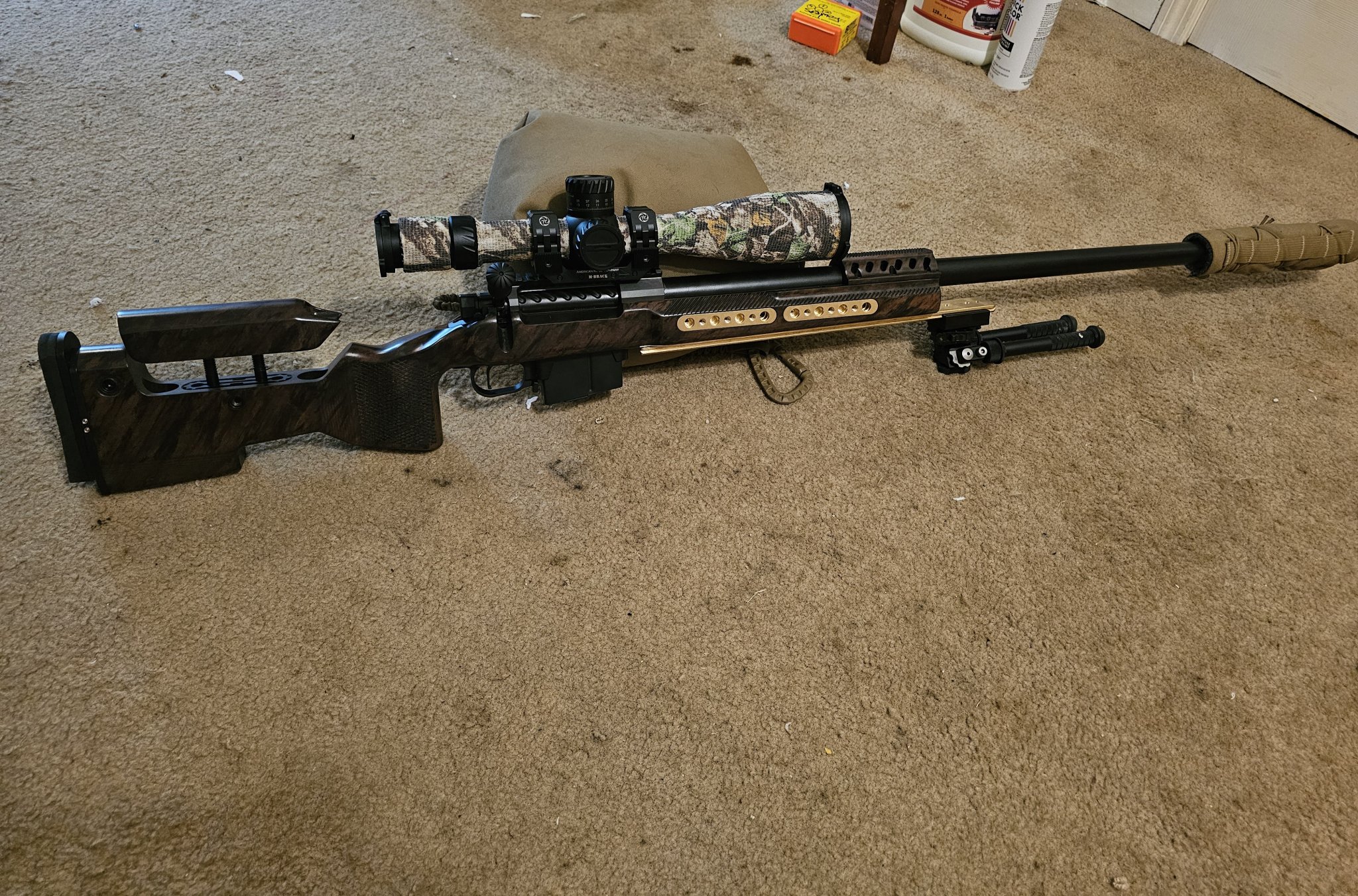

I went with the CDG. I could have saved up for a more expensive action, but why? after taking it down a few times i assure you, the video of ted doing it he is trying to be slow. its so easy and intuitive its crazy. id have paid much more for this action if i had to. 6.5 creedmoor is an excellent cartridge, I'm running 6 creed.
I got ordered this barrel from PVA, action from ARC and stock from foundation and got all three roughly the same time. tickled pink. it all bolted together no fuss, the only thing I will say is with the CDG action you want to run AI AW magazines, they are the absolute tits. when getting your bottom metal if anyone asks just go for the "standard" latch and everything will bolt right together. or get the mdt bottom metal, it's adjustable I hear.
if you get the wrong latch like I did it's a very simple job to take a file to it and make it 30 thousandths shorter.
other than that my whole setup took me about 30 mins to bolt together and get just right. even the file job was about 10 mins extra.
eta don't judge pva on my 10 min rattle can job with lowes heat resistant grill spray paint.
also I run the non pivoting bolt handle on the action so I can run stupid light triggers. I sometimes regret that choice, the pivoting handle seems cool. neat thing is, I can buy that part pretty cheap if I want later on, but I'd need a new trigger.
Reactions: Dawhit
also the shorter the throw the heavier the bolt lift feels. the ARC is very usable but a really good 90 degree feels lighter. the 90° bolt throw know never really got in my way but I'm just a rando on the interwebs, you might try it and hate it, depends how you hold the bolt knob I'd guess.
also I'd really recommend PVA for your first prefit order, I'd trust it to go well more than proof.

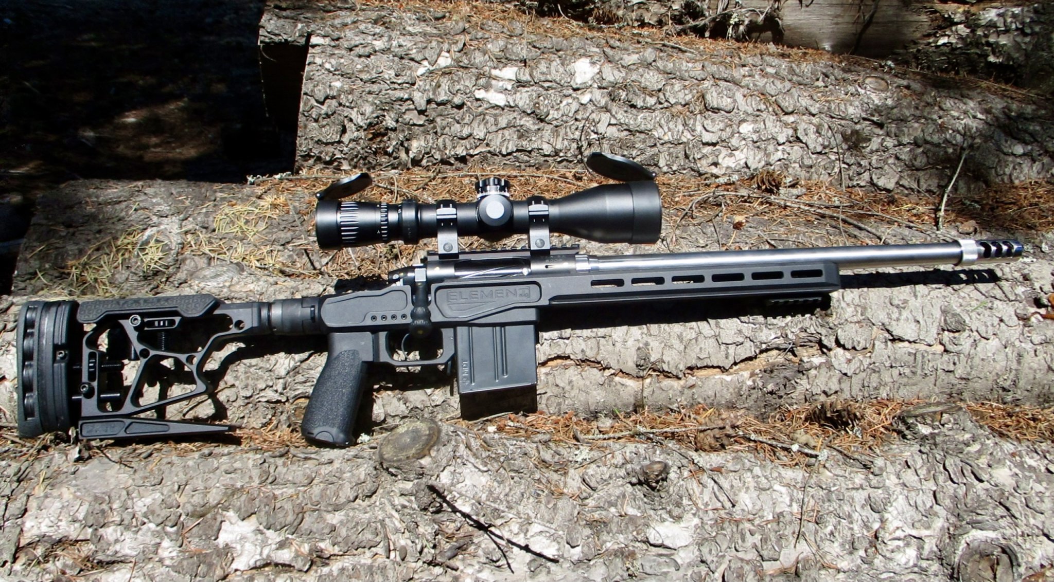

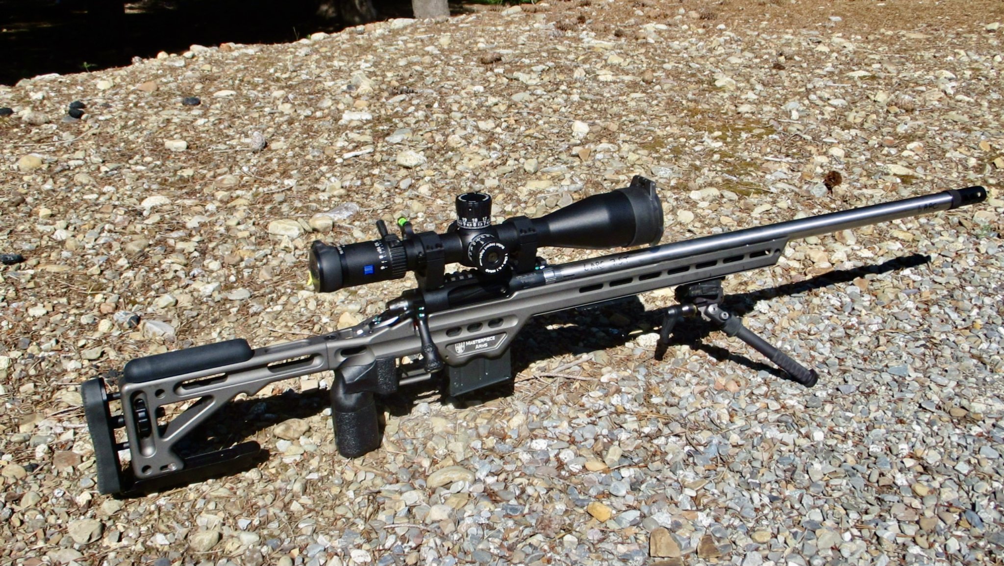

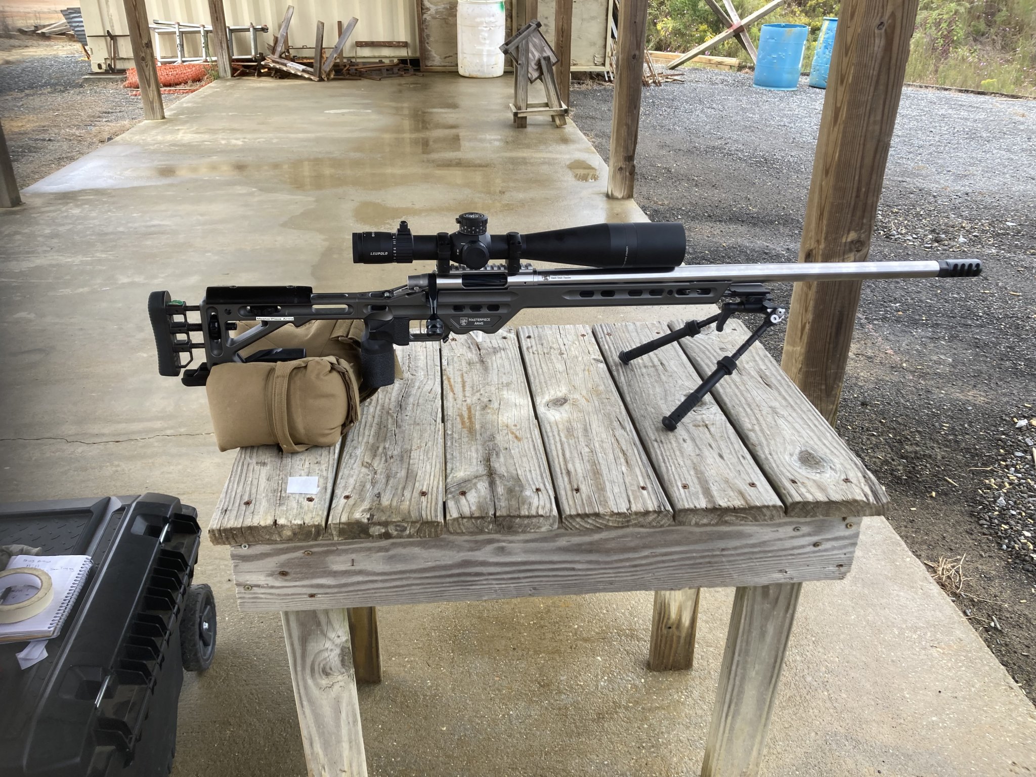

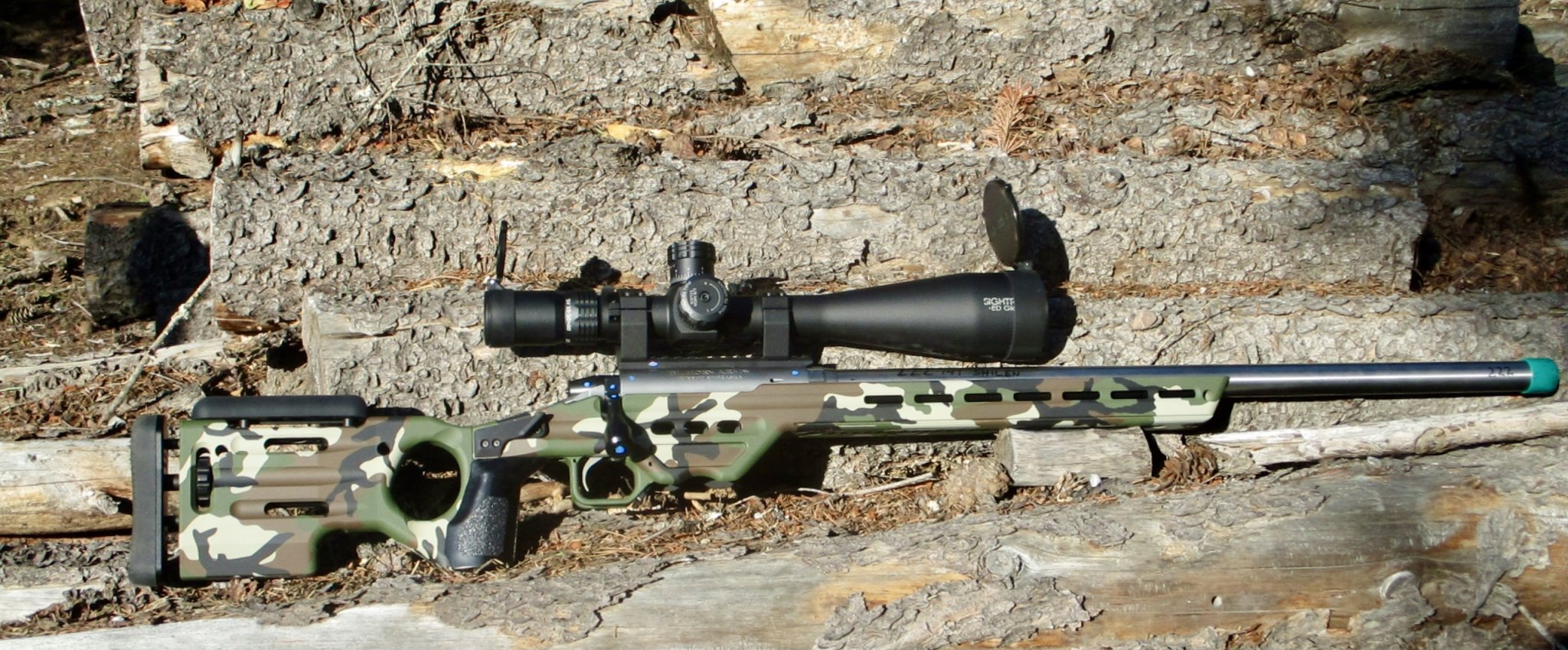

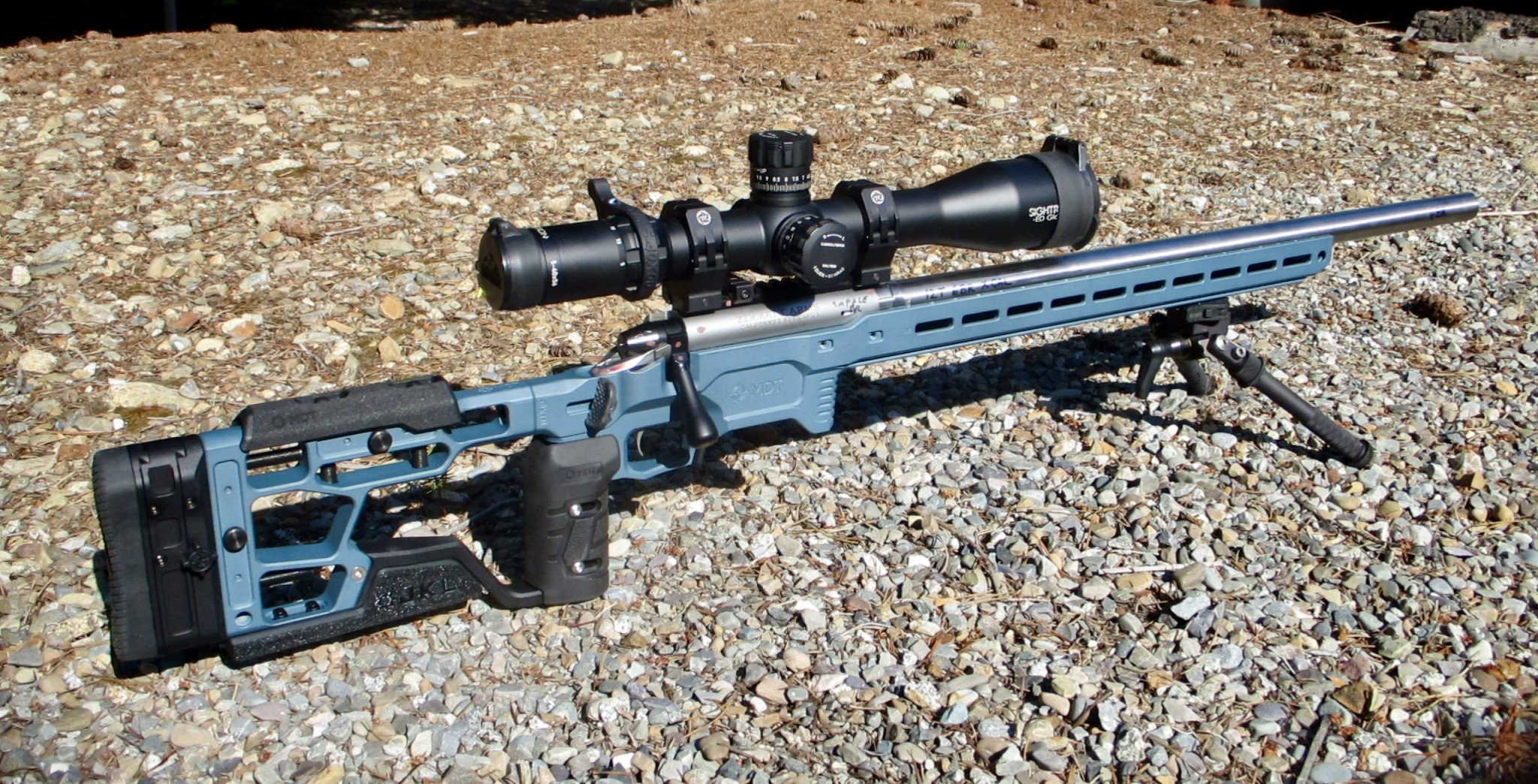

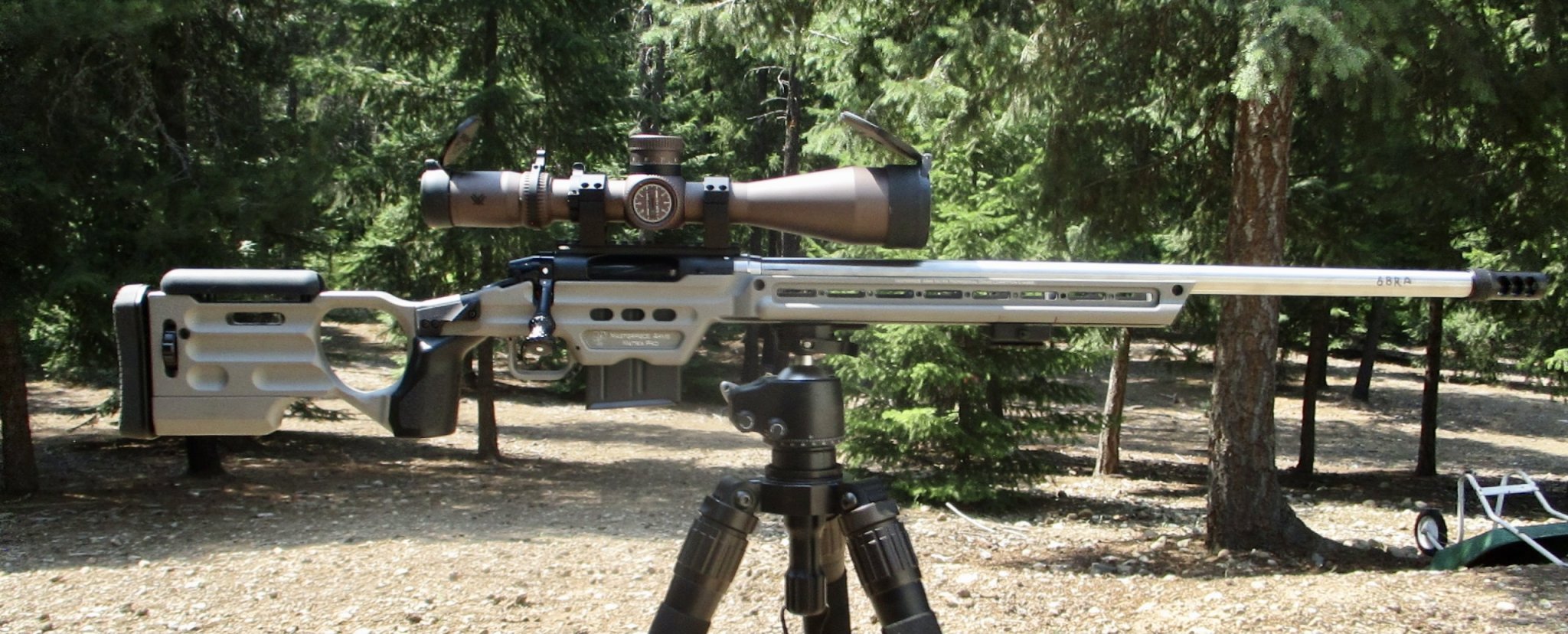

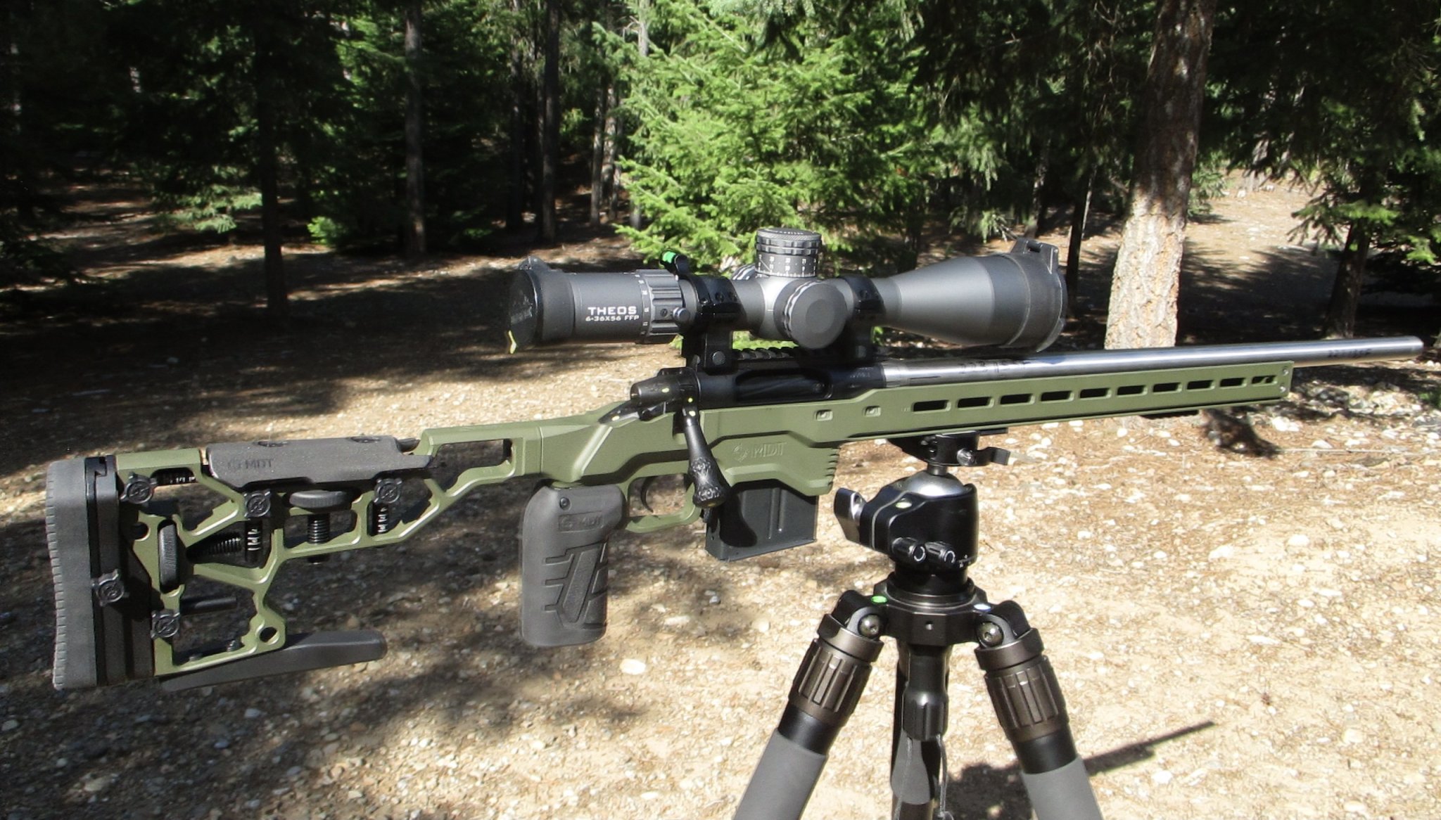

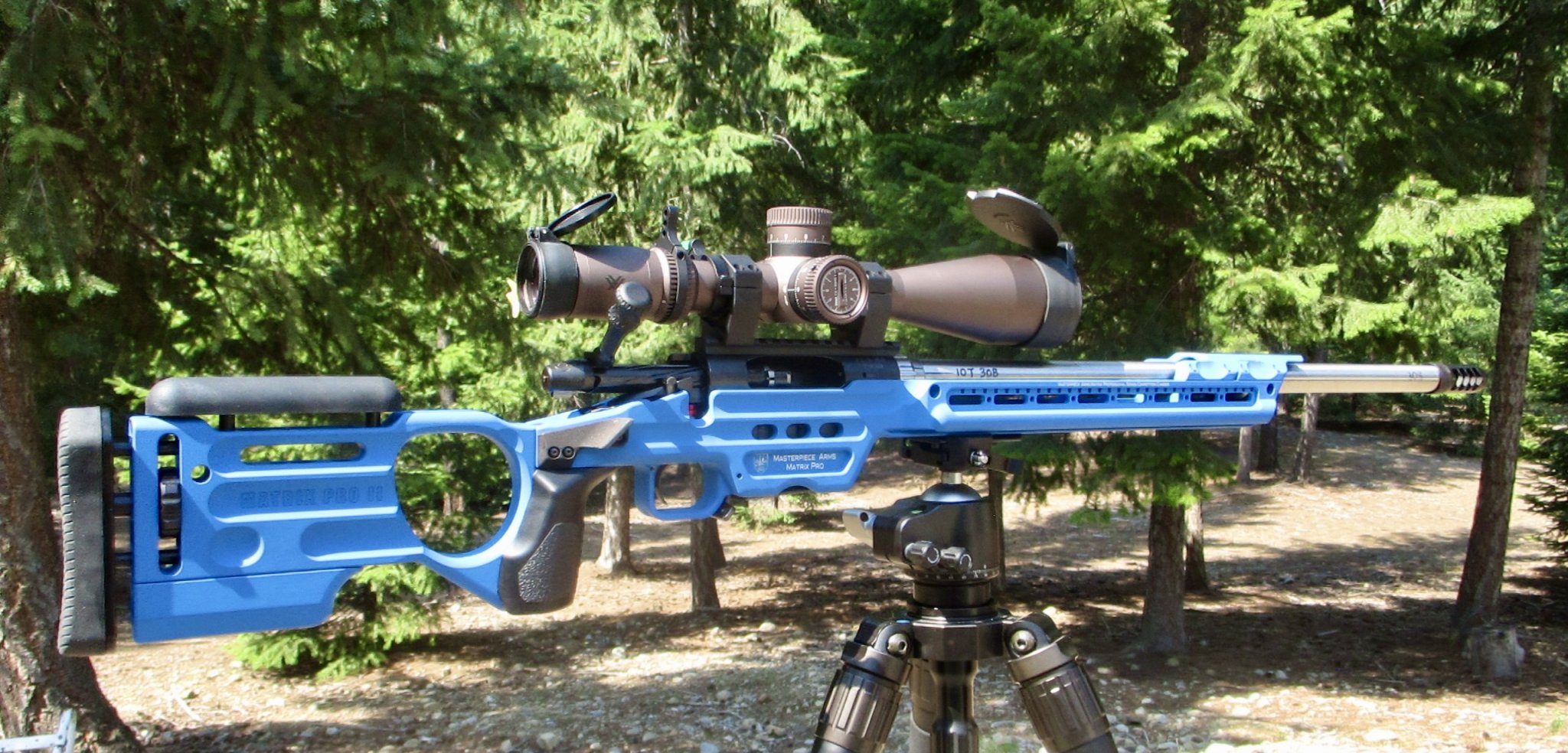

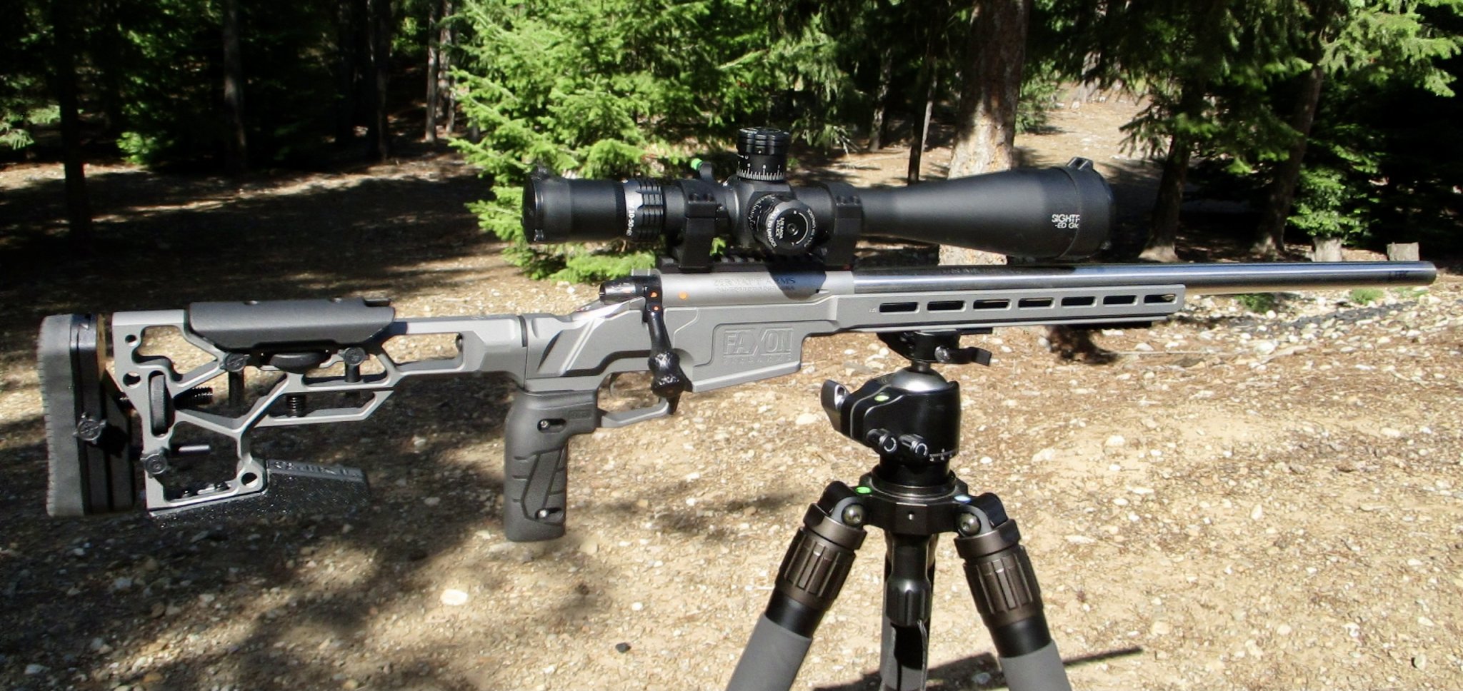

A good deal is a MDT LSS-XL that MDT makes for Faxon. I picked one up from PA for under $700 not too long ago. Here's some different chassis for some of my TL3s:
Faxon/MDT:
MDT ACC Gen 1:
MDT ACC Elite:
MPA ESR:
MPA Matrix:
MPA Matrix Pro:
Matrix Pro 2:
XLR Element:
Wow- thanks for the pics! Always helps to see pics to get a better idea on how things really look. I think I'm leaning MDT ACC Premier Gen2.
