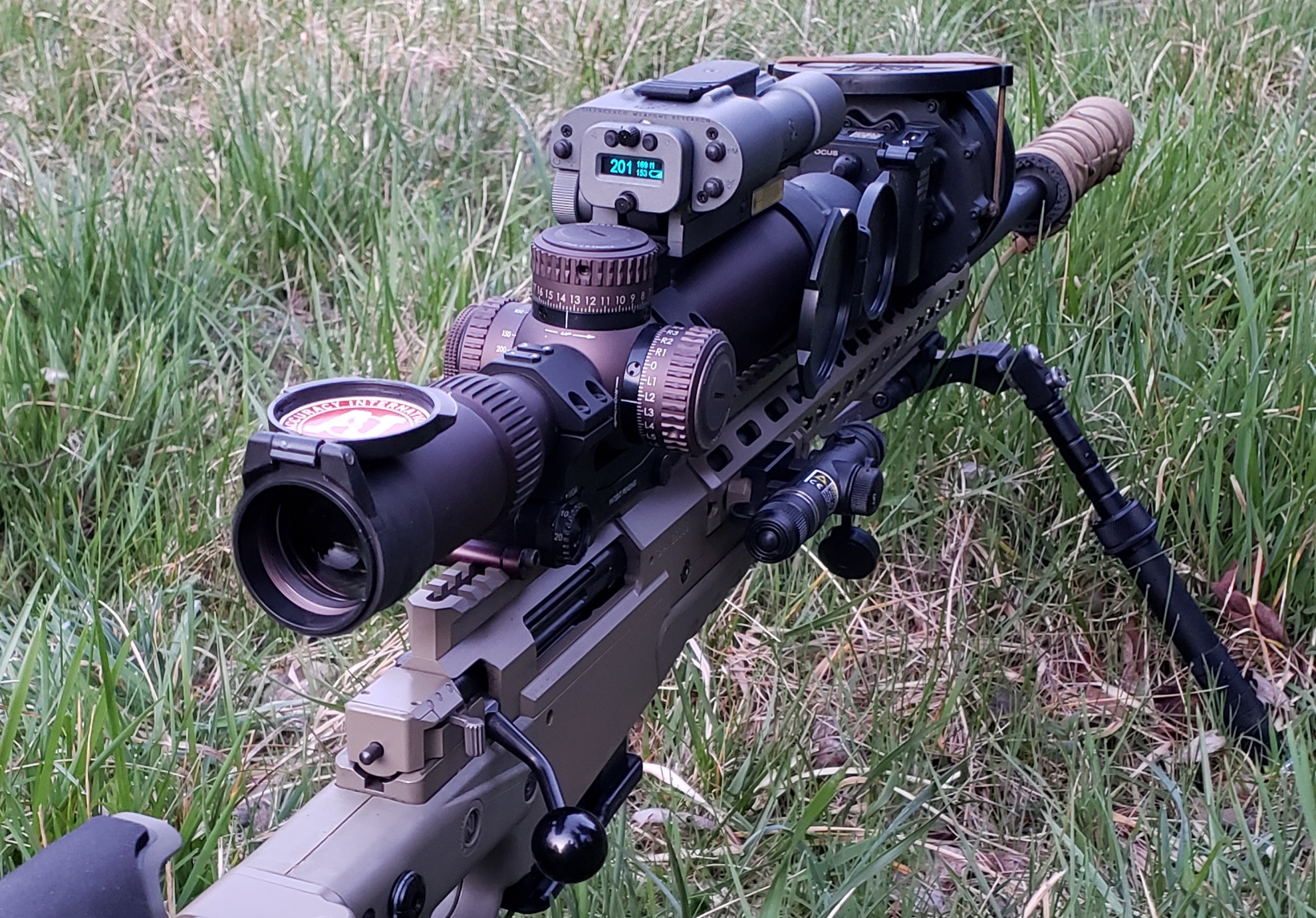

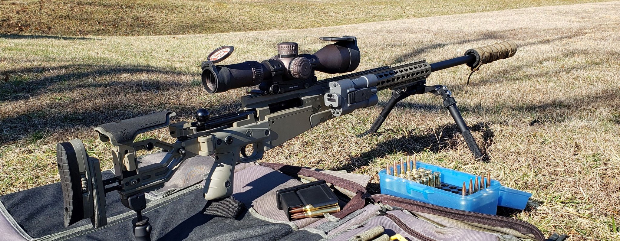

As it was said earlier it depends on your body type, I weigh about 170 and don't have a bucket head.... You can see in the pic that the cheek rest is more than half way up. Yes, that is a SilencerCo Radius RF on top(on the side in this pic)
what is that thing on the side of the rifle
SiCo Radius range finder that is no longer being produced. I was experimenting with different locations before I settled on the ring mount.

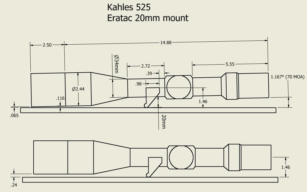

I am going to order an Eratac mount next week but was also unsure about the height.
It is for an AXMC with full rail.
I have a 21mm Spuhr mount right now so compared to the Eratac 20 or 25mm it will be either 1mm down or 4mm up.
I have played with the numbers in Inventor and with full inclination there is a .116 clearance under the front bell or .065 with a 2.5” sunshade.
This is with a Kahles 525.
However, as @Yerman wrote, the dial nut needs extra clearance when rotating so there is probably not enough clearance with neither a sunshade nor a Tenebraex lens cover.
The 25mm will allow for sunshade and lens cover.
I think you answered your own question already, go with the 25mm then :) i never understood the hype about getting the scope down to the last possible mm ;)
